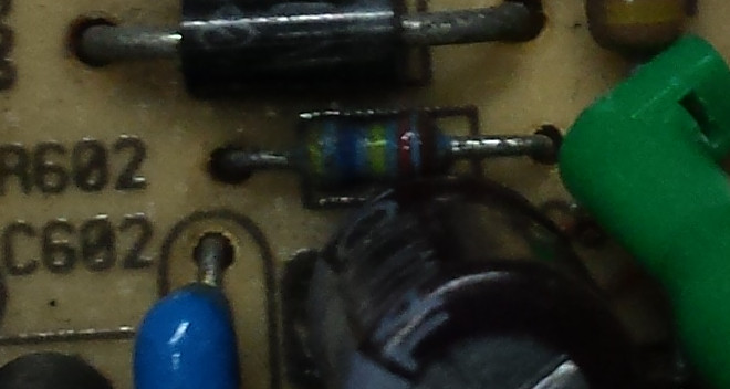

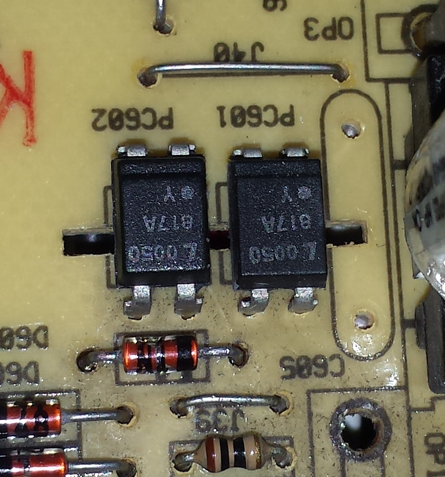

          I just replaced the TL431 shunt regulator & sadly its still dead. Ive now checked all diodes and all IC's except the two in the attached picture (L0050 8170). I have no idea what they are and cant identify them from the part number. anyone know what they are? Ive also tested the transformer and all 3 coils are ok. There is one resister (picture also attached) I dont get a normal reading from but not sure I am reading its colour code correctly. I think its red,yellow,blue,gold, 24 Mega ohm. What does everyone else think? I was also wondering should this PSU start up without this 5V board attached because then I can remove it and see if the PSU starts up on its own and if not I will know there is another fault.

            817a optocouplers, available everywere. the resistor does seem to be 24meg
                Those are standard "817" optocouplers, as R_J noted.
                What reading do you get from your multimeter?
                When testing in circuit, many times it is "okay" for a resistor to test lower resistance than what is printed on its color code (as there can be other components in parallel with the resistor that may make the overall resistance read lower on the meter). But, if a resistor reads higher resistance than what is printed on its color code (that is, higher than the % tolerance allowed), then that resistor is likely bad.
                If in doubt of course, take out the resistor in question and measure outside of the circuit. Then compare to the color code.
