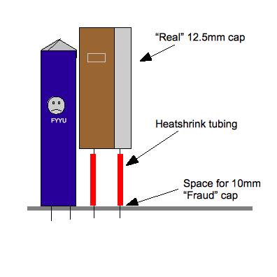

              Still, it seems well made except for those poor caps and lousy cooling.. Even though it trashed someone's hard drive and motherboard, it looks like it's worth fixing.
              Blowed-up fuhijuu all over and those 3300's are hard to find. I put some 2200's in which work OK and I ordered up some of those HZ 3300s. I did replace all of the other secondary caps including the two 1000uf ones.
              If you shorted out the fan controller board, you may want to examine the circuit traces very carefully. Some of them are very thin and apt to melt in two like a fuse, thus protecting the components. A touch of solder or a short jumper wire gets it going again. I fixed an original Neo480 (CWT built) like this.

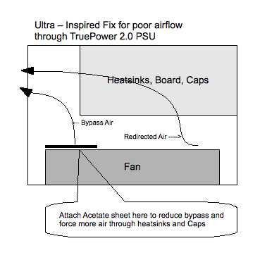

              One other thing about the ChannelWell-built TruePower Antecs with the 120mm fan..... There is a gap for where an 80mm fan might have gone between the board and the exit vent. This allows a lot of the air coming from the 120mm fan to bypass the circuit board entirely and just go in and out without cooling anything.
              I borrowed a solution from Ultra... Just cut out some acetate sheet from a package of some kind (you know, the theft-deterrent impossible to open kind) and block off the third of the fan nearest the exit vent (rear) This directs more of the air over the actual heatsinks and caps. You can attach it with fan screws or hot glue.
              Here's a neat little drawing I made:
              Have Fun!

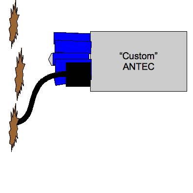

                              Here's an idea I borrowed* from my Seasonic S12-600 which is so crammed full of United ChemiCon KZE and KY they had to do this to fit the last two in..... see drawing.
                              Have fun!

                                I thought about putting them on 4" leads and hanging them out the vent holes at one point.

                                        Hanging out the vent holes! Careful where you point those tiny Chinese Timebombs. Firecrackers?
