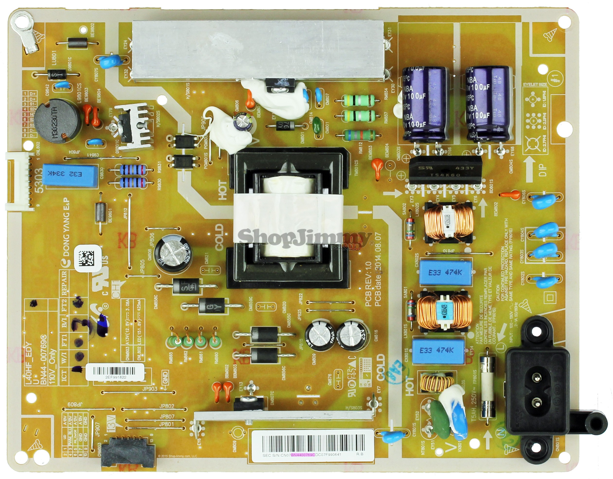

    Could a manufacturer actually "down-rate" a power board to US-voltage input only (and reduce cost?), simply by reducing the voltage rating of a couple of caps?
    Detail: I was checking out power boards for a 40in Samsung LED TV (UN40H5003AFXZA ver IF02) model which sold in the US a couple of years back. Looks like the current preferred replacement part number is BN44-00769C.
    In photos of the part, saw printed on the board "110V Only" - and wondered if they stopped making universal power supplies, or did Samsung print it to discourage people from moving electronics around.

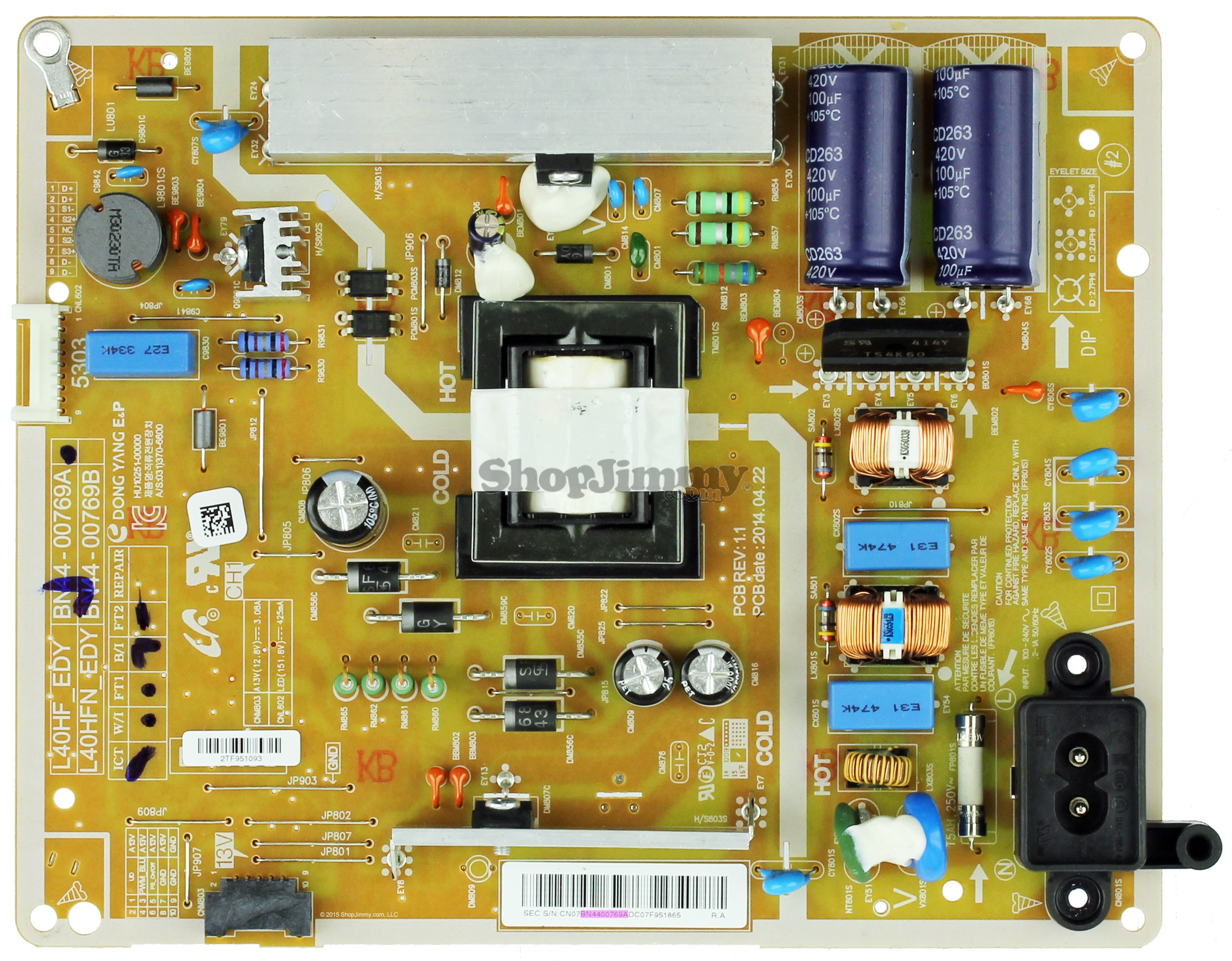

    Then I noticed pics of a different listed-as-compatible board, BN44-00769A, show no 110V warning, and the two biggest caps appear doubled in physical size (420V/100uF). I couldn't read the voltage rating of those same-position (smaller) caps in any of the 110V "C" board pics I've located so far, but presume they may be, say, 200V or 250V.
    So could Samsung actually "down-rate" the board to US-voltage only, simply by reducing these two caps? (Keeping everything else the same - as it looks.)
    Thanks.
    See the capacitors in question upper right, and "110V-Only" lower left
    110V "C" board
    Universal? "A" board
    https://www.badcaps.net/forum/showpo...21&postcount=3
    Image source: http://www.shopjimmy.com/samsung-bn4...-led-board.htm

    yes, they could.
    i'v seen it done years ago with crt monitors.

      By the way, looks like the wrong picture got uploaded above. I can't edit the first post, so for completeness here is the correct Bigger-Higher-Voltage Cap (Universal?) "A" board picture:

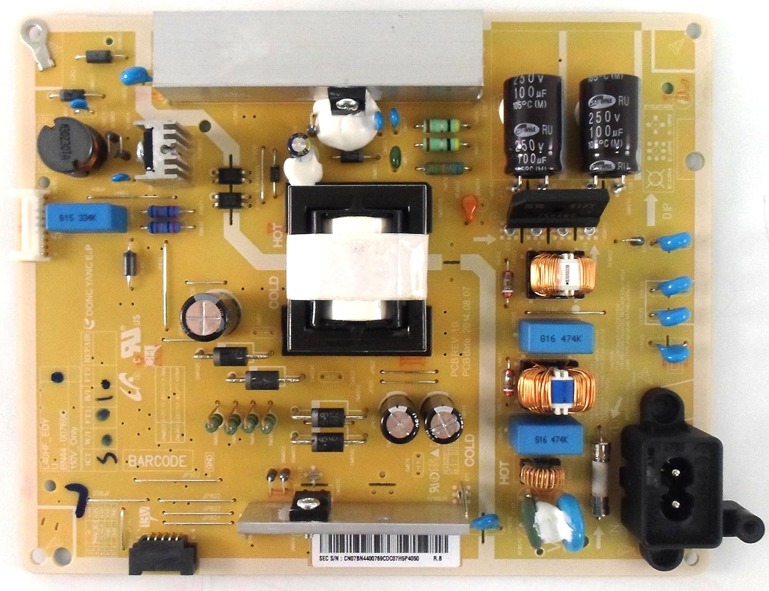

        One thing is the the MOV used in the 120V US will not have the same rating for the 230V version, and there may be some resistors changed if there is circuit to detect the incoming AC, etc.
        So unless you have the diagram of the board then you will not really know.

          they could also downrate the voltage of the diodes / rectifier.

              Unsuccessfully poked around for a schematic, but did find more pics of the "US" board.
              this one, clearly depicted 100uF 250V Samwha caps in this image from Amazon ASIN B01G7KC1A8:
              https://images-na.ssl-images-amazon....L._SL1500_.jpg
              rather than the 420V/100uF on the "universal" board, shown above.
