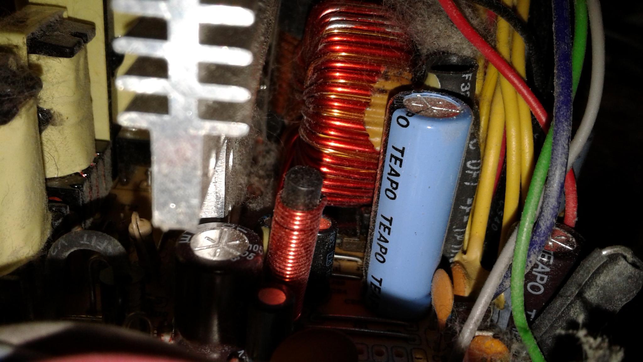

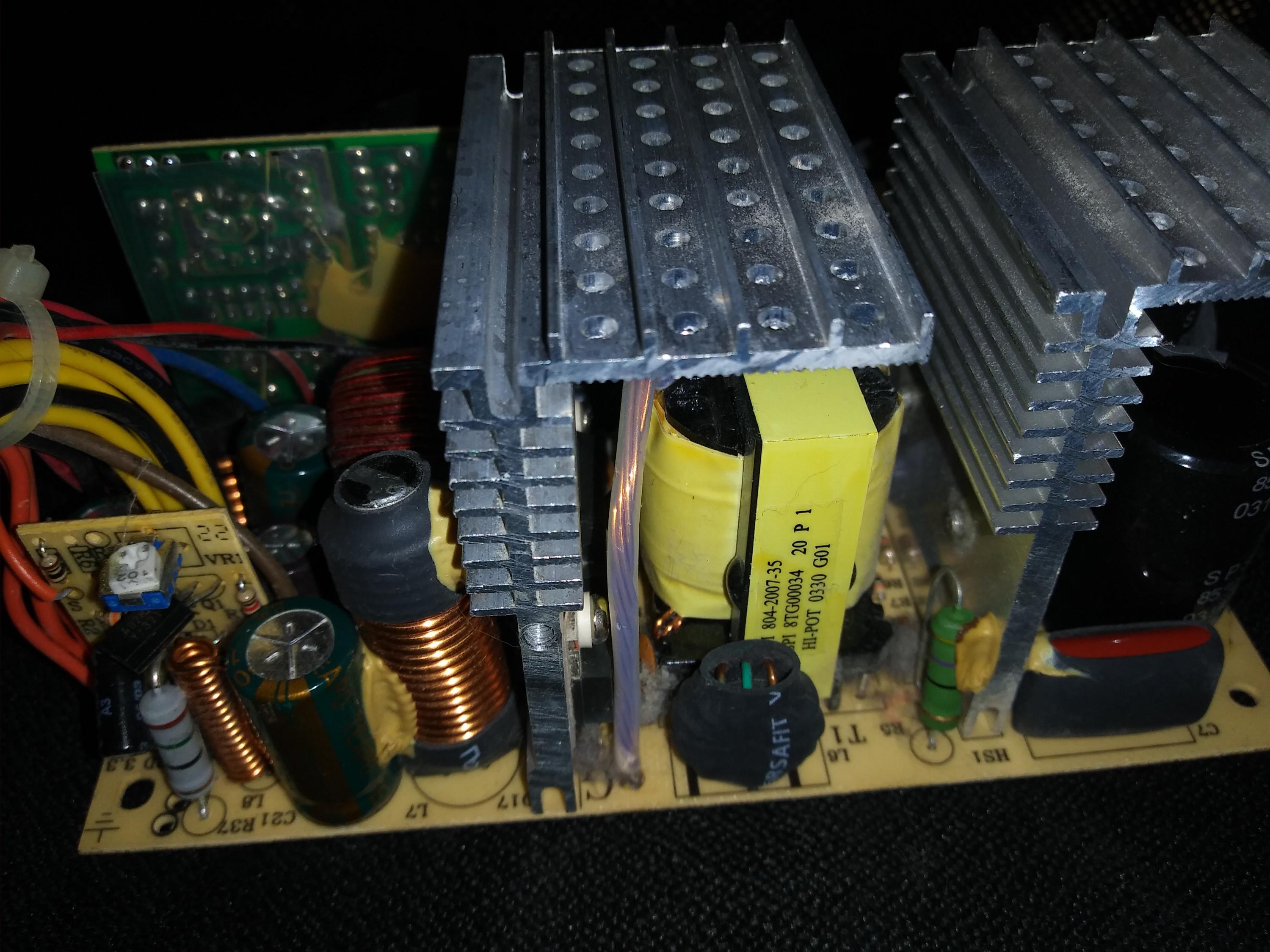

        Re: 400W PSU... is it worth trying to repair?

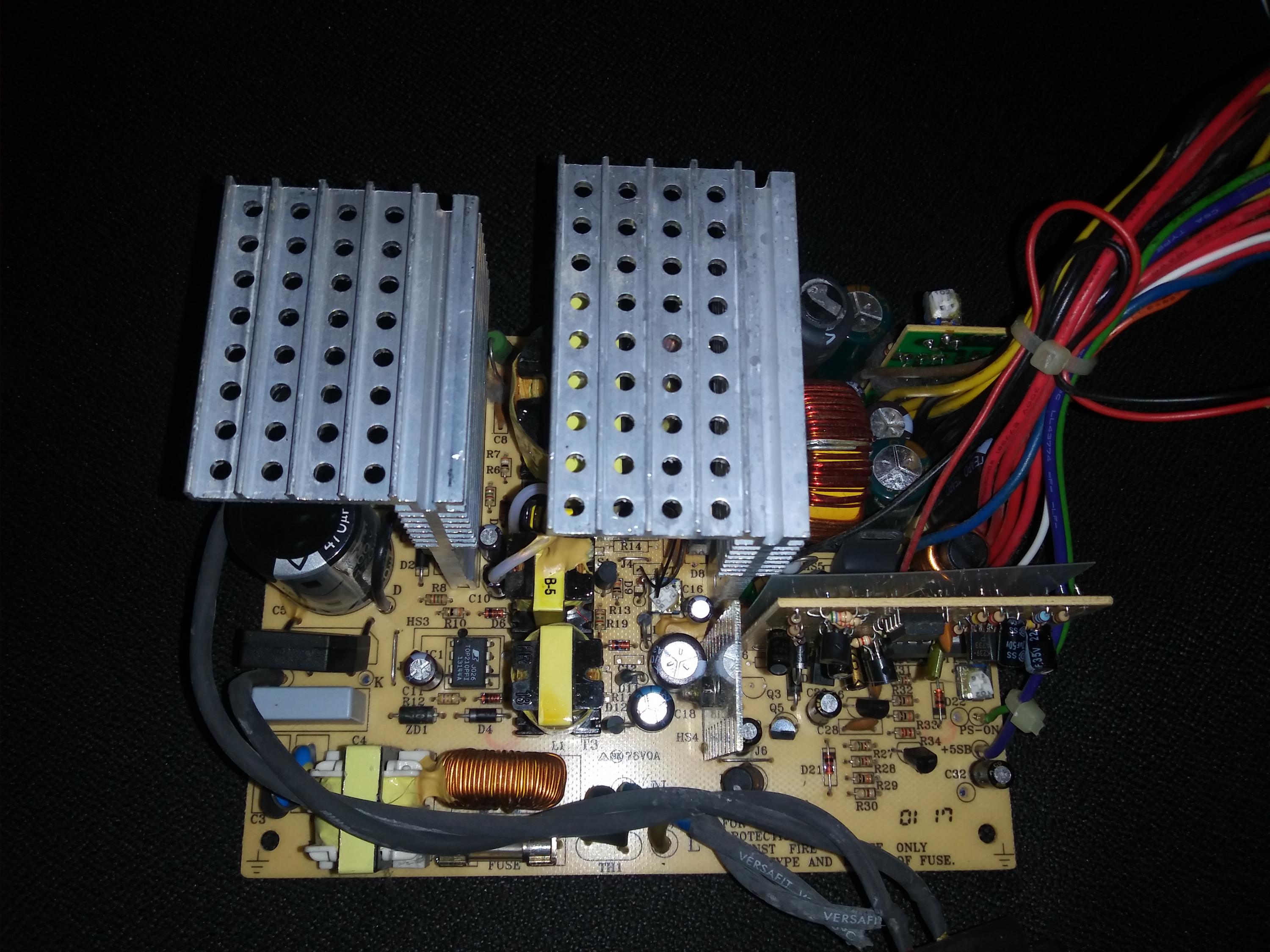

        Here are some photos...
        I'm not a expert, I'm just doing my best.
        • ChaosLegionnaire
          HC Overclocker
          • Jul 2012
          • 3266
          • Singapore
          errr... junk caps can fail without bulging...
          as for why there is a cat piss smell, i have no idea. probably a poor bung seal so as the electrolyte evaporates due to exposure to ripple current, u smell the electrolyte escaping from the cap as a cat piss smell. i could be wrong tho. wester547 could probably explain this in more detail.
          on a lighter note, i wonder how a pet dog would react to a computer that smells like cat urine. it might be probably afraid to go near the computer as its "cat territory" or it might bark loudly at the computer everytime it comes near.

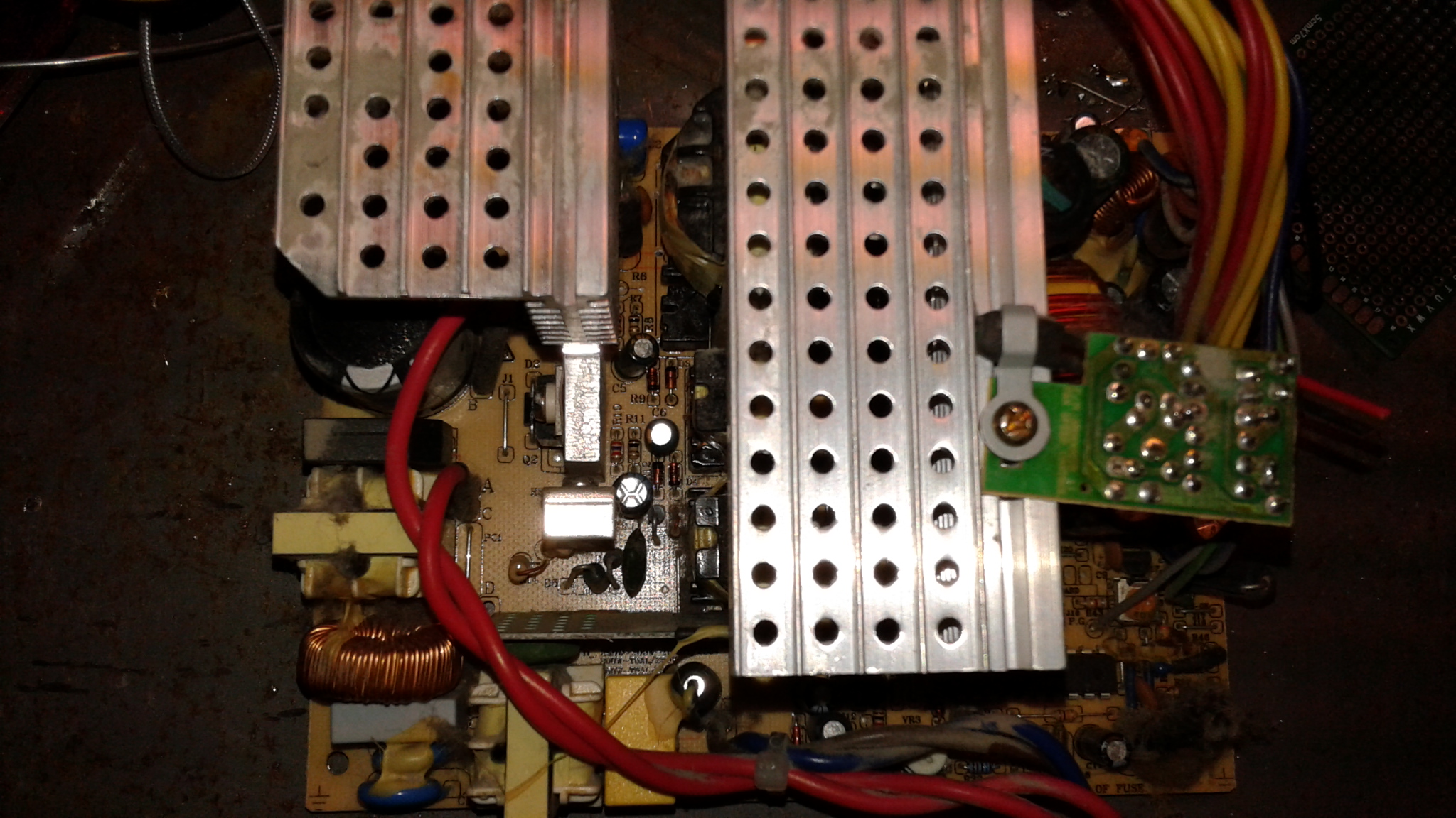

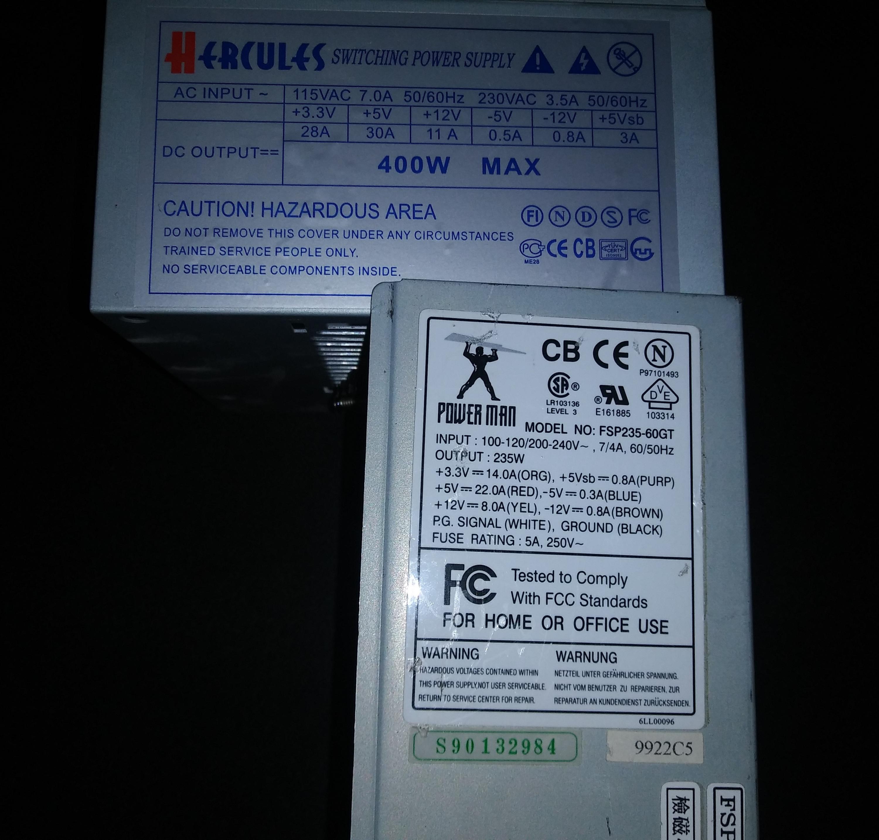

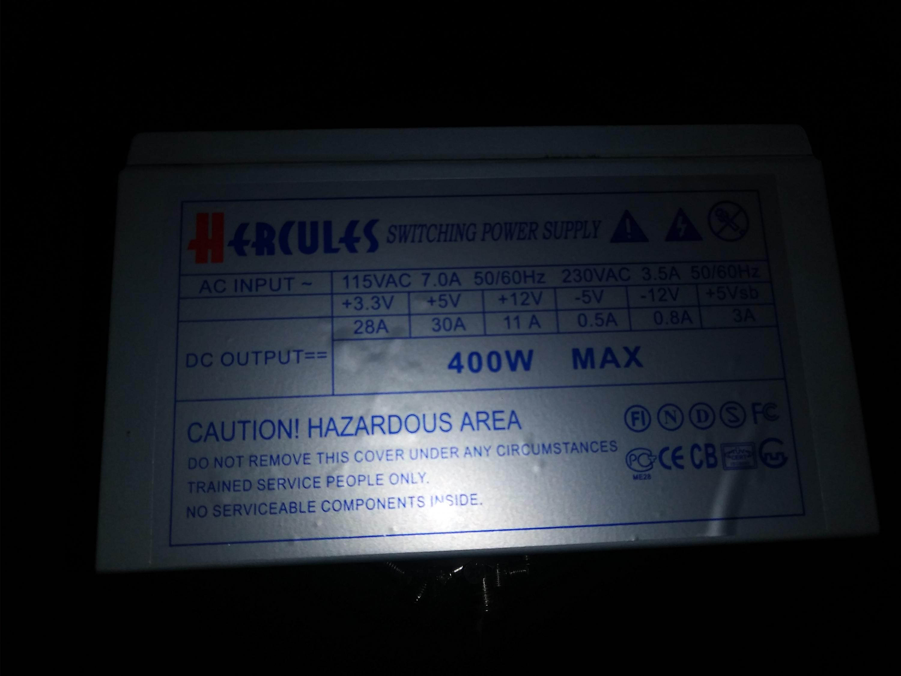

              Here's one last photo...
              • Per Hansson
                • Jul 2005
                • 5895
                • Sweden
                In the first photo it looks like the bung has been pushed out of the capacitor
                https://www.badcaps.net/forum/attach...5&d=1490076592

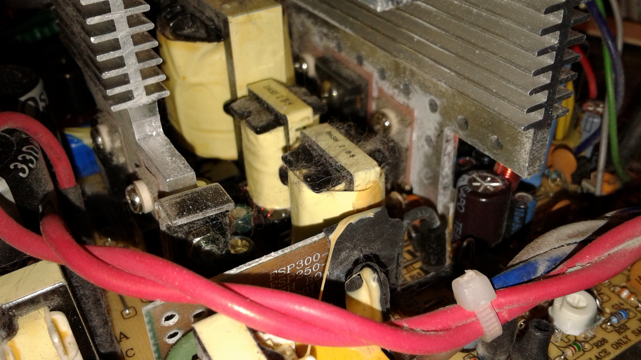

                • Stefan Payne
                  • 1267
                  Looks like a rather old FSP unit...
                  Could be decent, for +5V/3,3V heavy rigs...
                  • Stefan Payne
                    • 1267
                    loool
                    That looks like FSP delivered the units and Hercules put their label over the original label.
                    Anyway, I'd guess thats somewhat around 200-300W
                    Maybe ask FSP with that SN what unit that originally should have been.

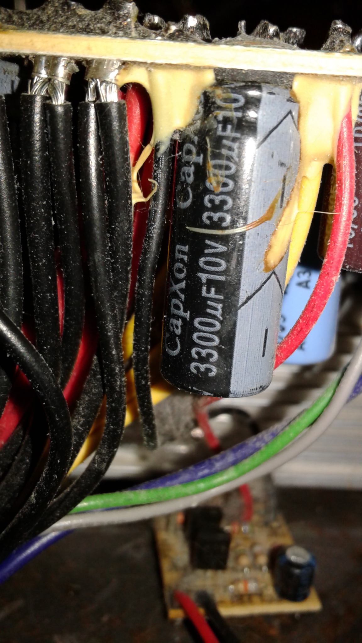

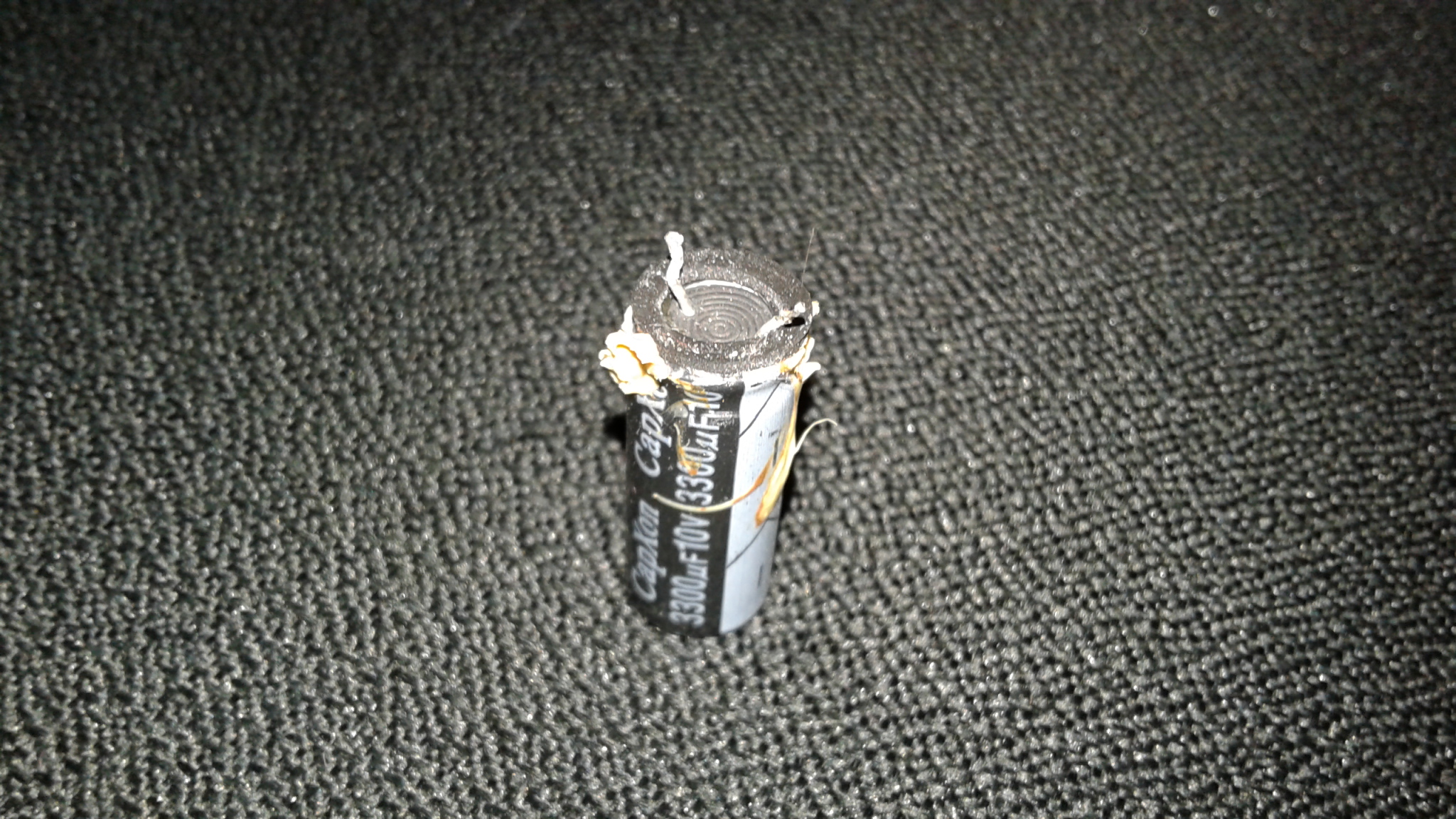

                    • RukyCon
                      A Fake Rubycon
                      • Jan 2017
                      • 816
                      I removed it to see if it did vent from the bottom and it did not.
                      Someone glued a rubber ring on the bottom.
                      Note: the stuff on the capacitor is glue.
                      • PeteS in CA
                        • Aug 2005
                        • 3586
                        • USA, Unsure of Planet
                        Looking at the heatsinks, I'd guess it's good for 250W-300W.
                        10 years ago or so I received some cap samples to test that were so rank I could smell them before I opened the box. And when I did, the caps were inside a plastic bag! The rotten fish smell all but knocked me over! They performed as badly as they smelled.

                          • dmill89
                            • Dec 2011
                            • 2534
                            Are you trying to say that the 400W rating is BS?
                            Yes/No/Maybe, the 2nd pic (in post #4) showing an add-in board notes FSP250, FSP300 indicating this platform was probably designed for a 250W-300W PSU (Though companies have built higher wattage units on older platforms originally designed for lower wattage before). The components definitely look beefy enough (from just a glance, we'd need specifics on the switchers, bridge, secondary diodes, etc. to know for sure) for a 400W though and if you add up all the amperage ratings for all rails it does come to 401.5W (though these ratings could be BS as well). I guess you'd probably have to load test it to know for sure.
                            Overall though with only 11A (132W) on the 12V rail it is only equivalent to most modern 200-250W PSUs in a modern(ish) 12V heavy system, but may be more useful on an older system that relies more on the 5V and 3.3V rails. Definitely a solid unit though, FSPs (especially older ones) tend to be well built aside from often using sub-par caps.

                            • ChaosLegionnaire
                              HC Overclocker
                              • Jul 2012
                              • 3266
                              • Singapore
                              is that the infamous yellow conductive glue i see again? might wanna scrape that off. it might be shorting the psu when power is applied thus it wont power on.

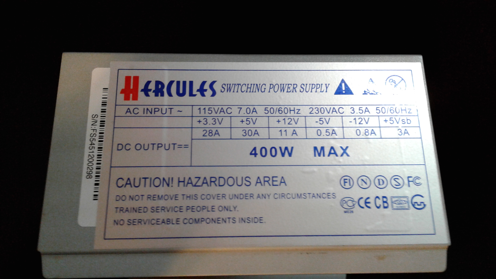

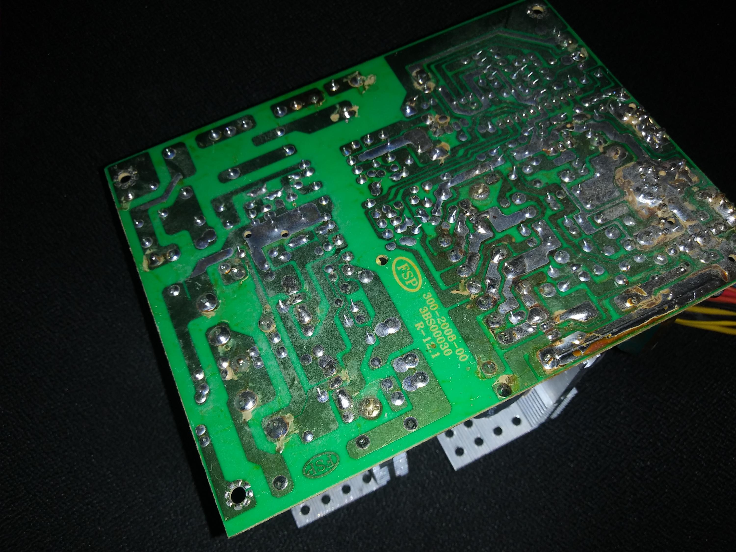

                                  Welp, the Hercules PSU has come back despite the fact it was tossed out over a year ago and it has a new issue.
                                  Problem: -12V rail is low (sits at -5v) and the 5V rail is a bit high (sits at 5.3V (ATX Tolerance says the max voltage on the 5V rail can be 5.25V), maybe i'm overreacting about the 5V rail).
                                  Label.....
                                  Top View............
                                  The PSU appears to be made by FSP and it looks just like 2 other power supplies i have.
                                  Most of the capacitors appear to be fine.
                                  Bottom View..........................
                                  The bottom confirms it's an FSP unit.
                                  The soldering looks a bit messy.
                                  Side view............................................
                                  The capacitors are a mix of Teapo, OST, and Jamicon.
                                  And unlike the other one, this one does not smell like cat piss.
                                  And in case no one noticed yet, one of the capacitors for the 5v rail (Teapo SC 3300uf 10v) is bulging after one year of use (and no, it was not bulging when new).
                                  One of the three power supplies looks almost identical to this one but it's rated for 235w while this one says it's rated for 400w use.

                                  • Wester547
                                    • Nov 2011
                                    • 1269
                                    • USA.
                                    Between those heatsinks and the 470uF primaries, etc, I highly doubt that PSU could do 400W. More like 250W, or as the other supply expressly states, 235W. That Teapo definitely needs replacing, but according to the datecode on the transformer and on those OST primaries, the PSU and the caps are basically 15 years old now. Bulging after 15 years doesn't seem so bad, although it goes to show that just because crap caps haven't failed after a decade doesn't mean they never will (liquid electrolytics are only rated for 15 years max, but this is due to rubber seal deterioration rather than hydrogen gas production).
                                    If the cap is located next to a hot resistor, it could have been a heat-related failure, or maybe the cap failed as a matter of course. I'd guess if -12V isn't linear regulated in this PSU that the cap on the -12V rail silently died too and may need replacing, or maybe when the cap died on the +5V rail, due to -12V being group regulated, it caused the -12V rail to sag too.
