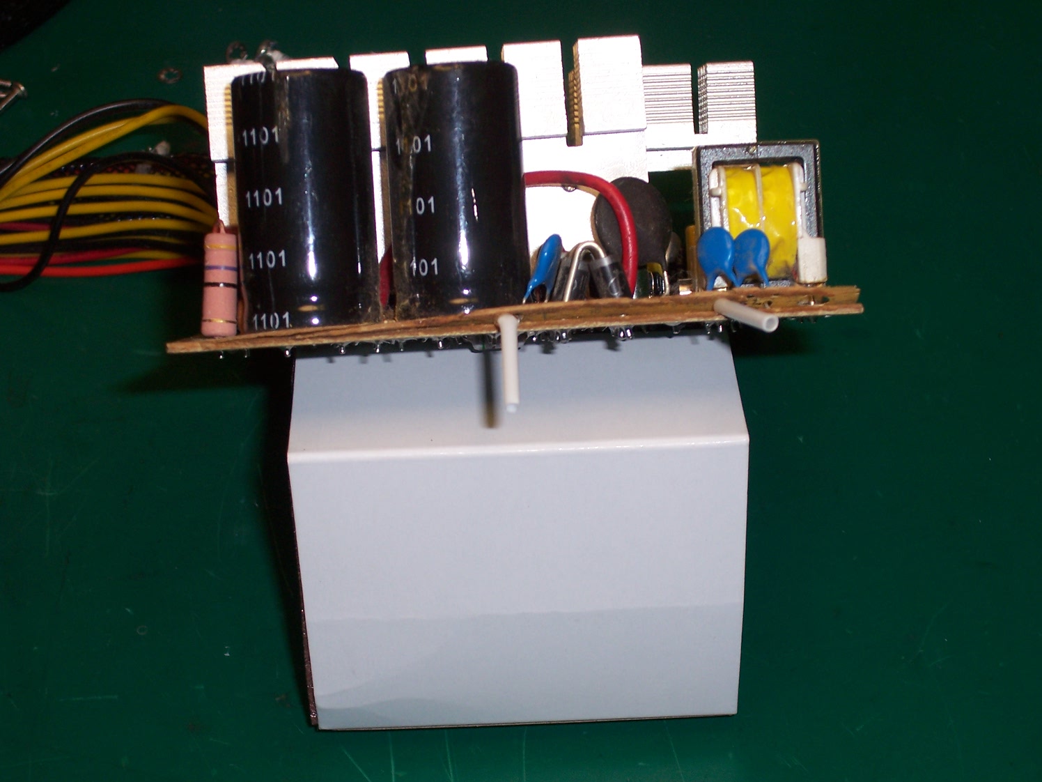

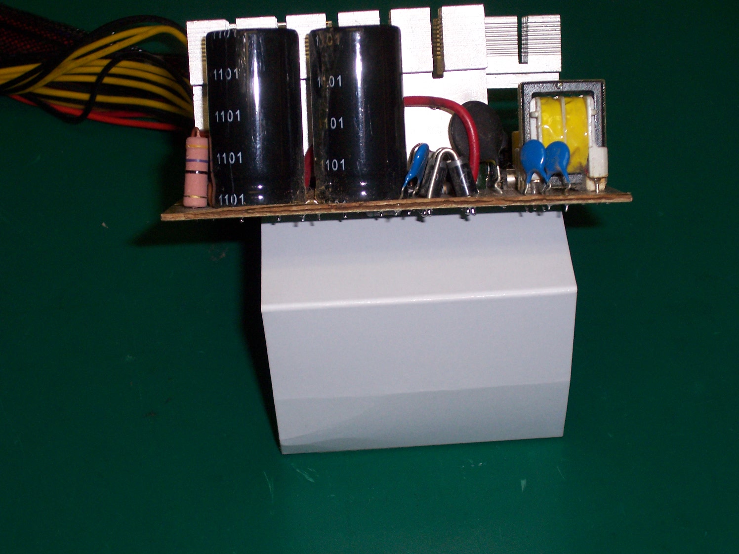

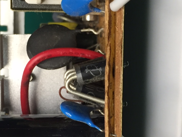

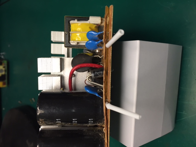

    Acquired a dead Coolmax model V-600. Powered it up, and sure enough it was dead. The 5VSB was OK, but everything else was dead. Removed the pc board from the metal box, applied power to start troubleshooting, and everything working OK. Hum....................
    Doing a visual inspection, I found that one end of the pc board was delaminating. That ought to be a quick fix. Just squirt some super glue between the layers and use a couple of clothes pins to hold it together until dry. But.........I began considering that crappy quality pc board material means that it will probably continue delaminating in other areas. NOT acceptable. So I have met my match and decided that this power supply is simply NOT repairable (unless you want to replace the pc board!). So this one will be used for parts.
    Old proverb say.........If you shoot at nothing, you will hit nothing (George Henry 10-14-11)

      Re: Coolmax unraveling
      Wow, that's a really crap PCB!
      Looks like heat is the cause of the de-lamination. (Well, that, and rubbish quality glue)

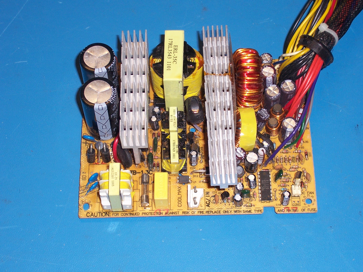

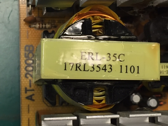

            What a bummer! I love those Sun Pro AT-2005B designs. I've probably recapped a dozen of them. Perform well and very silent. Should have some good parts to use!

                Considering they usually don't have too tall heatsinks,you can fit them in any generic 120mm PSU case
                It does have a nice case and fan. Perhaps I can find another IMicro to fix the pc board and put it in this case. Wouldn't that confuse the next person to work on it!
                      Originally posted by everell
                      This is the sticker I would use.
                      That label comes from this piece of crap, which makes a Sun-Pro or L&C look "top of the line" by comparison:
                        That happened to me with an old PSU that came from a Lenovo PC, don't know the manufacturer though.
                        I did the same, took everything I could use and throw everything else out the window
                            Yeah, the parts where quality ones and everything was good but because of the bad PCB it would not work all the time or just never after a while lol. The only disappointment was the 20a fast recovery diode but I think it can be useful some day so I kept it,
                            the fan was stuck that's why it died, it was really dusty inside that little case
