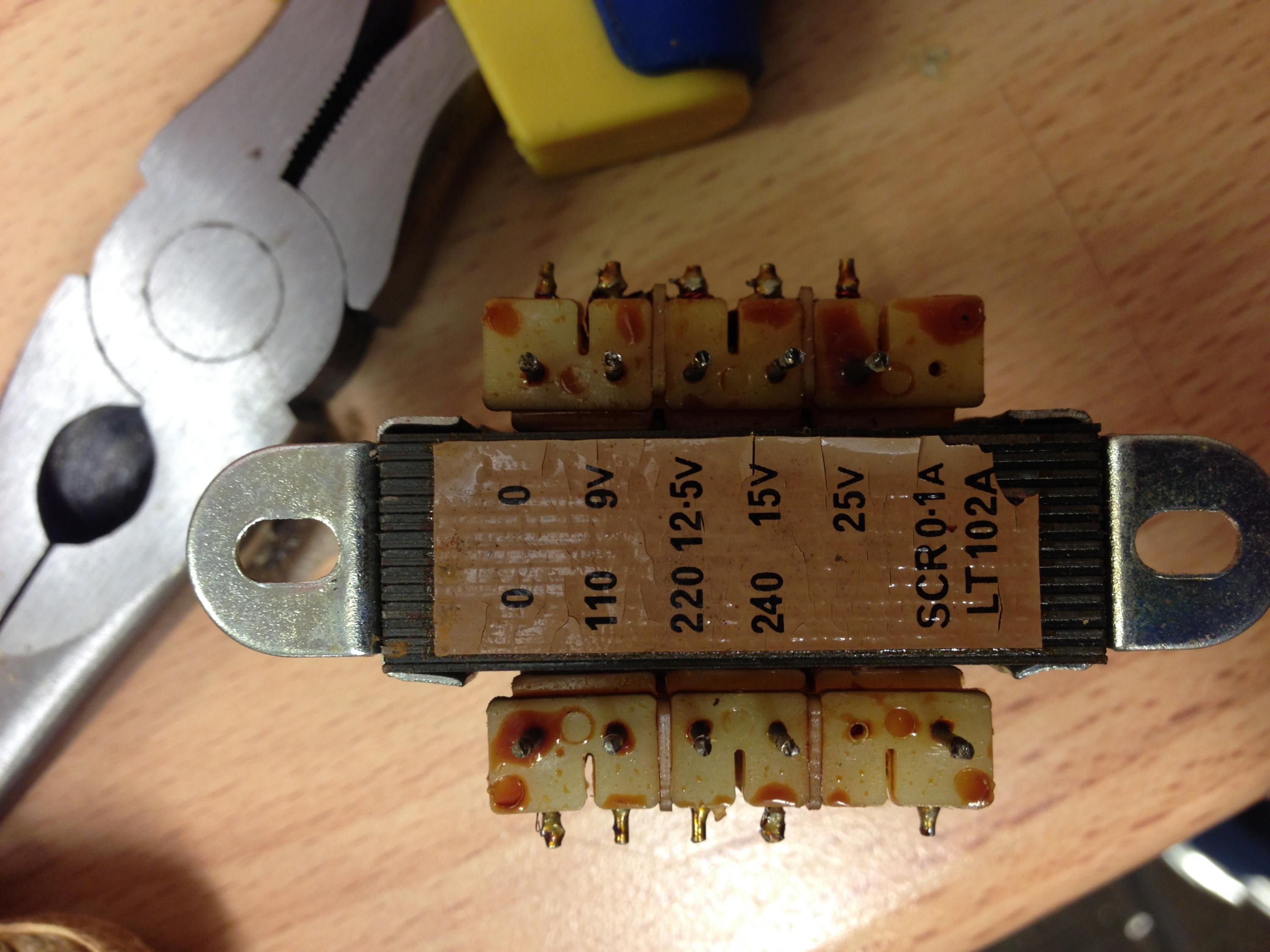

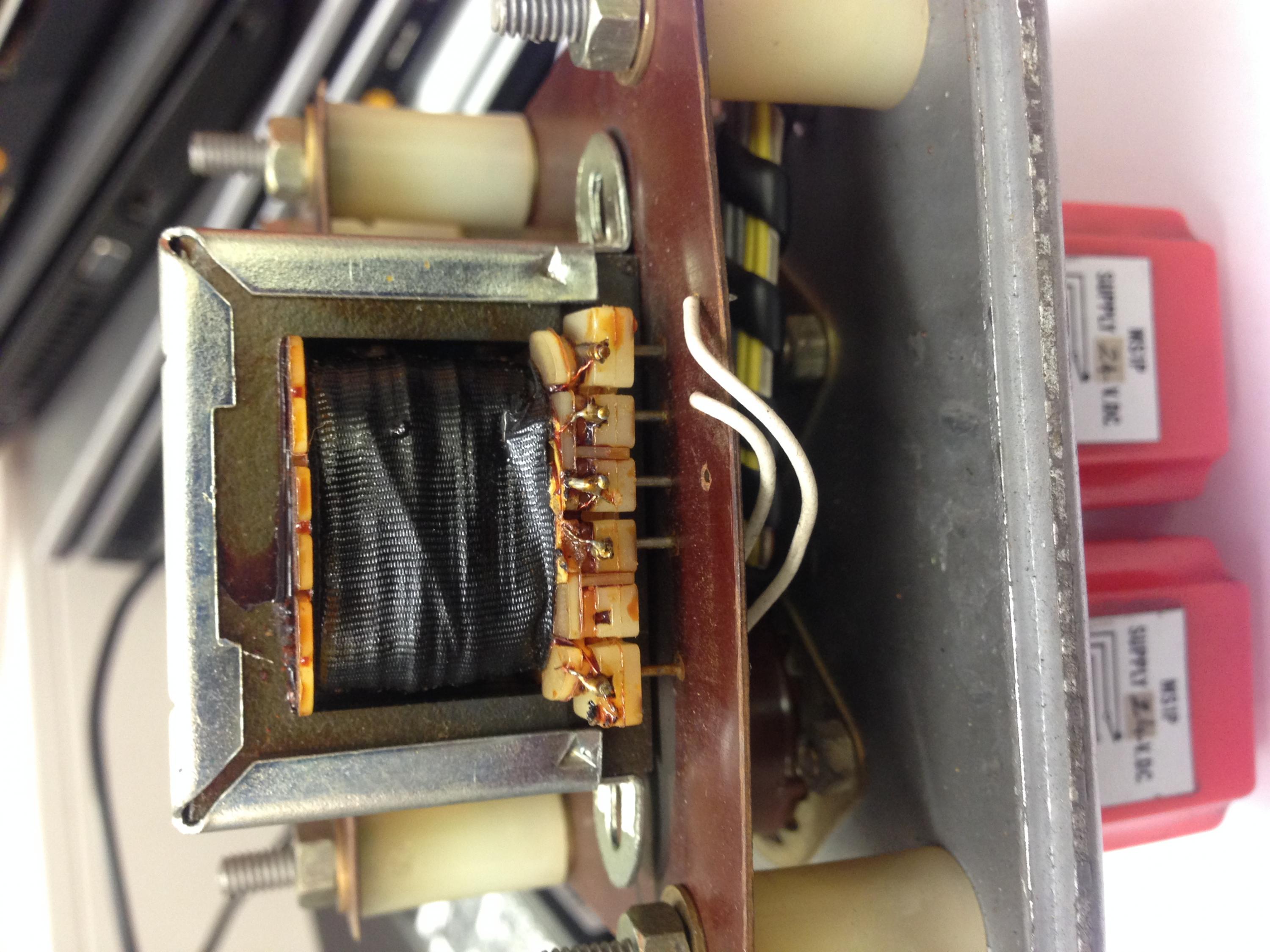

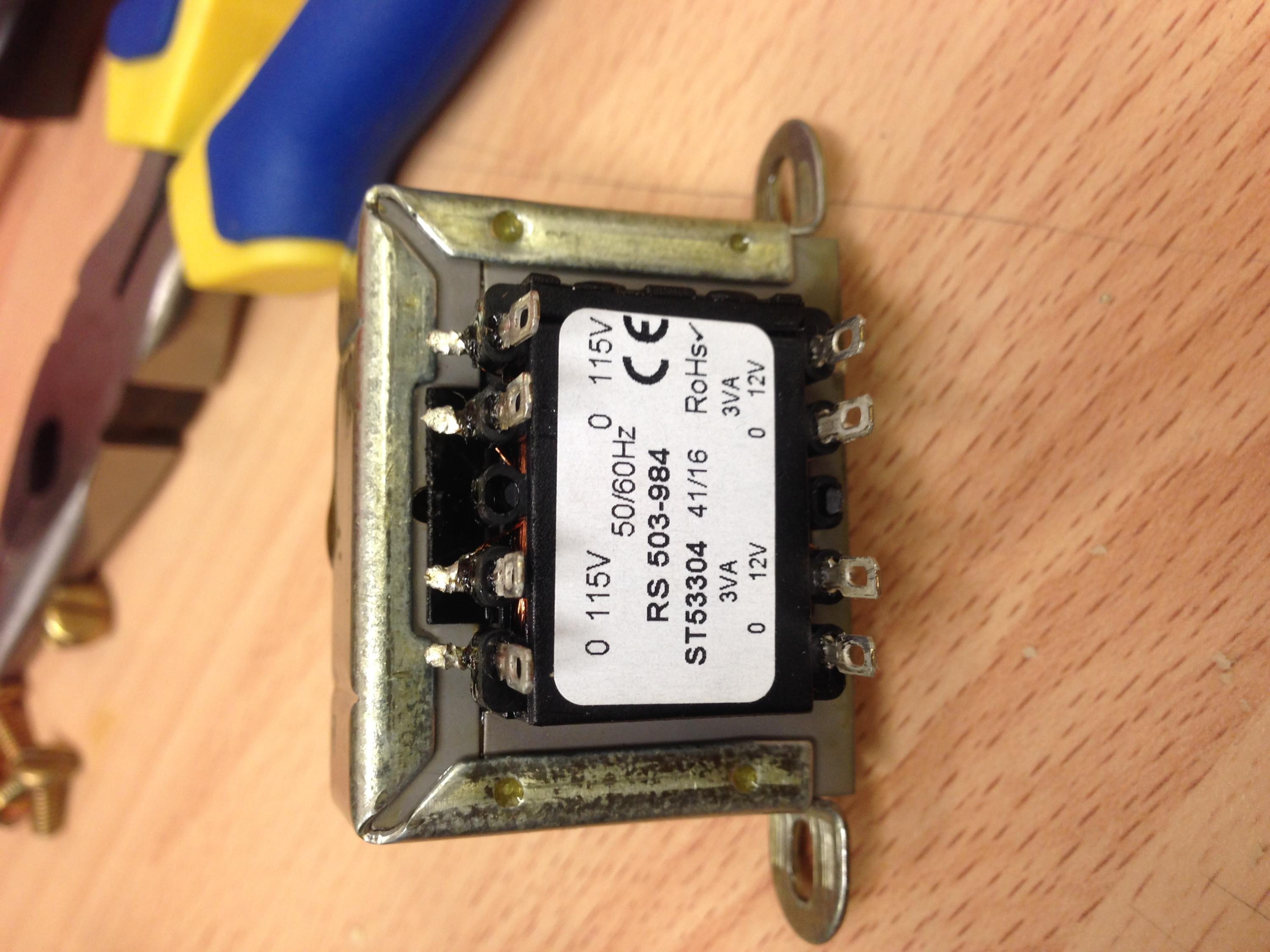

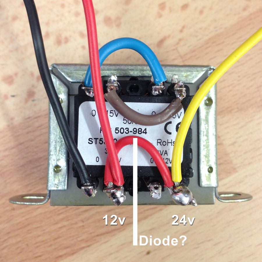

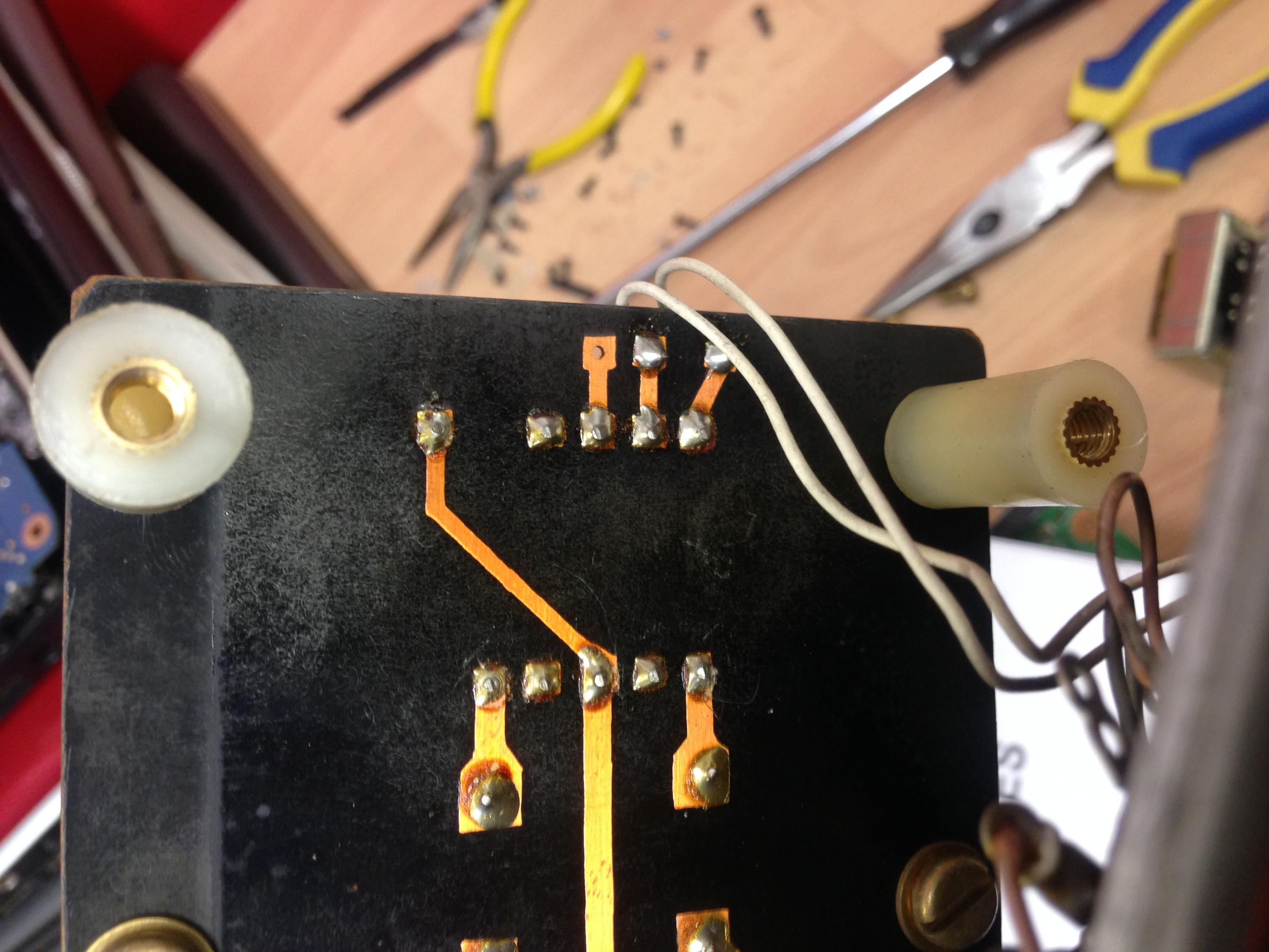

    Got this device to change a step down transformer. But Im not sure if this transformer that the customer bought is ideal.
    Image not edited:
    This is what I need to replace with the above pic:
    Based on the above, is there a similar 115v to 24v (12v on both pins)

    Re: Similar 115v to 24v Transformer
    it will do 120 or 240 input and 24v output.
    but you need to work out the original transformer wiring.

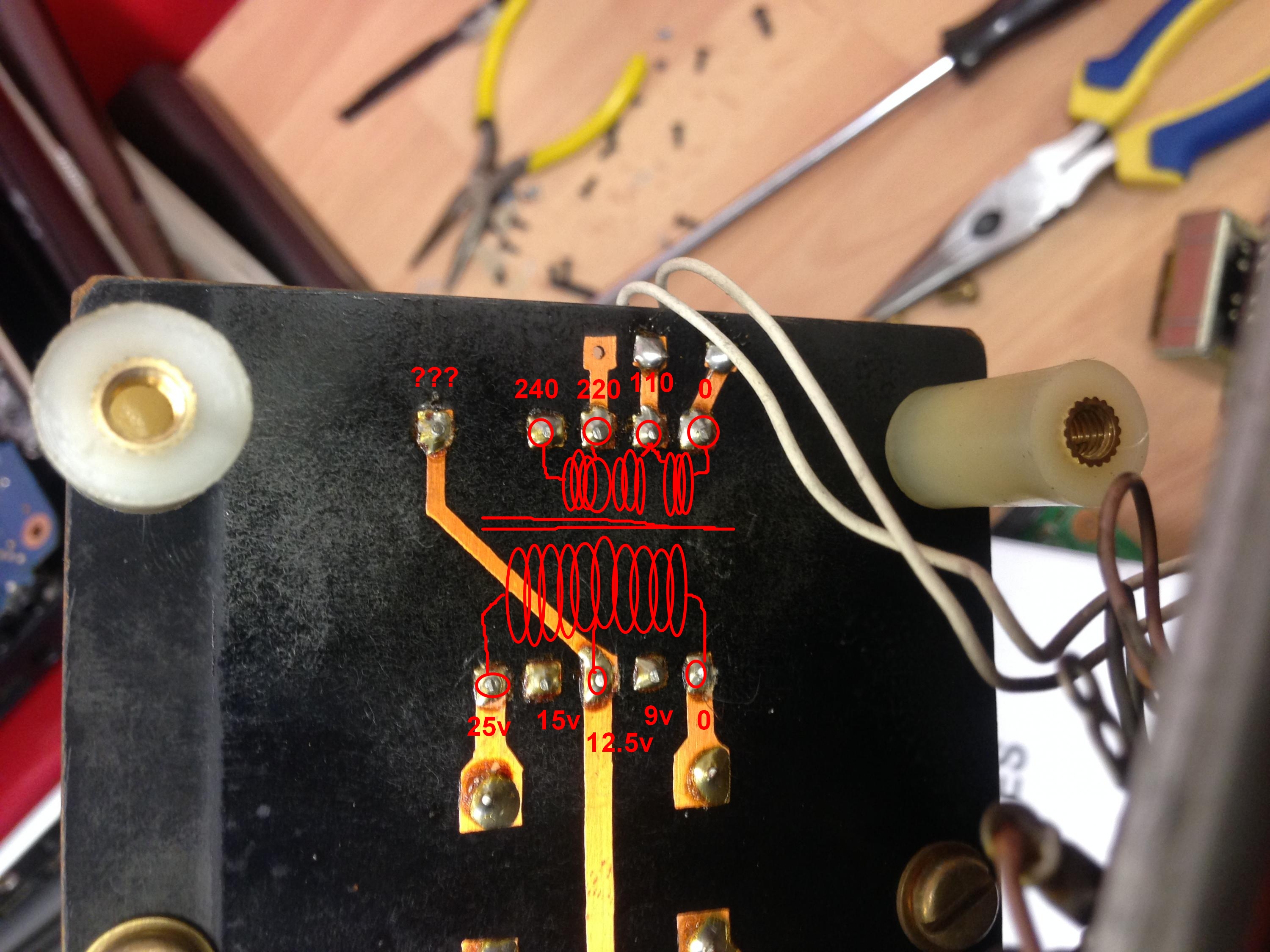

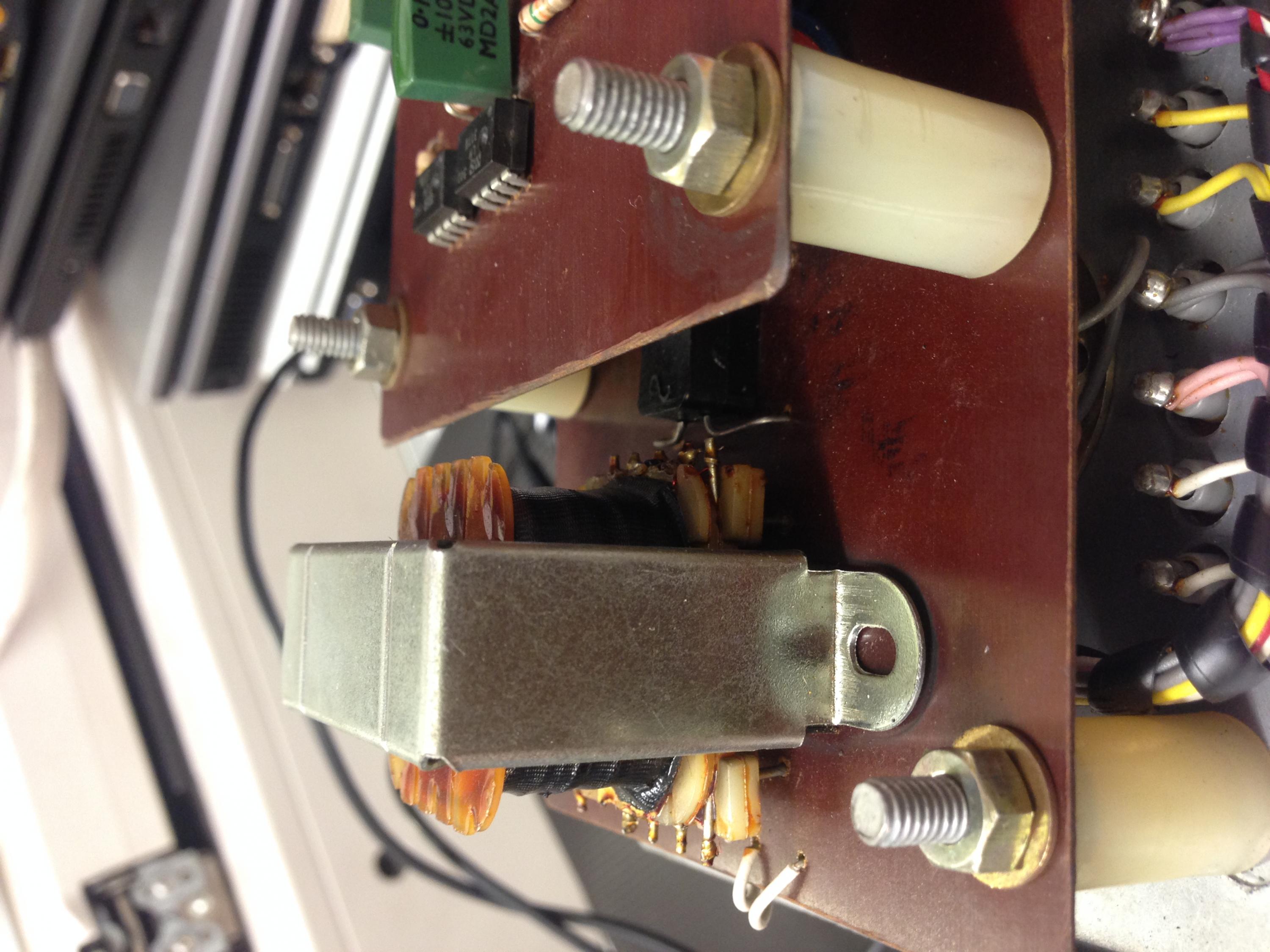

      Well... Ive desoldered the old and found this model:
      The 15v and 25v are in use. I cant even find that exact transformer.

      • eccerr0r
        Solder Sloth
        • Nov 2012
        • 8701
        Actually it looks like it's using the 25 and 12.5 pins, right?
        Then that other transformer probably will work just fine. Make sure you wire the primary correct, need to make sure the two primaries are in series in the right way.
        Are the two transformers similar in size at least? The "replacement" transformer looks very small. Also need to connect the secondaries in series as well.

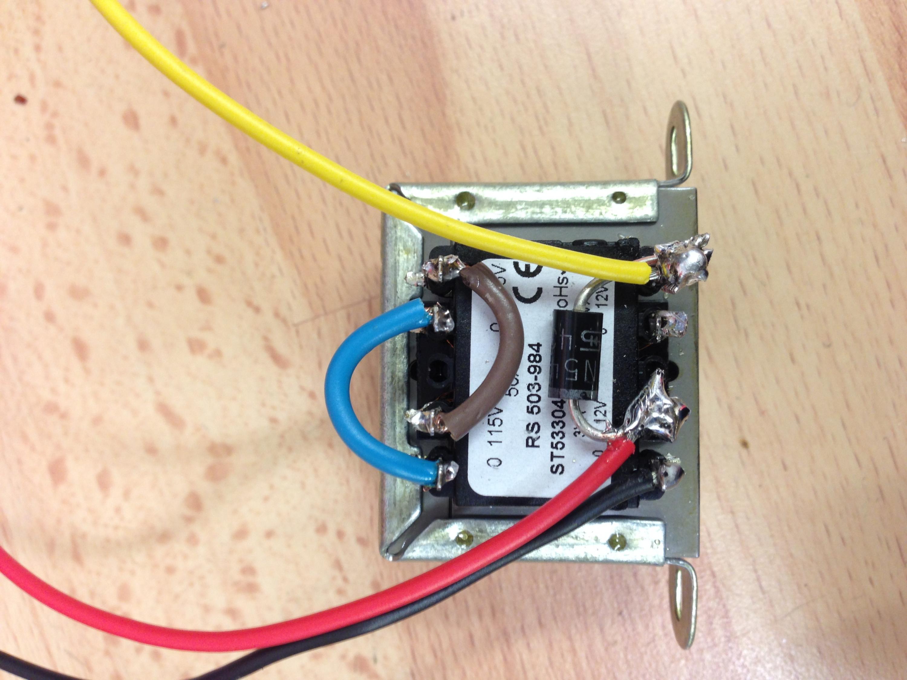

          Size not an issue. I ran into one: Ive solve the input of 115v but I cant get 12v and 24v output. Well... I get the 24v but how to get the 12v? As in image, that way makes both pins 24v. I may need a diode to prevent the current from returning. Which diode is best in this case? A 24v rectifier diode? Or any voltage above 24v?

            • 31163
            the red loop should be one tab left, not on the yellow.

              Not really. Joining those two reds I get 24v. So I added a diode which solves it:

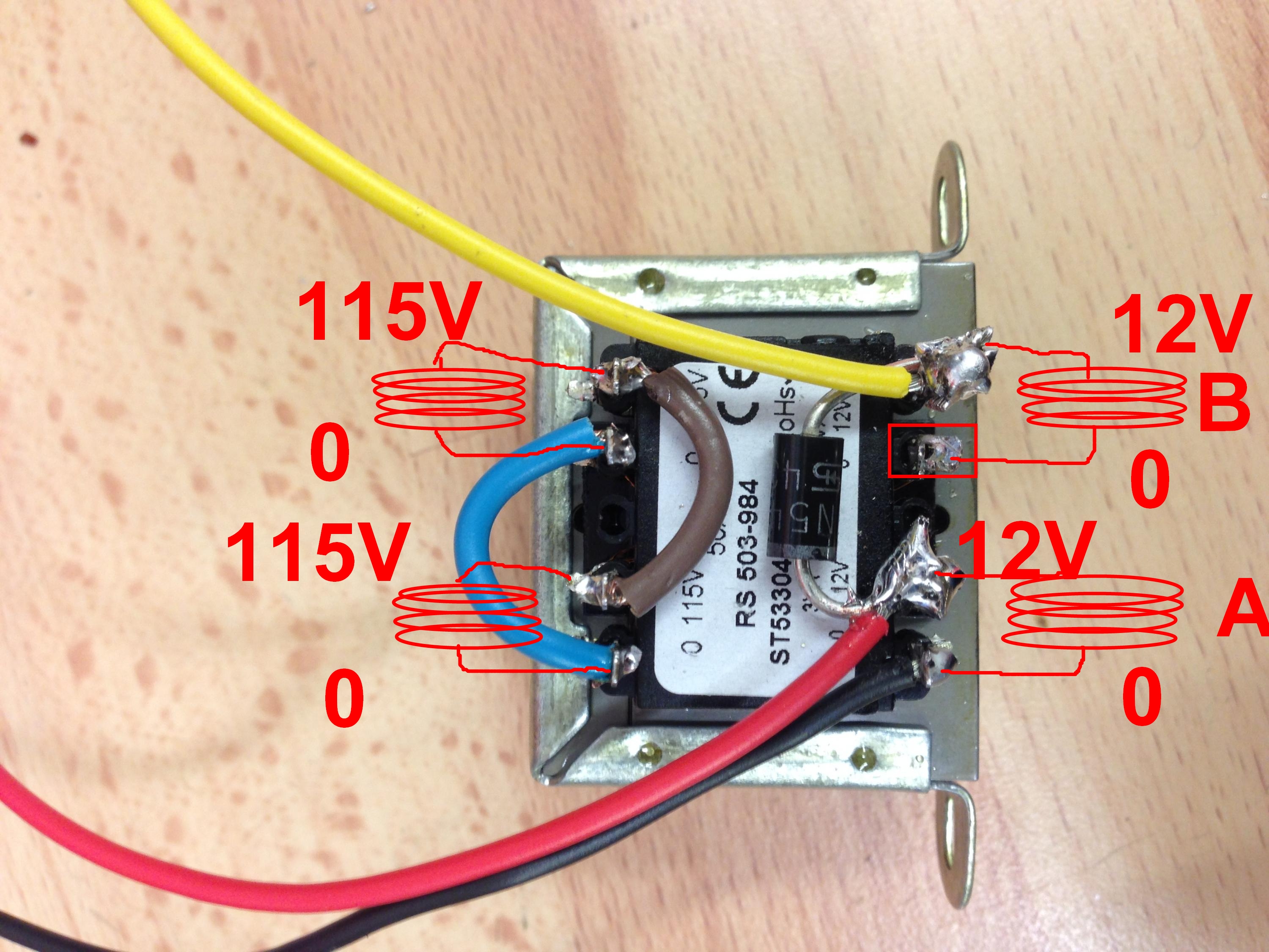

                • 31163
                no, that's wrong and not 24v anyway because the yellow wire is on a winding with one end not connected.
                you want: black to the first 0v, red to the first 12v, and link it to the second 0v then yellow to the second 12v.
                the link puts them in series so the second winding actually reaches 24v (12+12)
                  What is the added diode for, that is not right at all.
                  The cold side looks to be using 25VAC winding with center tap.
                      BTW, replacement transformer windings, the way you have it wired up you are only using one of the two 12V winding, the other 12v winding (B) is not being used at all.
                        The drawings on the images made it clear. Im not way into transformers but will make the changes when customer returns. Thanks.

                          I still do not understand where that diode comes from?
