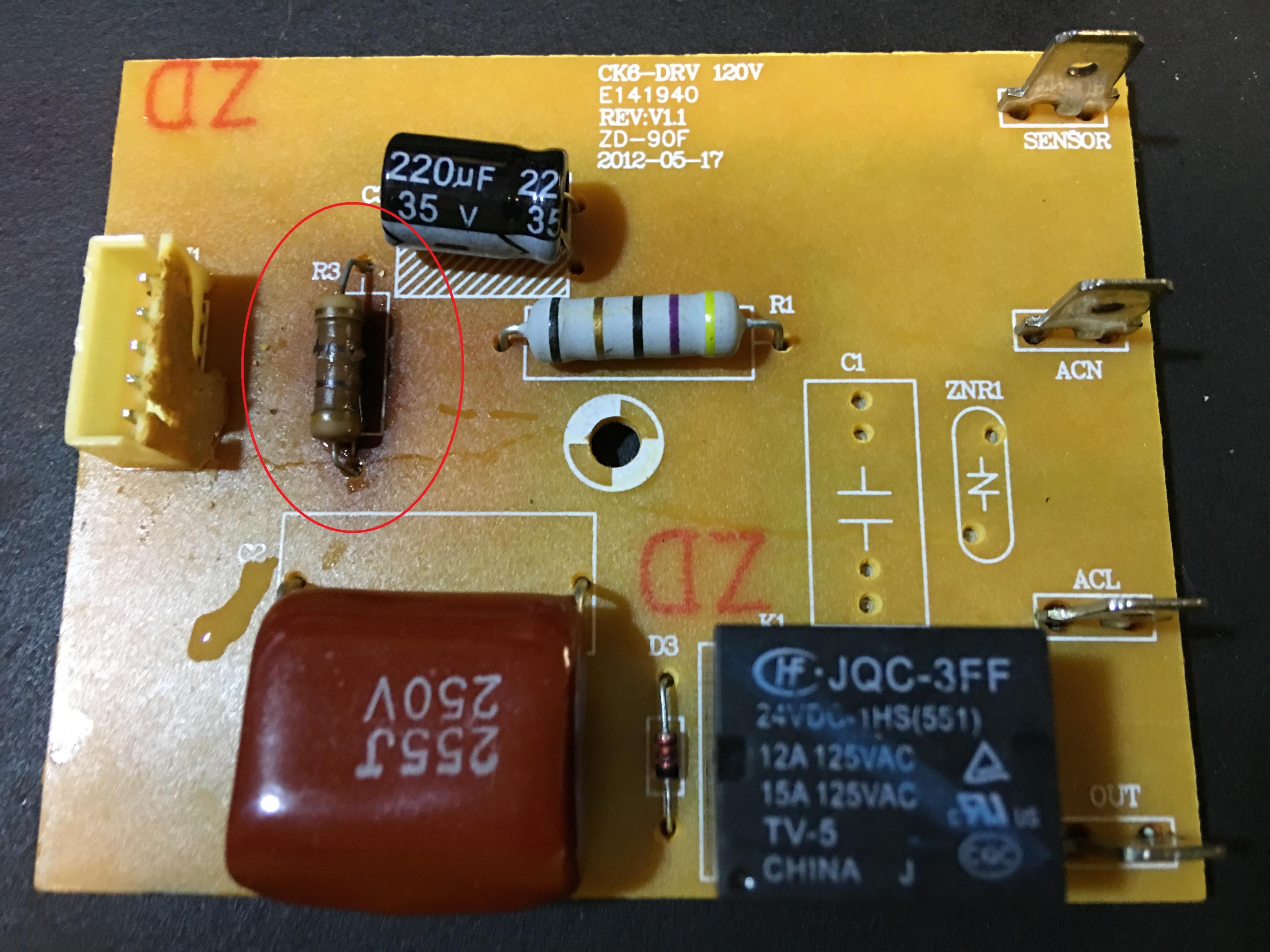

I know this is a weird question lol, but I want to repair this board that came out of my coffee maker. It just suddenly stopped having power. I took it apart and this is the only board in the coffee pot. it looks like it has a blown resister. I can solder a new one in there but I have no idea what to get to replace it with. Anyone know what that is? I circled it in red where its labeled R3. Thank you in advance for any help. Is there a fuse on this board? If so, where?
Mr. Coffee BVMC-TJX37-RB power board

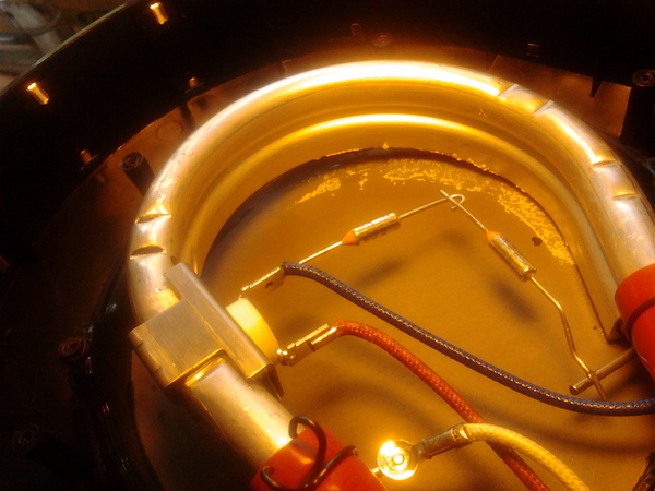

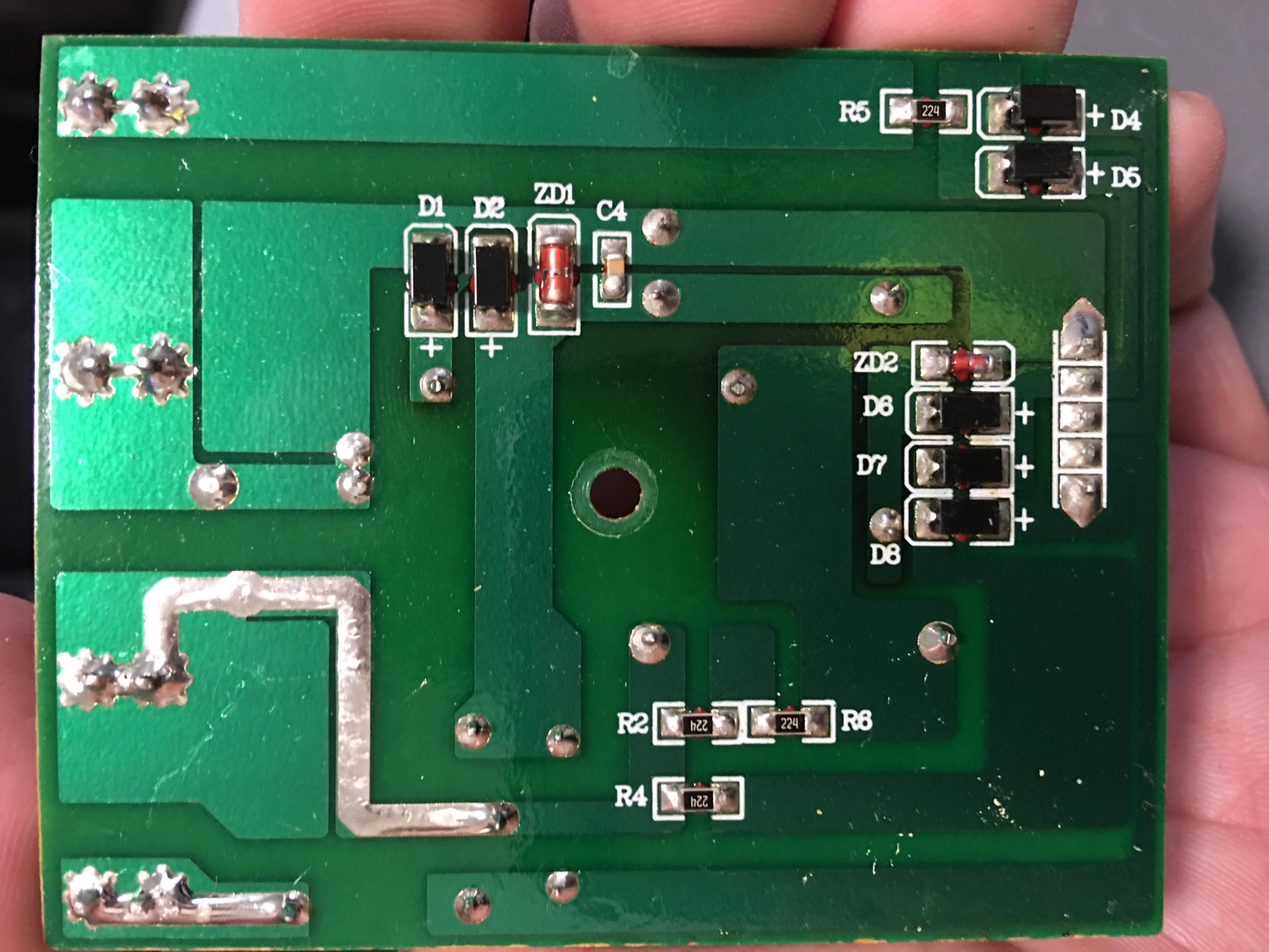

Post a clear picture of the other side of the board, that could help. There are usually thermal fuses located in the coffee maker that may have opened causing no power. In this picture there is a thermal cutoff attached to the tube and 2 thermal fuses in seriesLast edited by R_J; 10-02-2016, 12:12 PM. -

Did you measure that R3 resistor, it might be ok but just heat stressed, You might need to remove one end to get a good reading.
Do you get line voltage accros acl & acn ?
do you get any dc accross C4 Cap.?

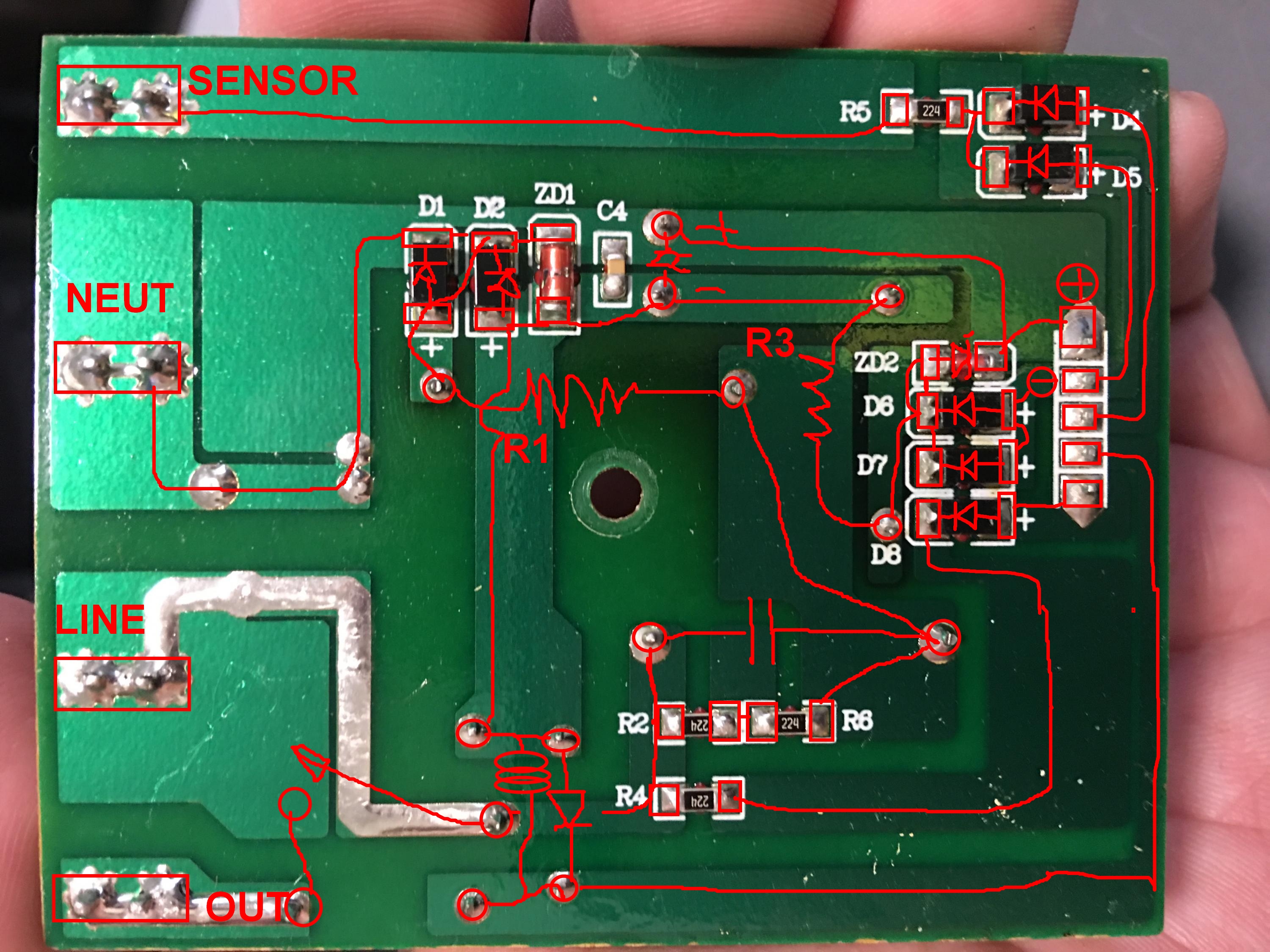

Looks like ac line comes through C2 and goes through R1, is rectified by D1 & d2, filtered by C4 and dropped to less than 35volts (maybe around 25 volts) by ZD1. It then passes through R3 and is regulated by ZD2 which must feed the processor board.
If you don't any dc voltage accross C4, unplug the white plug with the 5 wires and see if that voltage comes up.Last edited by R_J; 10-02-2016, 02:24 PM.Comment

To me it looks like a current limiting resistor this setup is use in LED nights it is very simple
you just need to know what the current draw of the controller and what ever else it powers
The best way to do this is if you have a variable power supply
Look at the caps around the power input of the controller board just make sure NOT go higher than voltage
This is to find out what your current draw do this carefully take your time doing this you can burn up the controller
Slow bring up your voltage until the controller powers ON and works the way it should
Then use Ohms Law to get what resistor you need to use
Just make sure to use 120 volt and what your current is
You might have to adjust the value of the resistor to have the right current value
Put the resistor value on the board and make sure that your voltage and current is the values that you need it, this is the voltage and current form your testing that you did
