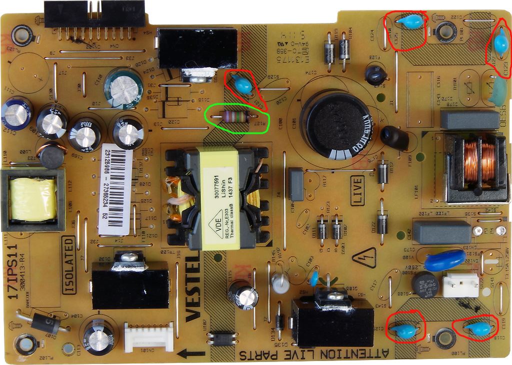

hello, i need help to id this resistor circled in green on this Vestel_17IPS11__rev4 i will include a photo, i cant id it as nothing comes up when i enter them colours none have a balck at ether end from what i can tell but this one looks like it does, also if anyone could id the 5 resin dipped caps, i think iv id them but not sure they are circled in red, thank you phil.

oh hi man nice to see you, ok ye the back lights did not work at all so i opened up and 3 leds had blown so i replaced and tested all worked, but when i now turn thre tv on it will flash the back leds on for a fraction of a second then there off, tv works and displays if i shine a light on it to see, i tested that resistor and those resin caps and none of them have any reading at all so i assume there the problem, but hard to id them.Comment

Hmm what is the Led voltage when it flashes ?Please Do Not PM My Page Asking For Help Badcaps Is The Place For Advise, Page Linked For Business Reasons Only. Anyone Doing So Will Be Banned Instantly !

it does the normal jump up to around 90 then falls off to around 24, the return does nothing until that the red wire power falls to 24 then the return shows 4 then slowly drops to 0 againComment

Psu is fine then buddy, the Leds you used might not have been the rating I thought and have burnt out.Please Do Not PM My Page Asking For Help Badcaps Is The Place For Advise, Page Linked For Business Reasons Only. Anyone Doing So Will Be Banned Instantly !

ok that makes some sense then, they do only light up when 3 volts is passed they dont light up if i try 1.5 volt but im new to this so watt must matter here then, i will strip it back down and test them again to see, in the mean time are those caps i mentioned and that resistor ok not having any reading even if i take them off the boardComment
