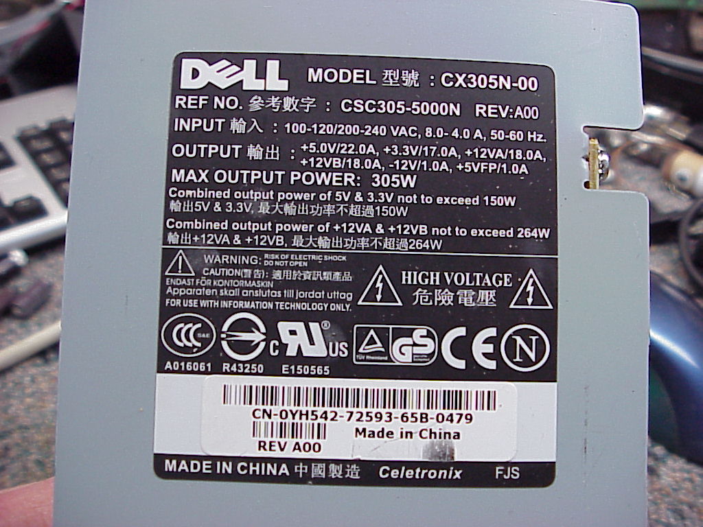

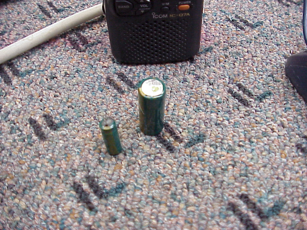

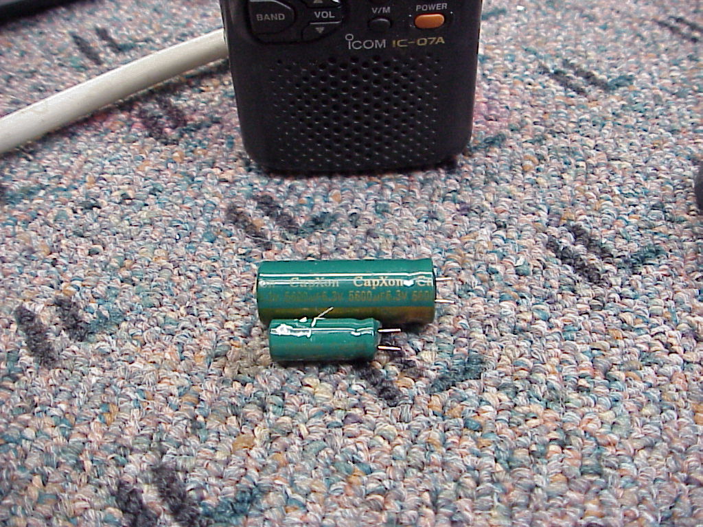

    this came from a dell unit that was in use about a year.
    i have a pile of these to fix that came from the same customer.
    full of capxon gf.
    which look identical to samxon gf i find often in lcd's

        I'm still finding these. Just replaced one today in a doctors office. When I got it home, sure enough, the 5600uF 6.3v and the 1000uF 10V CapXons were bulged and leaking. I pulled all the outputs (a mix of CapXons and G-Luxons) and replaced them with a mix of Panasonic FM, UCC KZE and Nichicon HM, cause that's what I happened to have on hand.
        All tested fine for capacitance and ESR except for the two that were bloated and leaking, but of course their days were numbered.
        PC exhibited the classic symptoms, wouldn't turn on intermittently, and finally wouldn't turn on at all, with a flashing amber power button. She's purring like a kitty now.

          BTW, it was a hell of a chore trying to squeeze 3 12.5mm Panny 3300uF 6.3v FMs into the space where the 3 G-Luxon 10mms were.

            Every one of those Celetronix Dell PSUs I've seen had bad CapXons on the secondary(usually the larger ones). Surprisingly the g-luxons are usually good.
