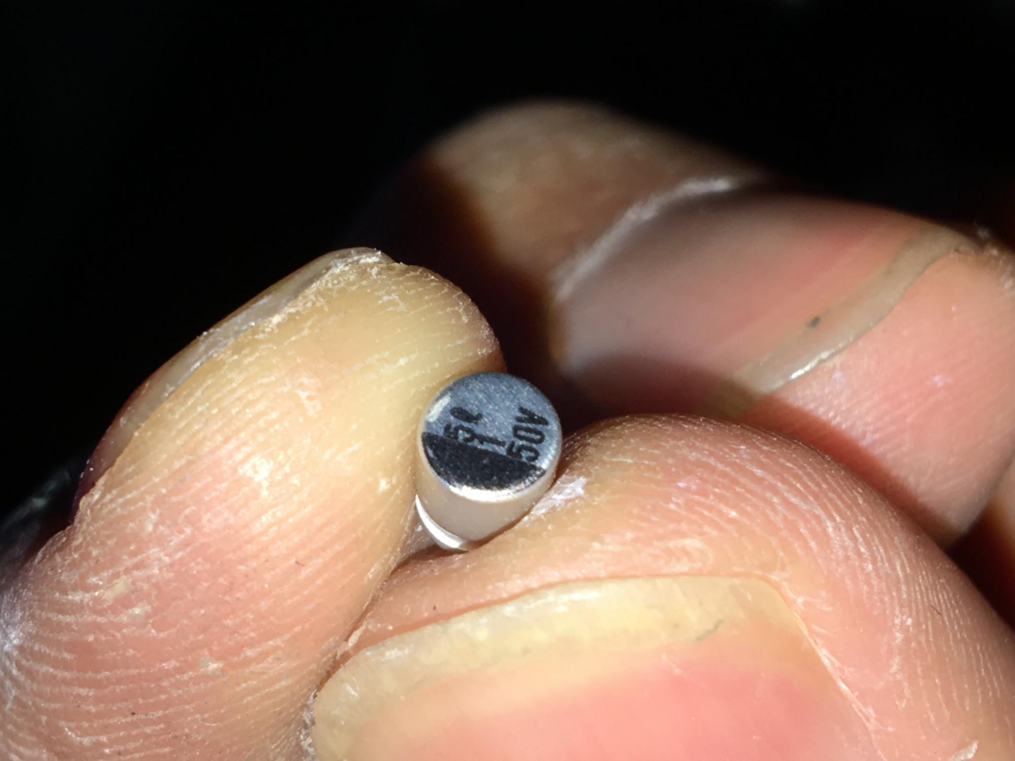

          I've accidentally broken a smd cap, just to make sure as in not sure is this a 1uf 50v cap?
          And can I just use a regular leaded cap to replace?
            • 31025
            Re: How to test a relay?
            yes.
