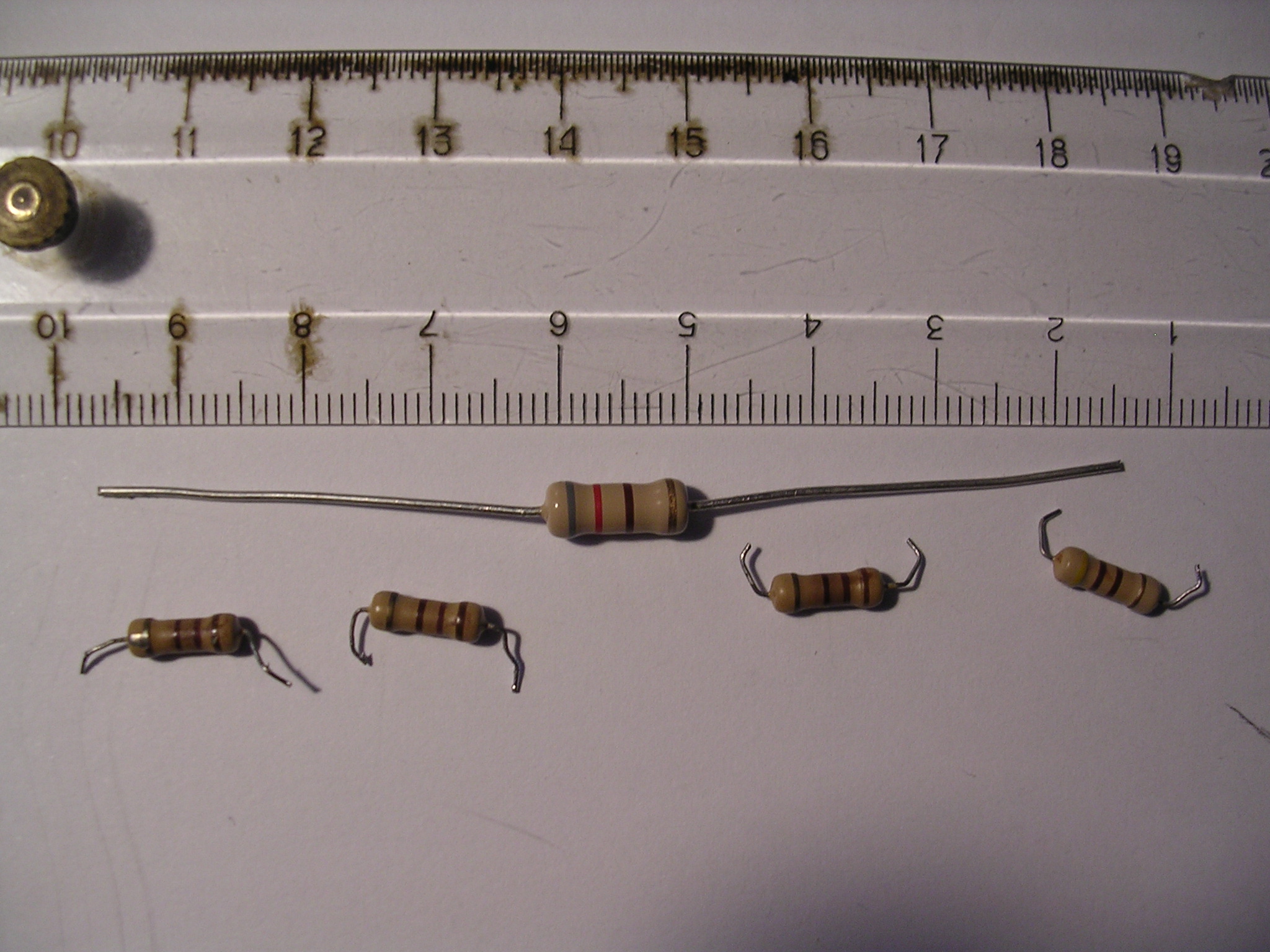

      Sorry for my delay in replying but I have been concerned in a slow recapping of ATX in my free time!
      So far I recapped four Power Supplies (and replaced their 12 V rail diodes) but I had the opportunity to test two only and the result is of course Solomonic. One had shortly failed (ATAPI error of the HDD) and the other has been stressed for 10 days of intensive computation and holds super. However, I believe that the statistics has to be extended to the other recapped PSU, maybe the failure of the former machine has been due to the Mobo or elsewhere.
      Momaka, as you suggested me, I also have been desoldering the resistors (see the picture), actually 470 ohm, since most of them have been baked enough for the colour bands to appear all as dark-brown ones :-) Anyway, the dissipating heat is 17x17/470 = 0.61 W which is 20% too much for a halfwatt resistor. Therefore I removed thm all (V = -11.5 to -12 V). I measured every voltage under a 21 W car stop bulb (see picture) connected to the 12 V rail only. Not so much indeed, but better than nothing.
      The other pictures are concerning the previous release of the ATX posted in this thread to recap. Here, there is the usual failure under intense load (ATAPI error #11 and #9). Based to the hints of my "teacher" Momaka, I now have some clue of my own about recapping and replacing the diode. Just let me post some questions:
      1. why did they put a 2200 uF 6.3 V cap in the 5VSB rail after the wattage in the specification is even lower with respect to the newer release (10 W vs. 12.5 W)?
      2. is there any concern about the presence of a central, small electrolytic cap between the fast diode and the two small transistors (I had to also replace a 0.25 W 10 ohm resistor - red ellipse - which was rather baked together the PCB)?
      3. what may the green spots on the ChengX cap black envelopes near the diode heatsink mean? I can see no exploded component, however.
      4. last but not least: how can one MEASURE the actual (instant) load of a PC to an ATX? I mean experimental readings, not average computing in some web sites. I begin to suspect that the PSUs simply can't afford the intense load of my computations!
      P.S. I am inspecting the Corsair VS450, which we had speaking about in a previous post. It's indeed full of CapXon and JunFu caps! I will be posting some pics since it's not yet clear to me which cap belongs to which rail.

            • omega

                              Good riddance with that load resistor! I think the heavy load on the 12V rail will keep the -12V rail voltage is spec too.
                              Even if that 470 Ohm resistor was rated for 1 Watt, 0.61 Watts is still enough to make it run very hot. A good rule of thumb for resistors is to dissipate no more than half of the rated power (so for 1 Watt, that would be 0.5 Watts). I guess the PSU manufacturers here weren't too concerned with that, though .
                              If the voltage were in spec with that 21 Watt car bulb on the 12V rail, chances are, they will be in spec when the system is loaded as well (provided the CPU isn't too much of a load on the 12V rail). Speaking of which...

                                  In fact, the scenario is worse than you painted (see pic). Those resistors are 0.5 W, definitely!
                                        *sigh* Built to fail, I suppose
                                        Not today, though - you fixed it

                                        Nothing out of the ordinary here. But I was wondering about that recapped PSU you put in one of the computers. Would really like to see how these PSUs do "in the field" after they are fixed.
