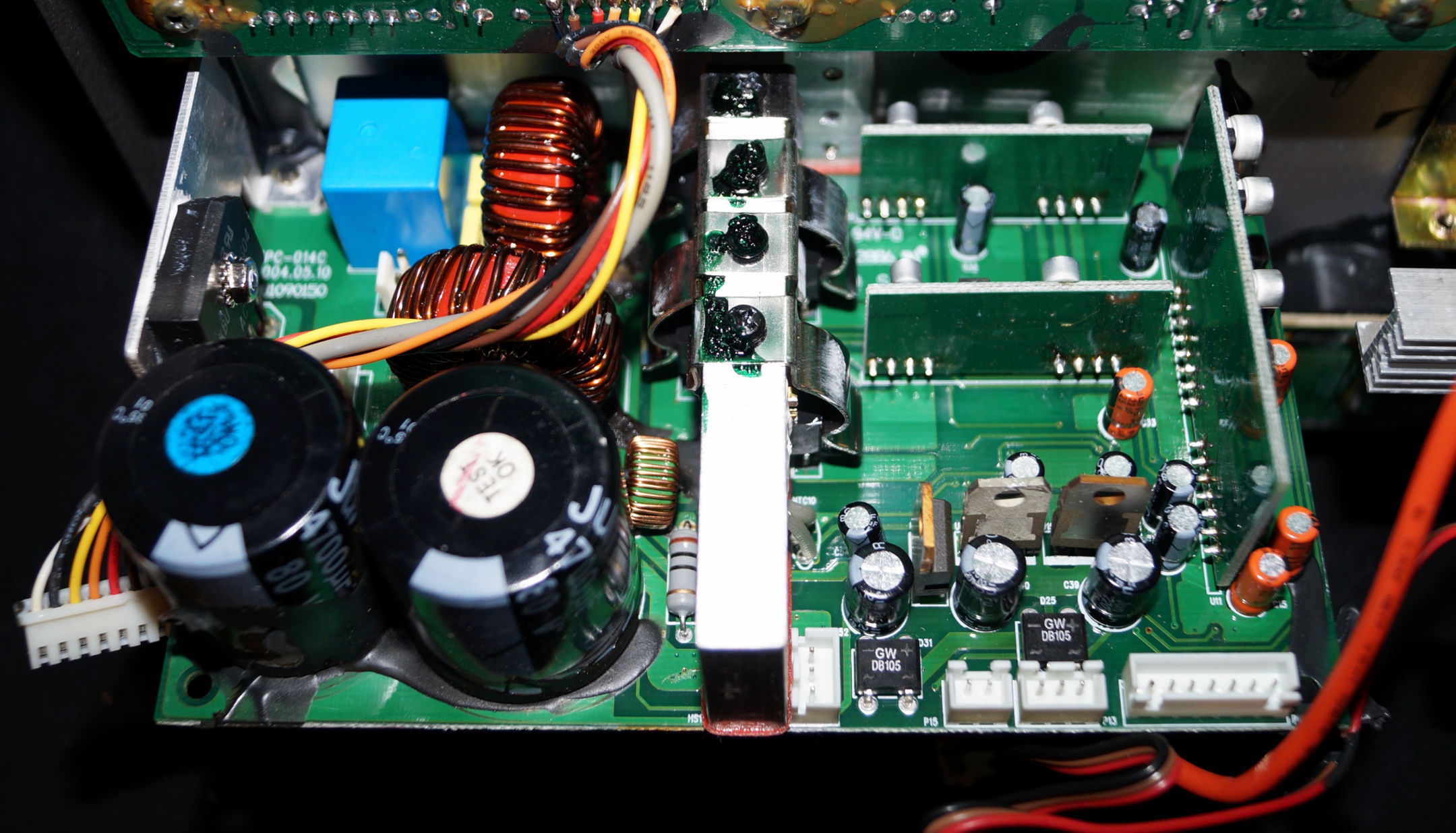

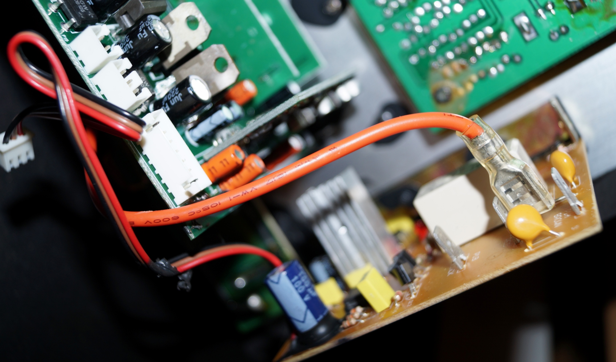

    ReCap on a Monitor Audio RSW-12 Sub
    Got this sub basically for free from a guy a bought some surround sound speakers off. It's a proper beast of a sub and sounds amazing.
    Its basically got a loud hum when powered on, a little hum in standby but mainly when powered on.
    Cracked it open and all Jun Fu caps and from what I've gathered from here is they last just about as long as the warranty does. Given sub is about 6 years old I suspect its the caps. Normally I would just cheap out and just replace caps that need replacing but I think this is worth a full recap and to be fair there aren't that many electrolytics in it.
    Don't want to change the main caps if I don't have to as they are expensive? if not will replace too. Anyhow these are the caps
    Jun Fu - 100uf 100v (HK105 0501)
    3 x Jun Fu - 220uf 25v (RB 0411)
    7 x Jun Fu - 100uf 16v (RB 0502)
    4 x Jun Fu - 22uf 25v (LL)
    Jun Fu - 2.2uf 50v (LL)

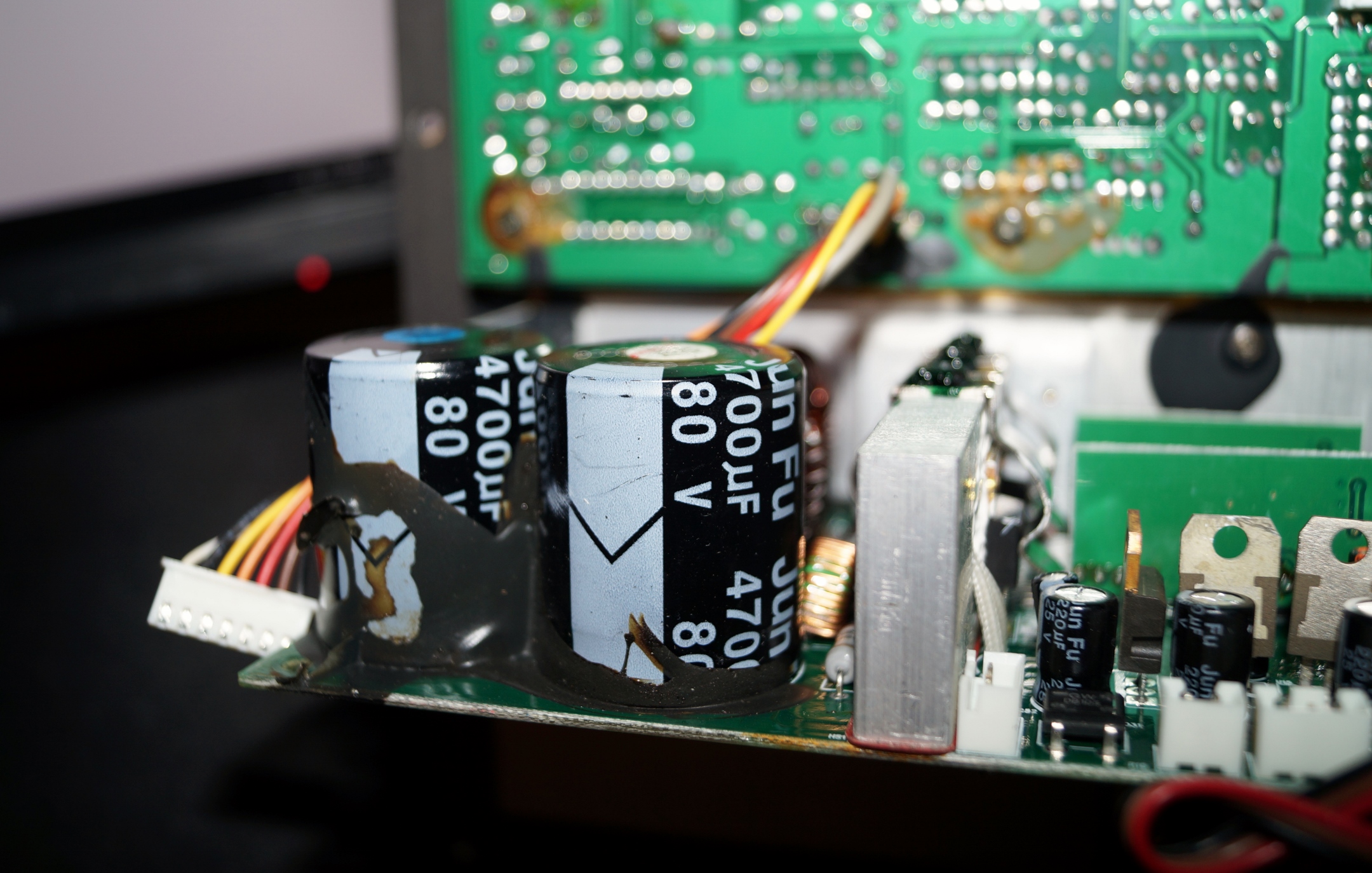

    Main Caps
    2 x Jun Fu - 4700uf 80v (LP 0501)
    Questions, will Panasonic FCs be suitable to replace these or do I need audio grade stuff? Or anything better.
    If I was to replace main caps what caps should I use, are the main caps just regular caps or are filter caps a different type?

    replace everything under 80v with panasonic FR
    the others will need to be worked out.
    you should probably post the diameter and height of them and if they use 10mm spaced snap-in terminals

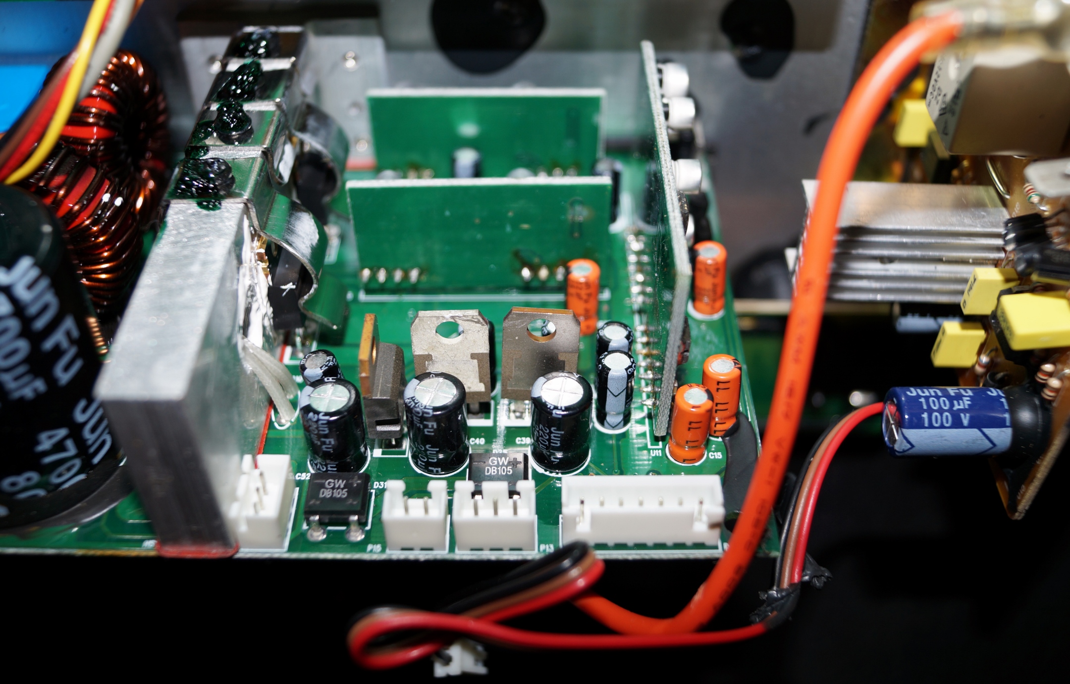

            Jun Fu - 100uf 100v (HK105 0501) 10mm x 20mm
            3 x Jun Fu - 220uf 25v (RB 0411) 8mm x 12mm
            7 x Jun Fu - 100uf 16v (RB 0502) 5mm x 12mm
            Jun Fu - 100uf x 25v (RB 0503) 6mm x 12mm
            4 x Jun Fu - 22uf 25v (LL) 5mm x 12mm
            Jun Fu - 2.2uf 50v (LL) 5mm x 12mm
            Main Caps
            2 x Jun Fu - 4700uf 80v (LP 0501) 30mm x 36mm

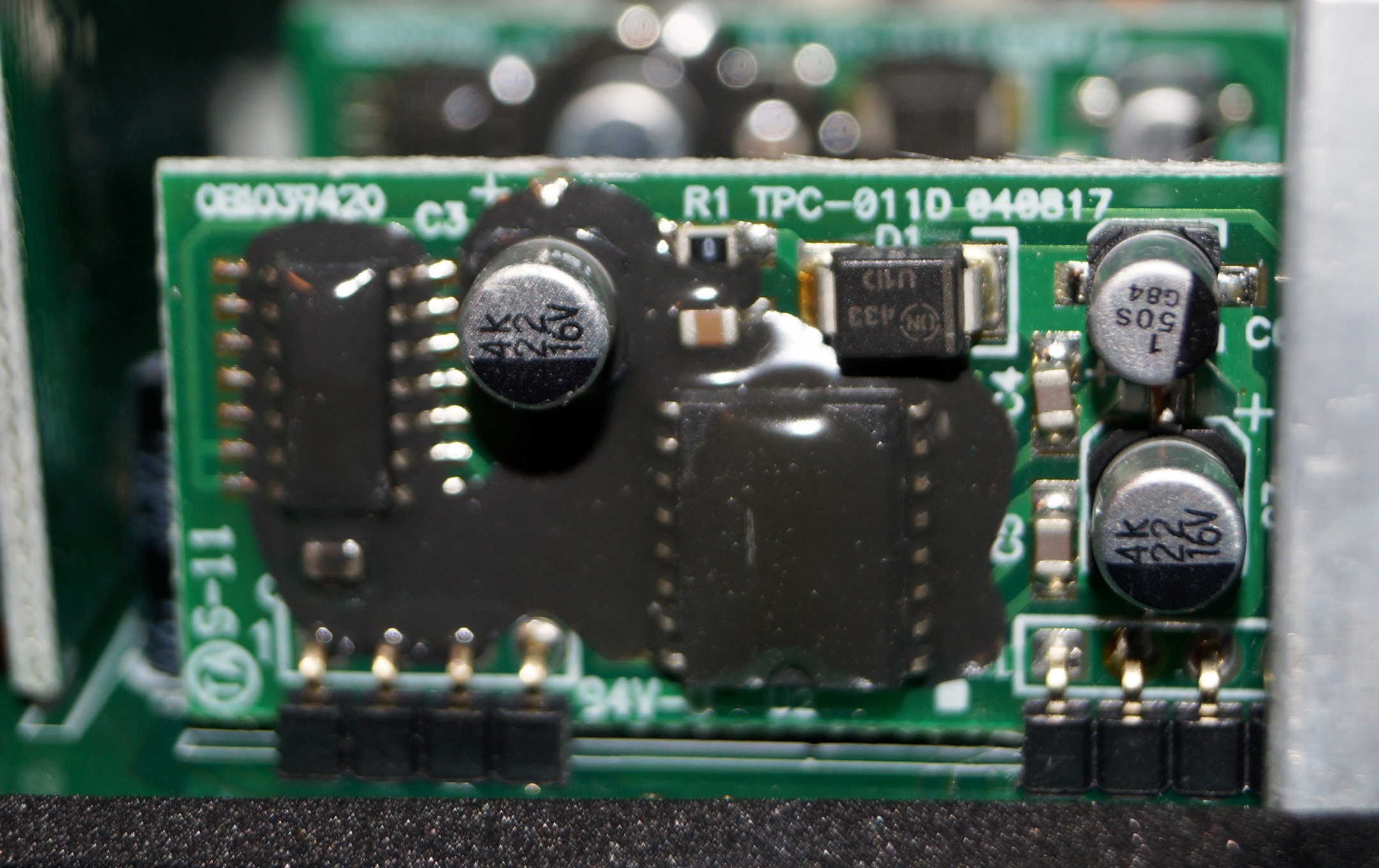

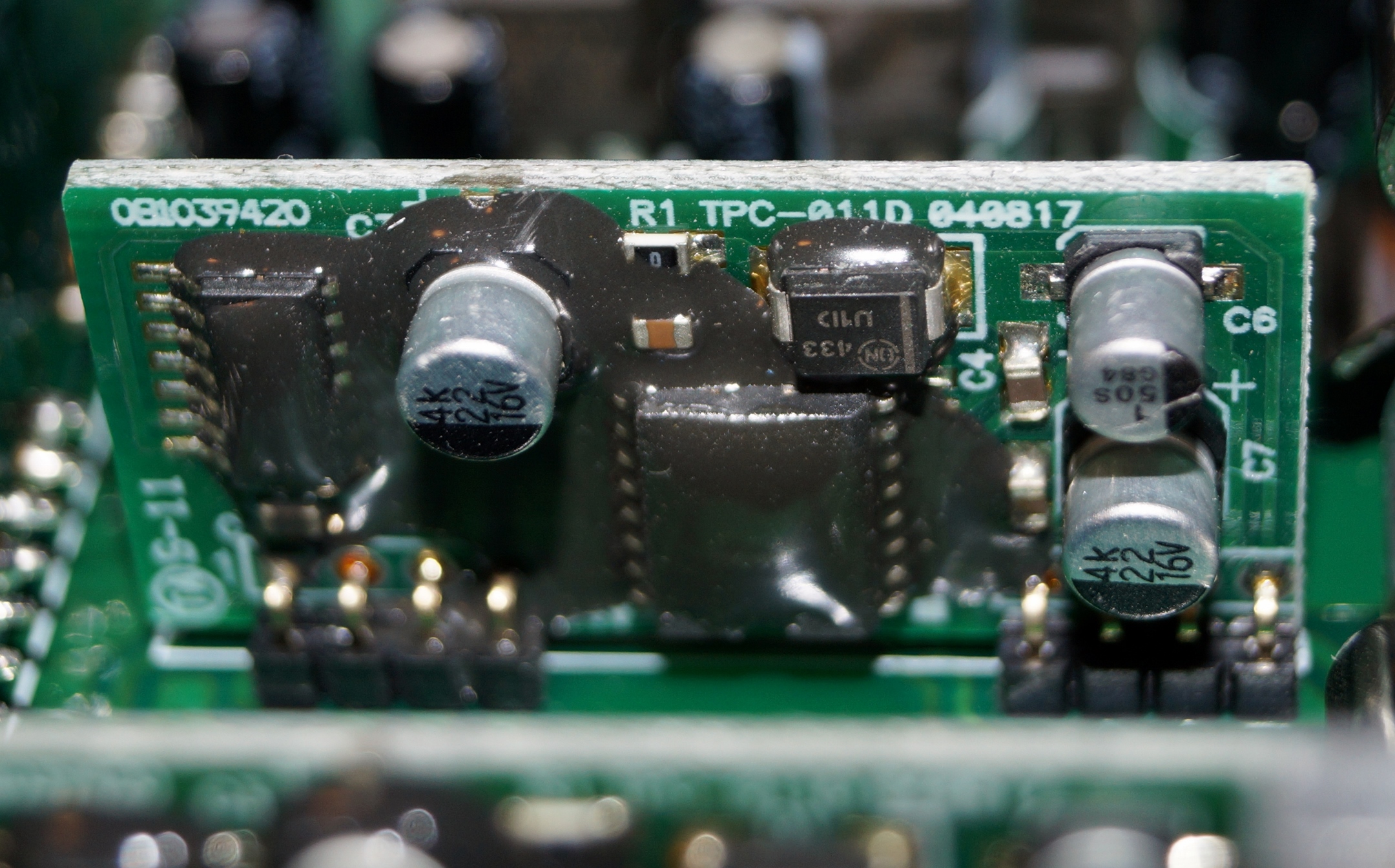

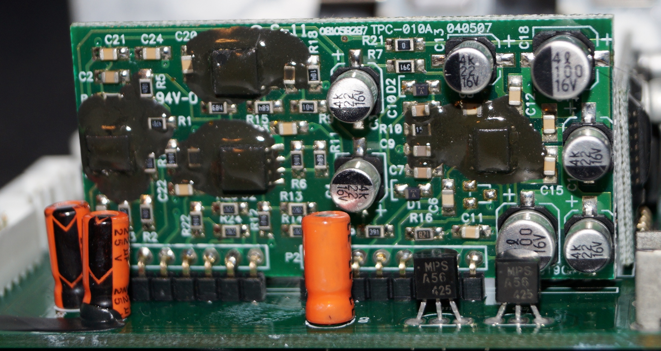

            Surface Mount
            9 x 4k 22 16v
            2 x 4& 100 16v
            2 x 1 50s G84
            I'm not gonna mess with the surface mount caps, that a bit past my technical ability at the moment.
            Also has 4 x 470nj100 yellow rectangle caps? Seems they are correction caps. Are these worth changing too?

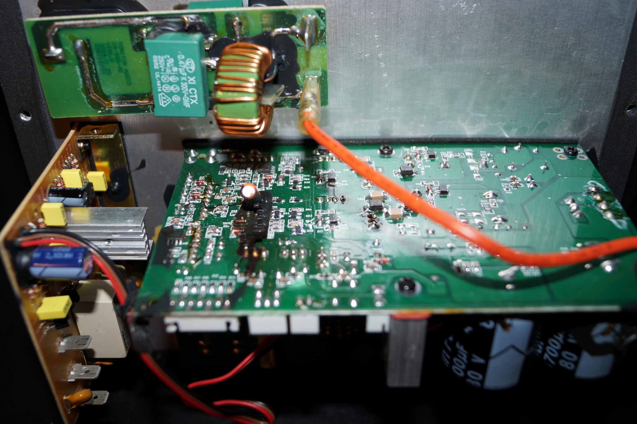

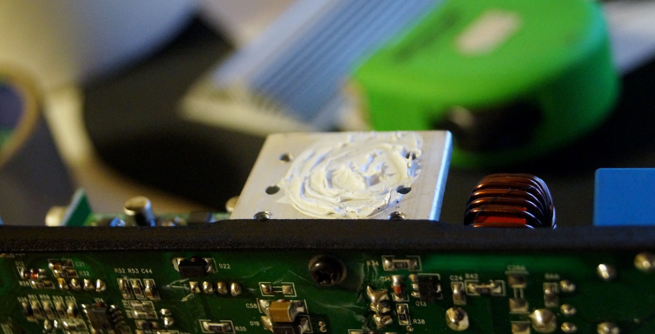

              Not impressed with how thermal paste is making contact with heatsink. Not even spread, cant imagine it would be transferring heat away efficiently.
              Some shots of the board with the surface mount caps on. Out of my league changing those. But will do the others first and see how it goes.

                  looks o.k. dont bother with the film caps

                    Would the surface mount caps be as bad condition wise as the junfu stuff?
                    Any tips on how to do these, I might just order some. Only just do the JunFu caps first and if the fixes it will leave the others. If not will change the SMD caps too or attempt to anyway.

                                      The large capacitors should be replaced too, they do most of the hard work. If there is room, there will be no harm in going for a higher capacity value, it will give more reserve headroom for those long bass notes or explosions.
