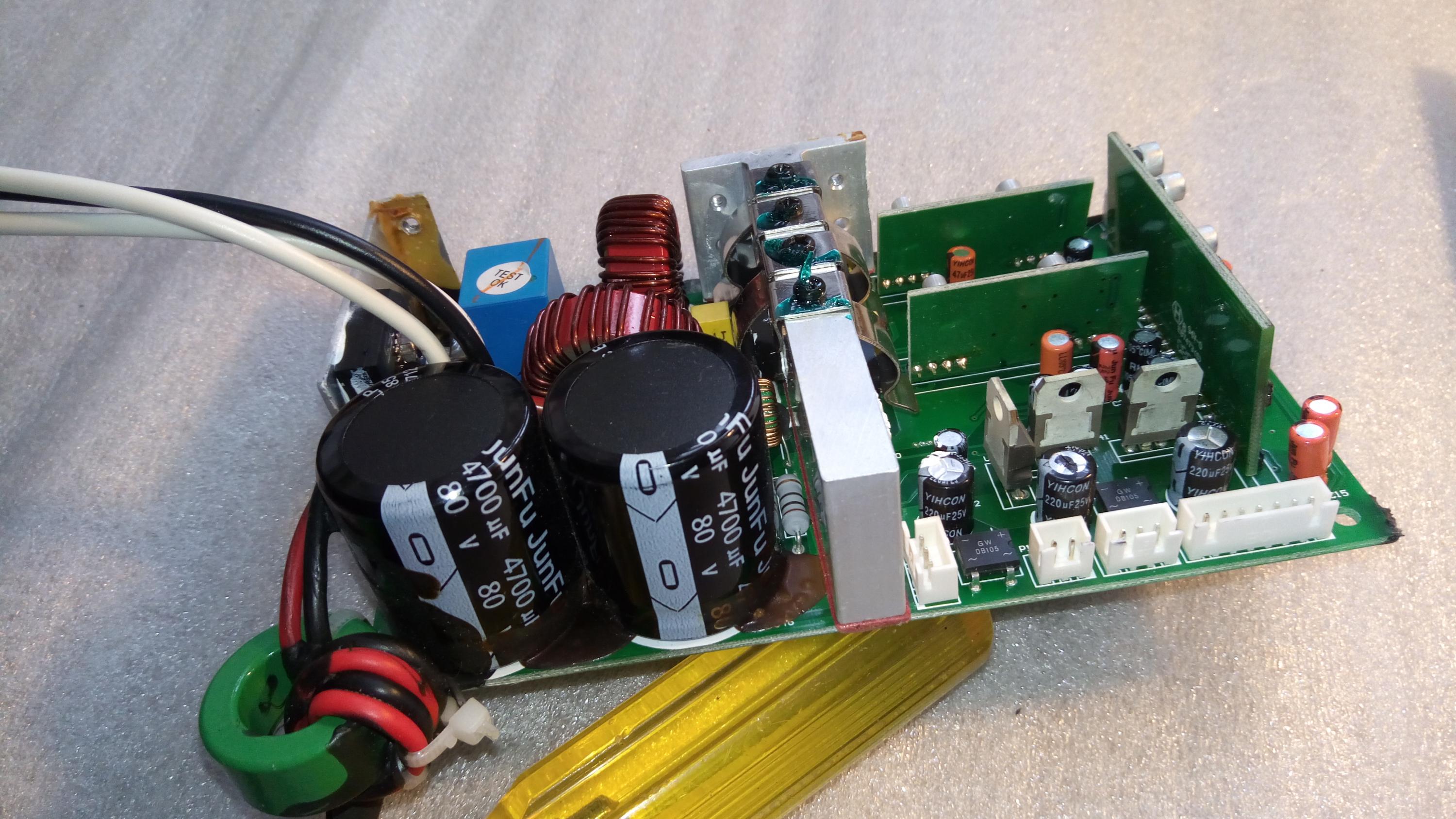

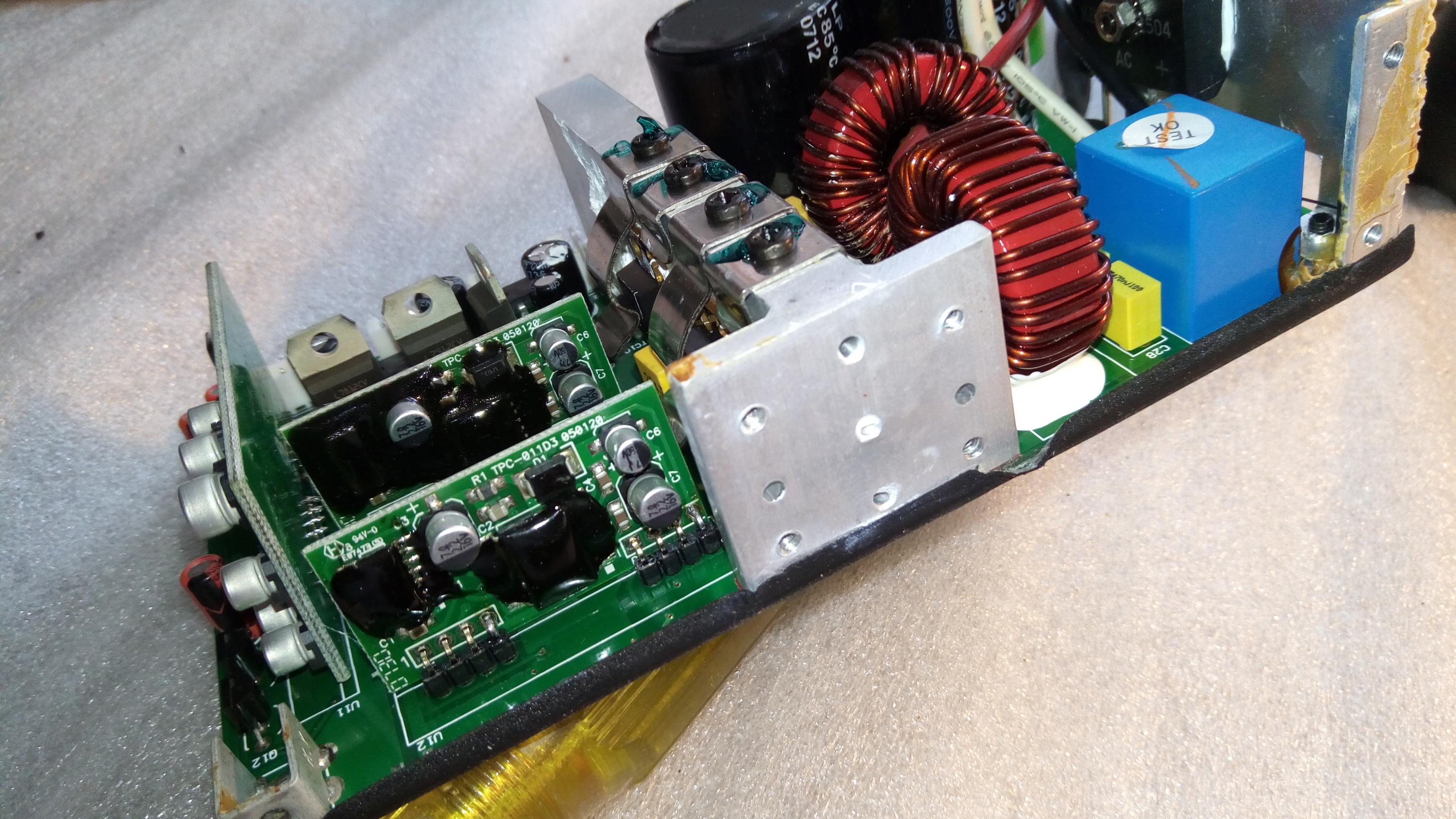

What you should be asking is how powerful. A small iron turned up really high will not work, it will just burn things. You also need to add fresh solder when desoldering, to aid in maximum heat transfer. Your iron needs to be clean. Preheating the board with a hot air tool or a hairdryer can help, if your iron isn't powerful.
It is a dual-layer (at least) board going by the photos, so that will make it harder.
I assume you are having problems trying to repair one of these yourself. Post what your soldering iron is etc
