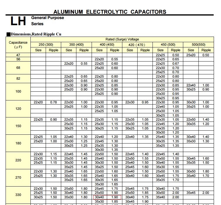

        ok back to topic, original cap has 1.9 ripple and the one i listed has 1.44 does it matter?
        I can get it much cheaper. But its always the same…you dont need it so foten after all, you need it fast, you whatever. So I invest at least 500 bucks in that, than sell 10 pcs here and keep the rest on stock for 5+ years till I sell it out finally…nah, not really. You want, than buy it overpriced.
        What series is that teapo crap? I can find no 330/400 with 1.9 A RC.

          Re: OCZ 700 Watt Bug Zapper Recap & Repair
          LH
          also can someone explain me why it's ok to go with a 390 uf instead of 330, i always read that you should stick with same capacitance when replacing a capacitor
            Oh I see, noticed just the 1.75A version.
            You can go with 390 just fine, you'll get less stress on PFC silicon and longer hold-up time. But the cheapest seems to be https://www.digikey.ca/product-detai...965-ND/3986864, for 390 https://www.digikey.ca/product-detai...1663-ND/483261

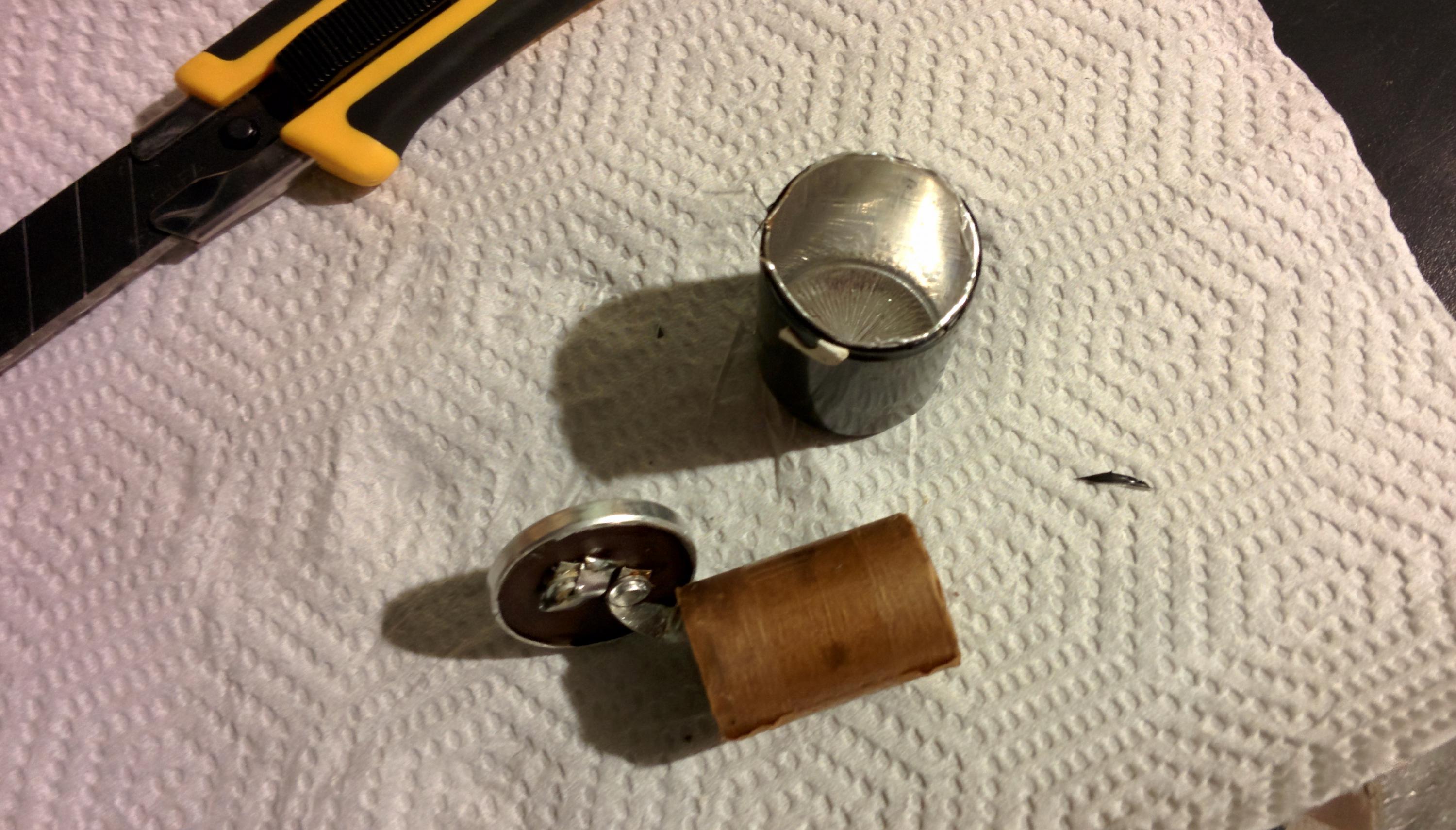

                          • Per Hansson
                            • Jul 2005
                            • 5895
                            • Sweden
                            #33
                            Please dissect the capacitor and post some pics of it's innards.
                            I guess a capacitor that has dried up completely inside could rattle around a bit.
                            Still it should be a minimal difference vs a cap filled with electrolyte...
                            Never seen or heard of something like this before so I'm curious

                                        #39
                                        here it is
                                        i think it was the paper roll that was moving inside
