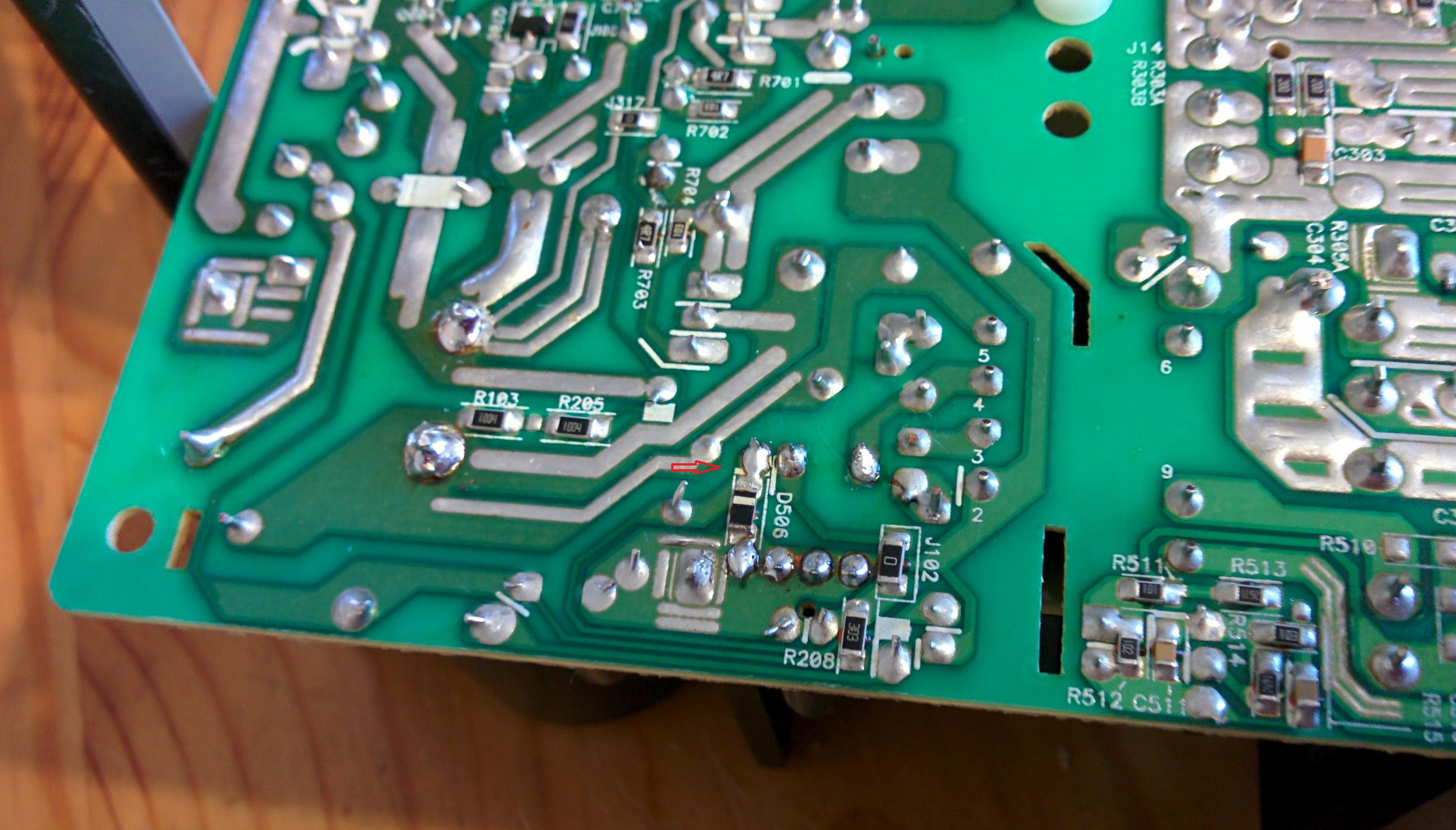

              #46
              Re: OCZ 700 Watt Bug Zapper Recap & Repair
              here's a picture of the regulator i soldered yesterday
              can someone tell me if i fucked up, on the red arrow i notice i made a connection between the diode and the regulator leg,
              what does the white line underneath means (no connection?)

                #47
                I think it should be connected, otherwise the pin would be severed from the rest of the path. According to datasheet it is drain, those four common are source. But the diode may have been already bad. Or something else. Now when it exploded you have to check every component in that circuit, something else may went bad during the blast.
