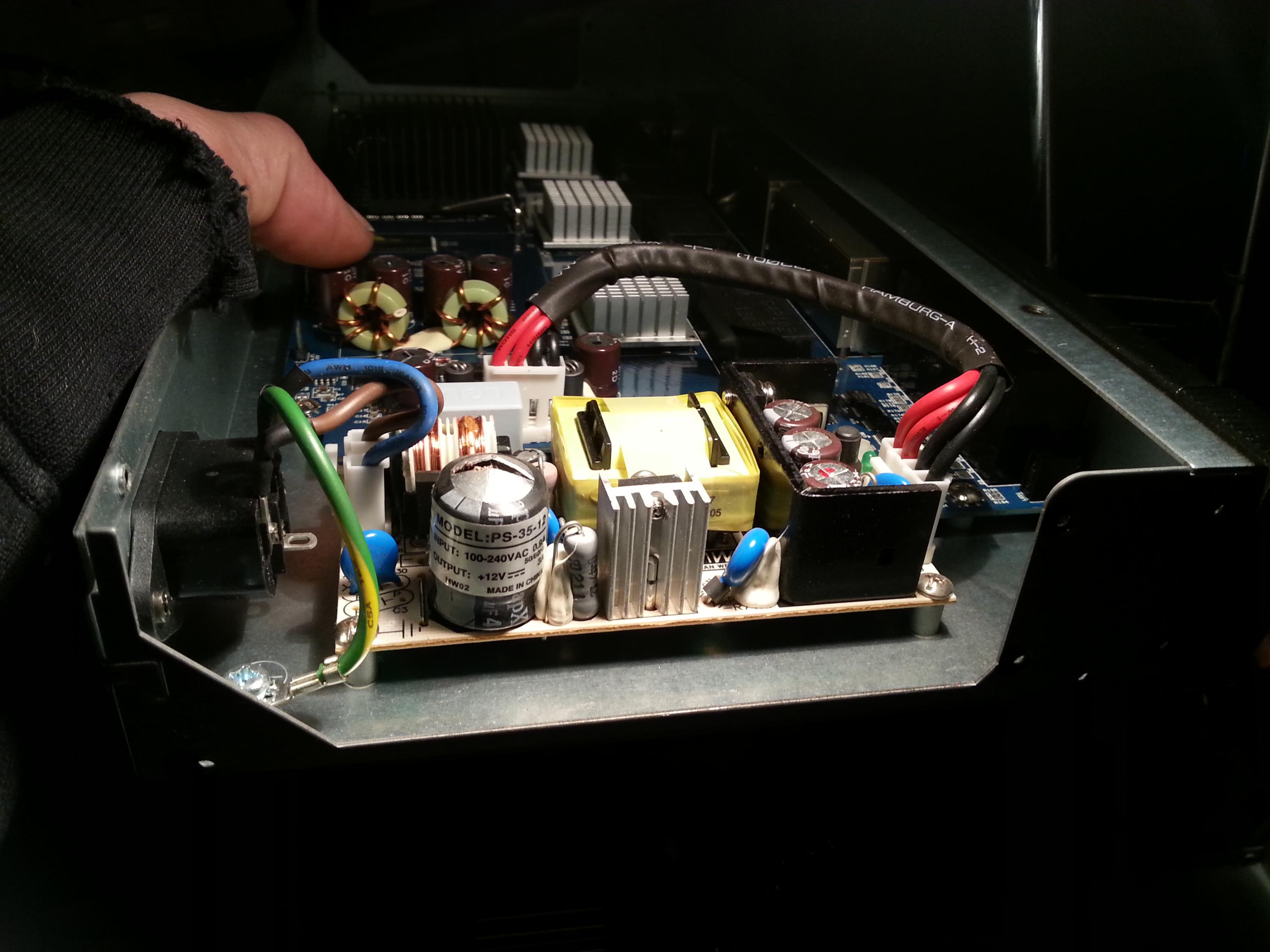

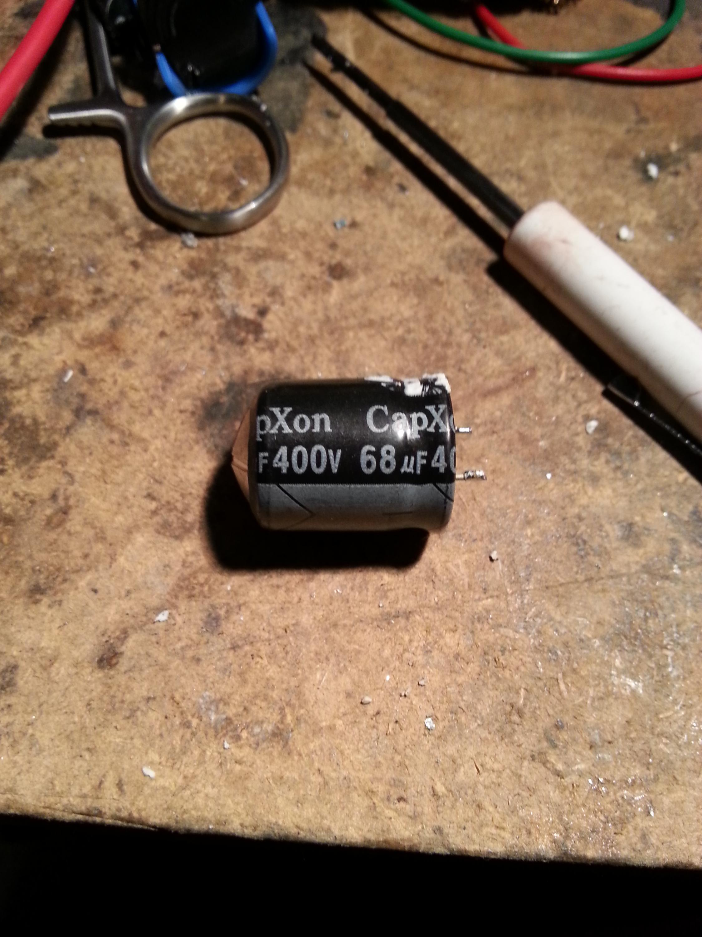

    Zyxel PSU
    Obvious why this switch has failed !
    Should I be replacing with a DC or AC cap ?
    I have a choice of three is it's a DC cap. Which one would you buy ?

      1) I am assuming you have a zyxel network switch that stopped working because the power supply for it failed.
      Any of those 3 capacitors you linked should work, but I wouldn't get the Rubycon because it's excessively priced. It does not need to be an AC capacitor as it is rectified to DC by one or more diodes before that capacitor in the circuit,but this should be obvious by looking at the original capacitor, looking up how it is rated.

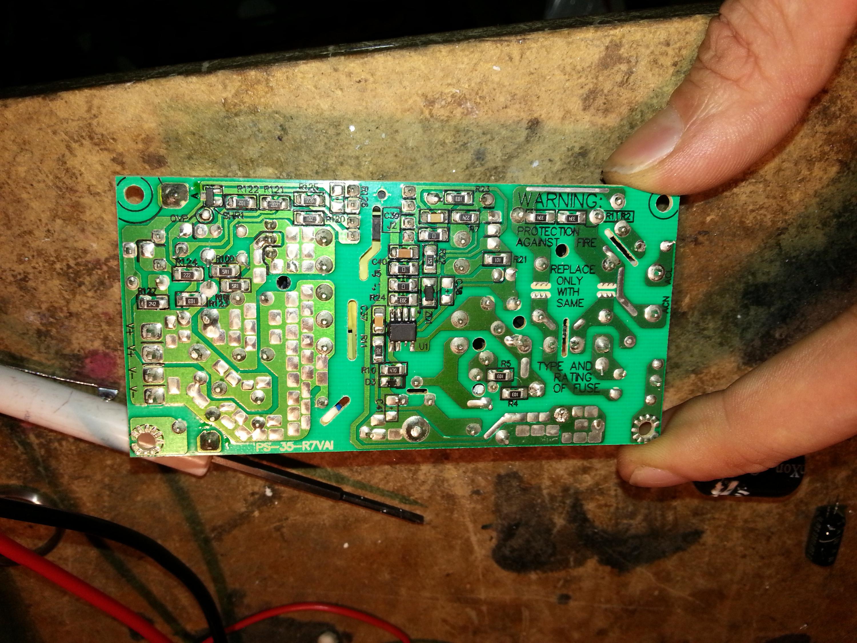

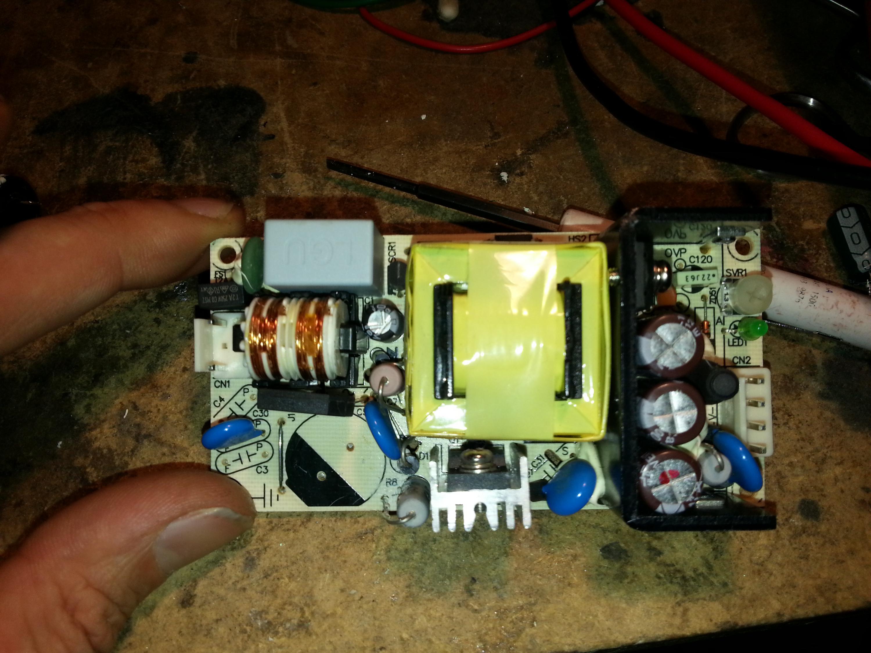

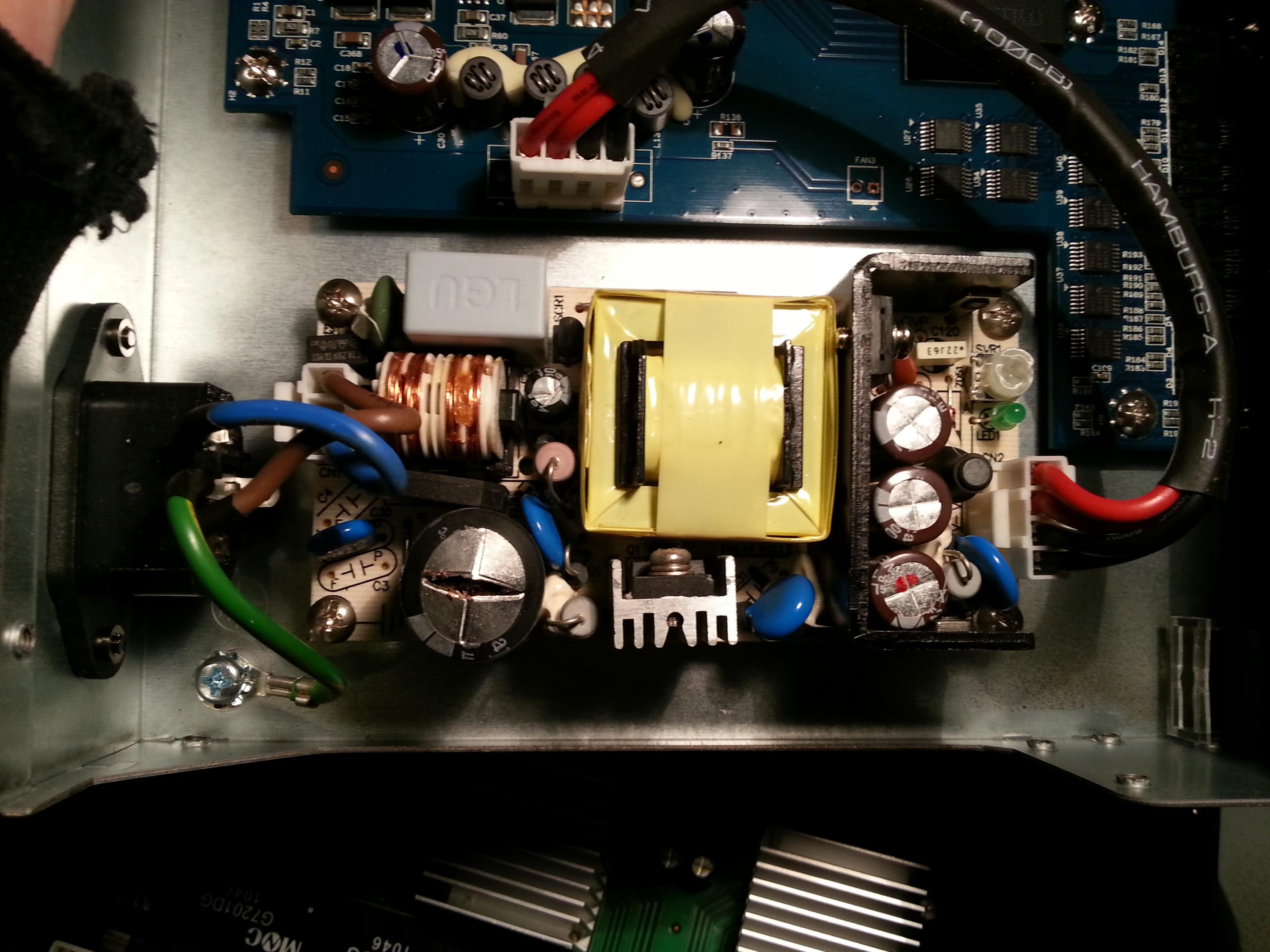

        Ahhh, missing photos, seems the uploading failed last night.
        Here we go.
        I bought a lot of 10 faulty assorted gigabit switches. I have Netgear, HP, Dell and a lovely Belkin.
        Obvious failures in most of the power supplies although one of the small Netgear switches is down to a damaged DC socket.
        Thanks 999999999 i ordered the Panasonic.

                Bipolar/AC capacitors should say "BP" on them or look like they're completely symmetric minus having possibly a dot on which pin is the outside foil. If there's a band of any kind it's a unipolar DC capacitor.
                I don't know if there are any recent usage for bipolar electrolytic these days - perhaps other than audio crossovers and even then people probably prefer some other method for separation. Induction motor AC caps aren't electrolytic - and bipolar electrolytic capacitor ESR is not that great... if not outright bad...
                Oddly enough I've never tested the ESR on a bipolar cap, I'd think these would be pretty bad?

                          Just to update, replaced the cap and the bridge rectifier and the switch is back to working.
