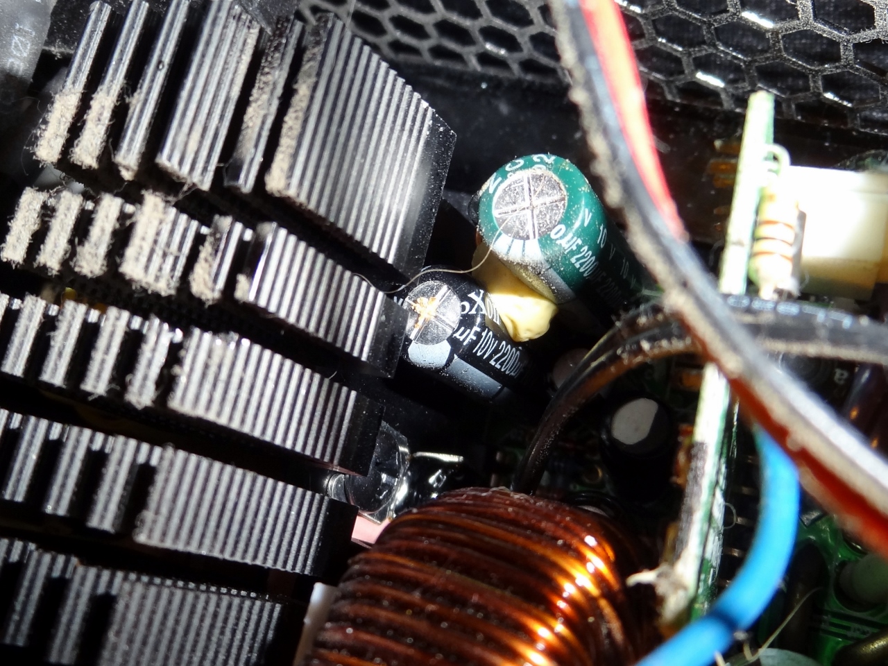

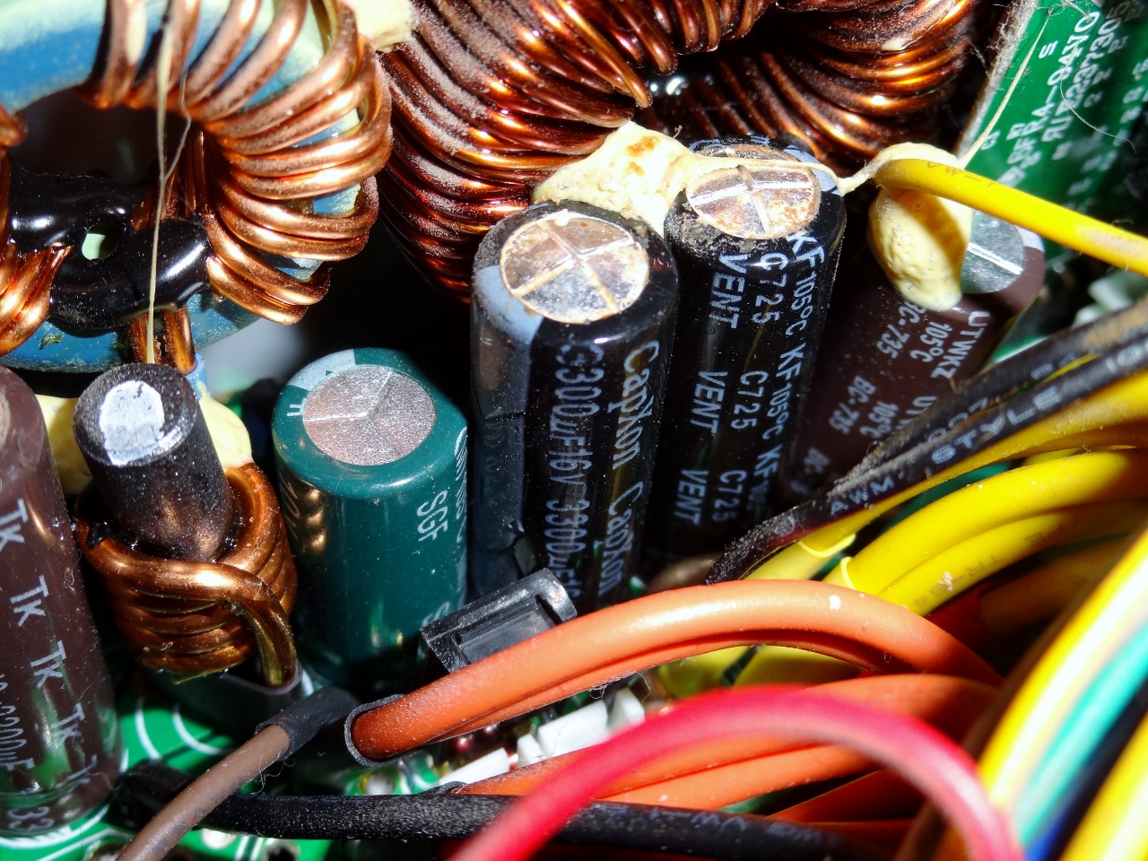

    Struggling to decide whether it is worth replacing some caps in a PSU I have or would it be too risky to use again in system?
    Concern being if it blows and wipes out the system.
    I got it with a PC, seller witnessed it go fizz, pop, smoke and shutdown. I got it and its actually still working, made a buzzing noise when I plugged it in but subsided after a few seconds and ran fine for a few hours.
    Had a look inside a can see 3 caps that look bad, see pics below.
    PSU is a Topower Top-1100W modular PSU, so a decent unit.

    That supply should be worth recapping but it will not be easy. It would be important to pick the correct replacements and get them from a reliable source. Do not buy them off Ebay and you need to match the specifications of the original capacitors.
    The reason it will not be easy is that it most likely has a double sided PCB so you need a really good soldering iron to tackle this job. Also if your soldering experience is limited you need to practice before trying to tackle this job.

      Agreed. I'd have no hesitations about recapping a PSU like this and using it in a PC. If you do a complete re-cap with entirely Japanese caps, You will actually end up with a PSU that is more reliable and less likely to fail than a brand new one.

        Ahh, more Capxon (aka Crapxon) bad capacitors. I love them because I get all sorts of free stuff from owners who toss out the non working computers, TVs, etc.
        Easy fix (unlike troubleshooting a TV main board) with the soldering iron and some new caps.

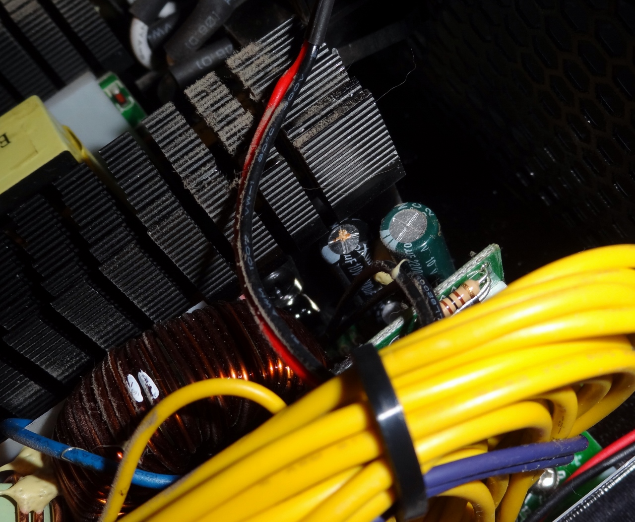

                  Measured with voltmeter and appear to be discharge, touched a screw driver across them just to be sure and seems fine to handle now.

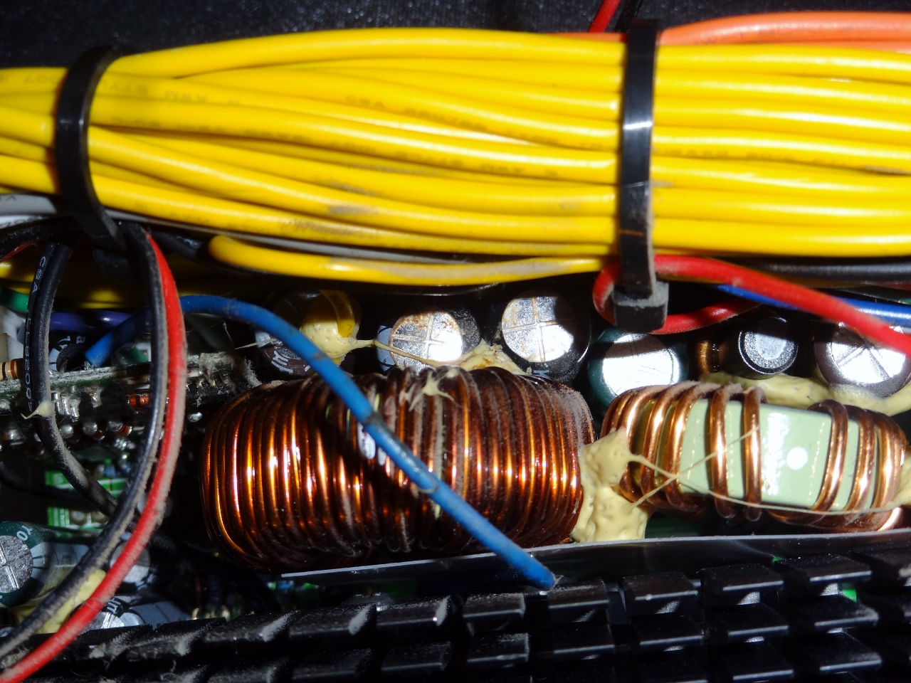

                  Ill have to remove them to get a proper look but have removed pcb from casing to get a better look.

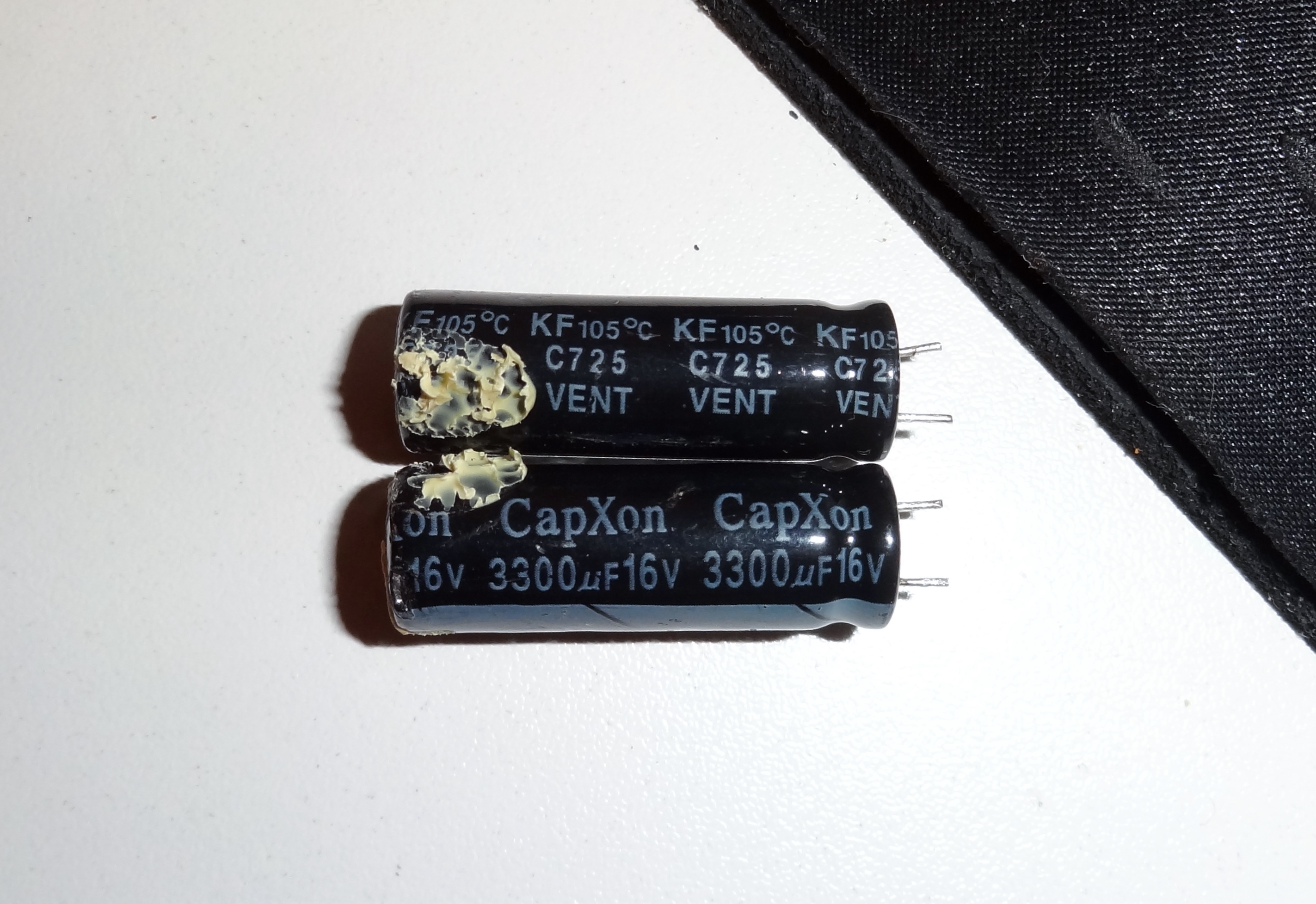

                  The 3 dodgy looking ones are all capxons
                  Capxon 10v 2200uf
                  2 x Capxon 16v 3300uf
                  and other which appear ok but you can see in pics, ill remove them over the next couple of days to get a better look

                    As stj said, Replace all of the caps on the secondary side, even if they aren't yet bulging, as they won't be far off it.
                    As for replacements, badcaps.net doesn't carry anything that is a suitable replacement.
                    For the 2200uF 10V caps, you could use either Rubycon YXJ from RS components (see http://uk.rs-online.com/web/p/alumin...itors/7497142/) or Nichicon HE from element 14 (http://uk.farnell.com/nichicon/uhe1a...tor/dp/1823552), both of which are UK based suppliers.
                    If you have any 3300uF 10V or 6.3V caps, you have two options. Ruby ZJL from element14 (http://uk.farnell.com/rubycon/6-3zlj...rad/dp/2346439). You can also PM our member "Behemot" and get Chemi-con KYA 3300uF 6.3V caps. (note that you can safely replace 10V caps with 6.3V caps, as they will only be on the 5V or 3.3V rail)
                    For the 3300uF 16V, you would have to get Behemot to supply them (either Samxon RS or NCC KZN), as he is the only one I know of who sells 3300uF 16V caps in 10mm diameter. Annoyingly, though, he doesn't sell any 2200uF caps, otherwise, I'd suggest getting everything from him. You may get away with replacing the 2200uF caps with 3300uF, but not all PSUs will play nice with it.

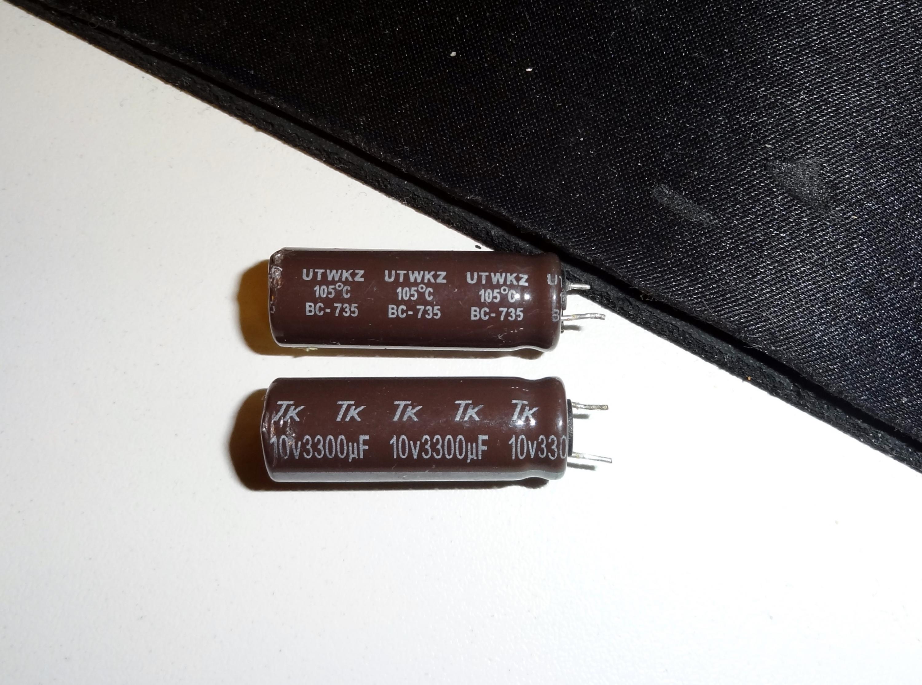

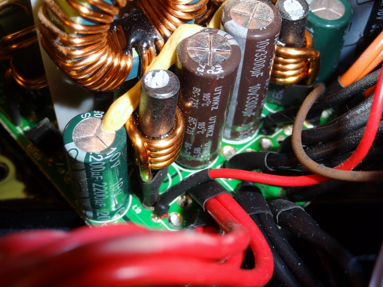

                        Wow WHAT a difference a good clean tip makes! Struggled with first two, tip was a little charred so swapped with a new one a the rest were a breeze. Cant recommend these desoldering guns enough. There were a couple more tiny ones which are quite difficult getting to which ive left. So we have
                        A) 2 x Toshin Kogyo 3300uF 10v (UTWKZ)
                        B) 1 X Toshin Kogyo 2200uF 16v (UTWKZ)
                        C) 2 x Capxon 3300uF 16v (C725)
                        D) 1 x Capxon 2200uF 10v (C723)
                        E) 2 x Samson 2200uF 10v (SGF)
                        F) 1 x Samson 470uF 16v (SKM0702)
                        G) 1 X Samson 220uF 16v (SKM0702)
                        H) 1 x Samson 2200uF 10v (SGF0702)

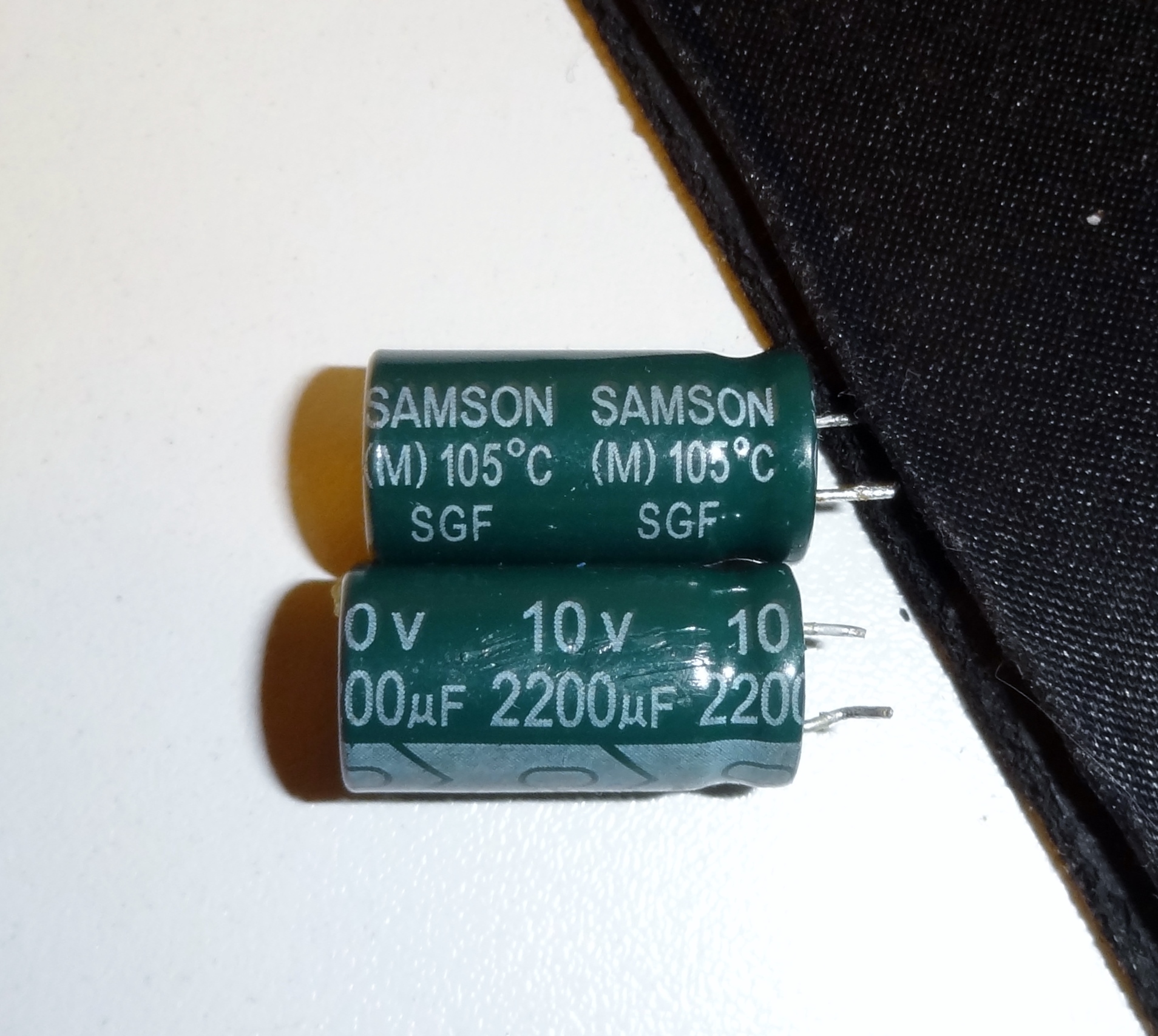

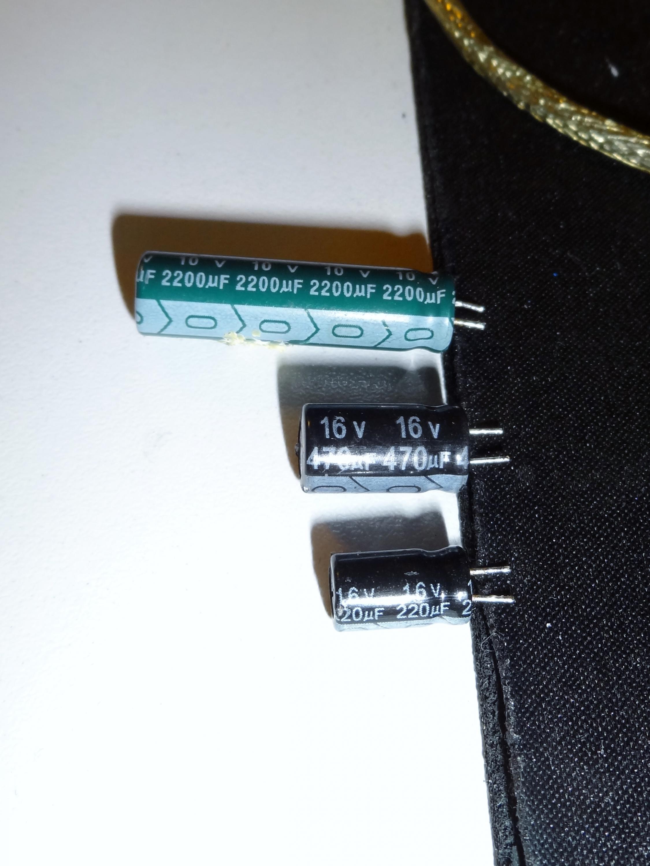

                                  A) 2 x Toshin Kogyo 3300uF 10v (UTWKZ) D 10mm H 30mm
                                  B) 1 X Toshin Kogyo 2200uF 16v (UTWKZ) D 10mm H 25mm
                                  C) 2 x Capxon 3300uF 16v (C725) D 10mm H 30mm
                                  D) 1 x Capxon 2200uF 10v (C723) D 8.2mm H 25mm
                                  E) 2 x Samson 2200uF 10v (SGF) D 10mm H 20mm
                                  F) 1 x Samson 470uF 16v (SKM0702) D 8.2mm H 15mm
                                  G) 1 X Samson 220uF 16v (SKM0702) D 6.2mm H 10mm
                                  H) 1 x Samson 2200uF 10v (SGF0702) D 8.2mm H 30mm
                                  Would it be possible to source suitable caps from say Farnels as is local to me?

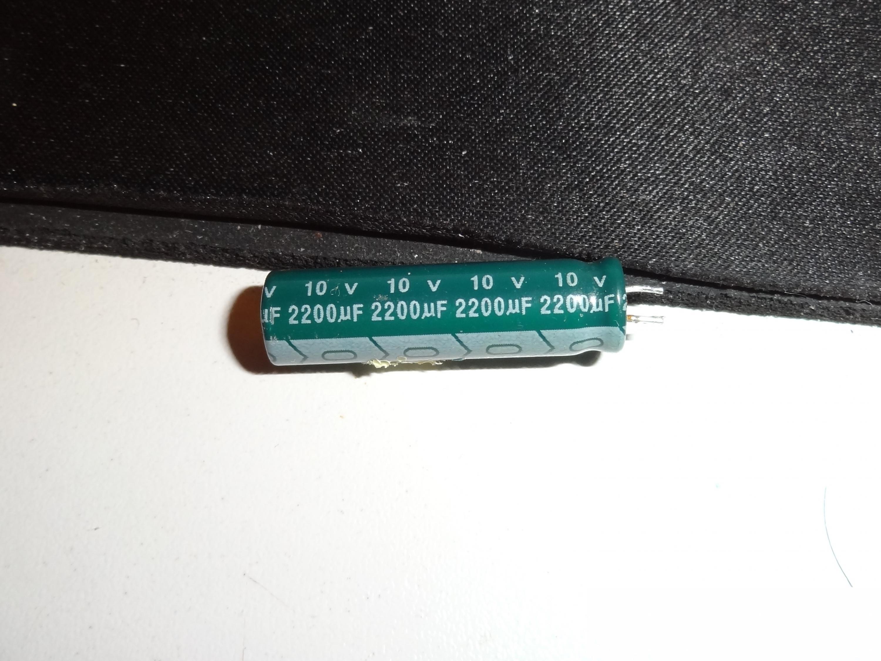

                                    Originally posted by mikay786
                                    H) 1 x Samson 2200uF 10v (SGF0702) D 8mm H 30mm

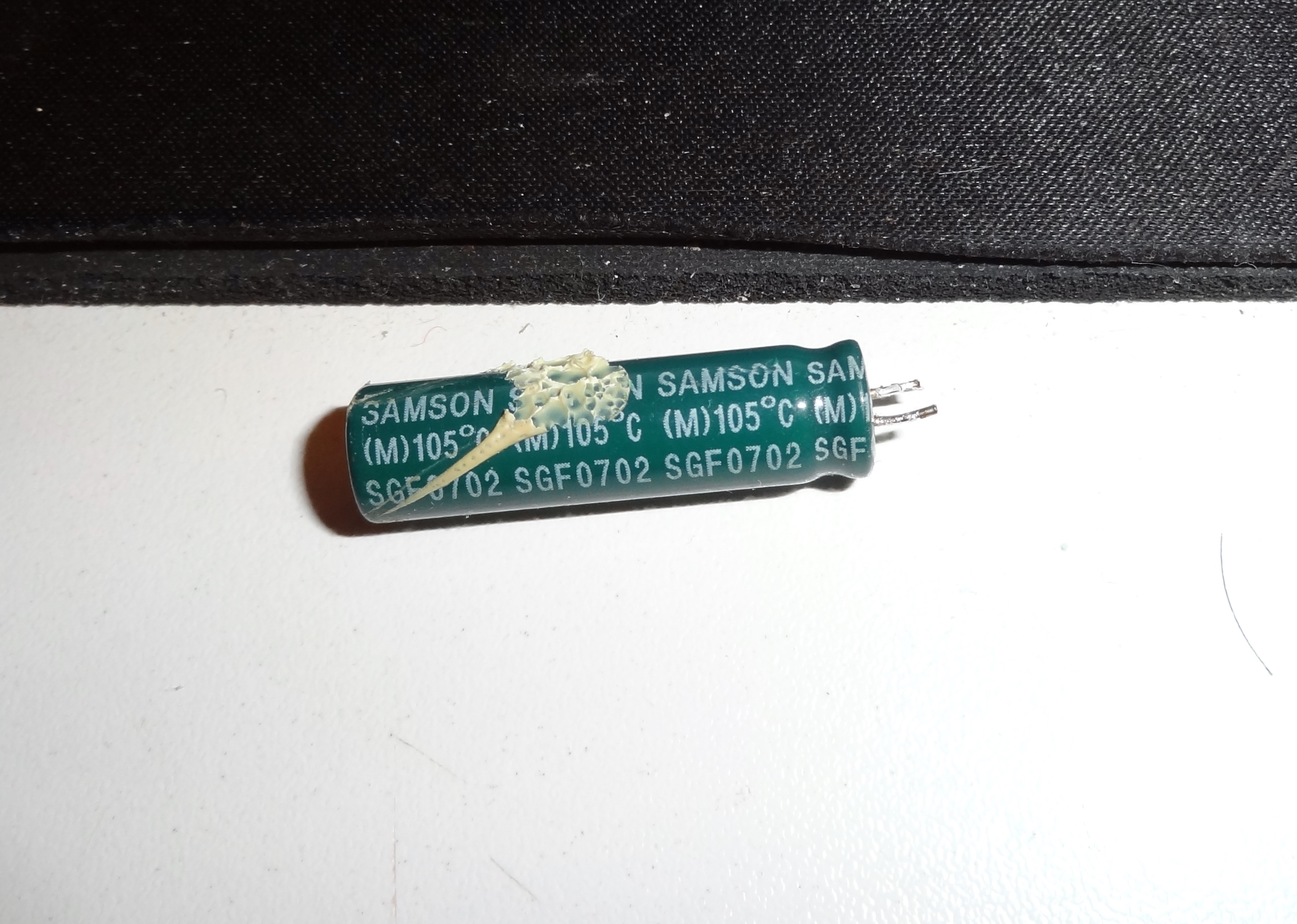

                                    This is for real? Could you get me some clear sharp pictures when you remove it from the unit?
                                    • mikay786
                                      • Aug 2014
                                      • 765
                                      Re: PSU worth replacing caps?
                                      see attached

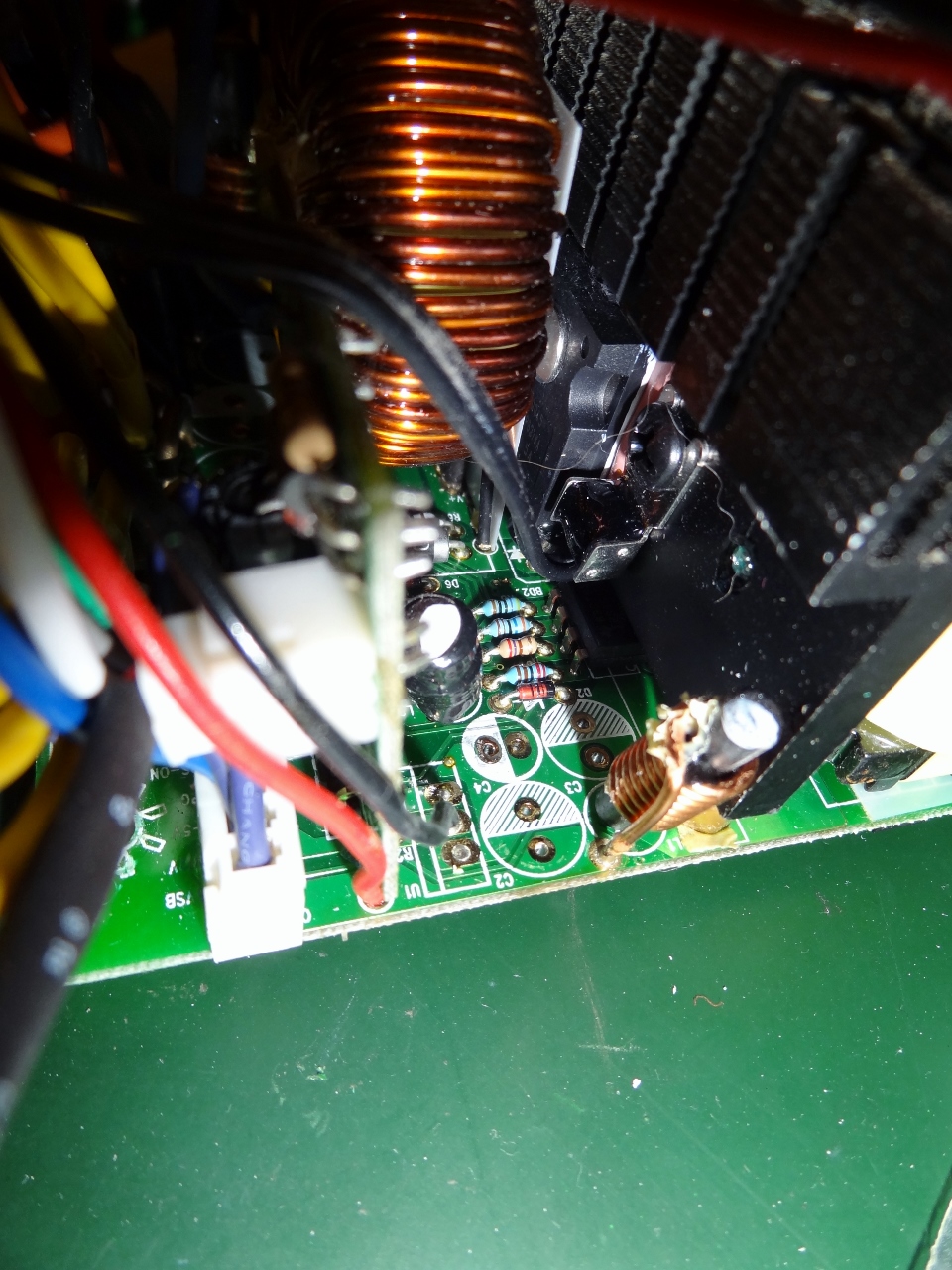

                                        regarding D & H
                                        See fit in board and space left behind
