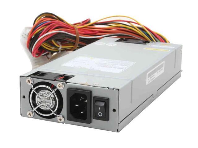

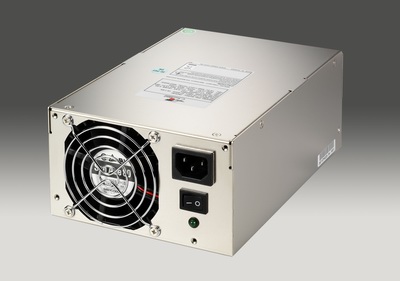

                    Re: My new Seasonic has questionable caps.
                    Dispelling the fan myth:
                    Hmmm,
                    A 500 watt with ONE TINY lil 40mm fan.
                    Sparkle/FSP , FSP500-80BU , 500w , single 40mm Fan , -> MTBF 100,000hr
                    http://www.fsp-group.com/english/1_p...d=61&proid=101
                    A 1200 WATT with only ONE 80mm Fan.
                    Zippy/EMACS , PSL-6C00V , 1200w , single 80mm Fan
                    http://www.zippy.com.tw/P_product_de...code=PSL-6C00V
                    OH SHIT! In the learned wisdom of PSU reviewers those are gonna melt down into lumps of useless metal!!
                    OH SHIT! OH SHIT! - They'll catch fire!!
                    Spectre!
                    You better go call the Engineers at FSP and EMACS and tell'em they don't know what they are doing!
                    I'm sure they'll listened to you.
                    You obviously know more about what it takes to cool a PSU than those Engineers do.
                    Those are power supplies where the priority is reliability in a brutal environment (servers) and not in impressing ignorant buyers (and magazine editors).
                    As I said before:
                    It does NOT take two fans to cool a PSU.
                    That's load of advertising HYPE.
                    The hype as existed so long and been repeated so frequently that people actually believe it and call it 'common knowledge'.
                    Once upon a time common knowledge said the world is flat.
