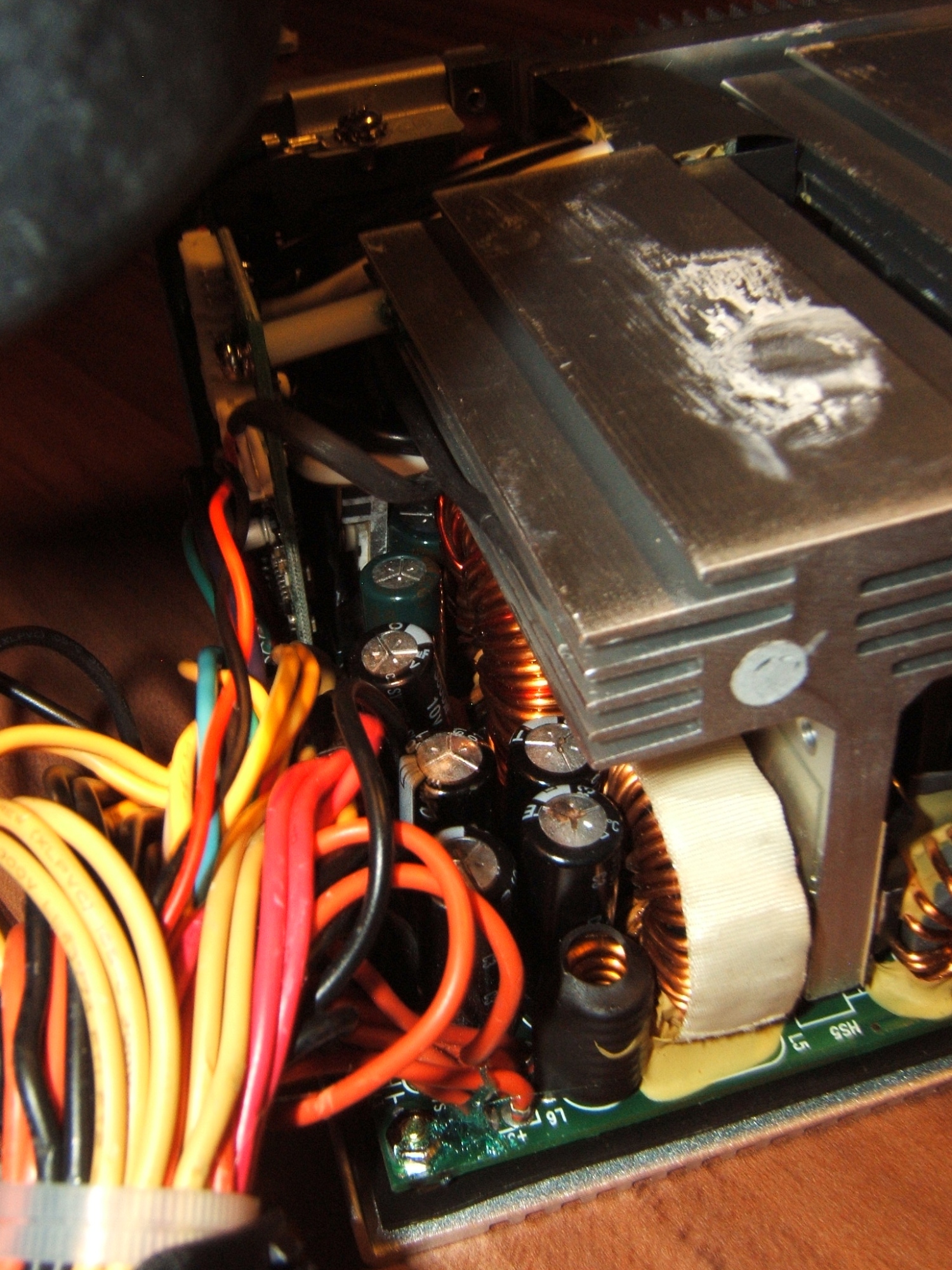

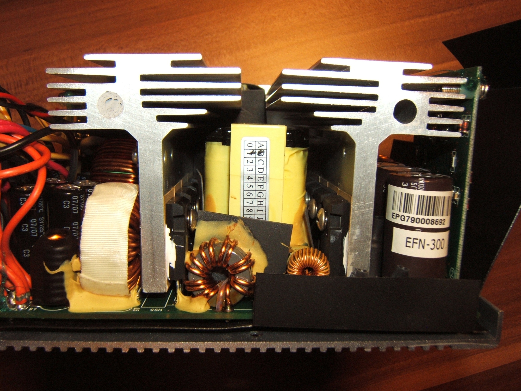

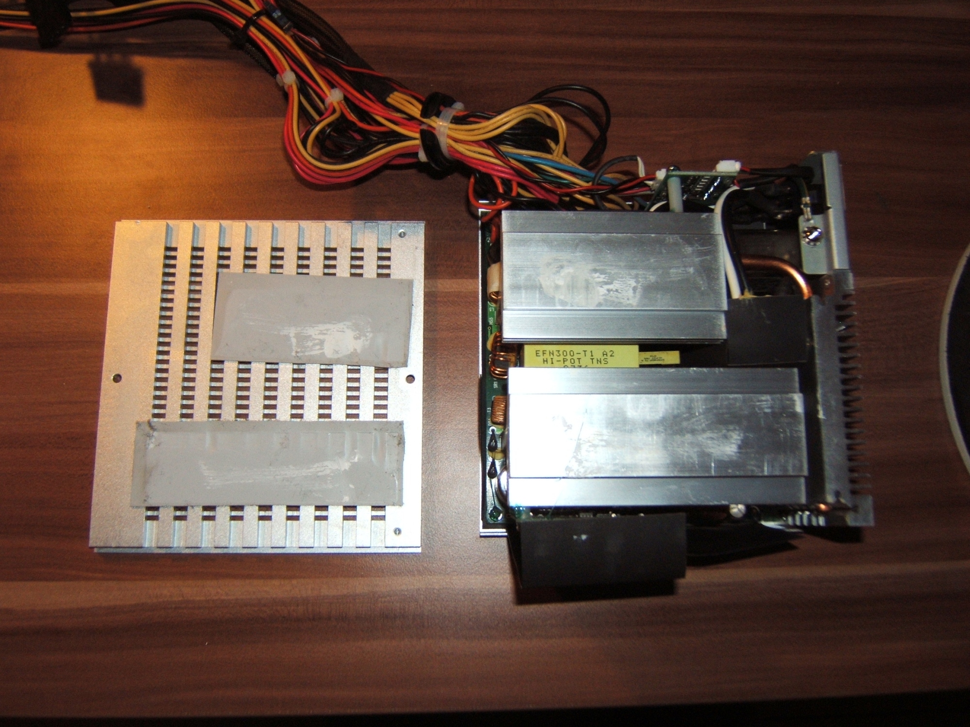

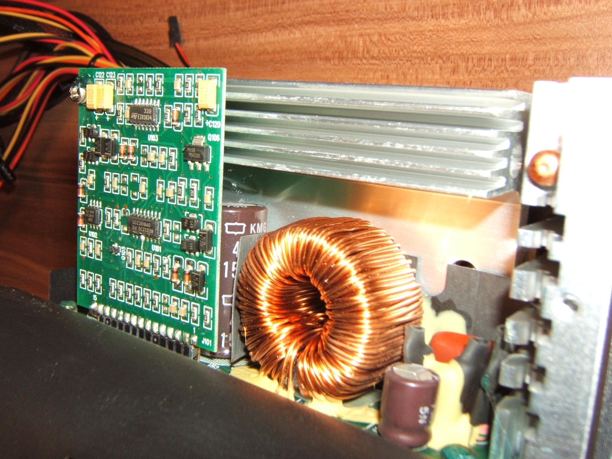

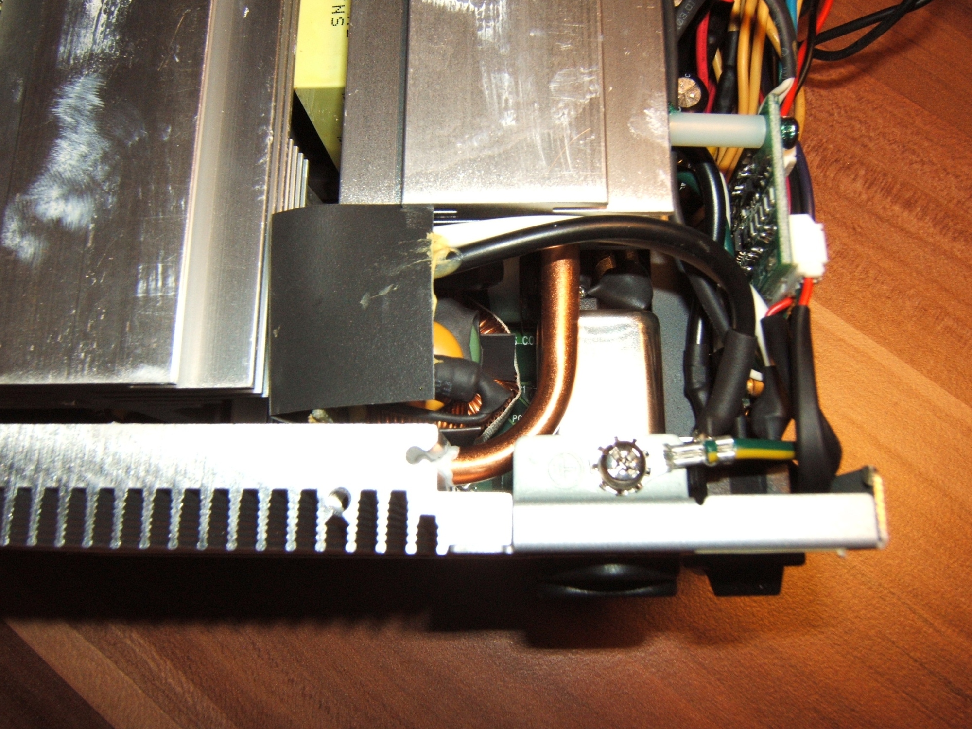

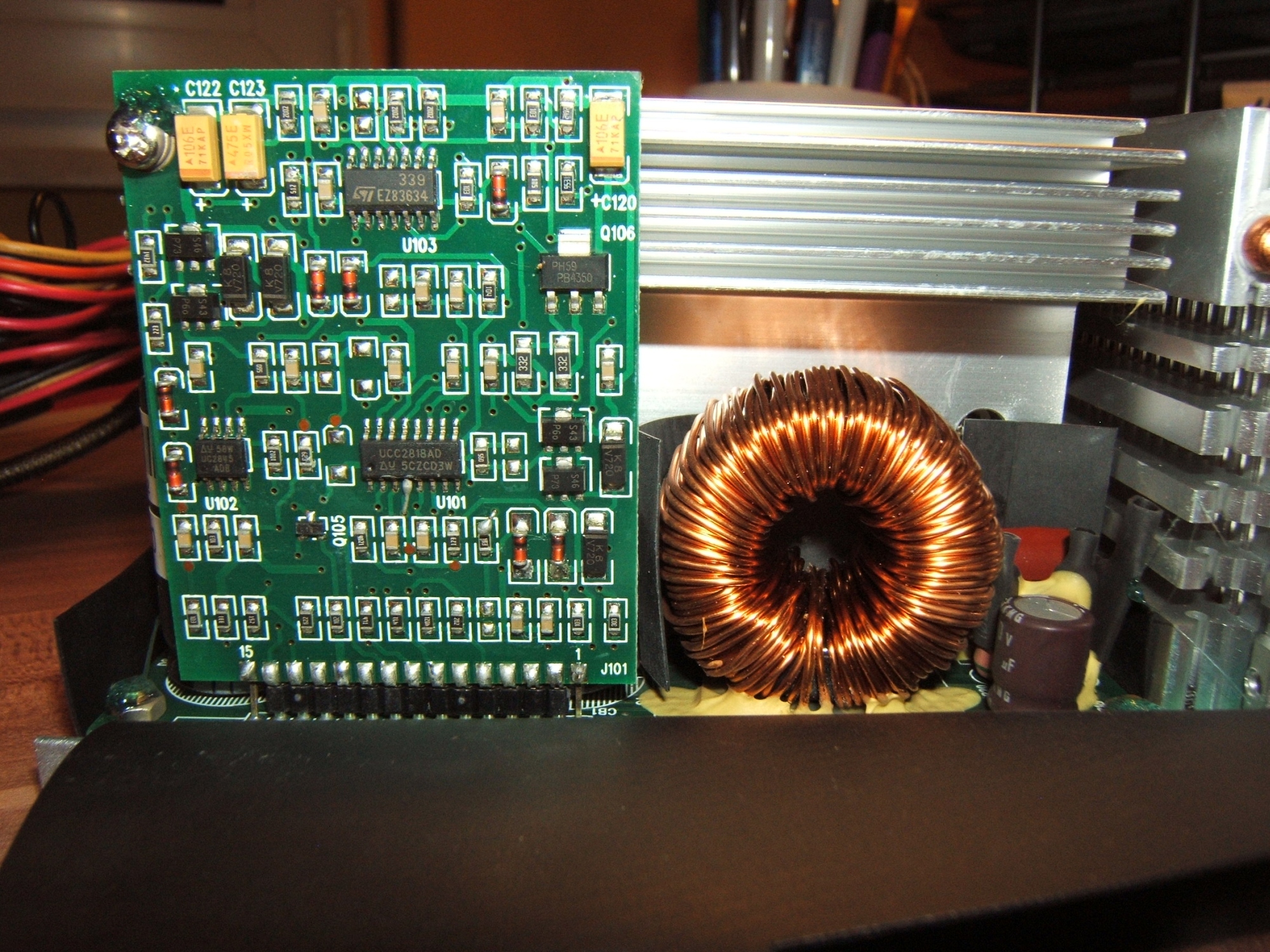

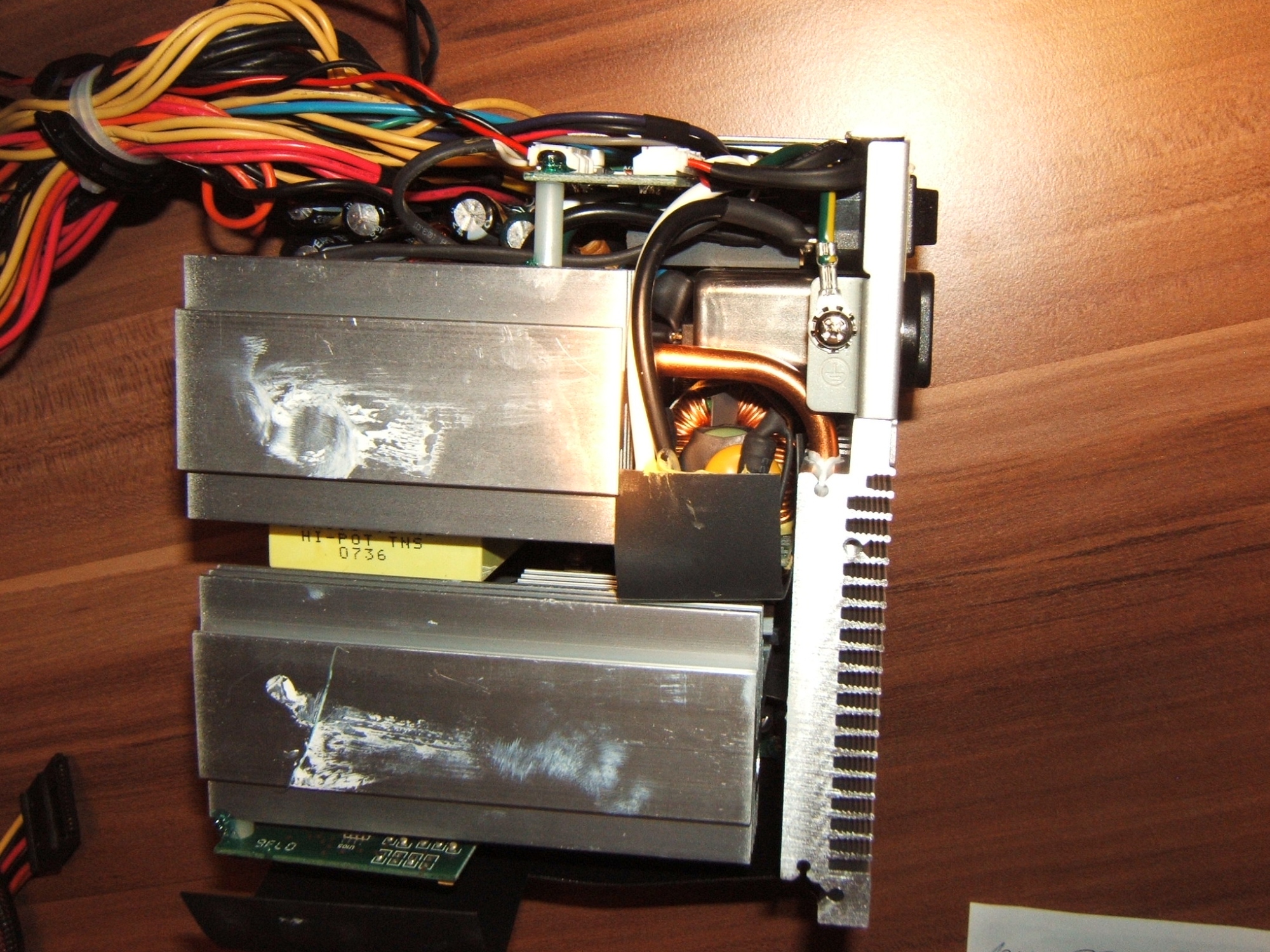

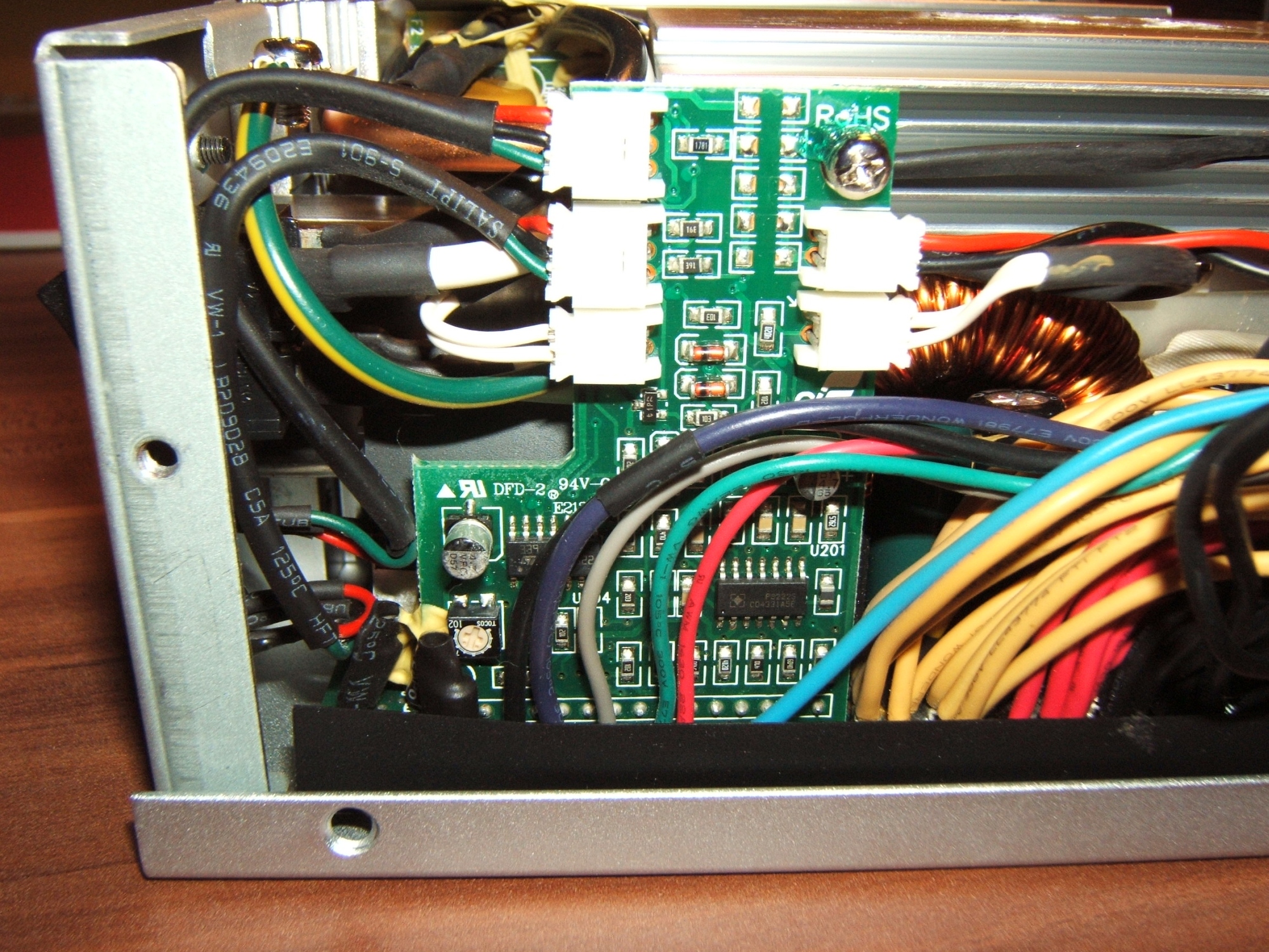

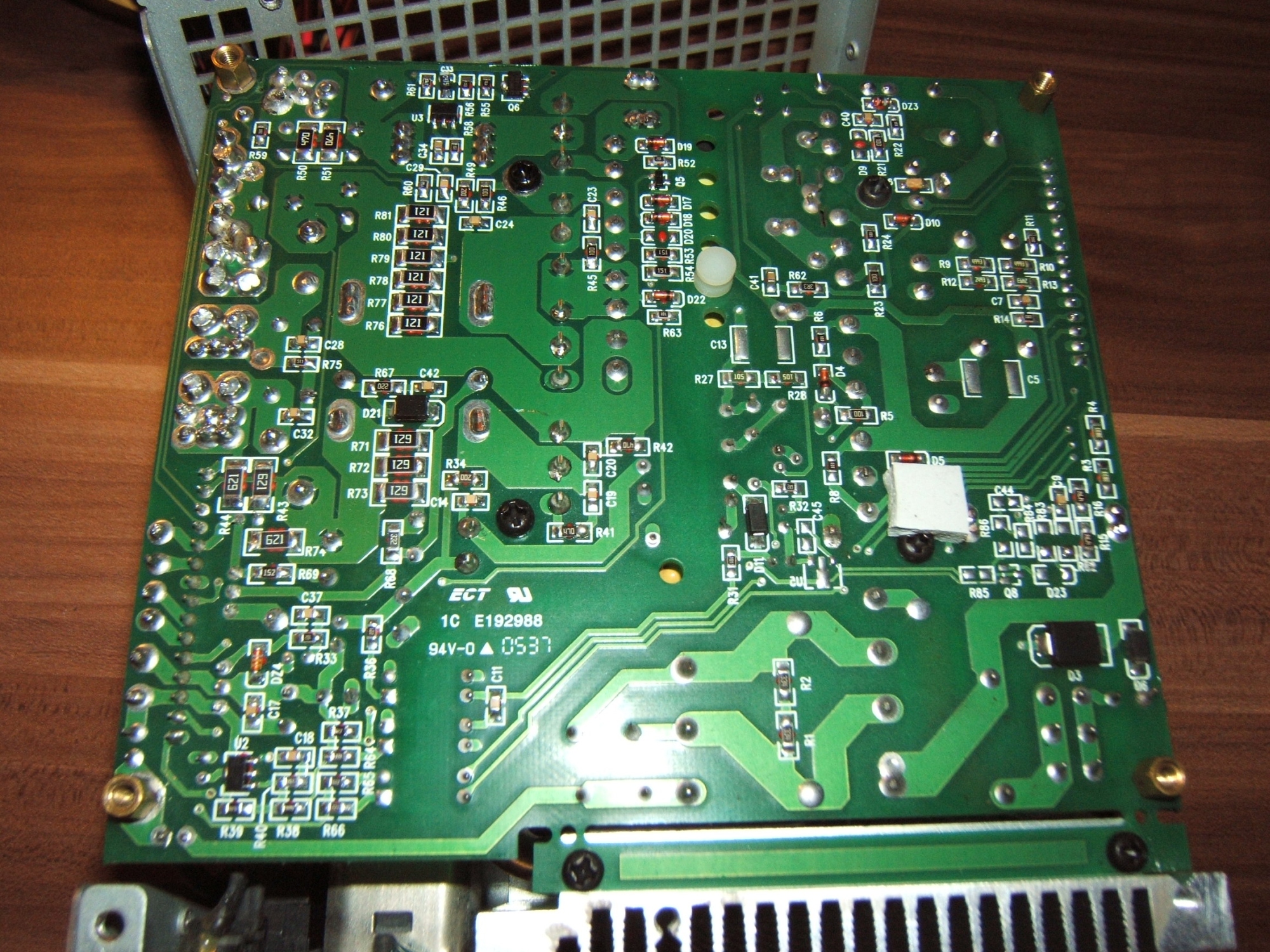

    Fanless Silverstone ST30NF, also known as Etasis EFN-300, doesn't power up anymore. Was working 24/7 for about seven years until it switched off itself.
    This thing is massive, even with the thick aluminum case removed. Components squeezed into every corner. Three daughter boards.

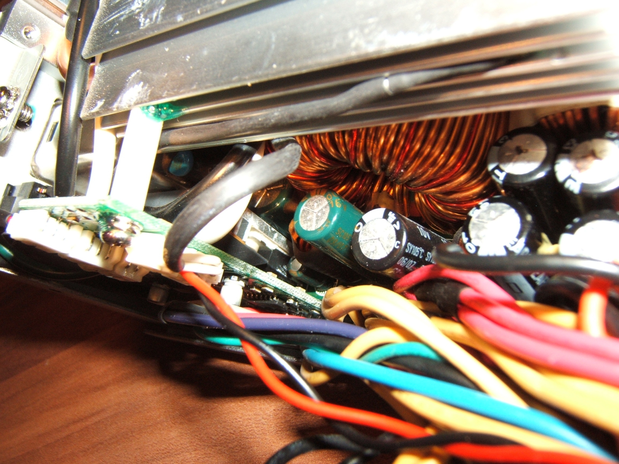

    There's 3 KMG 400V 150 uF on primary. And a KMG 50V 1uF close to it.

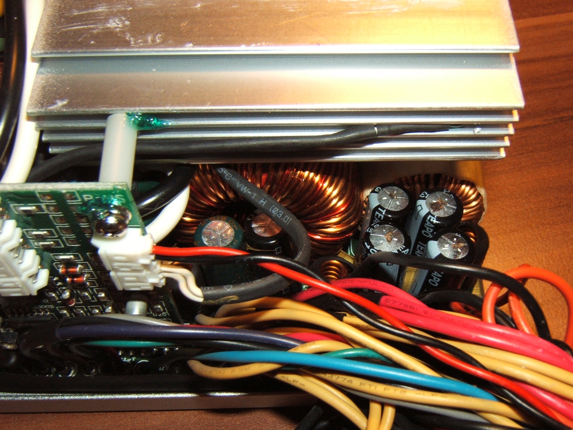

    On secondary four of five black Teapo C3 10V 3300uF are blown.
    There's a green Teapo C1 16V 2200uF.
    A bunch of other caps are hiding below the heatsinks. One is bulged. Can't really identify them, looking at the sleeve color and at the top vent I'd say it's all Teapo C1 ones.
    In standby temperature LED shows green ("ok"), fault LED shows orange/amber, it turns red when trying to switch it on. Power supply make one "click" noise for each power up attempt. +5VSB is available and stable.
    I'm not sure if I wanna invest the time to disassemble this beast, just recapping secondary probably won't fix it, I guess. Any ideas?

    Well, those caps are to be expected to be fried 'well done' due to the lack of airflow. So no surprise there.
    Just be glad the PSU shut off and didn't damage anything...
    As for the PSU: it's not really worth fixing, decent quality 300W PSUs are on sale for about 30€...

            If that PCB is double sided, like it looks to be, then recapping that supply will be a real pain to recap. If you do not have much experience replacing capacitors then this supply may not be one to start learning how to repair power supplies.

              I'd say it's worth a repair if you have a powerful soldering iron. Doesn't look like there's a lot in there to replace anyways. I'd replace all of them besides the primary ones.

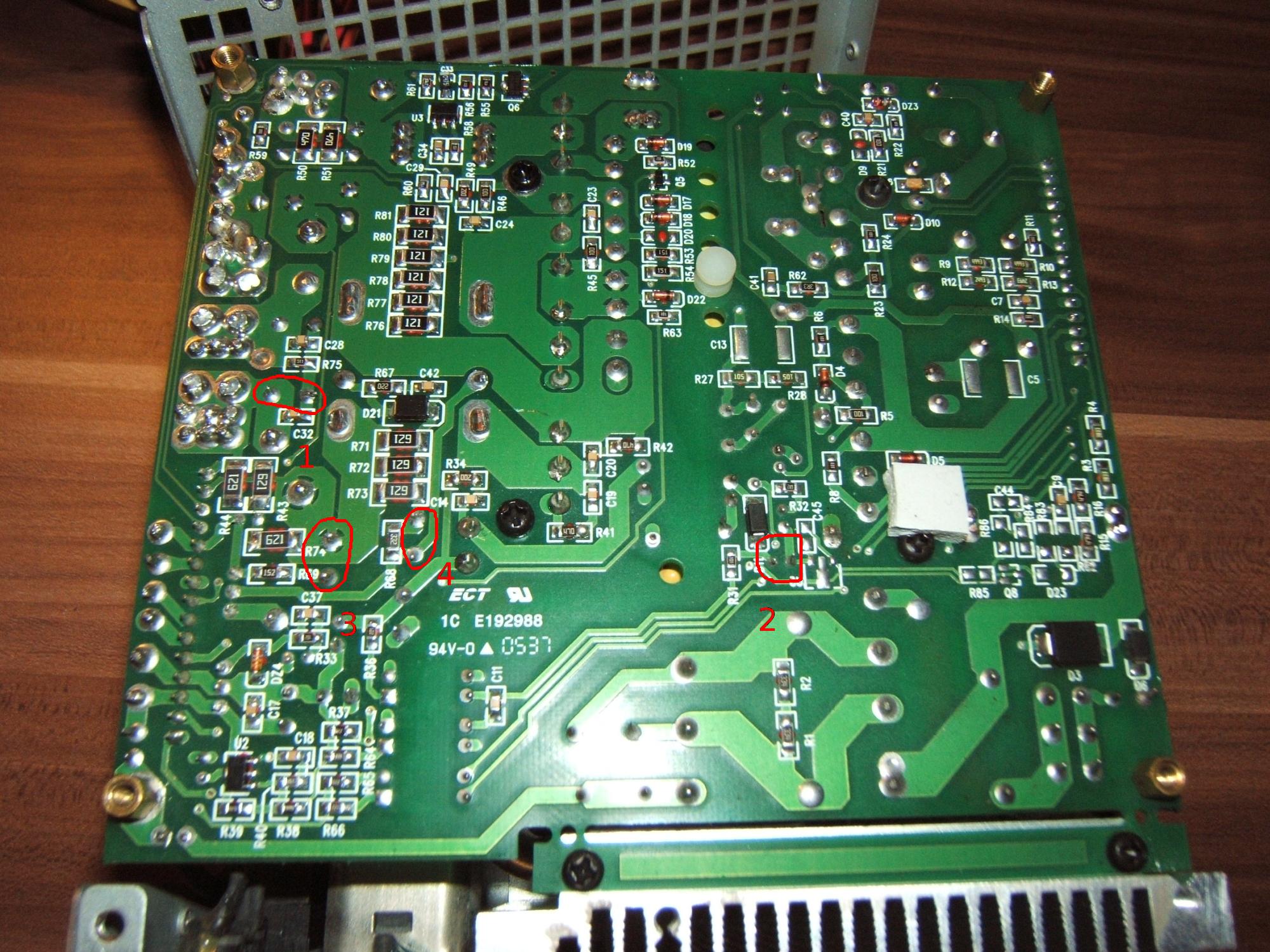

                    I pulled out a few.
                    1. the green tall one here:
                    https://www.badcaps.net/forum/attach...1&d=1435615315
                    is a 2200uF 16v
                    2. then the tiny green one in the middle of the board between the 2 big coolsinks:
                    100uF 25v
                    two low green ones below the power connector (not visible on this pic). (the thickest one and the one next to it:
                    https://www.badcaps.net/forum/attach...3&d=1435615315
                    3. thick one: 2200 uF 16v
                    4. thin one: 470 uF 25v

                      Those O/P caps are pocketed by the heatsink, O/P inductor, and O/P wires. With no airflow, I'd recommend NOT using an ultra-low impedance cap with a water-based electrolyte, not even long-life parts like Nichicon HD or HE, Panasonic FM, or ChemiCon KZE or KY. And not Rubycon at all (pretty much all water-based). Water-based electrolytes are more sensitive to heat.
