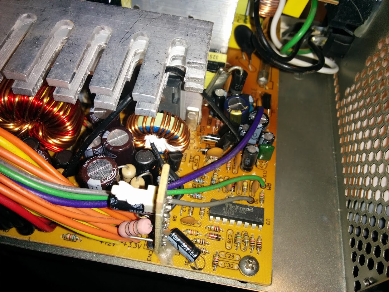

    Got this in a machine I picked up locally, immediately on powering the machine I got a really unnerving buzzing from the machine, I powered down and one of the caps (maybe the standby) was blown.
    I replaced and the sound went away, but slowly came back, seems to sync with hard drive or 5v activity.
    Is this worth saving and if so what is the likely cause?
    Thanks!

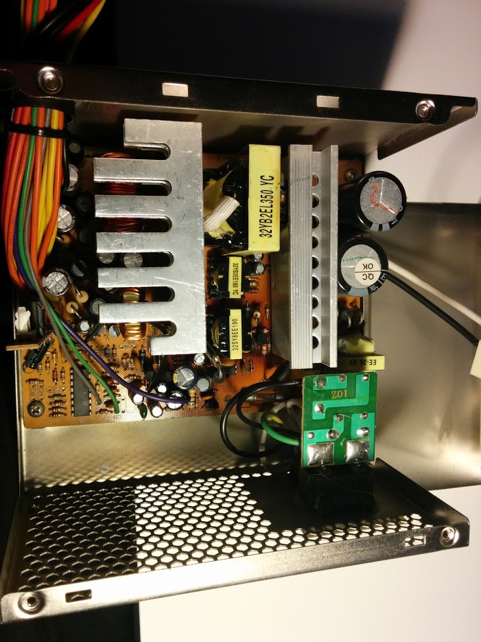

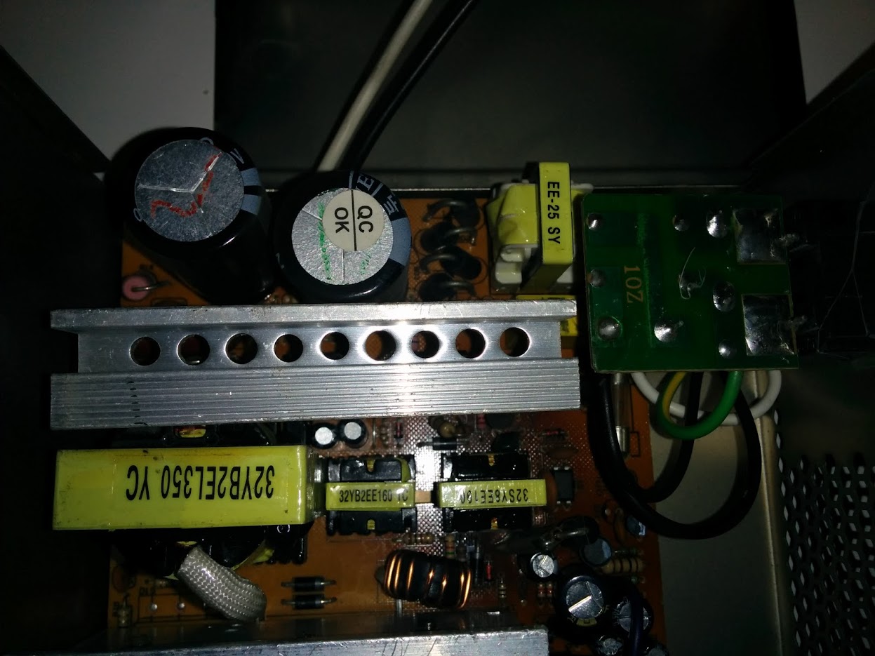

    Hmmm. Judging by the heatsinks and the way it's placed in the chassis, I'd guess it's a Deer. But nothing else seems like it's a Deer. Cap brand choices, that weird fan daughterboard, Weltrend WT7502. But on the otherhand....Deer is the only company I've seen that uses that interesting method of a heatsink on that 5VSB diode. I guess it could be a Deer.
    I think it's definitely worth repairing, It's got an input filter, 35 transformer, good sized toroids and output inductors, fan control thermistor. I'd say replace ALL the caps, oil the fan, and check the values on the minimum load resistors. Also, make sure the joints on the bottom side of the 5VSB section didn't go cold, it looks like that area ran really hot and it sounds like the little caps in that section have gone bad, changing the frequency of the transformer, and creating that annoying buzz. I'm guessing that's the main issue. It's also possible that the resistors slow roasted those awful JEE caps, pushing them out of spec, but not causing them to bulge.
    What fan does it use and what are the specs of the silicon?

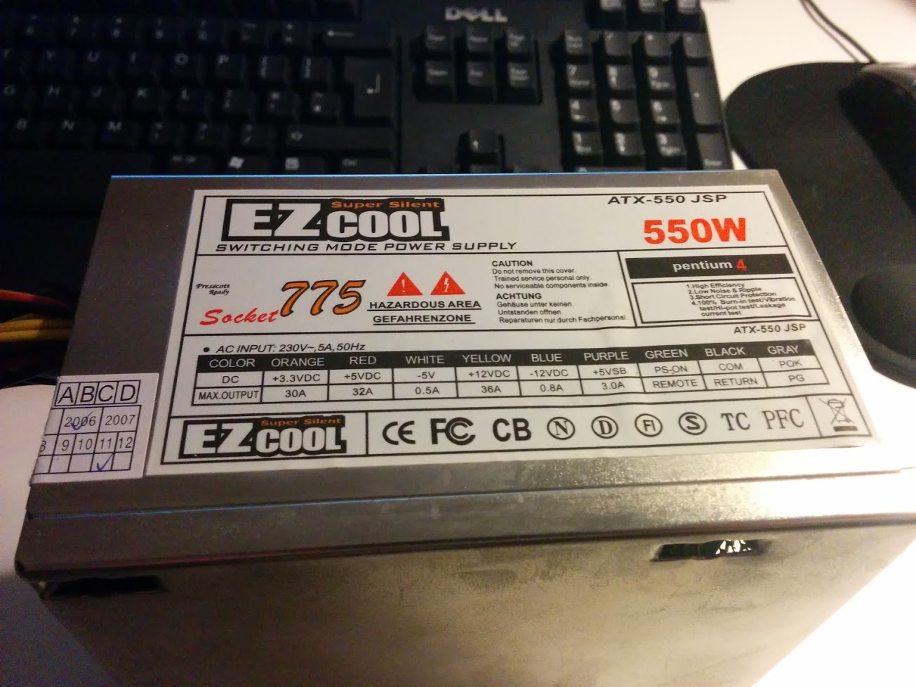

      I just noticed that that label has the same exact format as this Prudent Way I recently worked on:

        The reason why I didn't just lob this was I used them quite frequently in a computer assemblers job about a decade ago.
        The cheeky rip off merchant I worked for used to use these as "upgraded" power supply parts in builds, I believe they were charged at around £50!
        That said inside doesnt look to terrible, am I right in saying this is more a 350w unit however than a 550?

          hey Bungz, did you mess with that psu?
          it looks like the 5v standby has been upgraded with a couple of Panasonic FC's.
          • Bungz
            • May 2013
            • 133
            Re: Buzzy EZcool 550W - Worth repair?
            Yes the standy was bulging and I had a FC that fit so I swapped that.
            As i mentioned it was strange it cured the buzz that the hd activity was causing for about 5 minutes then it came back

                    Sounds good, but the first you should do a total recap of the standby section, both line side and load side, since it's been a bit toasty.
                    After that, you should test 5VSB with various loads/resistors, and a meter/scope. You do not want to see any signs of run-away 5VSB at lower loads of 0.1-0.5A, an obvious mobo killer.
                    Once you're satisfied with the standby supply, only then put your efforts into recapping the main supply.
                    Obviously, you'd have to do this outside of the computer, so if there are any "accidents," you don't ruin your day.
                    Not saying you should expect trouble, but some of those two-transistor aux ckts start getting cranky after they've been hot.
                    Also check joints on/resolder the 5VSB rectifier.

                                Righty
                                I went balls out and just re-capped the lot as I couldnt be bothered taking it apart again.
                                Still buzzes! Sounds like extreme coil whine, massively amplified with HD activity.
                                Any pointers before I harvest my nice panny caps out of it and sling it?
                                  • 31246
                                  find out what coil is bitching by pressing on them with a plastic rod or bic pen body.

                                    Oh yeah, good ol' ATX-550JSP. There have been quite a few different boards under this label actually.
