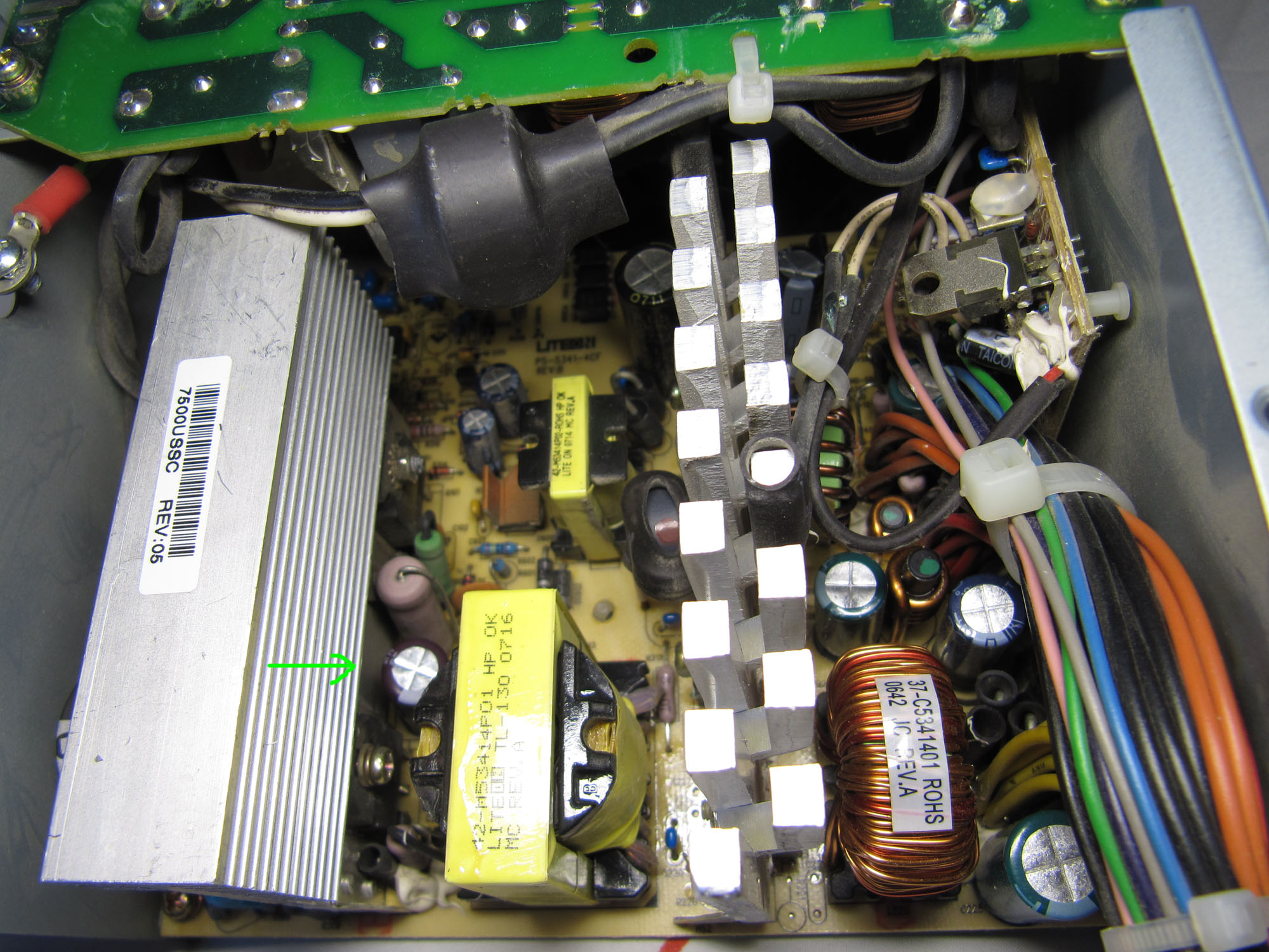

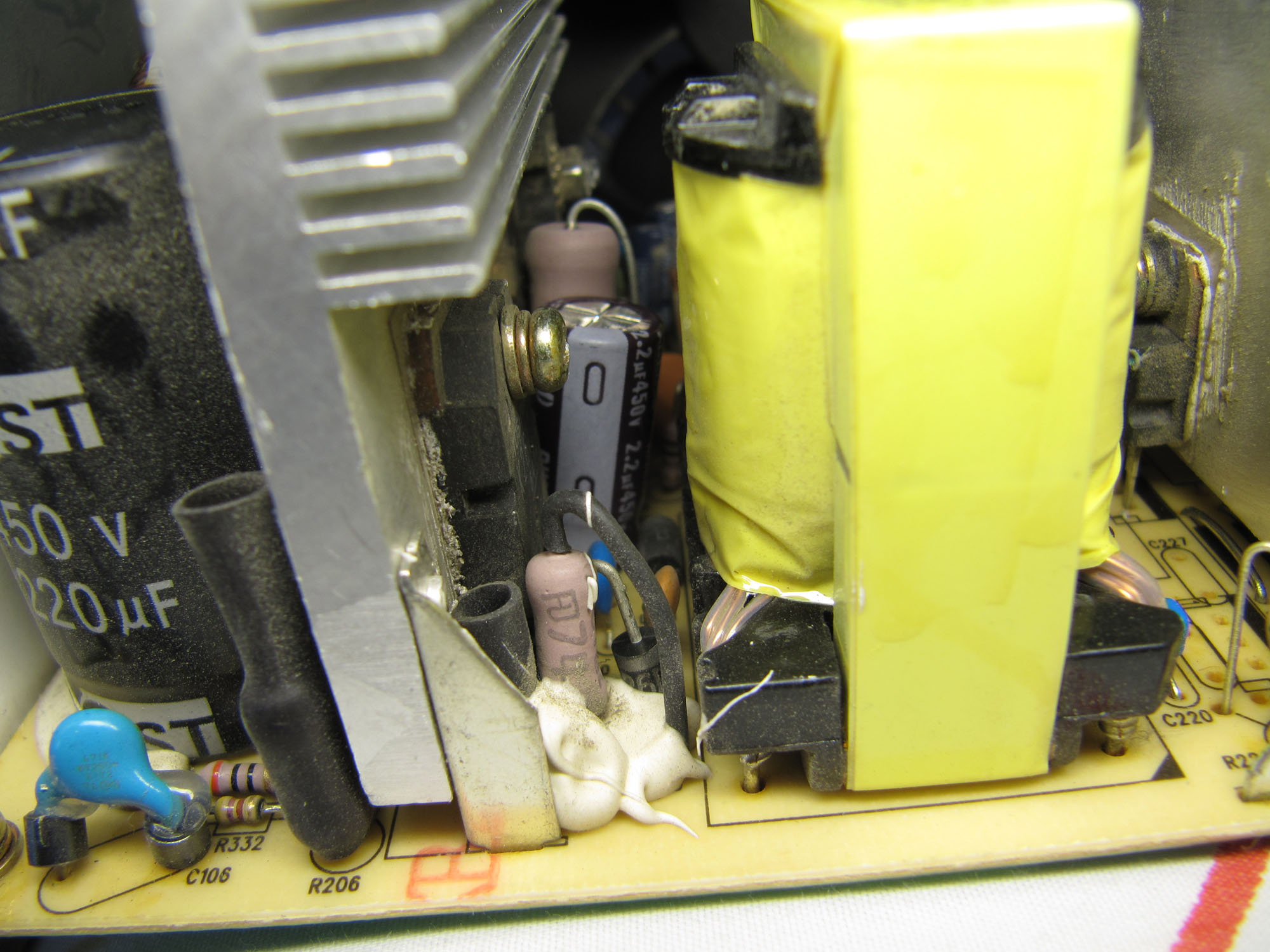

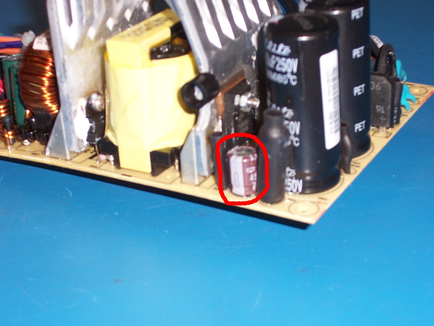

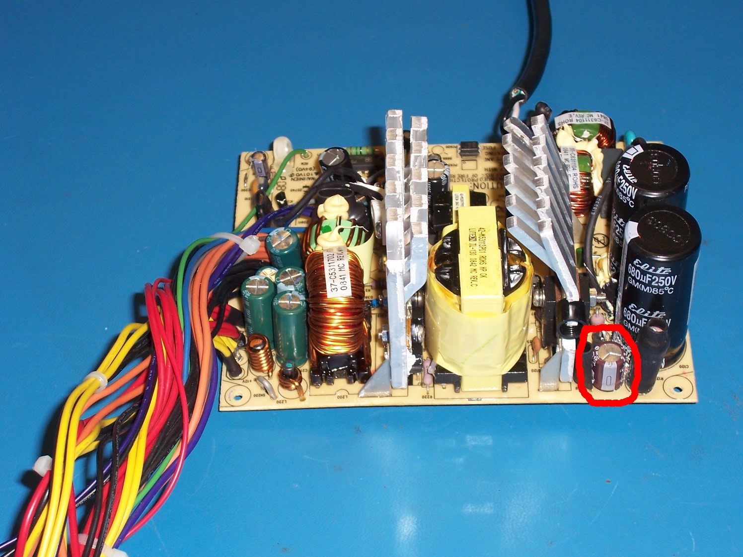

    I have recently acquired a LiteOn PS-5281-7VR 250 watt atx power supply. This is the second LiteOn power supply I have seen with an electrolytic capacitor in the snubber circuit. Capacitor value is 2.2 uF/450 volts. Measured capacitance is 1.98 uF and esr is 8.0.
    So what's the beef? Every other power supply I have looked at has a ceramic capacitor in this circuit. Seems like an electrolytic in this location is just asking for trouble. The first one I saw had a bulging capacitor. Replacing the capacitor fixed the power supply. This one is not bulging, and the power supply is operational.
    I thought that the proper value would be more like .1 uF, which is one tenth of the value. Here are some pictures and a drawing of the snubber. What do you think?

    Was the bulging capacitor an LTEC by any chance? Or a Chemi-con, Nichicon, Rubycon, or something? Or OST or Taicon? Since most of those brands aren't esteemed and don't deal well with stress.

      The bulging cap incident was a few years ago, so I don't remember the brand. I only remember that it was unusual to see an aluminum electrolytic capacitor in this circuit. And I still think it is unusual......and maybe a time bomb.

        What were the symptoms of the power supply that had this cap failed? Just refused to power up or unstable power? Or ticking? I'm just curious because I have a few LiteON PSUs as well. I think one or two of them are still in service.
        And yes, an electrolytic in that spot almost seems like planned obsolescence. Or just poor design.

          is the polarity marked on the pcb?
          maybe it was designed for a film cap and they decided the electrolytic was cheaper.

            everell is right. This is not random at all. Lite on does that.
            See this thread for example:
            https://www.badcaps.net/forum/showth...331#post377331
            There is a 2.2uF 400V capacitor among the big pink resistor and the mosfet. That cap has gone high esr and I replaced it back then with 2.2uF 450V Nichicon PW if I remember correct.

              Looks like they might have not had enough room to put a film cap in.
              I do agree, a film or ceramic cap would be better.
              I'm not a PSU design expert (I want to be one some day though :P), but I think that is normal. I've seen some with 10nF caps, up to 1 or 2uF!!! And I've seen some with varying snubber resistor values, from 33K up to 100K, or maybe more. Hm, I don't recall them well enough to see if there is a relationship between either the frequency, topology, DC bus voltage, or wattage, and the capacitance/resistance.
