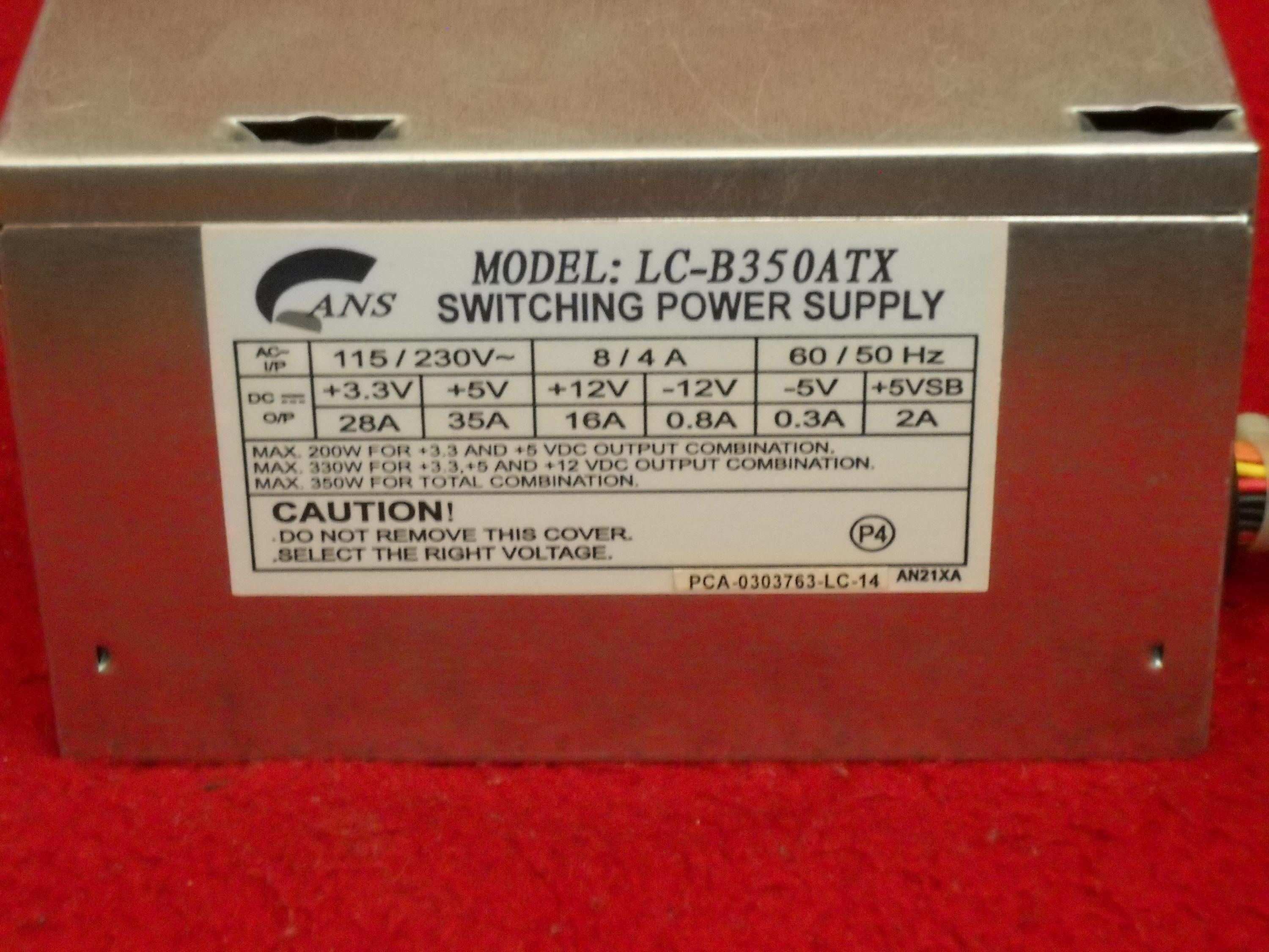

    This one is also a ANS LC-B350ATX,with a darker color PCB,which I discovered it's not due to the fan seizing,but because of what it has been made of.
    Anyways,I just tried this one to see if it works,and surprisingly,it works fine. No sparks or flying parts.
    I guess it's good for modding?

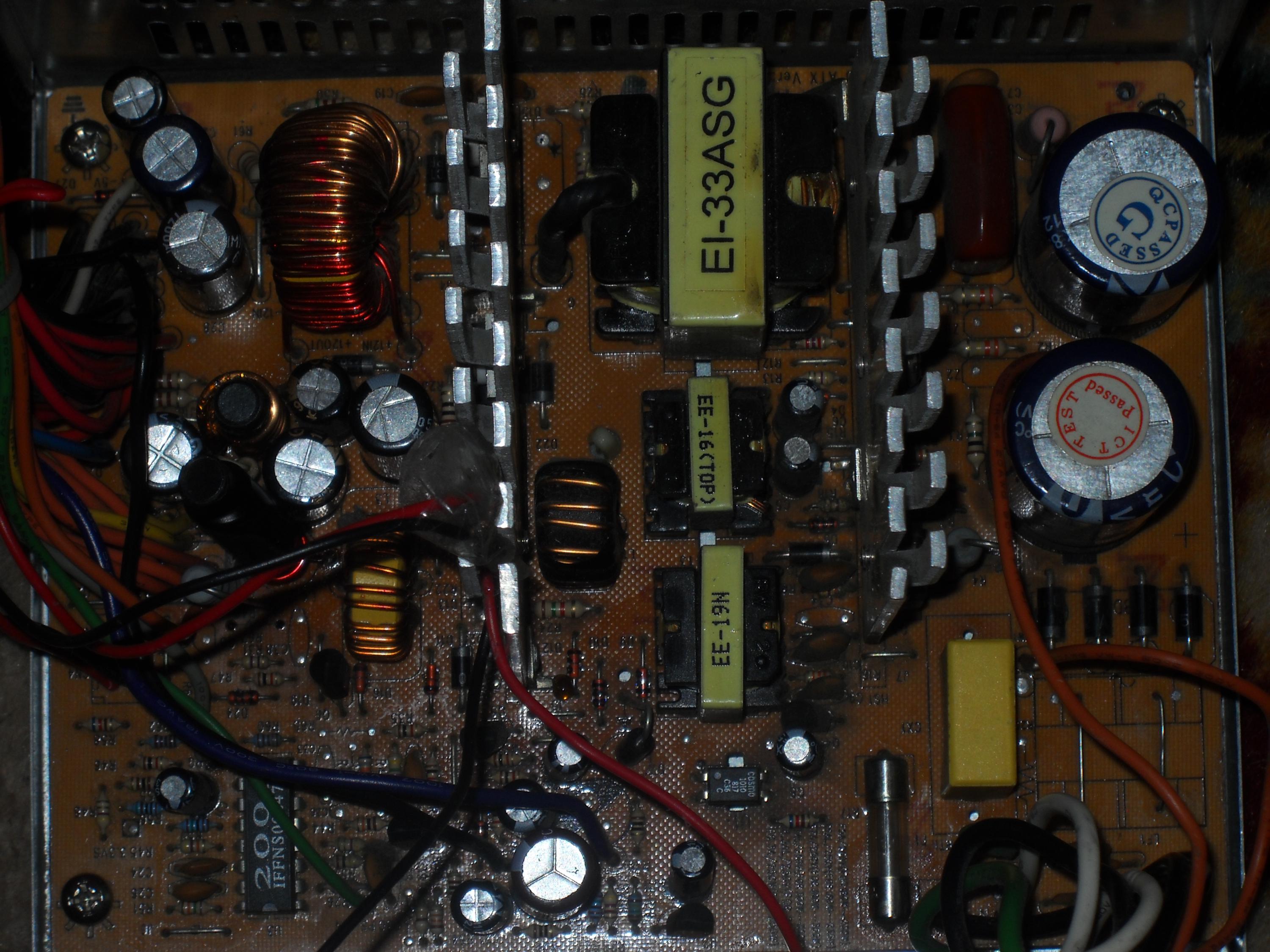

            Okay,here are the pics of the psu.
            PSU:

              Eh, doesn't look like it's worth modding. Unless you just want it for a low power computer.
              To get more power you might need to find a bigger transformer with the right pinouts, winding phasining, turns ratio, etc.... that's difficult.

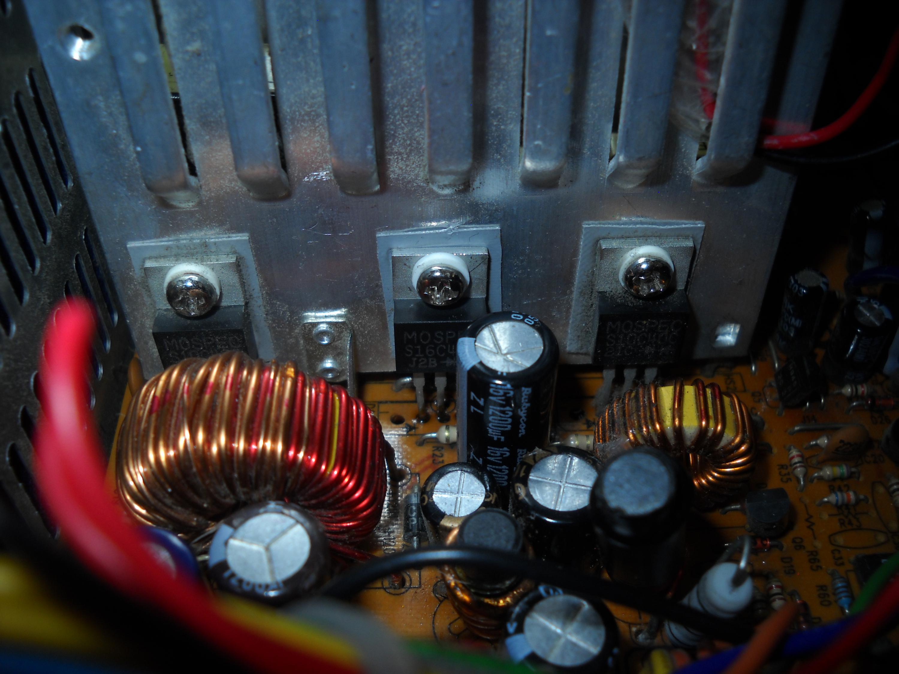

                Given good parts (sans a bigger transformers,as I've seen good EI-33 PSUs work with P4 without problems) it may work.
                I'll try fiddling with 12v by installing a SBL3040PT (along with the same on 5 and 3.3v) and run a Preshott with it for fun. If it works fine,then it's good to use. If not,then a 20A part may do.
                Also worth mentioning that if this idea works I think it might help equalizing the 5,3.3 and 12v in terms of voltage. (though not sure atm)

                  But that's one of the things we love to see here on BCN - cheap, terrible PSUs so that we can poke fun at them, thus informing anyone that reads BNC why they are bad.
                  DON'T!
                  You will likely short out that rectifier. Or at best, the PSU will not work.
                  Either way, it is a bad idea, because that rectifier will actually see, at minimum 35V reverse voltage. That's because in half-bridge PSUs, you will have 2x the voltage of each output rail + some headroom voltage.
                  Therefore, you will want at least a 60V-rated rectifier for the 12V rail (but preferably 100V). On STF topology PSUs, however, you can use a 40V or 45V part on the 12V rail and it likely won't cause a problem. I know Bestec, for example, often uses a single 20A 45V schottky rectifier for the 12V rail.
                    Deer uses 40/45V parts for anything on the secondary...

                      Not the 12V rail. At least I have never seen it. If this is something they have started doing lately, then they deserve a . It's simply a piss-poor decision to put 40V or 45V rectifiers on the 12V output rail of a half-bridge PSU. You will be running them really close to their rated reverse blocking voltage. Just one spike on the input (and considering how most cheap L&Cs don't even have a line filter), that spike will go straight through to secondary. And then you wonder why you get so many of them dead.

                        Hm, yeah, I too noticed that it was a 40V rated part. I didn't say anything though
                        Heck, I wouldn't be surprised, based on the quality of the rest of the PSU.

                          Oh well. Then will a S20C60C work for the 12v? It's 60v.
                          Gonna complete the line filter soon BTW.

                            Probably yes

                              Yes.
                              Save that 30A for the 12V rail of a STF PSU. See post #9 again.

                                That's true Rubycon in there?
                                  Yes. It's from a motherboard,so genuine 100%.

                                    So not original? I wondered since where they started using Rubycons
                                      There's also an NCC cap in there, I don't ever recall them using those either xD
                                        Now it even has an complete line filtering...
