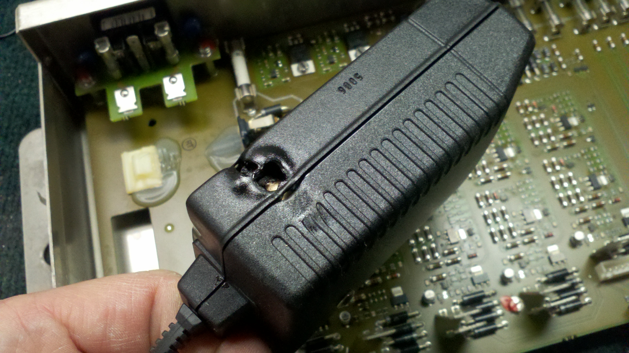

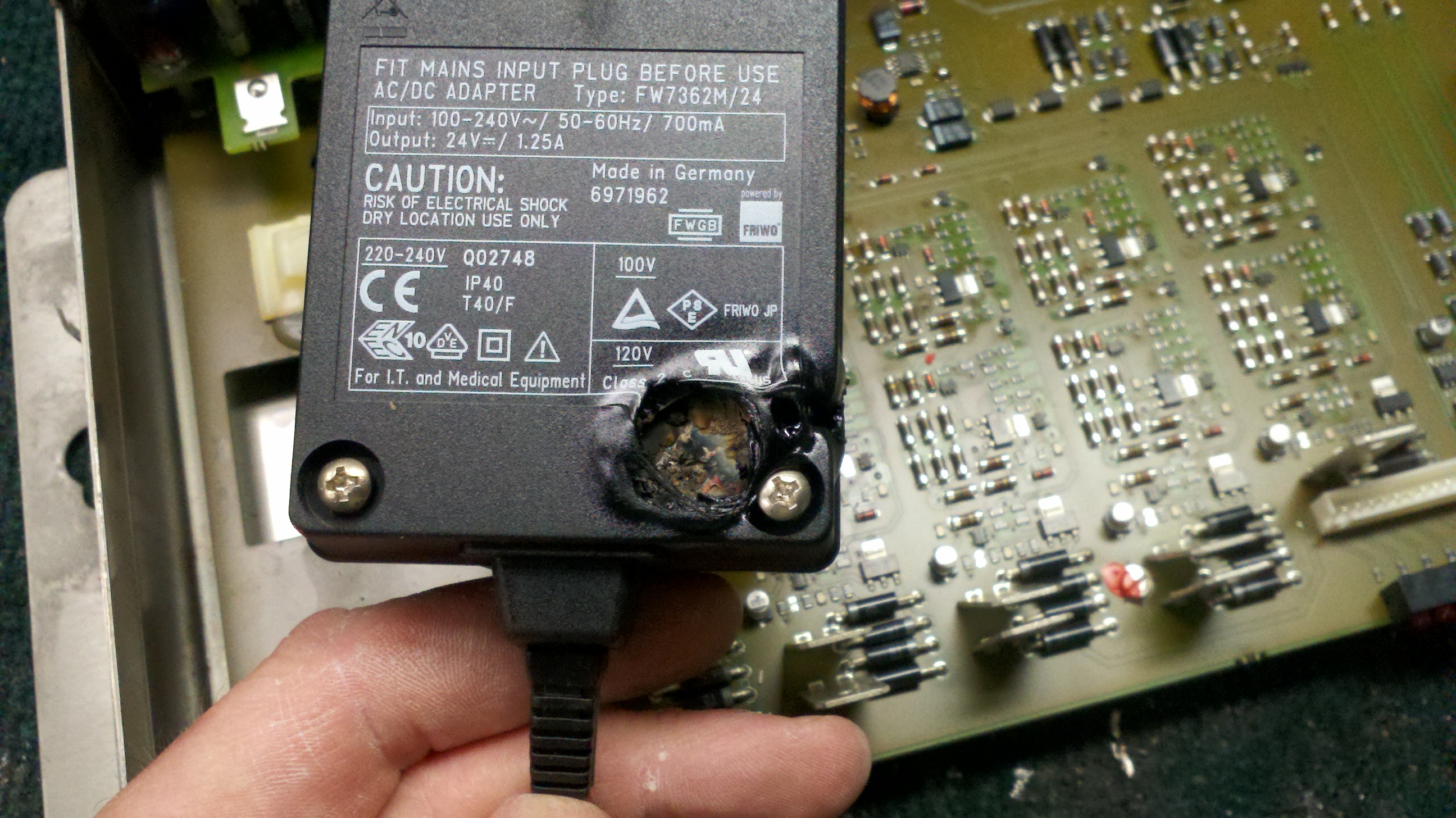

    Fire in the hole!
    this would have been nice in the normal places a wallwart usually lives.
    like behind a sofa or curtains.
    in this case it was contained inside a tight enclosure for a paint mixing scale interface.
    looks like the larger cap leaked out its bung and started an arc path that grew.it was a panasonic fc 470/35

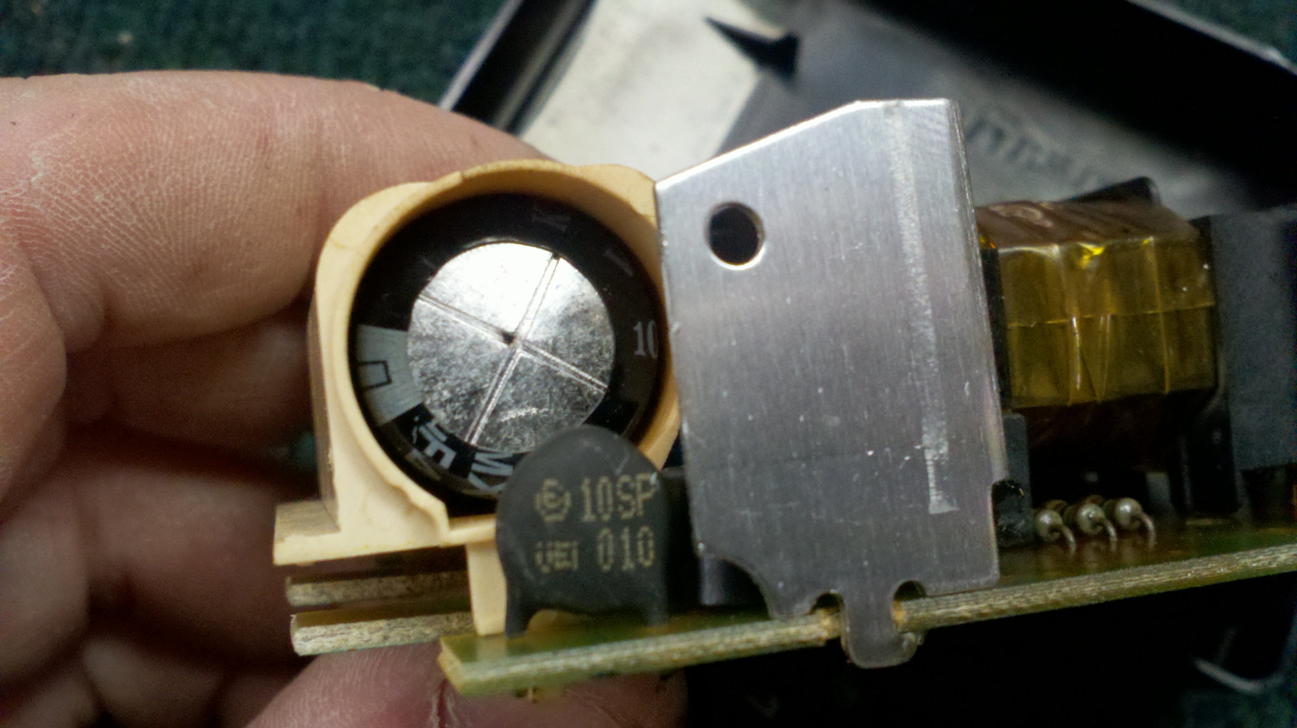

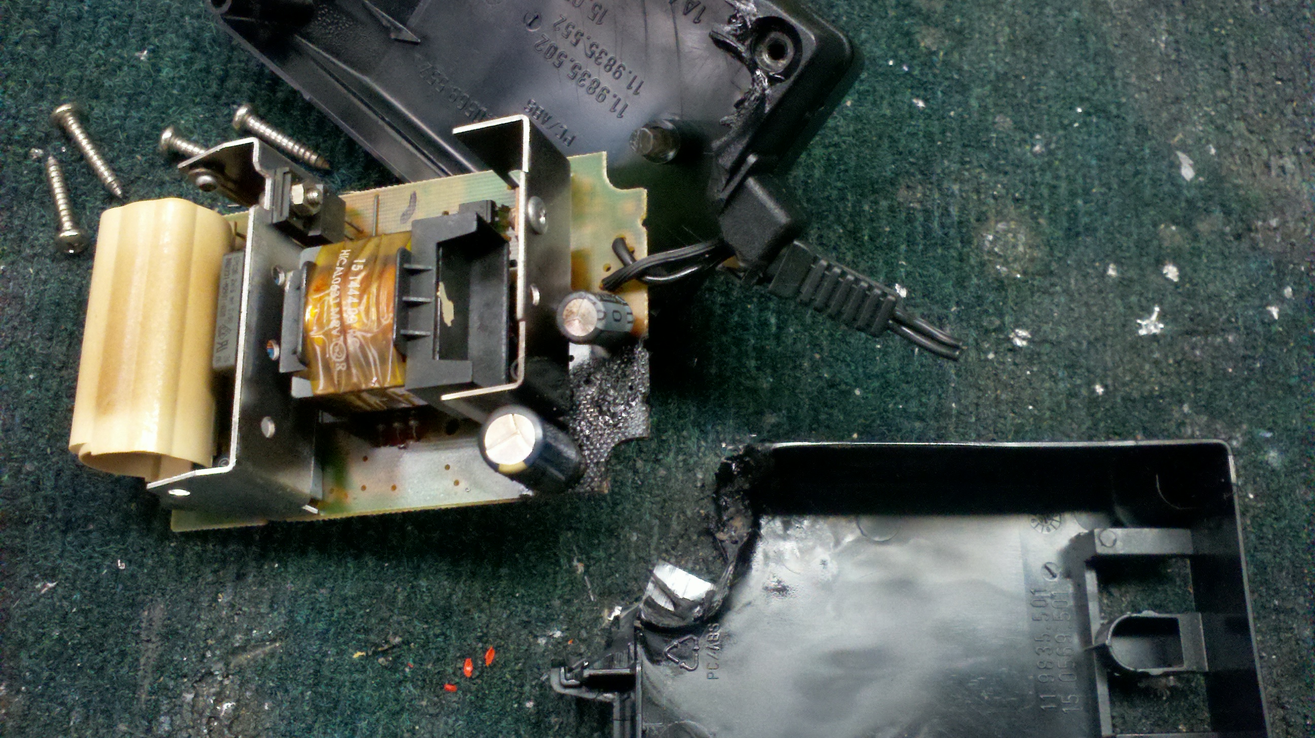

      Re: Fire in the hole!
      I wish all bricks had screws like that to make them easy to take apart.
      Is the big bulged cap Samxon?
        its already fixed.
        had to wash the motherboard from all the cap juice and soot.
        and to reduce the odor as much as possible.not good to have a caddy dealership stink of electrical fire.
        didnt look at the primary cap.took it to the dumpster asap.

          how much pcb was left after you ground away the carbon??
          • ben7
            Capaholic
            • Jan 2011
            • 4059
            Damn, scary! Glad it was caught before it started a severe fire.
            Is it just me, or is the little cap bulged? Maybe that is the one that leaked?
            If the panny did leak and do that, damn!
            Also, was the panny original, or did it have signs of being a replaced part? Interesting that it is in there, with a Samxon, and another unknown cap (looks to me like a chinese one ... JunFu maybe?).
            Argh! Samxon lets us down yet again!
            Also, that PCB in the background looks interesting. What the heck was it from? Looks like something industrial or automotive. (Or maybe medical?)

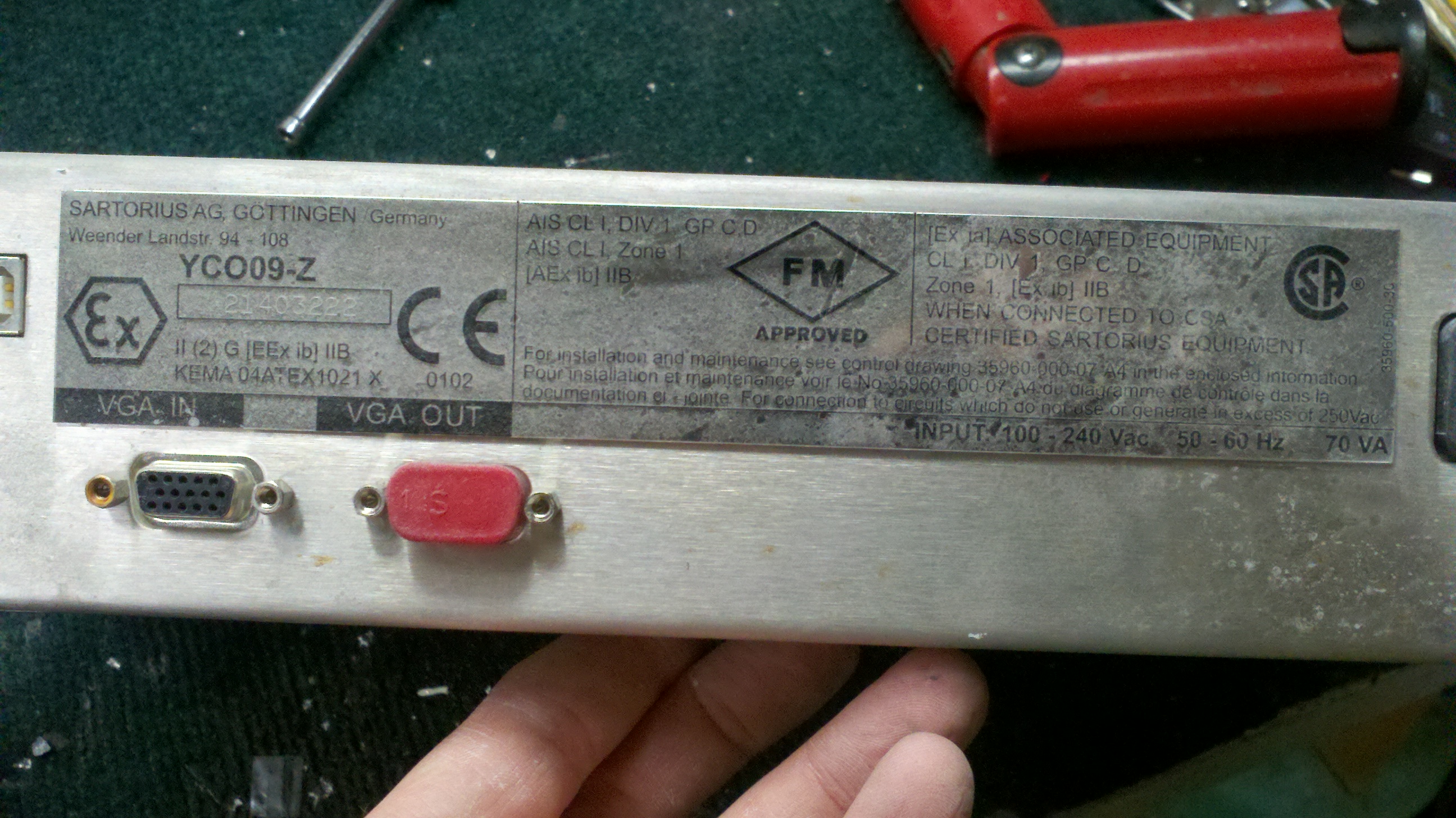

                  the board is of the unit.it doses paint and pigments for color matching automotive paint.
                  i replaced the power supply.
                    Wow. Just barely 30W, this adapter, and it nearly became a firestarter.
