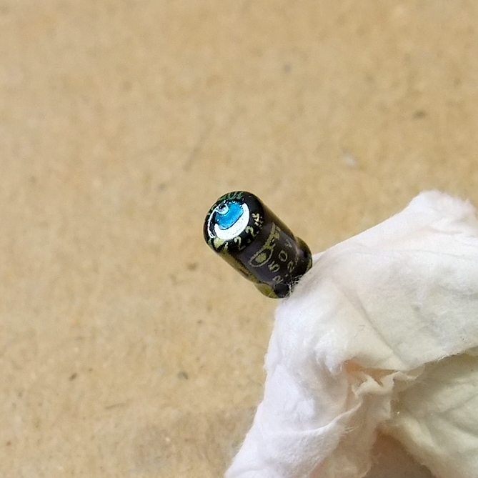

                  The tiny cap turned out to be 2.2uF 50V - I noticed one thing, I don't know if it is relevant but on the top of this cap there is a little sign of a bluish substance, I don't know if it is a leak or whatever; the first time I saw it I didn't give it so much importance since I thinked it was a sign of a blue marker that sometimes you find on caps. I attached a picture of it:
                  I started to replace this but, again, nothing changed.

                    • 31277
                    Re: Fortron FSP300-60GLS: starts/spins/dies
                    the blue is ink from a pen,
                    you often find caps marked by the factory for whatever reason.
