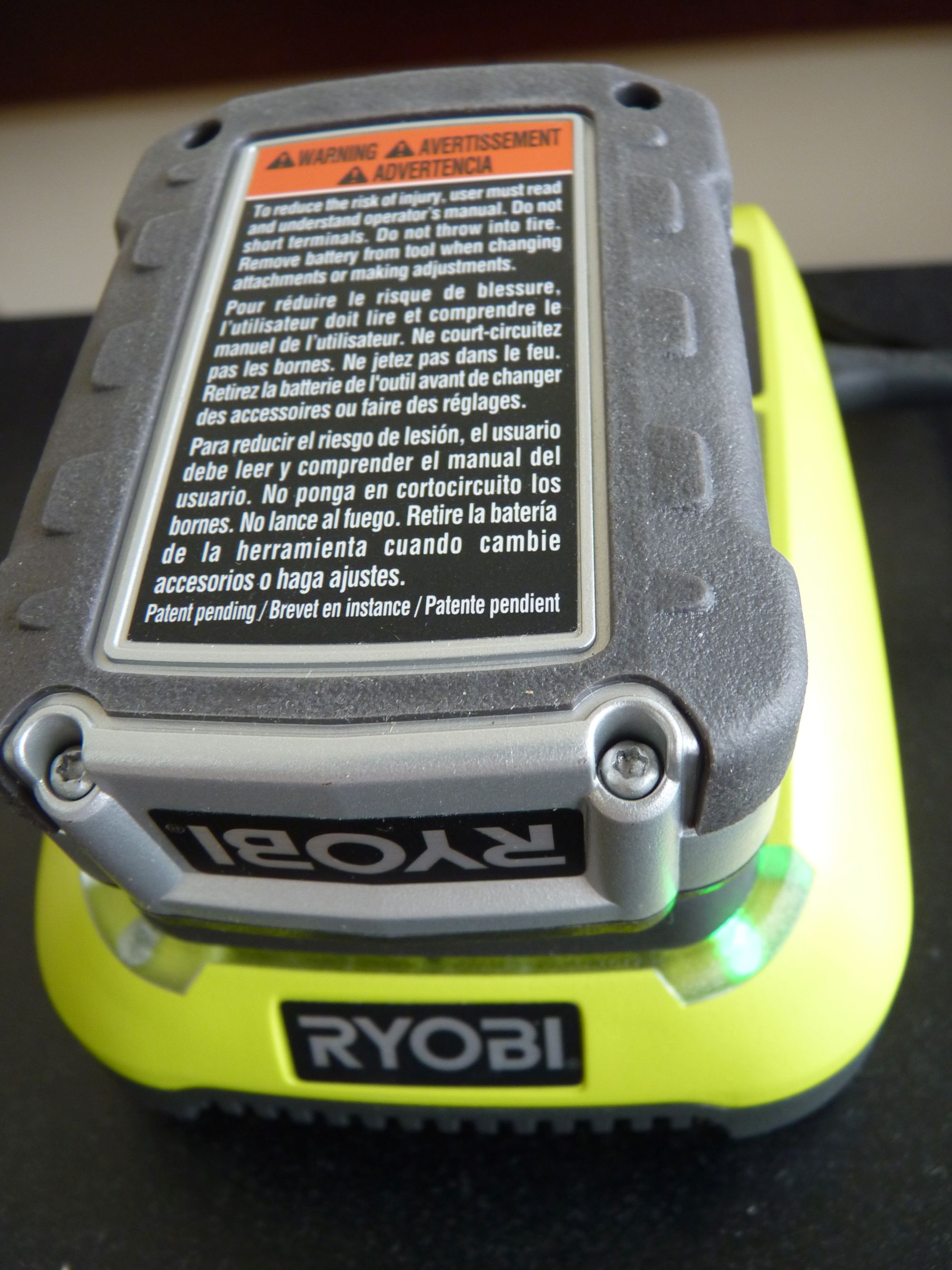

    Sorry I didn't have a chance to complete this repair yet. Now I re-tested the removed cap, and it shown 0 Ohms in both directions, and also meter emitted sound on "short" test both ways. Does it confirm "tin whiskers" theory? I don't see them on the board. Despite all this, it measured 250uF stable capacitance versus 220uF rated. How is it possible?
    I doubt it is tin whiskers. I don't think they grow inside capacitors... usually they grow on the solder terminals outside.
    It seems strange it could measure shorted and still test OK with capacitance. I don't understand that, unless it just has a really high leakage current or something.
    Originally posted by sambul83
    Open question however remains, why did it die prematurely without being used...
    Same way anything does... sometimes it just happens.
    -David VanHorn

      No it does not make sense, something is not being measuring correctly some where, it is like measuring a piece of copper wire and it show lots of capacitance.
        My guess would be reduced breakdown voltage. The meter doesn't test with a high voltage (high as in more than a few volts), so it seems fine when measuring the capacitance, but it breaks down (high leakage current) at the circuit's operating voltage.
        I'll get C203 cap replacement. Yes, its 0.2 Ohms reading went away once removed from the board, but... I can't say what it is now. Once out and fully discharged, it measures from 30 kOhms slowly growing to 2 mOhms, then suddenly drops back to 15-30 kOhms, and start growing again towards mOhms. Is it normal for caps? I assume its bad, since without it the charger shown signs of life?
        I think you must have meant mega-ohms instead of milli-ohms. I use MOhms for mega-ohms, and mOhms for milli-ohms.
        It sounds like either your probes have a bad connection to the cap, or the cap's dielectric is breaking down, causing it to discharge what little voltage/energy that accumulates from the resistance test.

          Originally posted by budm
          I would replace C203 first and see what happen, without that high capacitance in place the circuit may be oscillating.
          Sorry for the late update, I finally got a hold of new adjustable soldering iron, replaced C203 cap as suggested, and the charger is now working like new again - already fully charged 2 batteries. Ryobi service told me earlier, they don't repair chargers out of warranty, just buy the new one for $40. Amazingly, just one 30 cents cap replaced, and the charger is "brand new" again. Appreciate budm and other guys for help in this matter.
