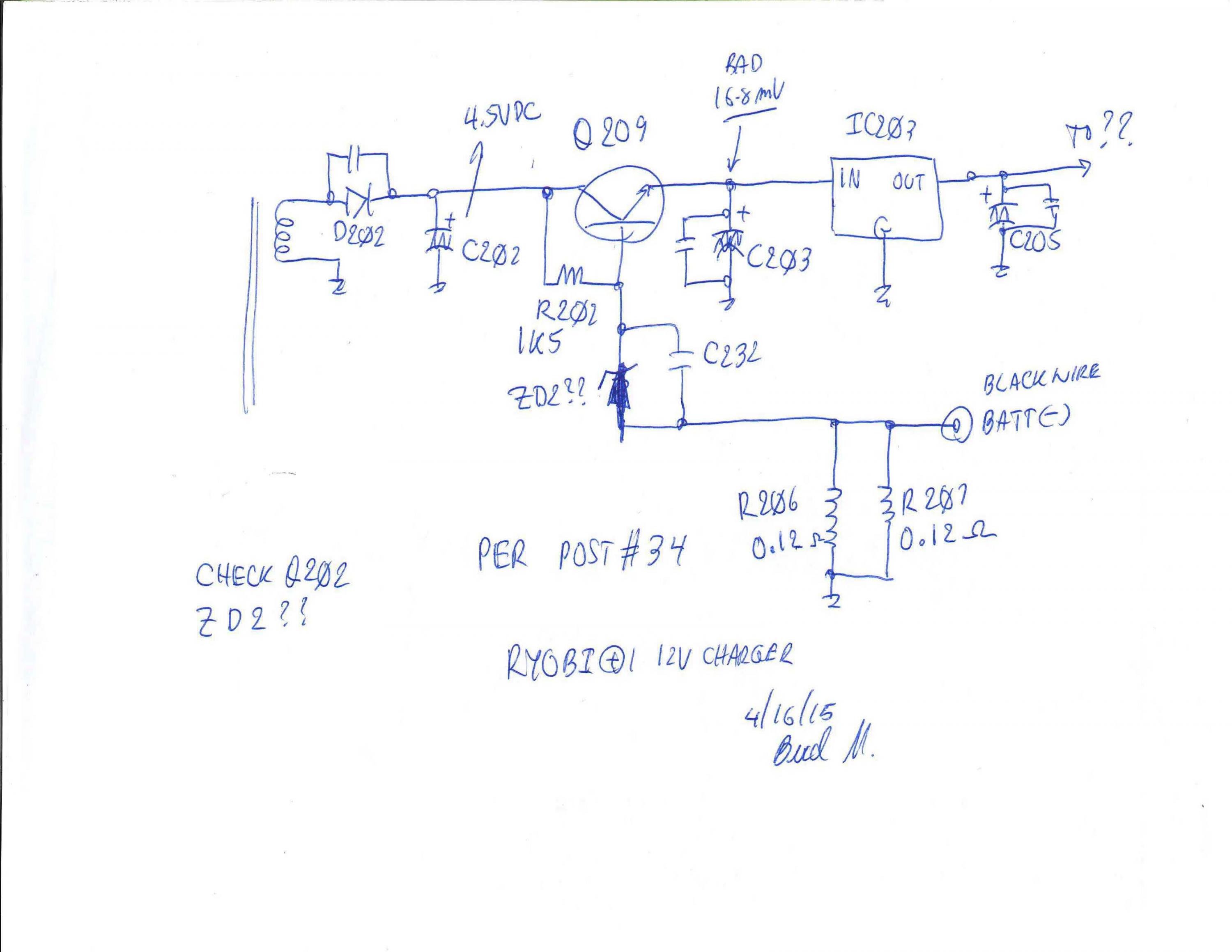

    Did you mean D201 on the smaller heatsink right behind the transformer? This one has 3 legs and looks like SMPS IC.
    As to C3E H62 (IC203), I already mentioned it was 16V at every pin, but now:
    Left pin = 9.8 mV (its mV, not V)
    Center pin = 27.1 mV
    Right pin = 25 mV
    Tab = 27.1 mV
    Yet the question remains, how a charger can possibly die without being used, unless an electrolytic cap is at fault - or its a time bomb?

          OK, I traced out the board, this is what I come up with.
          I would check Q209, ZD2???.
          Also check the resistance between the two legs of C203, C205 to make sure there is no shorts to ground.
          Check the Voltages without the battery in place.

            Transistor c1815 gr8e (Q209) What should I measure here, under power?
            Did you mean Q209 on your sketch (not Q202 - can't find it)?
            Zener unknown (ZD203). Its 750mV in one direction, and 790mV continuity in the other with power off.
            I checked resistance btw caps legs with power off, and for C203 (L-Tec 220Uf 16V SM85C) its near 0 (beep on continuity check), and for C205 its higher than 20+MOhm.

                It is Q209 as shown in your picture:
                https://www.badcaps.net/forum/attach...4&d=1429208748
                If C203 shows 0 Ohms then that is not right, use Ohm mode and check it both ways with your probes, no power to the unit of course.
                BTW, Q209 and the Zener is just a simple linear regulator, the 4.5VDC as you measured is kind of low to feed two regulator, but that low Voltage reading may be due shorts that you find across C203.
                What is the voltage rating of C202?

                  Q209 measures 1-3 750mV, 1-2 715mV, 2-3 740mV with power off, where 1 is emitter
                  ZD203 is 750mV in one direction, and 790mV in the other
                  C203 is 0.2 Ohm both ways
                  C202 (L-Tee 100uF 35V 110c(M)) is 4.3V now may be due to outlet power fluctuations
                  But... IC203 was showing 16V to the ground on all legs, and now its near 0. Does it say anything to you?

                    "C203 is 0.2 Ohm both ways" Right now this is the key to the problem, it is either the cap C203 is shorted, or the very small SMD (MLCC) cap C207 that is connected in parallel with the C203 is shorted, or the regulator IC203 has shorted input, I suspect the SMD cap C207.
                    So basically you will have to start removing parts connected to the + leg of C203.
                    "But... IC203 was showing 16V to the ground on all legs, and now its near 0. Does it say anything to you?" That does not make sense because you were getting in mV on C203 which is connected to the input pin of the IC203 regulator and C203 also show 0.2 Ohms.
                    I cannot speculate as to hwy the unit failed without being used for a long time, but looking that very simple transistor/Zener linear regulator circuit it should be working and not showing 0.2 Ohms across the cap's legs.
                    I hope it is not your measurement errors.

                          I mean no measurement error. OK, I took C203's out, and it measures 250uF on multimeter (rated 220uF), and resistance fluctuates 30 kOhms - 2 mOhms.
                          C204 measures 14kOhm both ways when C203 is out. Should I remote C204?
                          I tested the board withoutC203, and here we go:
                          Red led is lit now!!!

                              I would replace C203 first and see what happen, without that high capacitance in place the circuit may be oscillating.
                              The question is 0.20 Ohms reading went away?

                                I'll get C203 cap replacement. Yes, its 0.2 Ohms reading went away once removed from the board, but... I can't say what it is now. Once out and fully discharged, it measures from 30 kOhms slowly growing to 2 mOhms, then suddenly drops back to 15-30 kOhms, and start growing again towards mOhms. Is it normal for caps? I assume its bad, since without it the charger shown signs of life?

                                  I was thinking this might have been tin whiskers around the cap?
                                  It would explain why it died in storage and why the shorted cap tests ok out of circuit.
