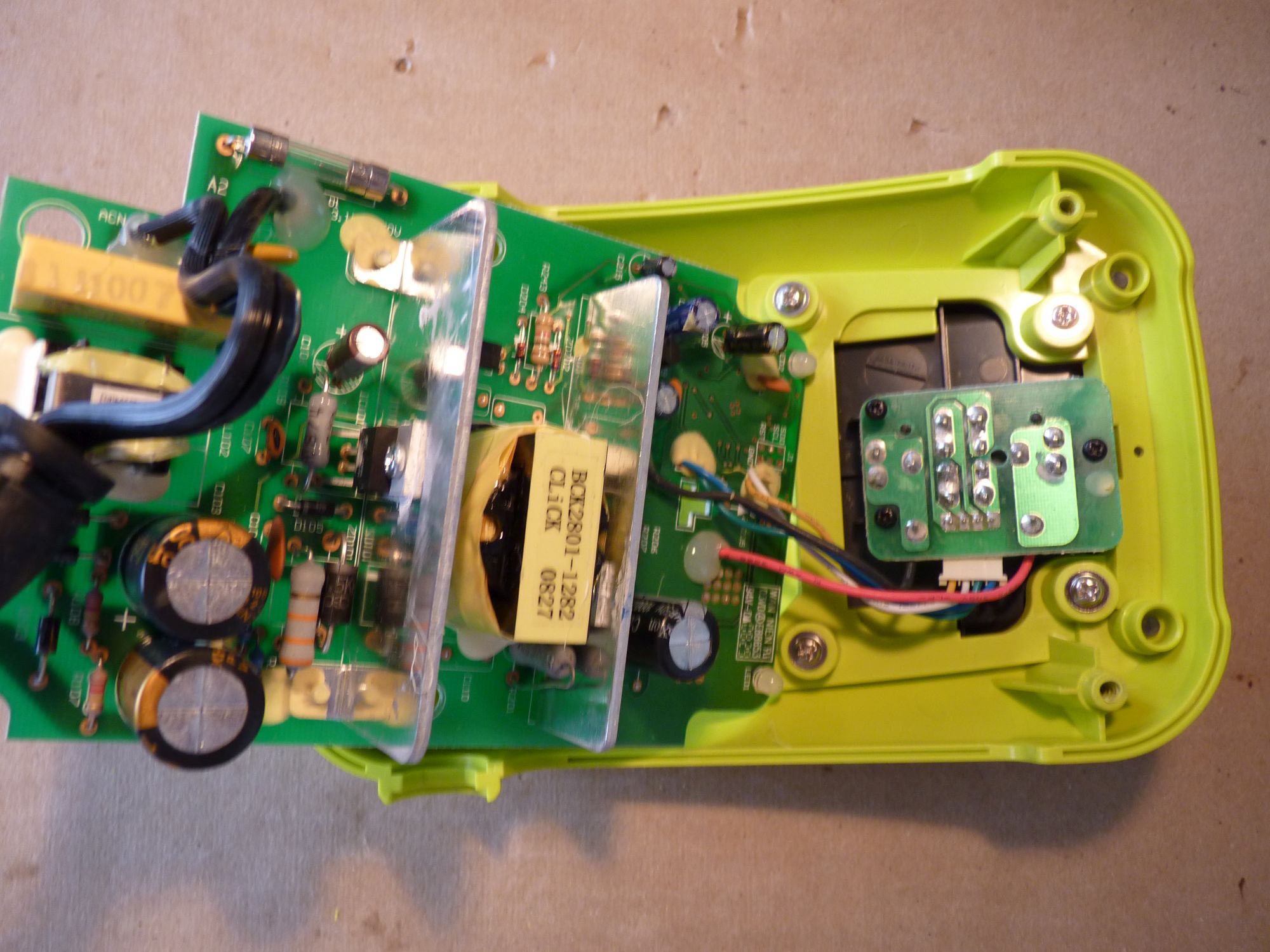

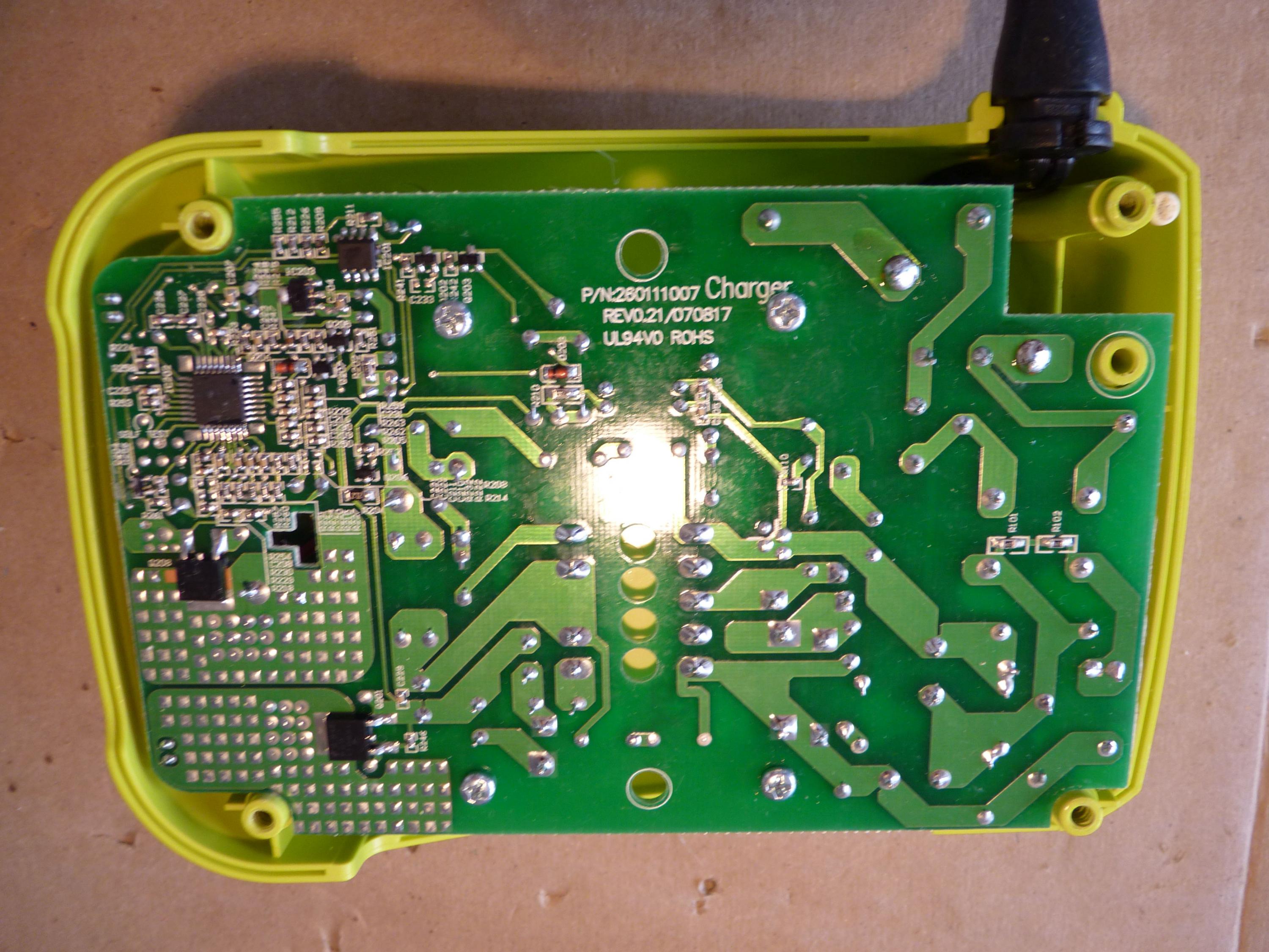

    Hi guys,
    My Ryobi CH120L Li-Ion Battery Charger suddenly died after sitting in the closet for some time without being used. No lights at all, doesn't charge any battery, no voltage btw Battery Charging Terminals. It measures 0.06V btw Battery Control Terminals. The fuse checks OK for continuity. Here's its Manual.
    I suspect its the same Bad Caps saga again, may be more.
    Can you suggest how to pinpoint the failing parts? I don't have any electronic components stocked, so can't try freely which replacement will do.

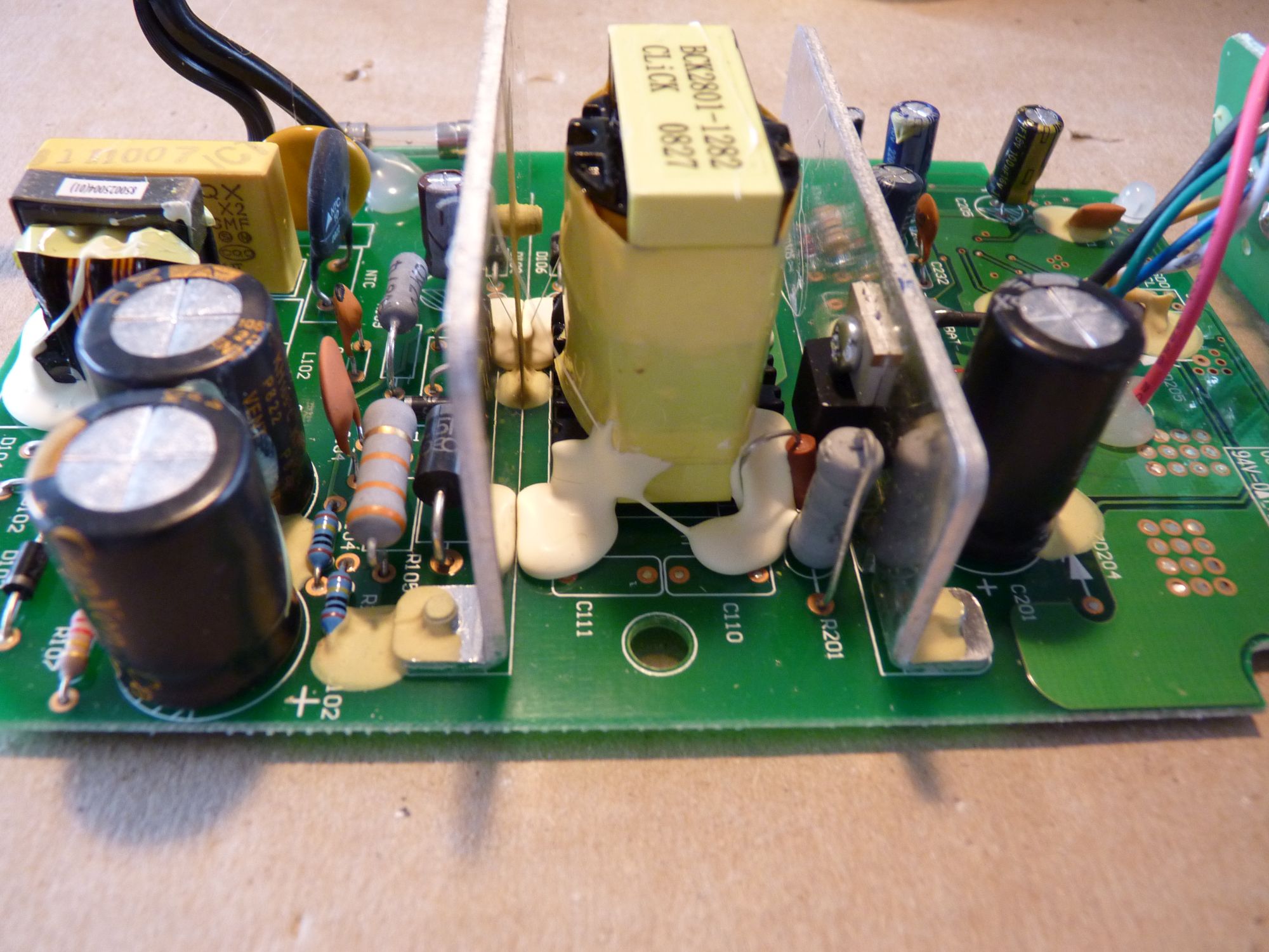

    get rid of the yellowish brown glue.esp on the primary side.see the mess around that 33k resistor? a leak to ground stops your startup.

      Not sure where exactly, can you circle the right places? Also, it was working well like that for 3 years, I never opened it before, then it suddenly doesn't work anymore without being used. As I read, they glue the parts on one side so they don't fall out from hits in transportation.

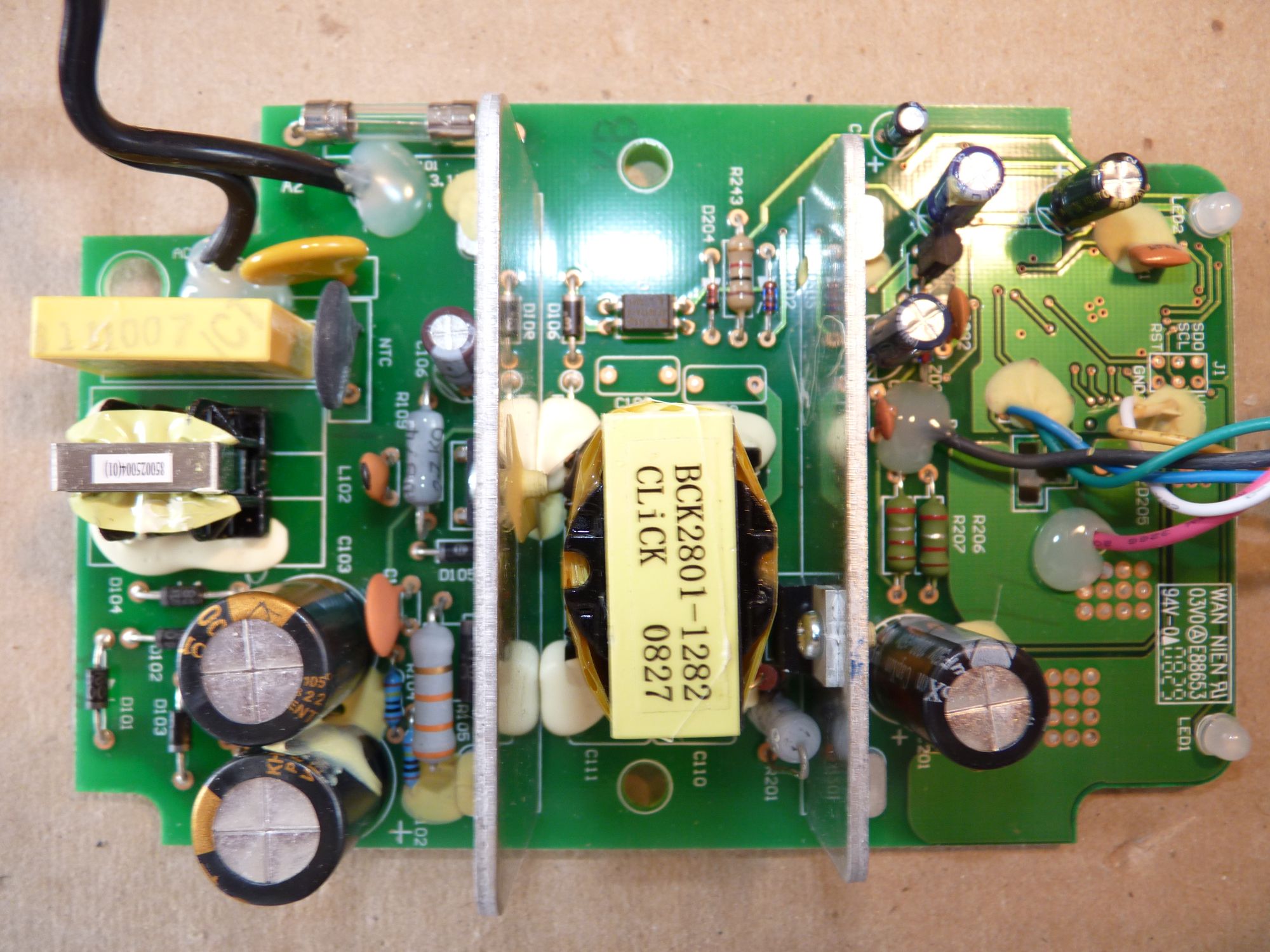

        c106 is my primary suspect.

          Also test D106 to make sure it is not shorted

            c106 is CapXon 47uF 50V Vent P828 GL 105C. As I understand, reliable checking it is only by replacing with the same value cap - correct?
            I also read somewhere that c201 cap CapXon 1000uF 50V was the problem, but in their case there were some lights working on the charger. Can this cap be a problem here with no lights and no voltage on battery terminals?
            d106 I checked for continuity on the board like a fuse in both directions under power, and its not shorted in one direction, and shorted in the opposite. Was that a correct method? It looks like a diode should work like this?
            What's position of "33k resistor under glue", or position near it?

              Re: Ryobi 12v Li-Ion Battery Charger dead
              When you resistance testing or Diode mode testing, no power to the unit.
              Check the DCV between the two leg of C106 with power applied, since you will be working in the primary (deadly side) side of the circuit, you must be real careful not to touch anything with your hands or body, you should at least plug this unit into GFCI outlet for some protection.

                Glad to meet you again. I checked DCV, and its 0V on c106, and respectively 0v on c102 and c103. Its 14.3V on c201. I checked the diod d106 with power off, and it shows no continuity in both directions.

                  Ok thats a bad reading on the diode... Remove from circuit and test

                    Ops... my error. When I checked the diode on the board, I only listen for multimeter beep. Now I looked at the display, and it shows OL in one direction, and 540 mV in opposite direction. Does it mean the diode is OK?

                      yes, a good diode is around 450-550 usually.

                          whats the voltage at the primary caps?
                          thats the 2 big ones side by side.
                          edit...
                          0v at 102 103 means problem between the wall and there.

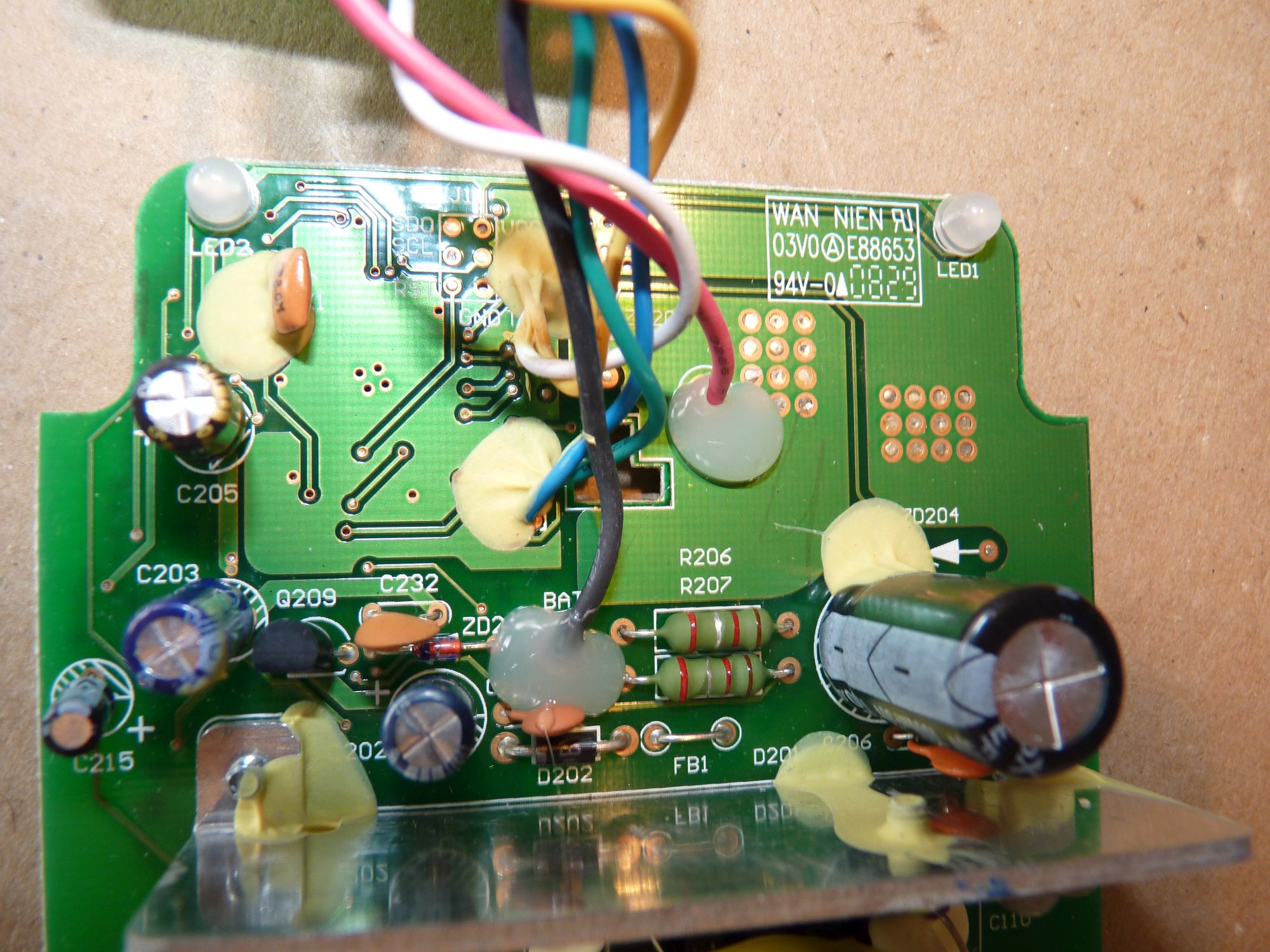

                            Sorry again, it was too late yesterday night, I was sleeping. Measured it today again, and the accurate voltages are:
                            6.65V on c106 (CapXon 47uF 50V), and respectively 181.7v on c102 and c103 (both are CapXon 100uF 200V). Its 16V on c201 (CapXon 1000uF 50V). All these voltages are stable. Wall outlet is at 116ACV.

                              What is P/N on that multi-leg SMPS IC? 6.65V for the start-up/running Voltage is too low, we need the spec sheet of the SMPS IC.
                              181Vdc on the main filter caps do not look right either, higher than it should be based on only 116Vac input.

                                  My meter VC9808 had a fuse open after an error in Temperature measurement. I changed the fuse, but it may need some calibration now. Though it measures 9v batteries at 9.8 to 10.2v, and 1.5v batteries at 1.5-1.6v, so DCV seems to be accurate, when compared to a battery tester measurements. But for wall outlet AC it shows 136ACV, while UPS shows 118ACV, so the meter's AC circuit may need calibration now. Not sure, how to calibrate it?

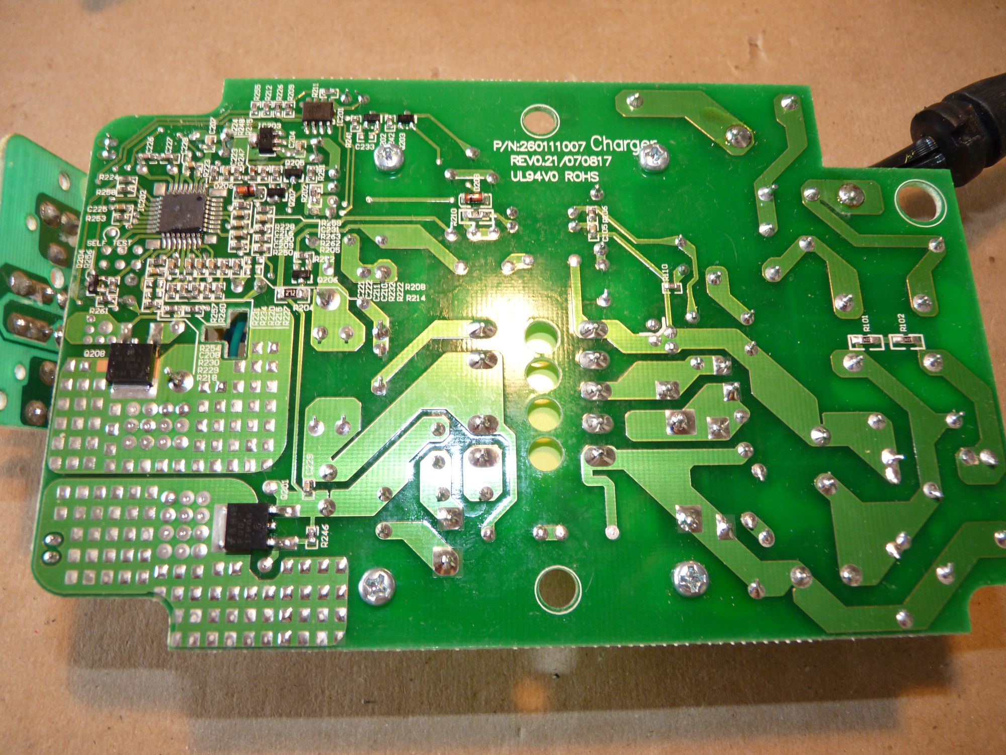

                                  As to the charger parts, the controller P/N is Atmel TBGA-FEB AU0820 - on the back
                                  The board P/N 260111007 REVO0.21/070817 UL94VO ROHS - on the back
                                  On the front side: WAN NIEN 03VO (A) E88653 94V-0
                                  Other parts:
                                  sfh617a optocoupler next to D106 diode
                                  fbh42 fod 17p06 mosfets on the back

                                    The SMPS IC is mounted on the heatsink, it has 4 or 5 pins on it.

                                      That one SMPS IC on the larger heatsink is H826 TOP245YN, and the other one on a smaller heatsink is hidden behind the transformer, but it looks and feels exactly like the 1st one.

                                        OK, here is the spec sheet, and per page 5 the control pin needs to have 5.8V to start the circuit:
