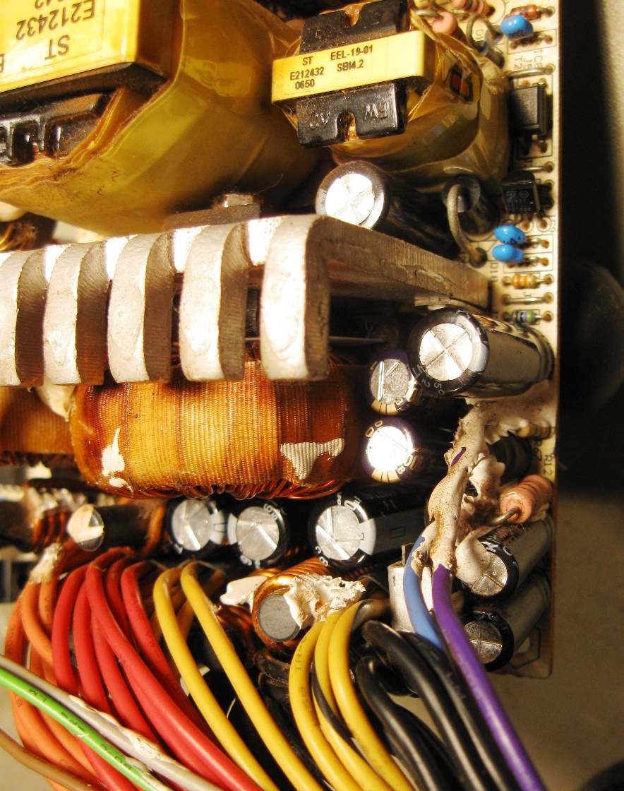

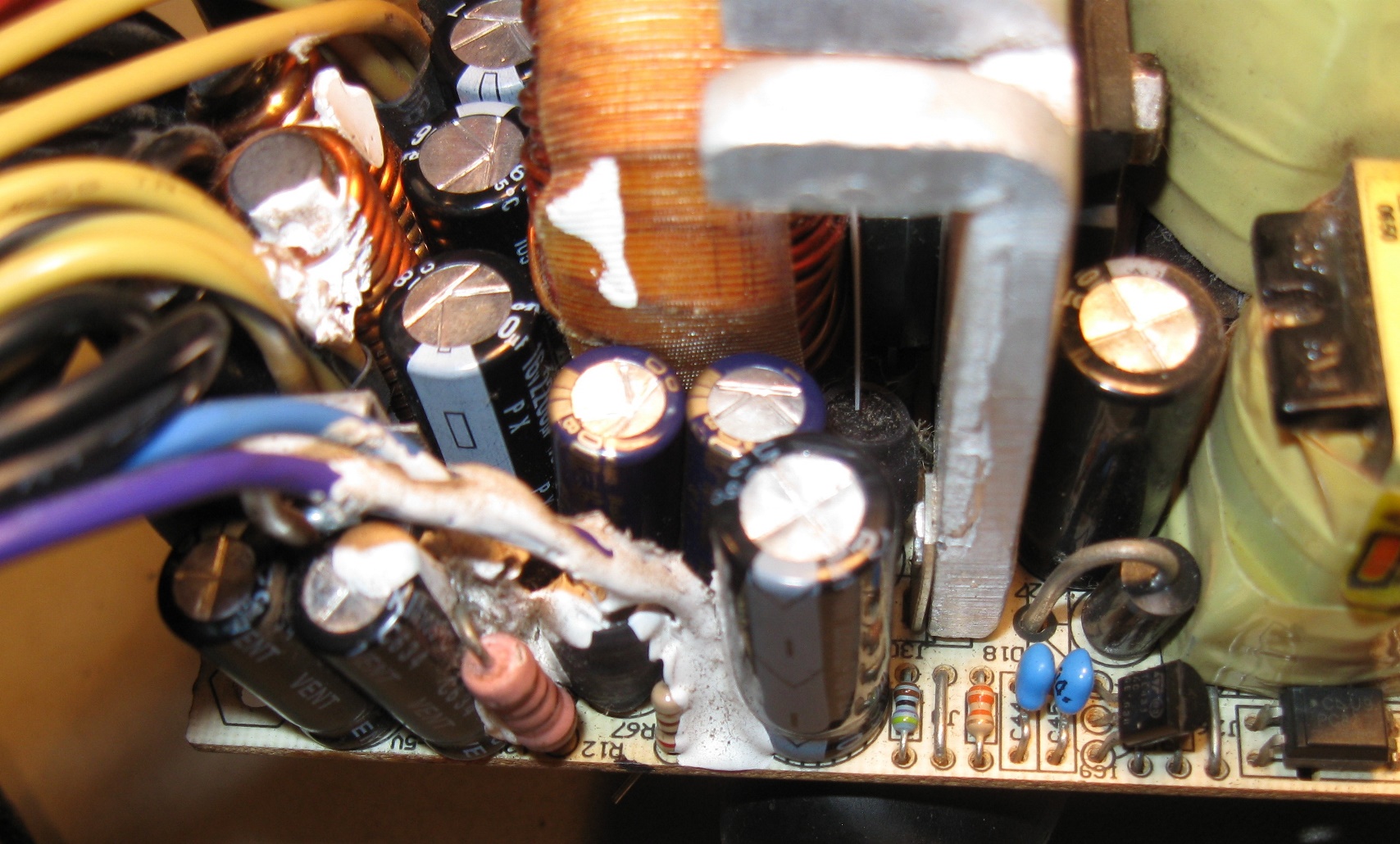

    Hey Guys,
    Need some advice from the electronic engineers amongst you.
    My PC went flaky last night.
    The fan had failed on the PSU and half a dozen caps were bulging.
    It's not a cheapie and has served well for 4 years so I am hoping to redeem it.
    I have the correct value caps except for the two new blue Ruby's under the heatsink beside the coil.
    The originals were 680uF x 16V Capxons.
    Would it be OK to use 1000uF x 16V as replacements here?
    I am hoping precise values are not critical.
    Thanks in advance for your help.
    Brett.

    what series of caps are you fitting?
    blue ruby's are mcz arent they?

      The two blue Ruby's are MBZ series.
        • 31293
        Re: Coolermaster Recap
        well the esr on those is way to low for a psu.
        you need something like a panasonic FC,FM,FK or FR preferably FR
        mbz should only be used on stuff like motherboards.

            1000uF caps will work fine there. And yes, Ruby PX are indeed unsuitable for PSU use. They might work OK for a bit, but it will make the ripple much worse, and they won't last as long. Use Panny FK if you need 2200uF 16V in 10mm diameter (http://au.rs-online.com/web/p/alumin...itors/0571606/)
            Also, replace the other two CapXons there, as they won't be far off failing (and may well have already failed without visible showing it these would do fine for them - http://au.rs-online.com/web/p/alumin...itors/7083572/

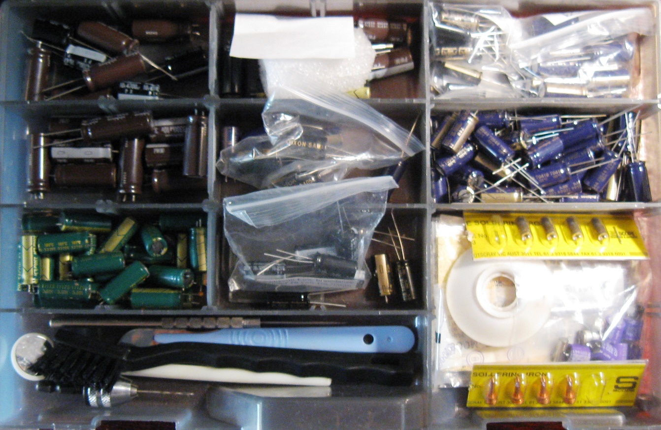

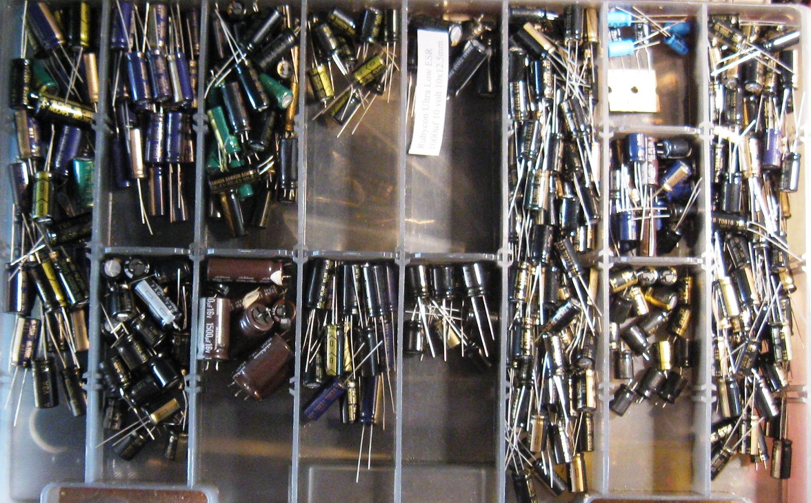

              Thanks for all your help guys. Seems I sure could use it. I have been using mobo series caps without realising these were unsuitable.
              Just had a bright idea. I no longer recap motherboards and have quite a lot of mostly Ruby's, some Saxon's and Nichicons in popular mobo values. I live in Australia.
              Would anyone be interested in doing a swap or alternately purchasing these? (see attachments)
              Here is what I need for my current project but I really should stock up on PSU repair caps now so would be interested in acquiring more.
