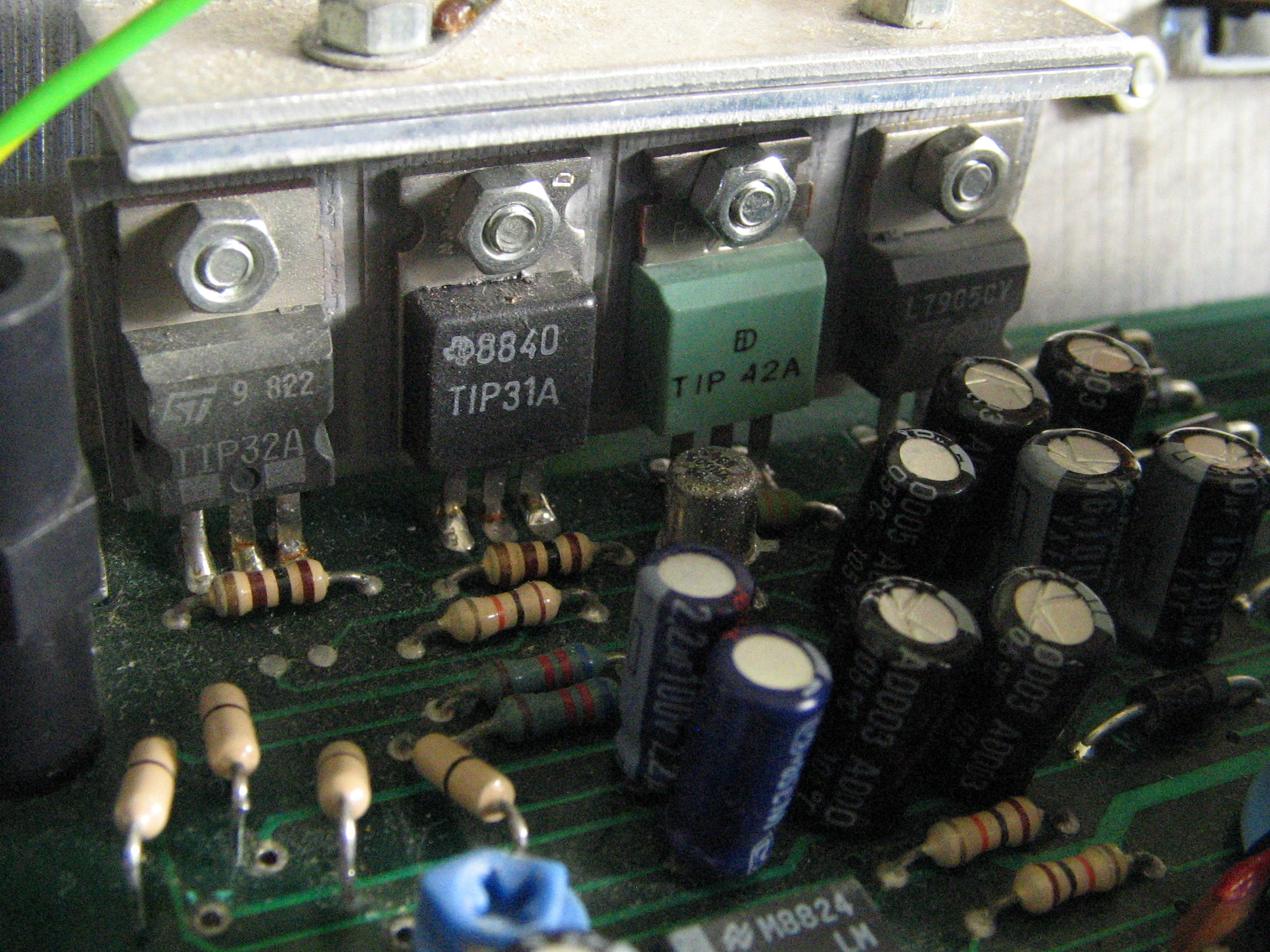

    What B-E junction? It's gone!
    Same for the B-C junction too - in fact the diode test function shows an open circuit on all pins in both directions.
    Looks like that TIP32 is dead.
    But if there is no base current, where did that 3.53v I got on the +5v rail come from I wonder? Perhaps the TIP32 is also leaky between E-C?
    I tried powering up without the TIP32, no voltage on +5v at all so I don't think that diode is leaky, anyway.
    It seems weird though that it only died after I put that 15 Ohm resistor on as a load, but then the toasted 33 Ohm resistor already hinted at damage somewhere, so...

                Well, I found some ancient green packaged TIP42As in a box (all I had) and put one of those in and now the supply is working again... to some extent. Regulation is out the window even WITH a load resistor. I get 7.8v now instead of 5v.
                I replaced the ZTX214, it seemed OK but I replaced it anyway with a brand new 2N3906, same problem.
                I also checked the main filter capacitors, they test at 8200uF for the 10,000uF one and 4200uF for the 4700uF ones. ESR is ~0.03 Ohms for all. The 4700uFs have 0.4v ripple at 100Hz on them. The 10,000uF has 0.3v ripple at 100Hz. This seems OK for the primary filter capacitors of a linear supply?

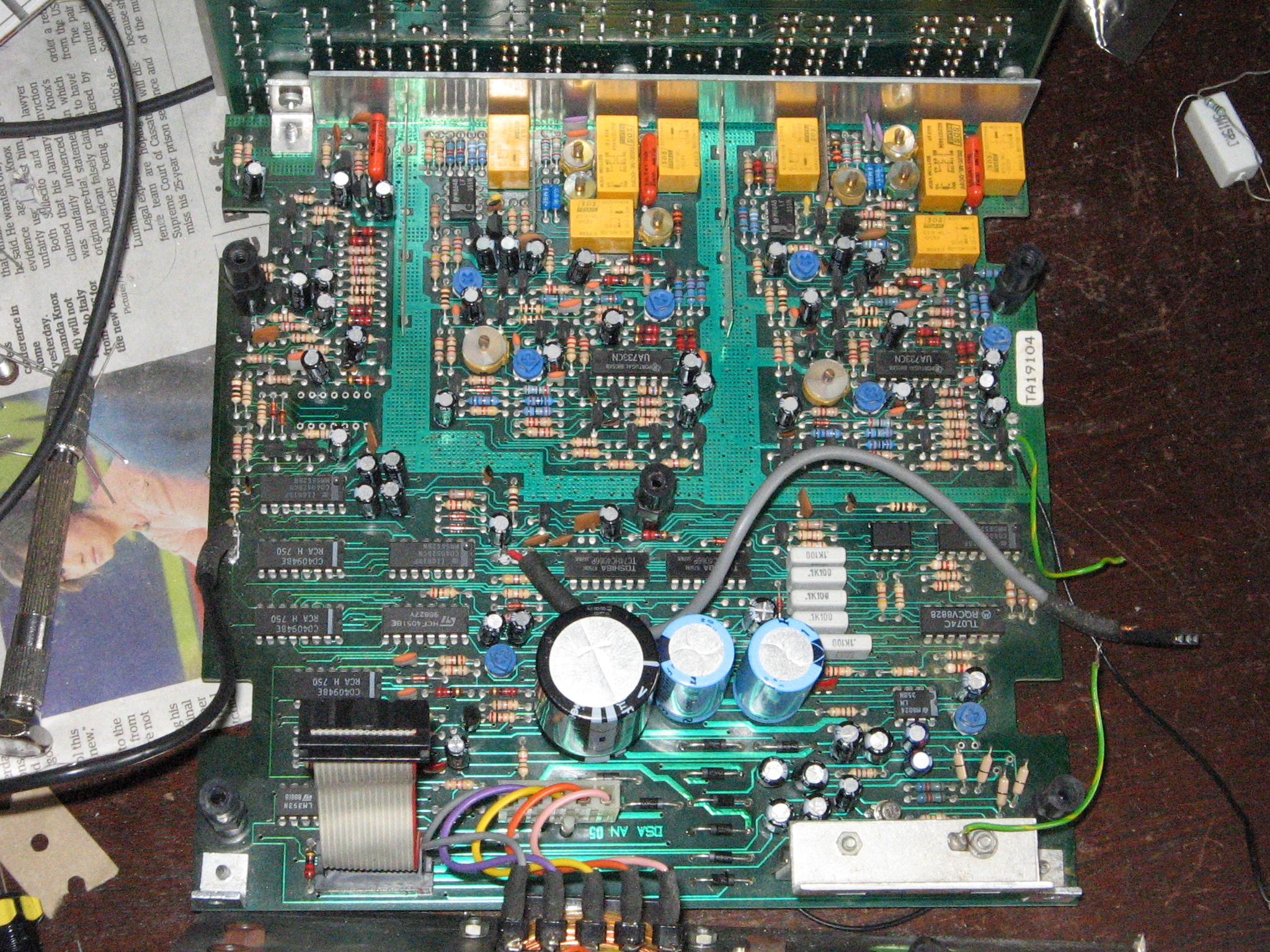

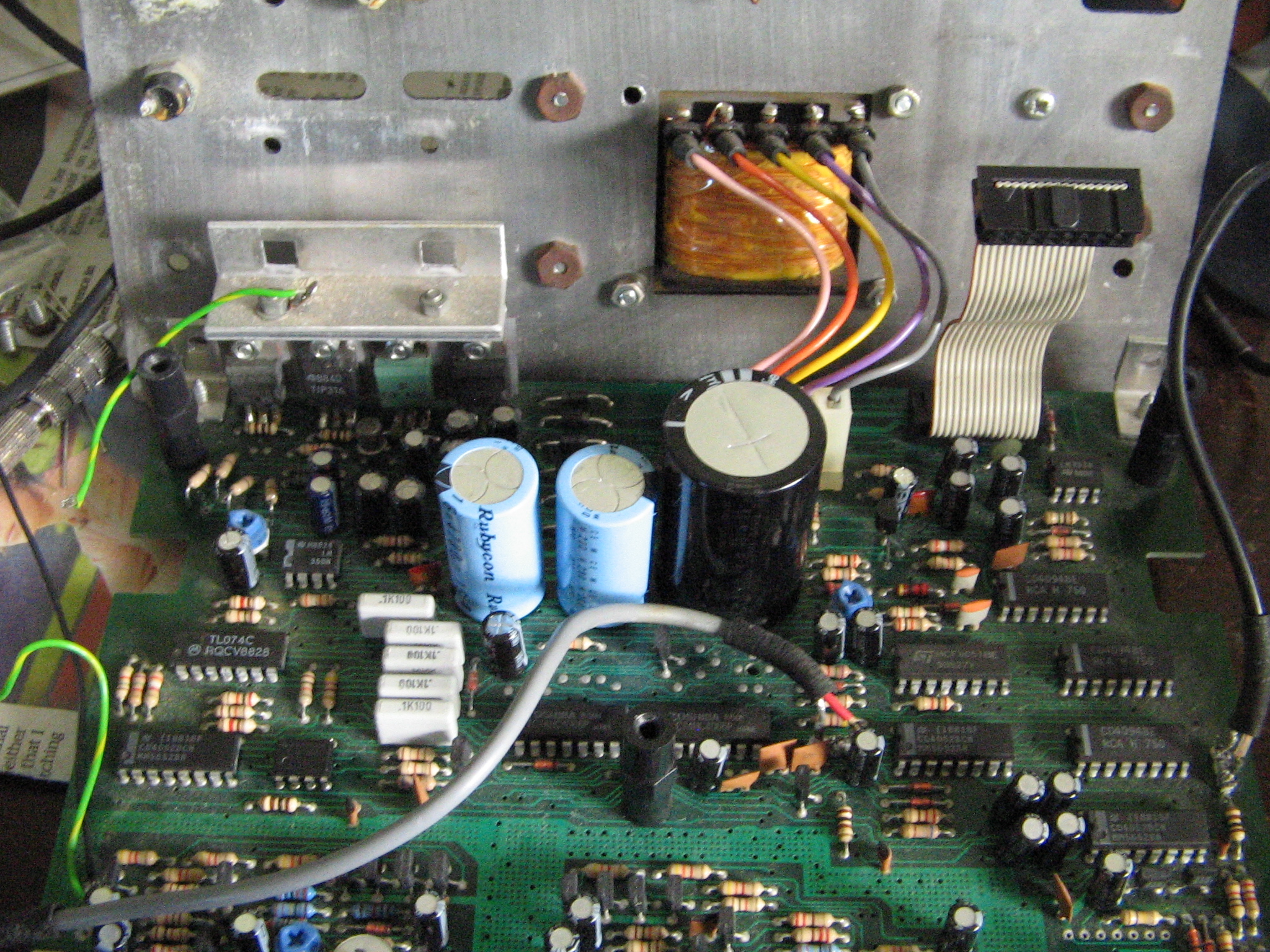

                                      Also added some photos to make this thread a bit more interesting.
