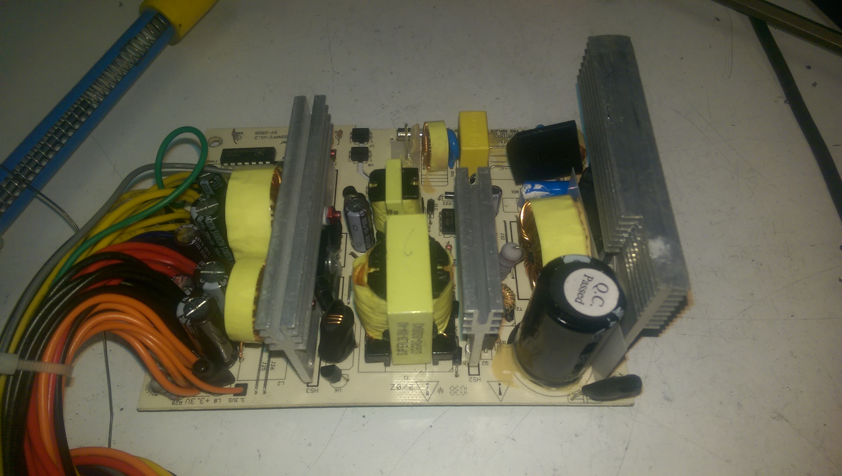

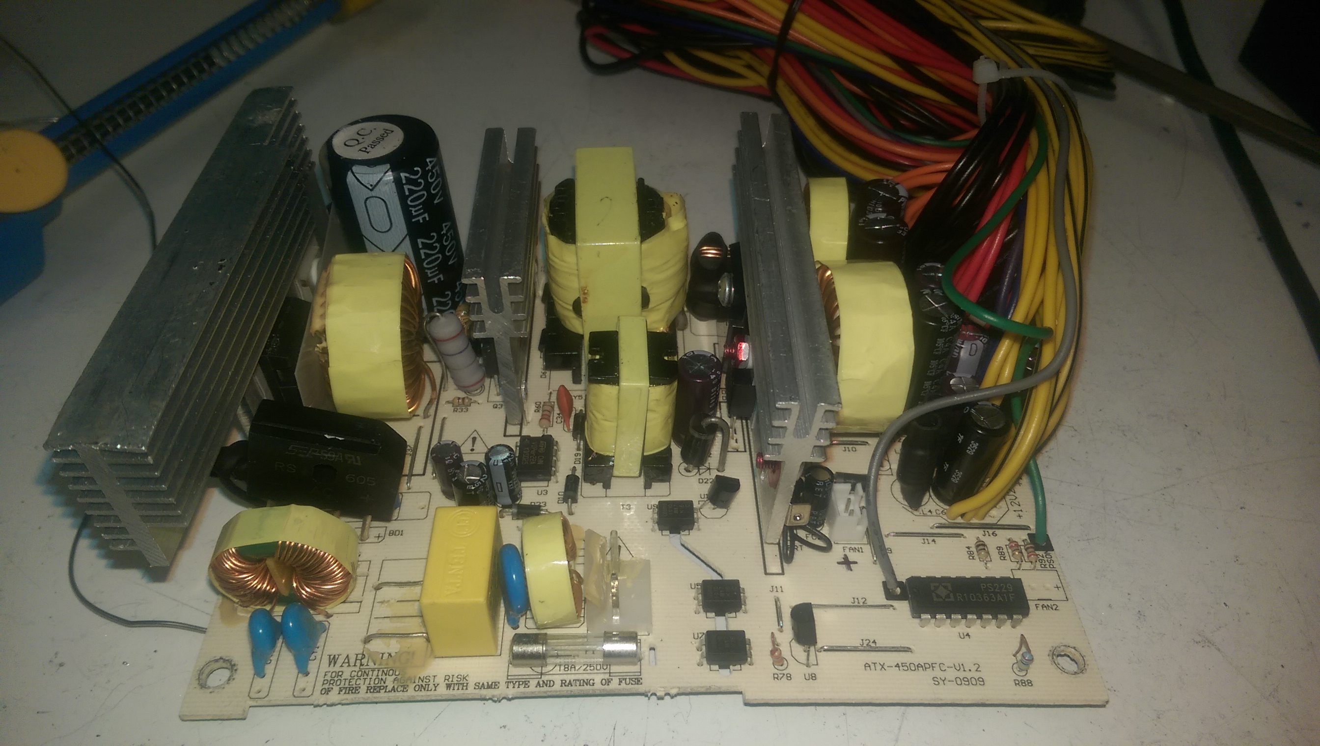

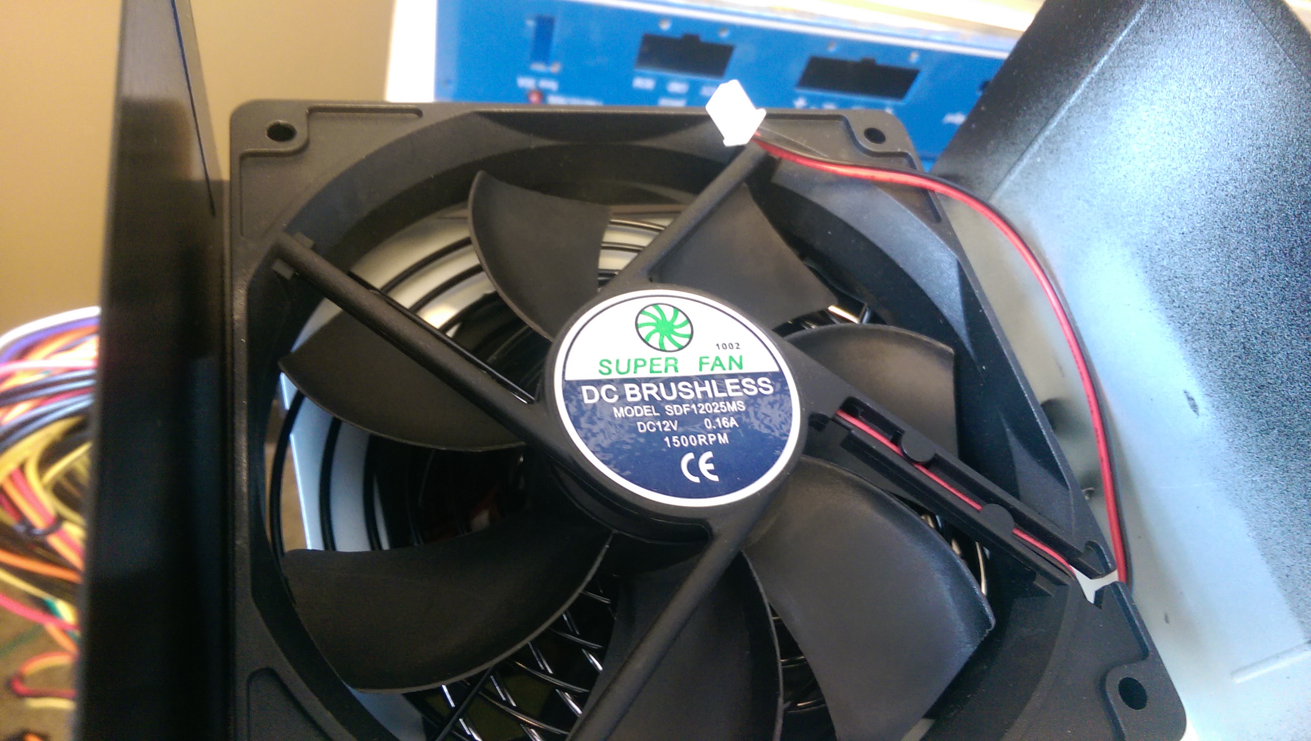

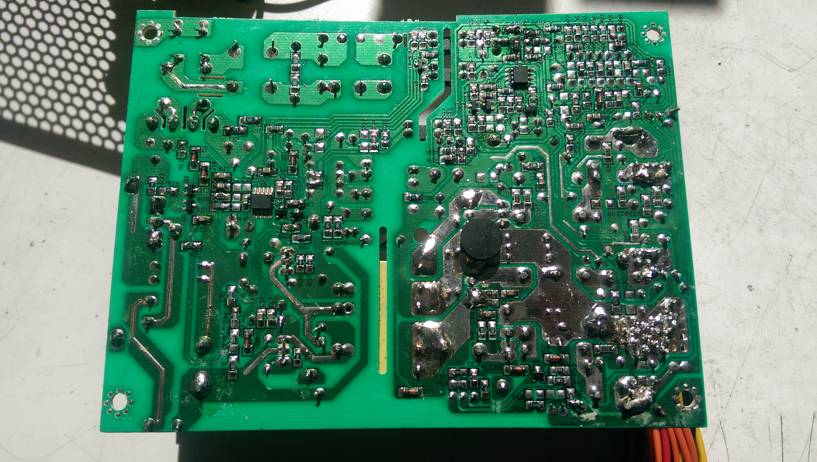

    I got this thing with a destroyed fan (The plastic holding the shaft to the blades broke) and the thing had no power, not even 5VSB. I pulled it to inspect it. Fuse wasn't blown, strange....
    I looked at the soldering side, which was of horrible quality. I found a broken joint on the PFC coil, and a cold joint on the startup resistor. Plugged it in, still nothing....

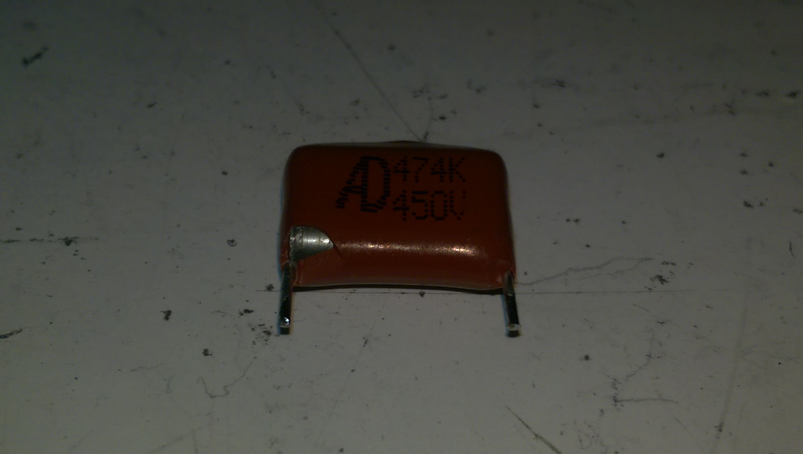

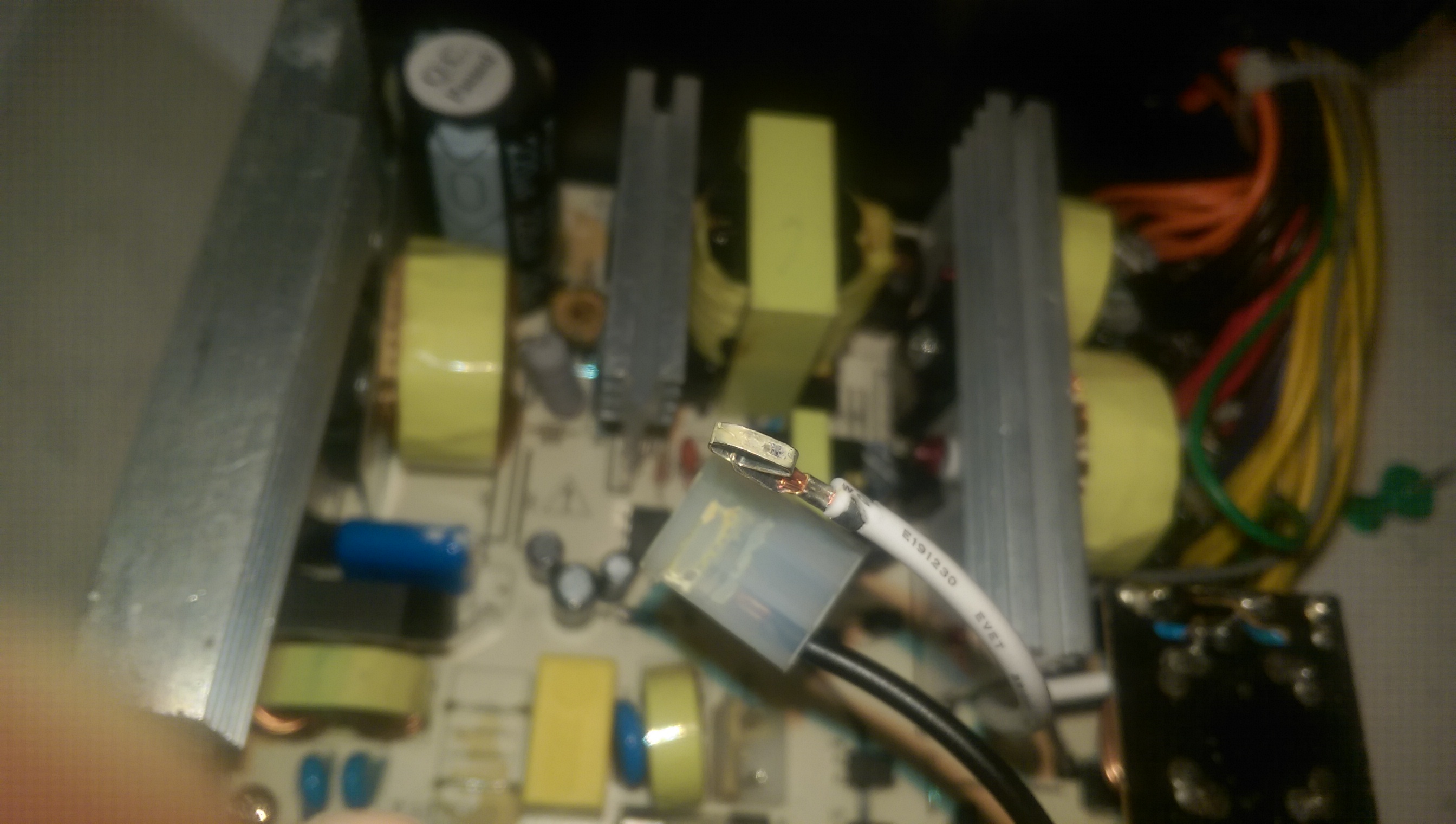

    Checked bridge rectifier, PFC silicon, all diodes/resistors on the primary, and then noticed the cracked PFC film cap. Replaced that with a better spec'd part. Still nothing. I pull it and throw it into another PSU chassis, and it fired right up! I figured it must have been some of the input filtering components on the small PCB before the fuse, so I took a similar one off another PSU and threw it back in the original chassis. No power, not even 5VSB.......WTF!! So then I pulled the AC plug and found that the glue had hardened on one of the AC pins. Wow! I guess it just shows not to over-think things, which I tend to do too often.

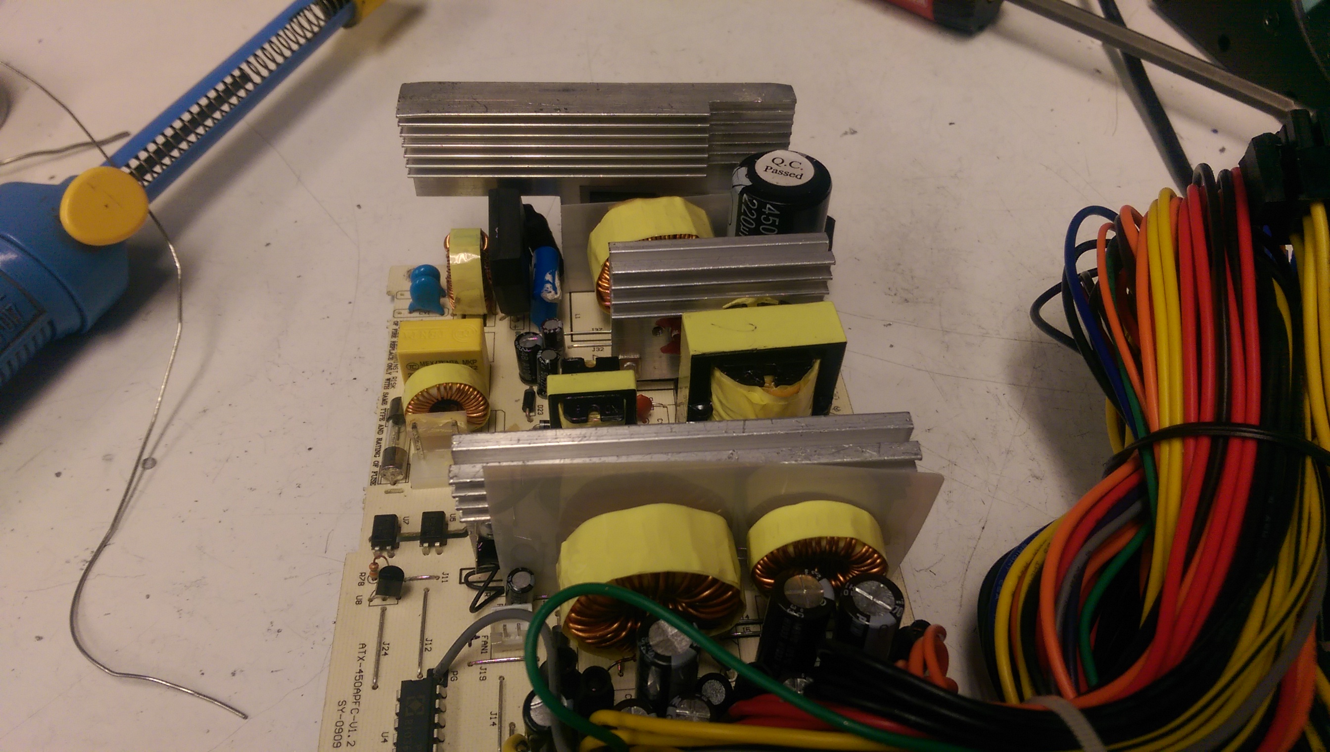

    I recapped it because all the caps were Ejicon (They all tested good), upgraded the bridge rectifier from 4A to 6A, mainly because the BR, PFC film cap, and fusible resistor were all packed in there too tight. Installing the bridge rectifier moved over to the side like that gave the other two components room to breathe, and at least they're not touching each other anymore.
    I find it interesting at their choice of heatsink sizes. Biggest on the PFC silicon??? I also could not believe that they didn't put a plastic sheet between the toroid coils and output rectifiers! I installed one.

    Wonder how hot that PFC booster gets at full load... that heatsink looks like they're disaster planning. I know, I know, "punny."

      As for the PFC heatsink... I thought APFC was all about improving efficinecy (not really).
      Pentium4, you should get one of those $5 type-K thermometers. Then you can measure heatsink temperatures easily.
      The PSU does look nice with the blue fan, though. Good save. I think it looks overall capable of handling a low-end system. Maybe even handle something mid-end too. Is it a single-transistor forward? And what are the rectifiers on the secondary?

        Well, not always. When the heatsink us live, it will measure nonsense.
        But having the biggest heatsink in PFC section is quite normal these days. Modern topologies with good silicon improved efficiency greatly so switchers and rectifiers usually have only small heatsinks. But boost PFC have not changed a bit. Wonder what the efficiency would be without PFC with 230 V AC - 95+ %?

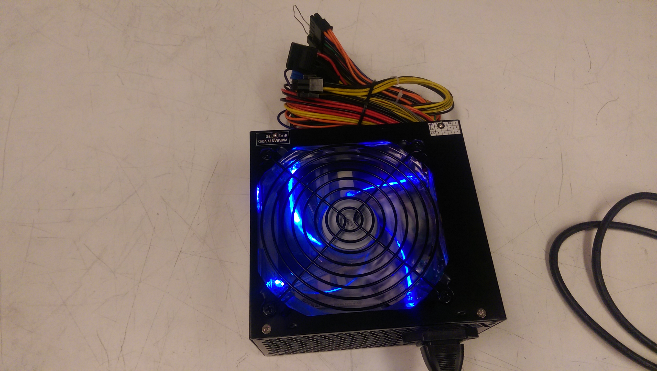

          And Behemot, you're right. Silicon is semi beefy for a 350 watter. PFC transistor is 24A, PFC diode is 10A. Switchers are 14A FETs. 5V and 3.3V has 30A. 12V rail is actually dual rail, with 20A schottky each. It does indeed look good with the blue fan That's actually from the ePower I'm still working on. Branded H.X.S.

            So the broken fan was the SuperFan? Where's the Kryptonite?
