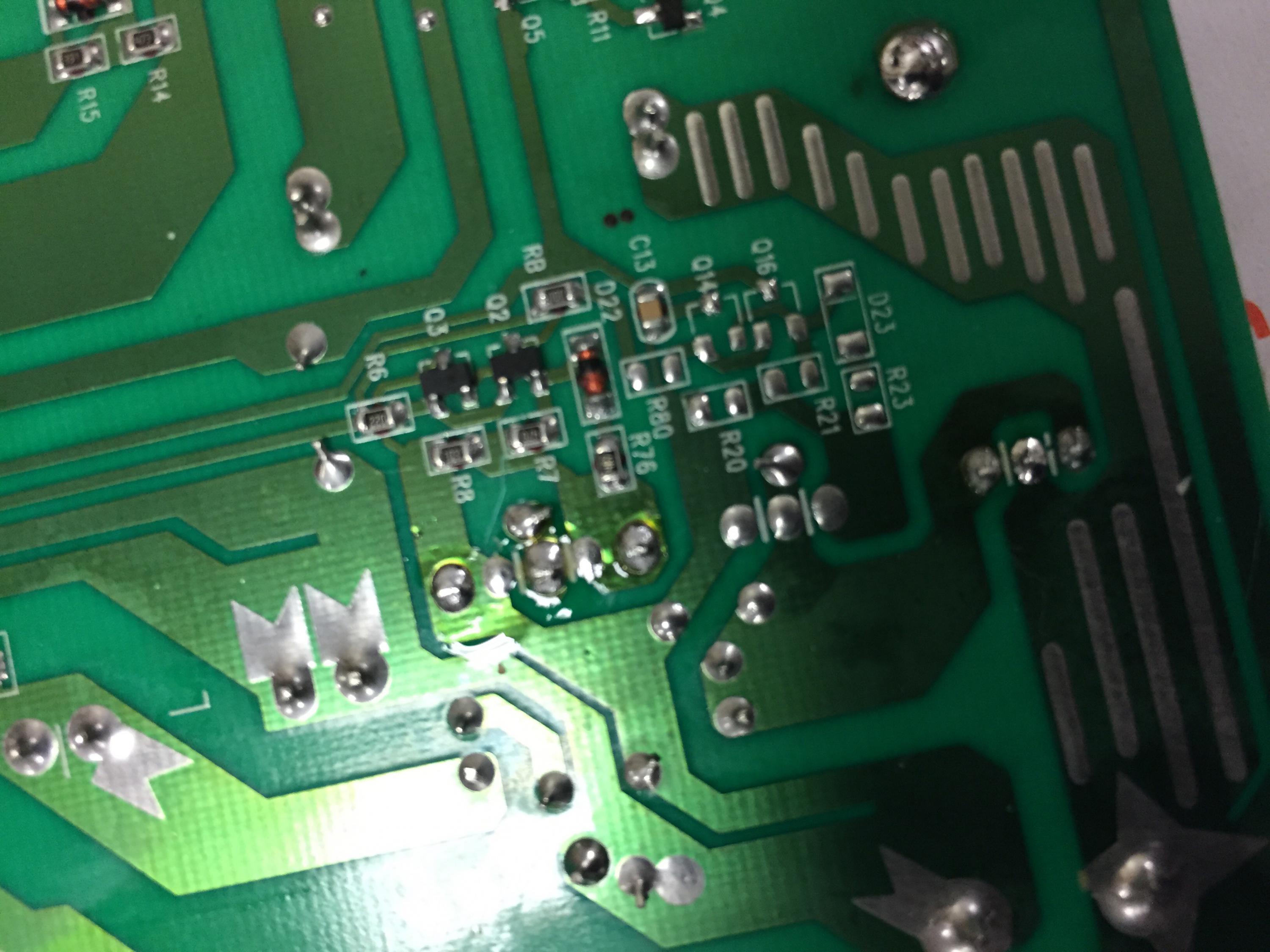

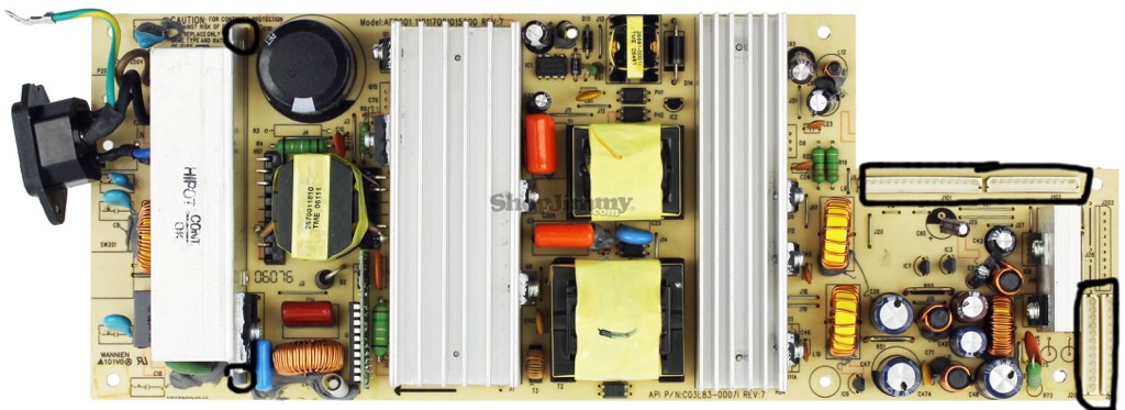

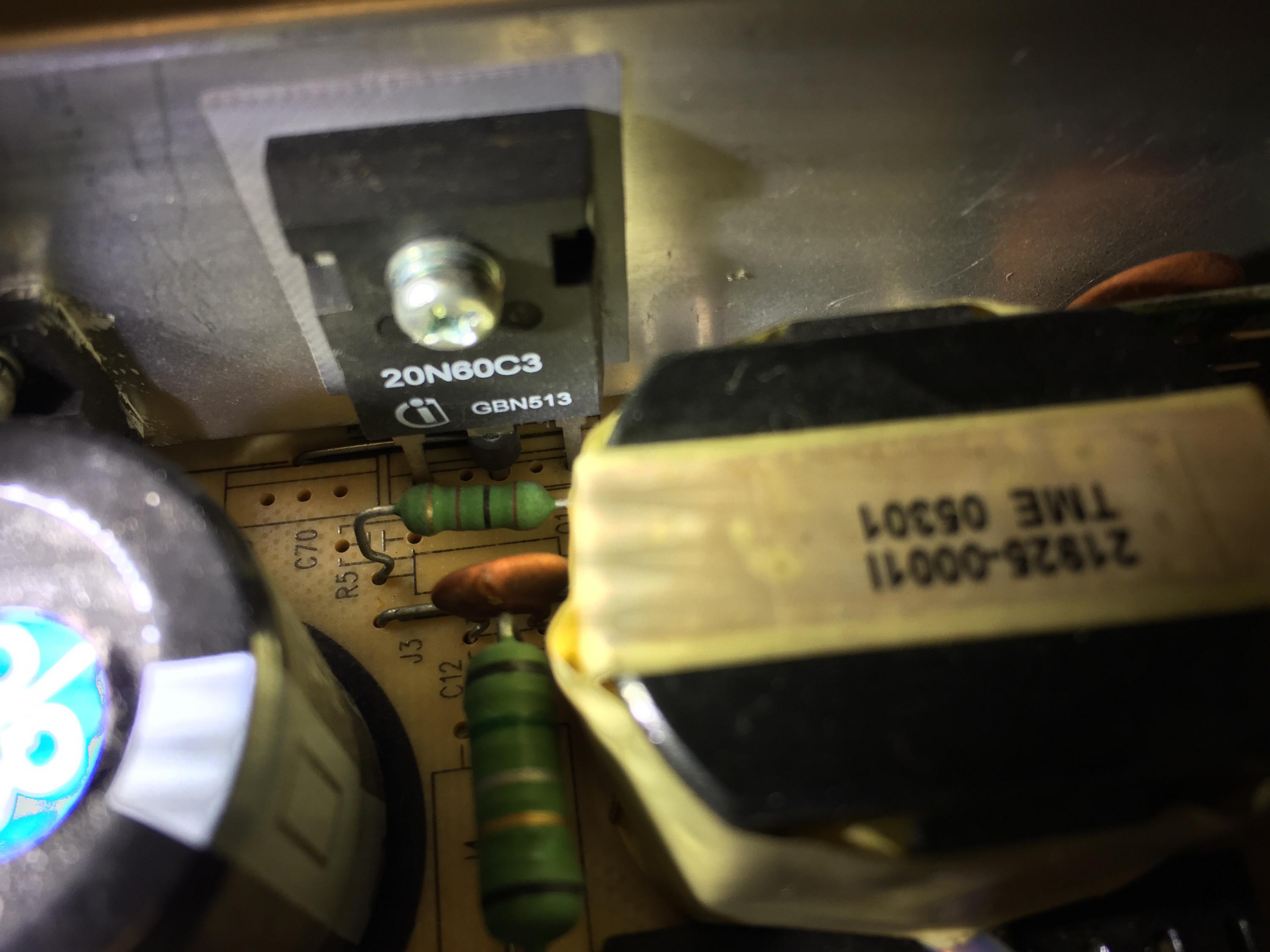

    I have a tv model lt37hvs .The problem I am having is everything turns on for about 10 seconds the shuts off.You hear a clicking noise when it shuts off.I looked for bad solder joints the only thing I find is a shorted Zener diode but I can not find a way to identify it so I can replace it.It seems to connect to one of the legs of 20n60c3.power supply model is aep001 9191170013 rev3.looks like a fast acting diode d22 maybe it being shorted is shutting down my power supply.any help is welcomed thanks

    Here pic of 20n60c3
      Re: Power supply on lt37hvs
      That is the Gate discharge diode (it is in series with R76) which there is another resistor connected in parallel with that D/R.
      That circuit is the PFC Voltage booster so if the circuit does not work then you will not have >360VDC on the main filter cap, so you need to check that voltage.
        What happen if the diode is shorted
          Lifted one leg the doide is not shorted I will pull my esr and check my caps
            That happens, sometimes diodes shows a short in circuit, just to take it out and it may be good. That all depends on the circuit the diode is in.
              Gate drive will usually have diode in parallel wit 10 Ohms resistor.
                  This is what i found on mine the solder joints on the power supply where connectors connect had bad joints so i just resolder them also the heat sink near the power plug had bad solder joints i resoldered it and the tv stays on now.
