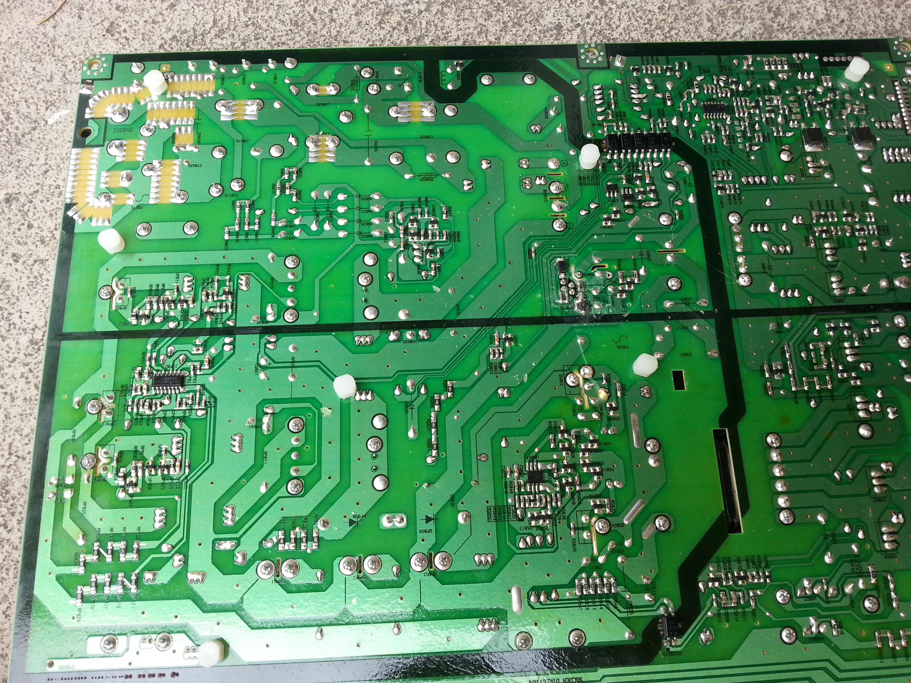

        plus pictures of both sides of your boards

          And yes, good clear pictures of the bottom side of the board.

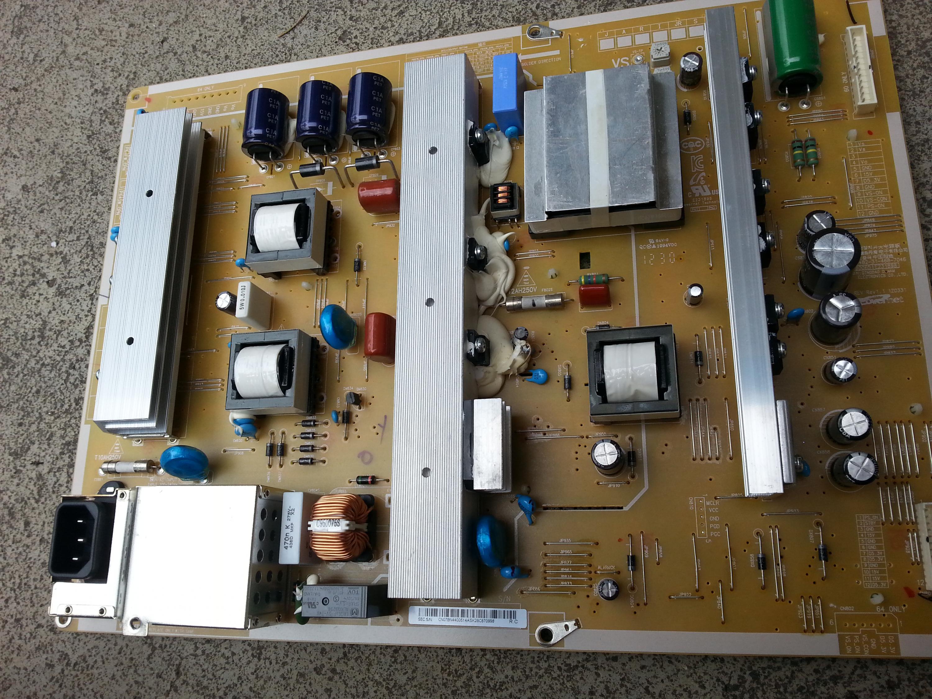

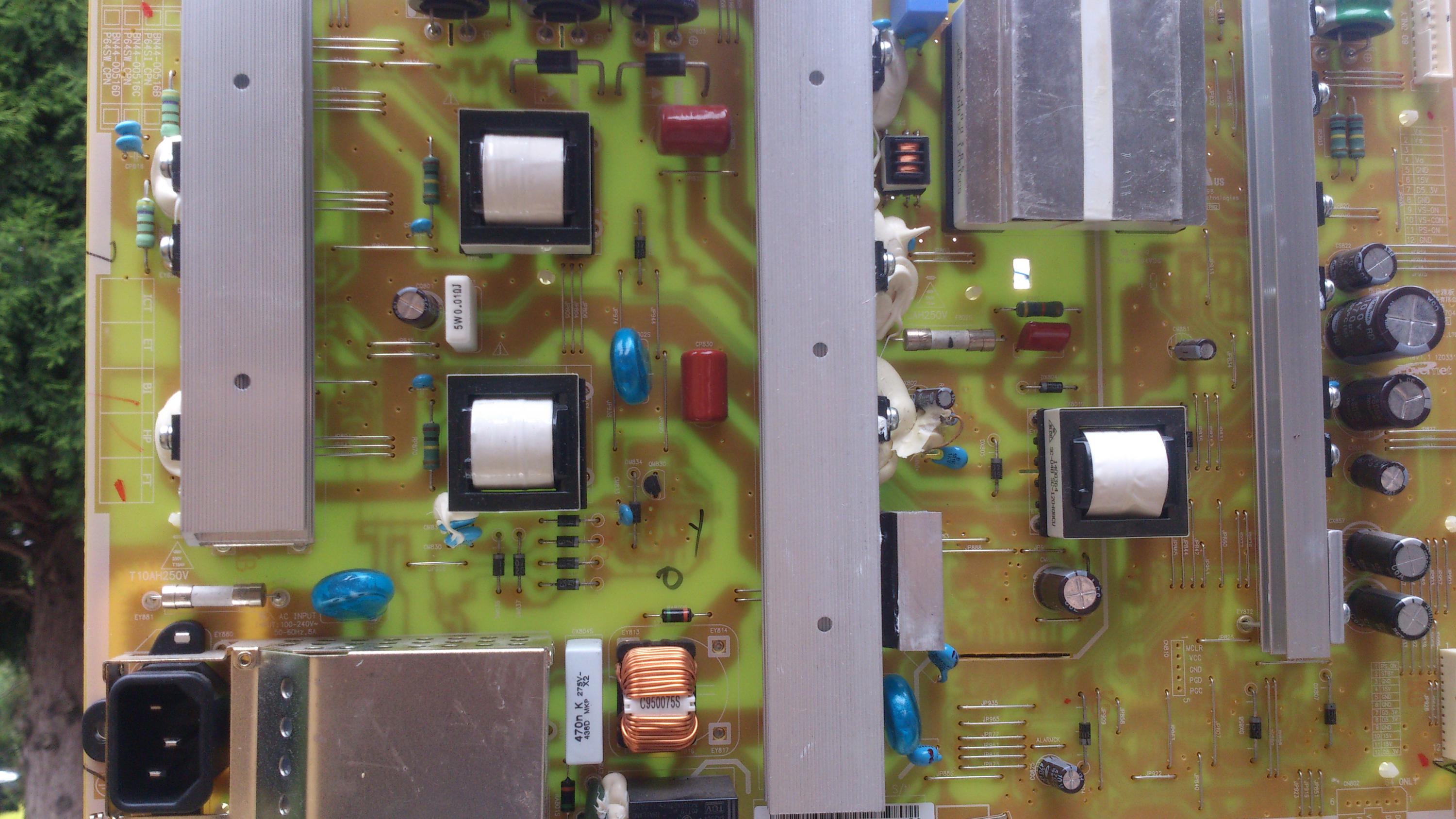

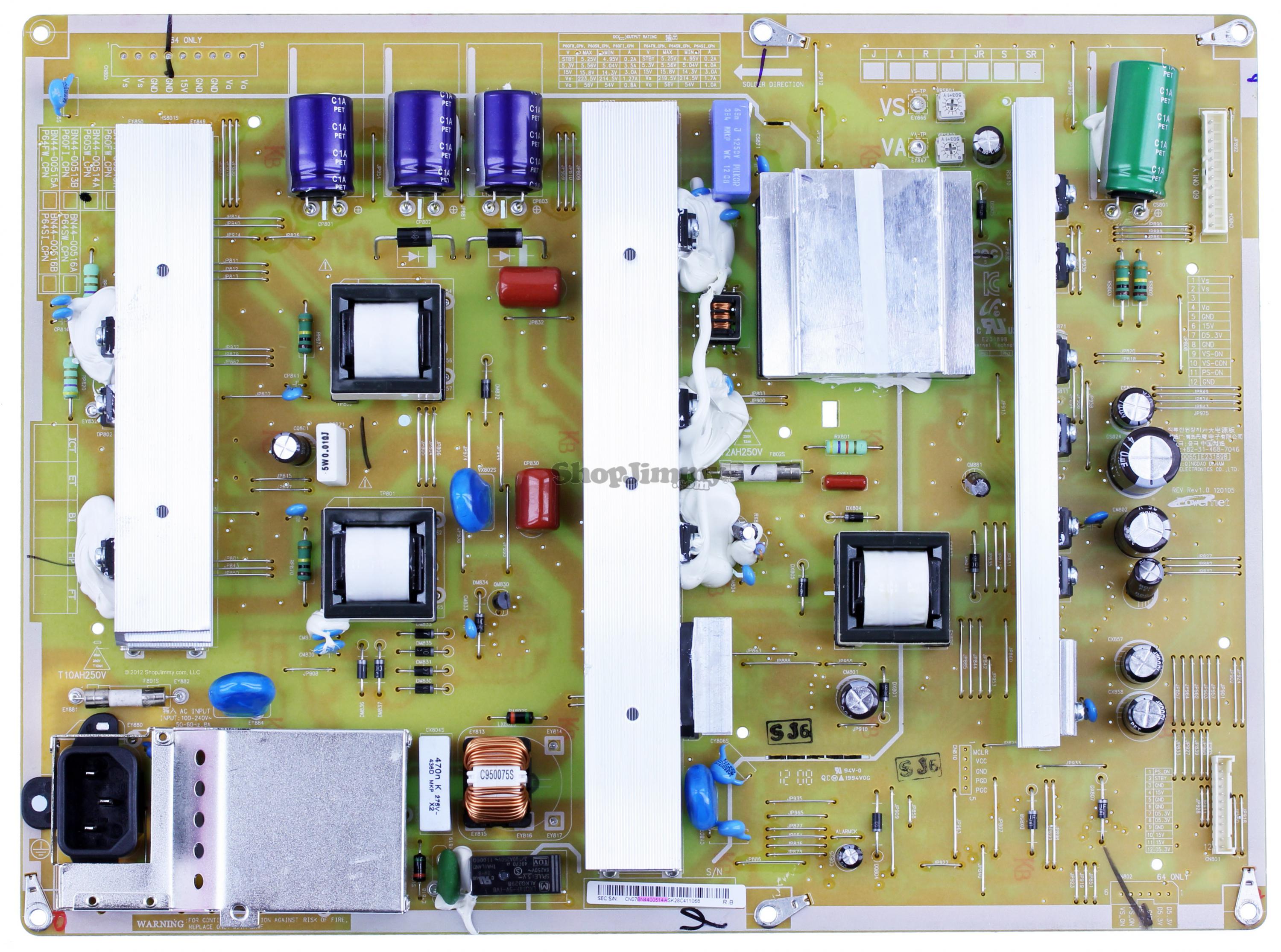

            I have included some pictures of the underside, thanks selldoor.
            I'm not quite sure where the b+ standby fusible resistor may be as the standby appears to go through the same transformer as the regular 15v run voltages etc.
            I see a fusable resistor in parallel with an ntc and the relay contacts. tests as a closed link (in circuit).
            also another fusible resistor across (kinda) bypassing the inductor on the ac in side before the bridge recticifier. also test closed link (in circuit).
            So I am wondering this resistor and ntc pass a low current into the psu to run the standby circuit which in turn should be able to power up the relay and allow further current through the same circuitry to fully power up the psu?

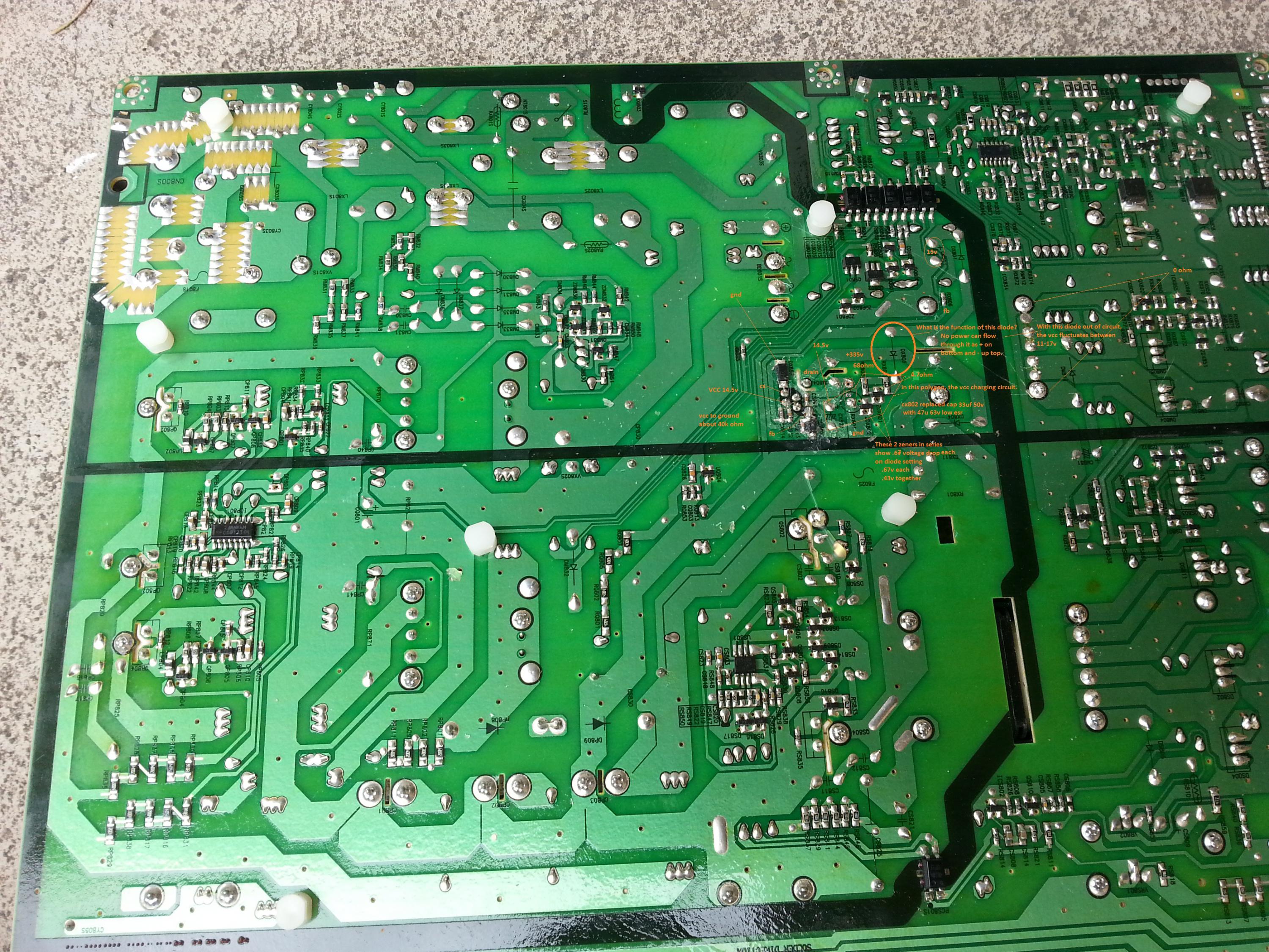

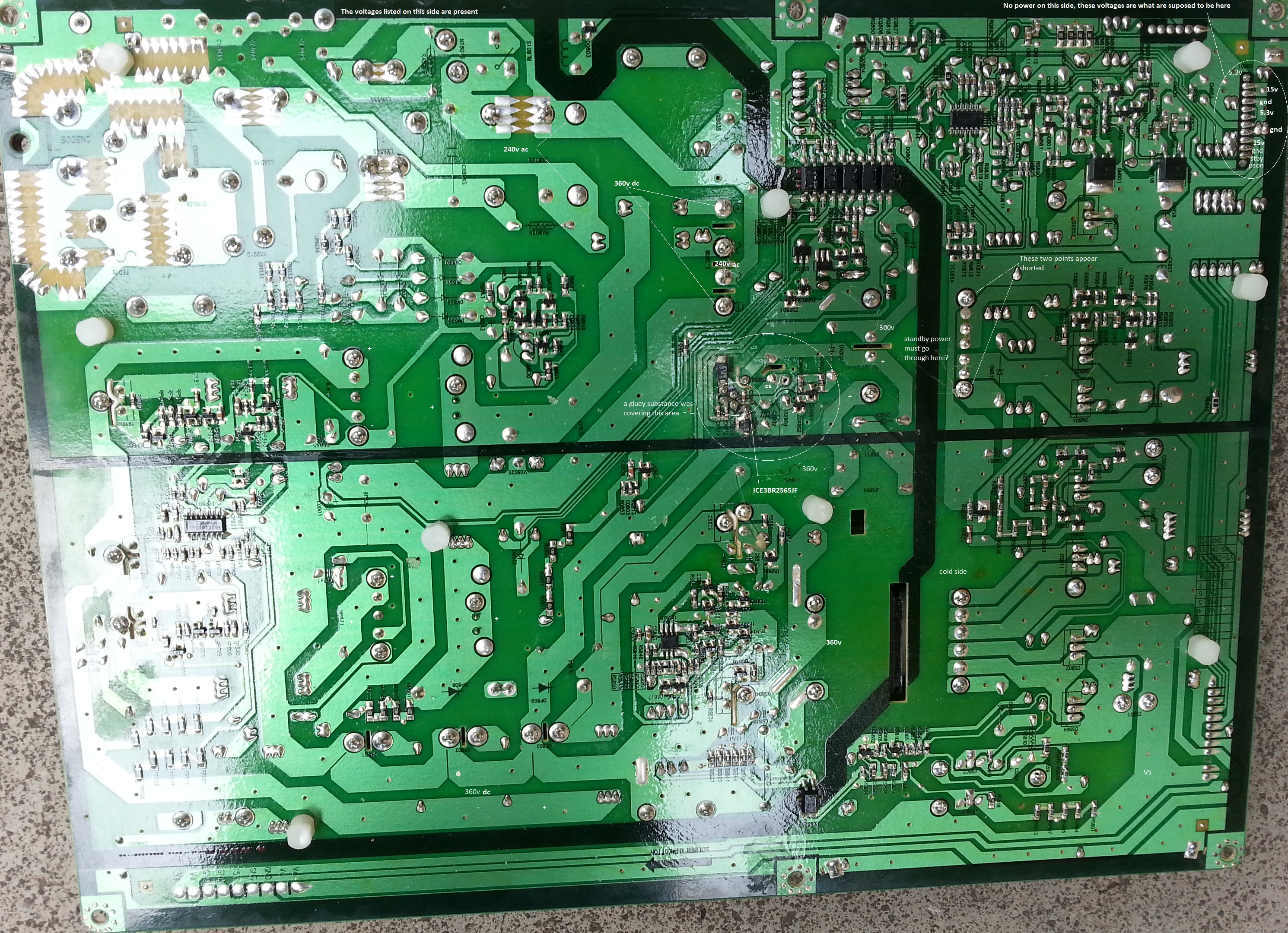

                                    > How to test the zeners in the vcc startup circuit? 2 of them in series to ground seem to read each about .67v on the diode scale and .43v when tested in series together.
                                    > Resistance from vcc pin to ground is very high about 37k ohm.
                                    > Replaced the startup cap with a 47uf 63v low esr. still the same vcc voltage.
                                    I include a picture with some annotions about the state of the circuit.
                                    Not quite sure how to test the startip cell current.
                                    It's a shame I could not get a schematic for the exact psu.
                                    It is making more sense slowly.

                                      Dx805 rectifies a voltage waveform from a winding on the transformer to power VCC after startup. Although leaky components can be illusive, I dont see anything too suspect. To rule out a possibly, cut the track leading away to the right from the + of Cx802. Double check that there are no other parts on the VCC pin other than Cx802. If the IC is ok, VCC should ramp up and down between 10.5V and 18V. You wont know for sure with a DMM but the fact that the voltage is going up and down implies that it's between 10.5V and 18V.
                                      If there is still a problem, you can be more certain that the IC is faulty by soldering a 1K resistor across Cx802, power it up then measure the voltage across the resistor. Then calculate the current from the Startup Cell .
