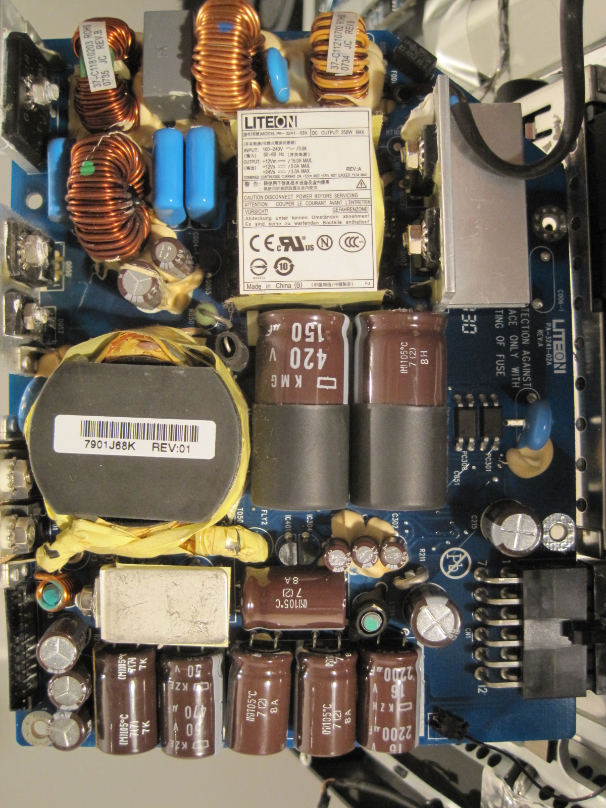

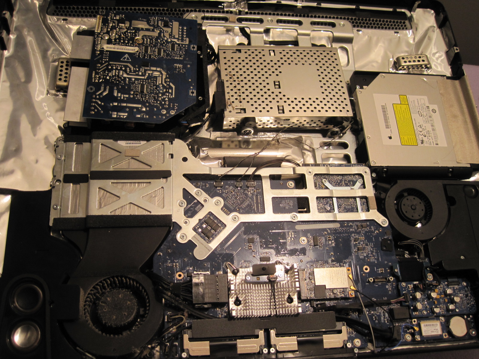

    Hi all...I have very little experience when it comes to troubleshooting boards but have always wanted to learn.

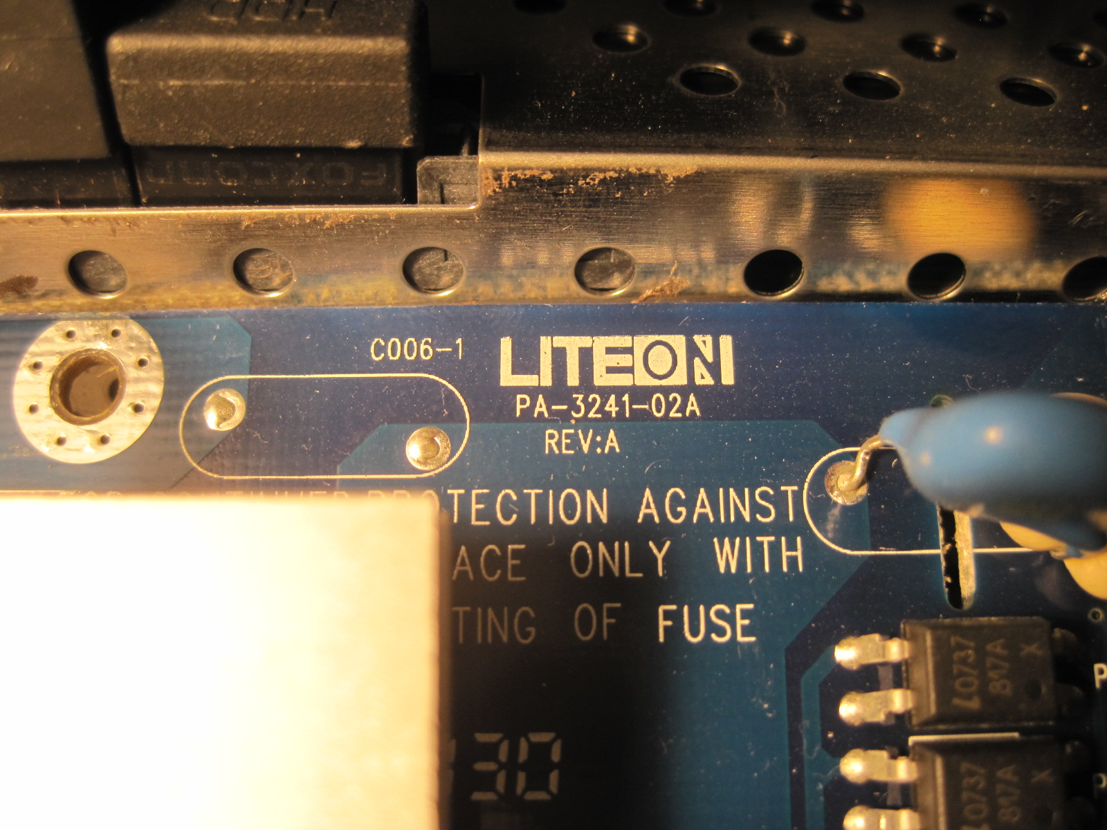

    Yesterday I picked up an Imac 24 for $20 that wouldn't power on and figured it was a good first project.
    Imac 24 A1125 - PSU is Liteon PA-3241-02A Rev: A

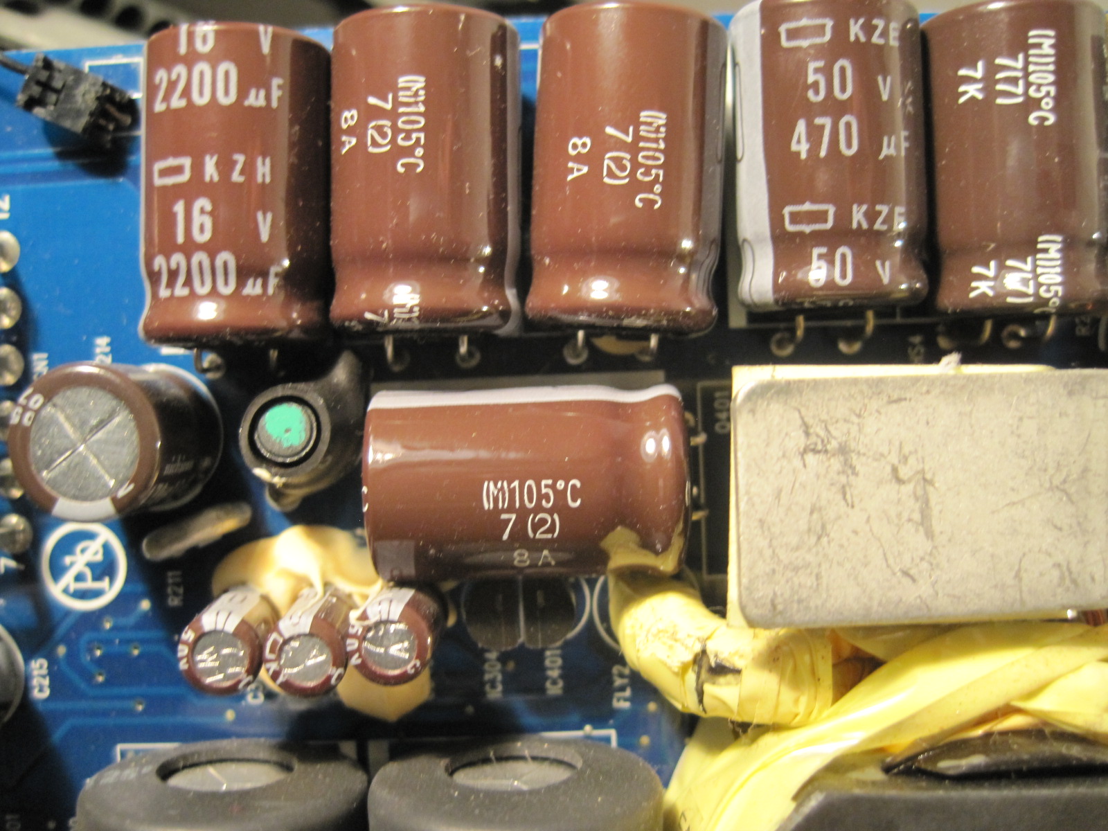

    So far I have checked that it has power to the incoming line that plugs into the power supply board.
    It has NO l.e.d. lights so it's not getting a trickle charge.
    I can't see any caps that have bulged tops.
    I will attach a photo of the multi meter I have..again not even sure how to use that all the time...sigh..lol (I know how to set it to check 120 volts and change it to check continuity)
    If someone can give me a hand and tell me what I should check, and how to check it that would be great. I have done a lot of searching but many of the terms are foreign to me.
    Thank you for your time.

    Re: Newbie - Imac 24 - Liteon PSU - no power at all

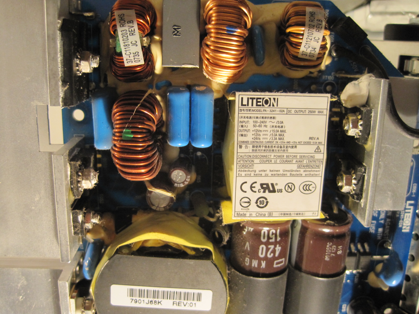

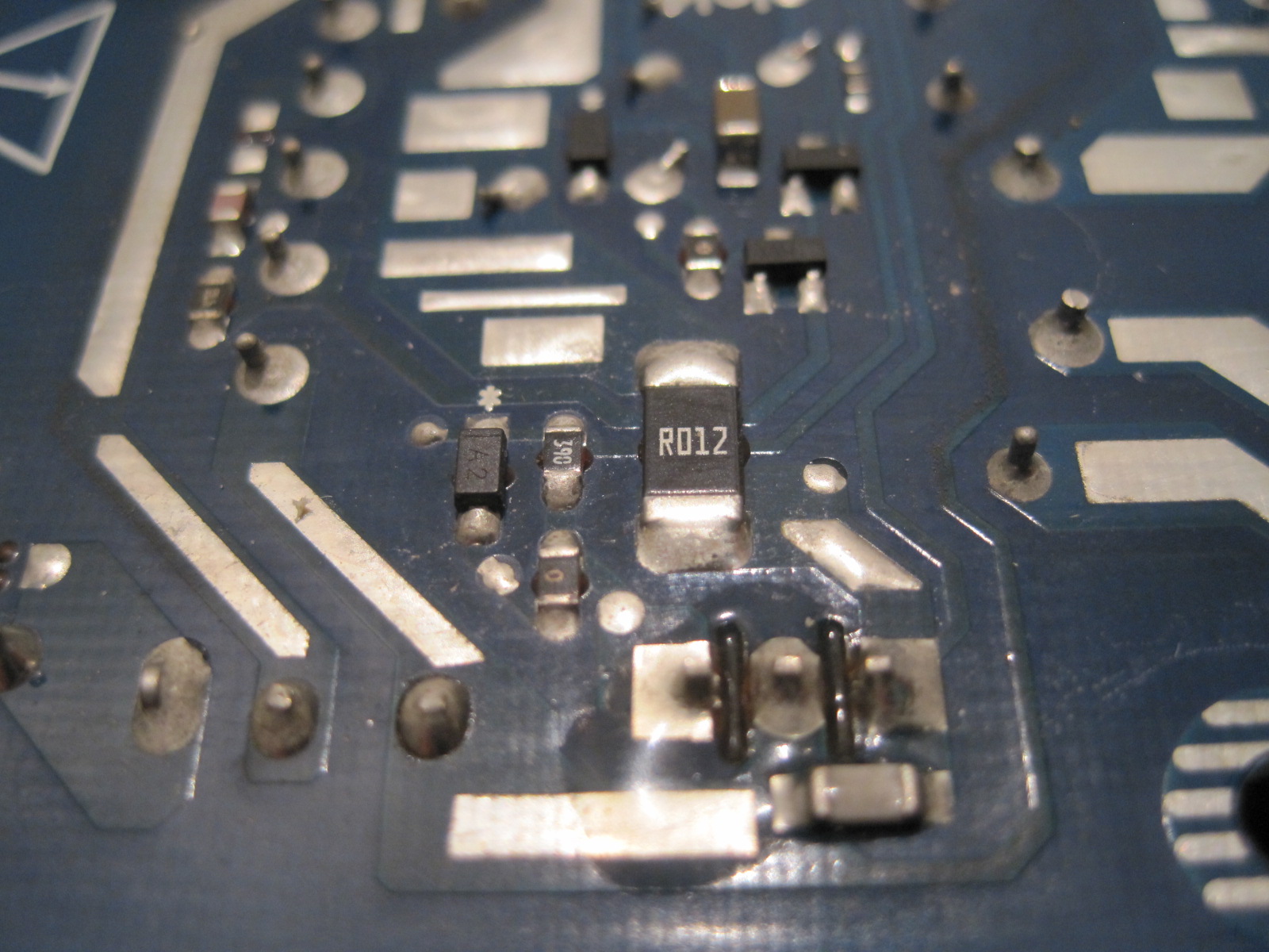

    I may be way off here but just pulled out a magnifying glass and looked around the board.
    Next to the AC input there is a small black box that reads:
    T 5A 250V
    I flipped the board over and checked between each post on that box for continuity and got nothing.
    Is this by chance a fuse that could be blown?
      That is the Time delayed (SLO-BLO) 5AMP 250V fuse, so it means the board has shorted circuit some where that you will have to figure out.
        Did I test this fuse properly? and is it bad if there's no beep when I touch both contacts with my tester?
        Also would a power surge cause this to blow or just a short somewhere?
        Thank you.
          If it does not show <1 Ohms (depends on your meter probe wires resistance) then it is bad.
          Yes, it can blwo due to the surge or shorted circuit, you will have test the bridge rectifier, MOSFETS, etc.

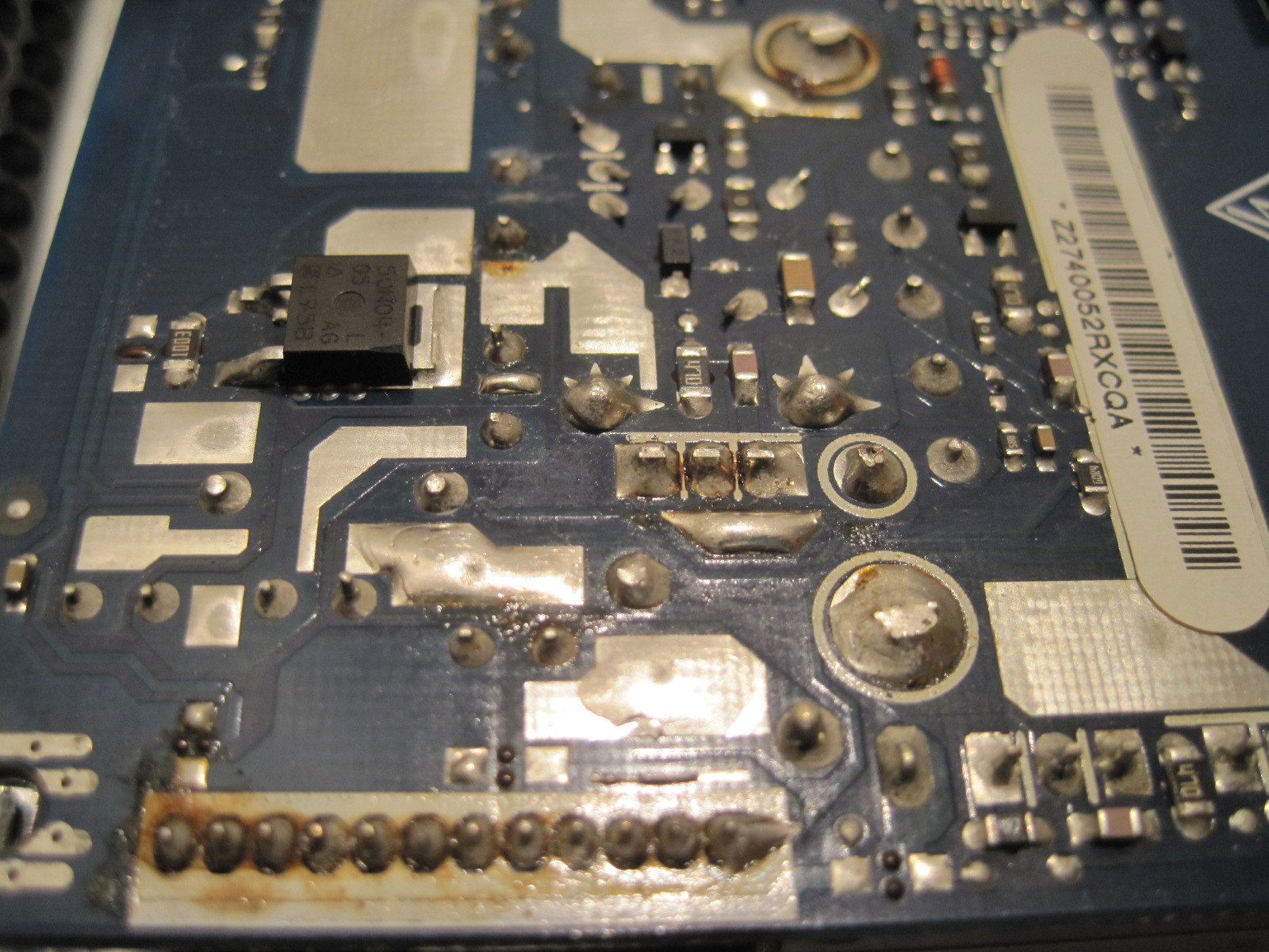

                      Update:
                      I finally got the pack of fuses in the mail today, re-soldered a new one to the power supply board and as soon as I turned it on..POP goes the new fuse
                      I am searching and searching on how to trace a board out..check for shorts, bad MOVS, CAPS, etc. (still foreign language to me).
                      If anyone wants to give this newbie a head start it would be greatly appreciated.
                      Thank you.
                        • 31050
                        check the fets - black things with 3 legs
                        • StraitNet
                          • Nov 2014
                          • 27
                          Do I just check for continuity? Sorry not sure what to check..or how
                          Update:
                          I also just did another test..
                          I replaced the fuse again and had everything unplugged..Except the power in clip (two wires blue and brown) before trying to give it power.
                          As soon as I even touched the outlet the same fuse popped again...didn't even have to plug it in.
                          So it must be a short on the Power supply I am "thinking".??
                          Not sure where to go from here though.
                          I am very very slow at this desoldering and soldering process...but don't mind practicing if that's what it takes.

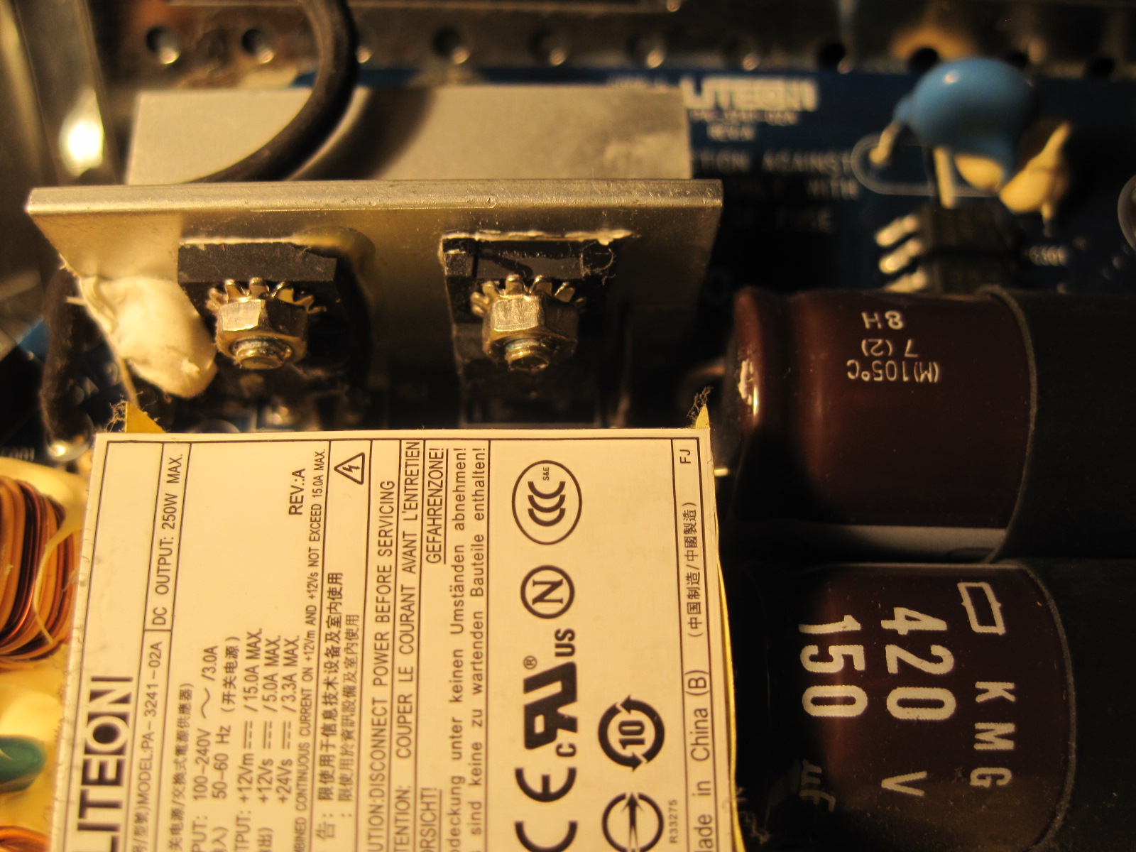

                              It looks like all the black things with three legs are bolted to aluminum cooling blocks or something....is that right?
                              Just making sure I google for the right thing to figure out how to test for shorts.
                                • 31050
                                usually they are.
                                • StraitNet
                                  • Nov 2014
                                  • 27
                                  So I have found info on how to test those Mosfets...but I am still trying to figure out what they are connected to and why?
                                  Do I need to take the aluminum blocks all a part and remove each Mosfet before testing?
                                  Is there any sort of grease etc. on the mosfet contacts? similar to CPUS (cant think of what that is called right now)

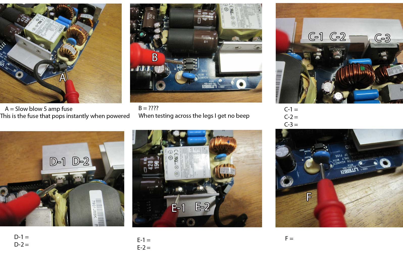

                                      I just created an image showing different parts of this power supply board.
                                      When I set my multi-meter to ohms (beep test) and check the legs on item B (both of them) I get no reading...no matter how I test them, straight across, diaganol etc.
                                      Should I get a beep here? and what is this called?
                                      Also if you can let me know the names of any other items that would be great.
                                      Thank you and Happy Thanksgiving
                                      • TELVM
                                        • Oct 2012
                                        • 547
                                        • Spain
                                        I'll try to help:
                                        A - If the fuse pops there is something shorted, it will keep popping until you fix the short.
                                        B - Look like optoisolators, I think it's OK if they don't 'beep' for continuity any way.
                                        C3 - Bridge Rectifier.
                                        C2 - Active Power Factor Correction (APFC) Pulse Width Modulation (PWM) MOSFET (transistor).
                                        C1 - APFC boost diode.
                                        E1 & E2 - Primary switching transistors ('switchers').
                                        D1 & D2 - Secondary rectifiers (probably diodes, some modern PSUs also use transistors for rectification).
                                        F - Looks like a Y-capacitor.
