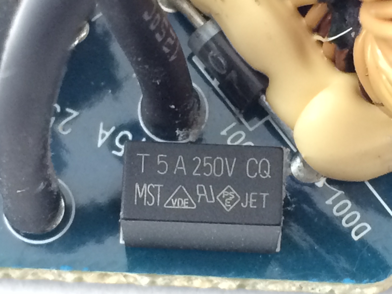

            I just confirmed that the fuse of my PSU is also blown. Can I go lower or higher than 5A fuse? 5A will be coming from Taiwan and I don't want to wait that long. I see 2A and 6.2A fuse that is available in the US.
              Re: Newbie - Imac 24 - Liteon PSU - no power at all
              @DYOODEKZ:
              Pictures of your fuse?
              http://www.mouser.com/ProductDetail/...ndH1v%252bE%3d
                Originally posted by budm
                Attached is the fuse. Thanks for the link. I'll drop by our local electronics store before I order online. Hope they have this part. Thanks again.
                  That one from mouser should work, but 100% you do have shorted circuits some where on the board so you need to really find out where instead of keep blowing the new fuse.
                  Put 120V 75W lamp in series with the power supply or build something like this:
                  https://www.badcaps.net/forum/showpo...&postcount=112

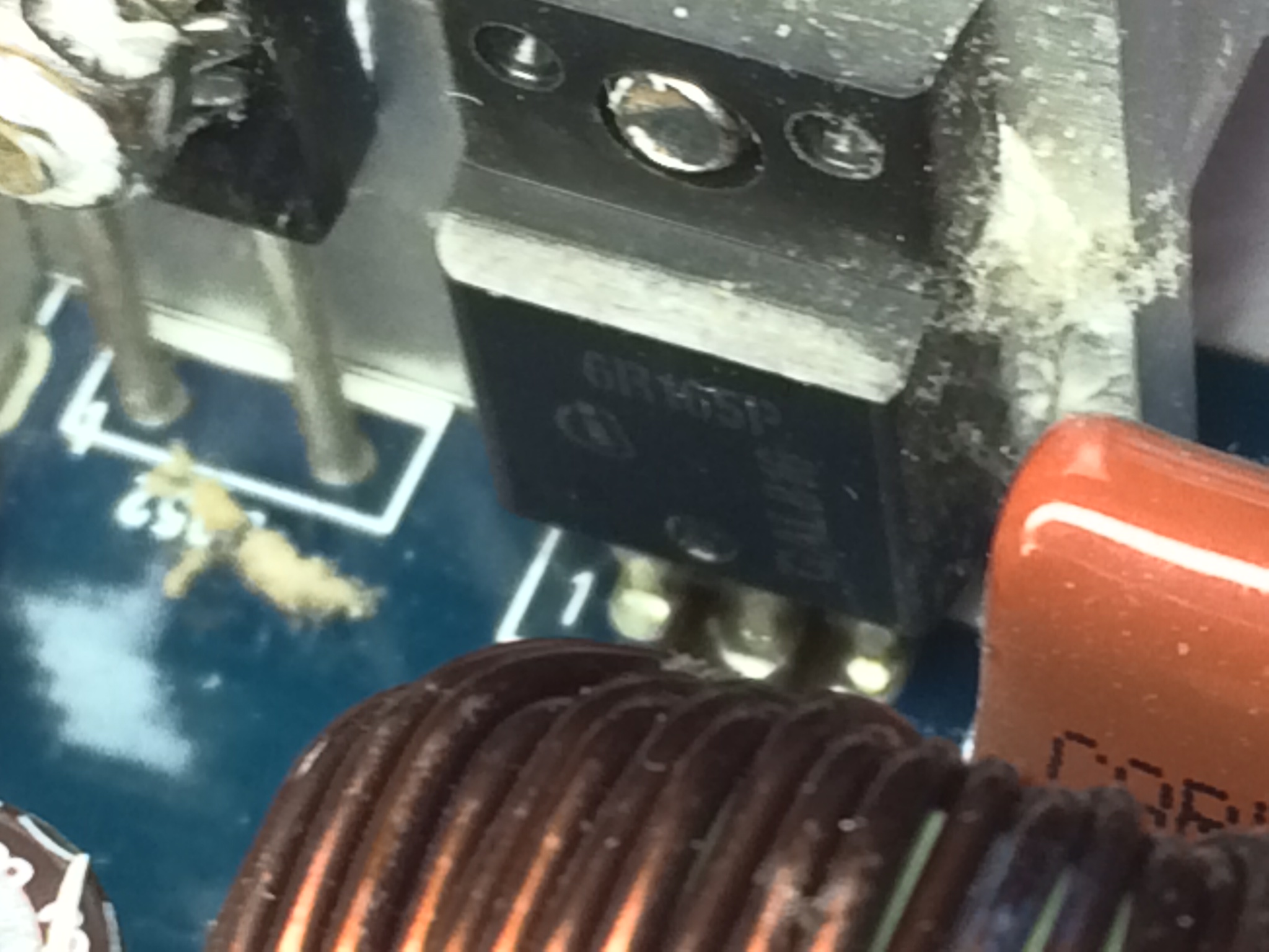

                        #31
                        You can test the power supply board by itself without having other boards connected, there is at least one standby power supply on that board which runs 24/7 the minute you supply AC to the board.
                        Did some testing last night and found that all of the pins of the 6R165P transistor are all shorted. I did an inboard testing, will removed it later to confirm. I need help with equivalent transistor that I can use and available in the US. Thanks.
                        • dyoodekz
                          • Jan 2015
                          • 8
                          #32
                          Confirmed, the 6R165P and fuse are bad in my PSU. Ordered parts and will update next week. Thanks for the help.
                            #33
                            You have to be careful, most of the time when thw MOSFET shorted out it will damaged the IC that drive the signal to the GATE pin of the MOSFET, so when you put in the new MOSFET it will cause the MOSFET to blow up if the Gate drive pin is stuck high and make the MOSFET to be fully on instead of switching the MOSFET on and off at high frequency.
                            • dyoodekz
                              • Jan 2015
                              • 8
                              #34
                              Update: Replaced the fuse and the MOSFET. Tested, the fuse blew but the mosfet is still OK. now what? I need help what to check? I hope I don't have any issues with the IC's. Thanks.

                                  #36
                                  The bridge rectifier test OK? The new MOSFET could have blown open circuit. That is one reson I do not like to put in new MOSFET unless I am 100% sure the IC is good.
                                  I would put 75W lamp in series with power supply so you do not keep blowing up parts. You can remove the MOSFET, then check the resistance on the two legs of the main filter cap to see if it shows low resistance (load side of the bridge rectifier), than check between the ~ of the rectifier (input side) to see if it shows low resistance.

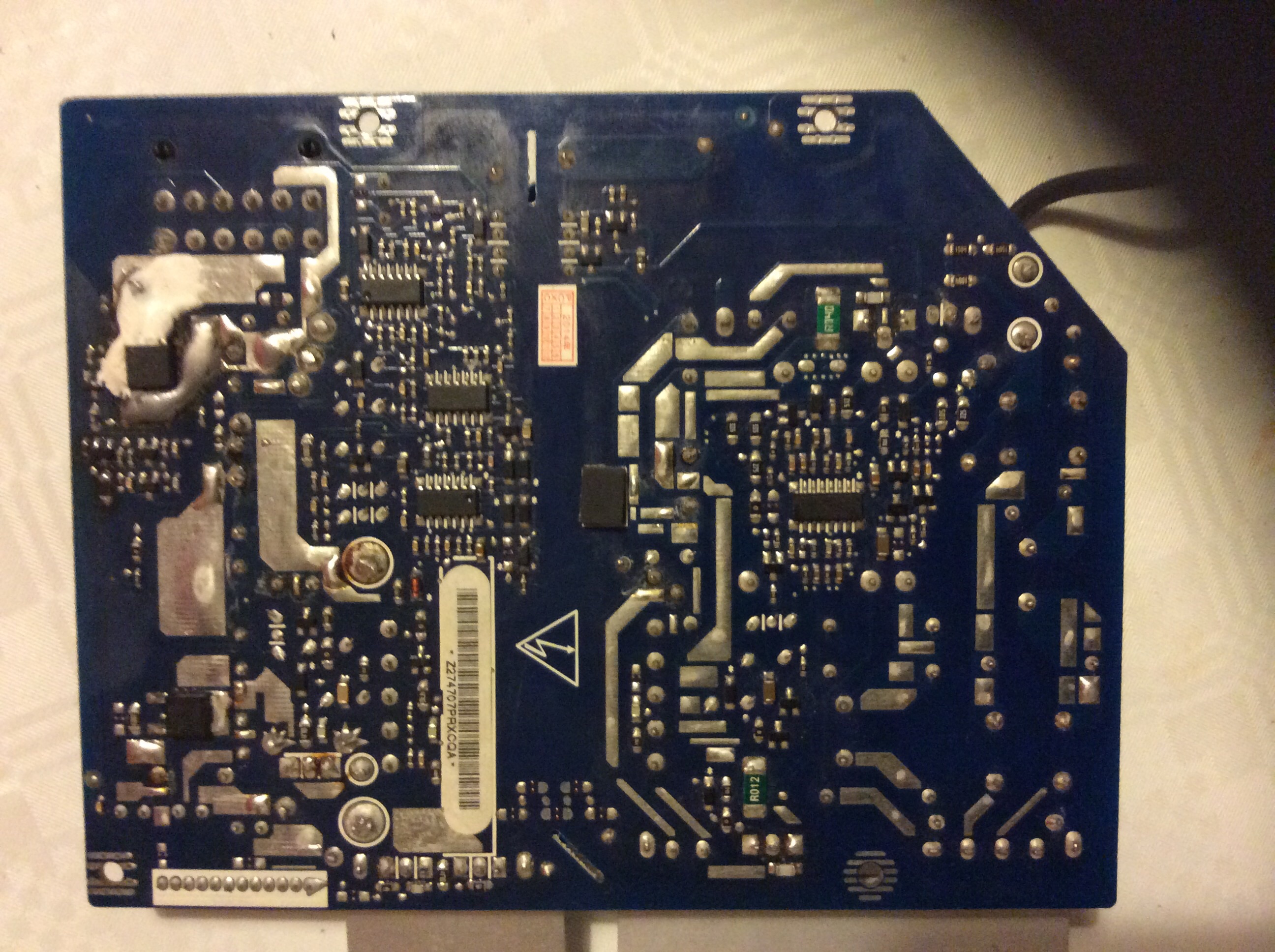

                                      #38
                                      Hi all new member here
                                      Sorry if this is posted in wrong place but as I cannot start new post (being new member) I have no other option so please feel free to move if needed.
                                      I have a 2009 A1225 Apple Imac 24" and the PSU went faulty I found a brand new one from China when it arrived I fitted it and all worked fine for about 4 hours then a loud bang and the trip went out when I removed it I found the fuse had blown , not sure where to go now this unit was brand new so to me this points to another part drawing to much power rather than the PSU but as I am no electronic wiz I am asking the experts.
                                      PS the old PSU had no obvious signs even the fuse was ok.
                                      Thanks in advance Dell
                                      Old man but still learning
                                      • Toasty
                                        • Jul 2007
                                        • 4171
                                        #39
                                        @Mrmullad - New from China means "it's been sitting here for 5 years with the bad caps slowly dying". We sell cheeeep!
                                        Will need pics of the board, top and bottom. CLEAR images please and large enough so grandpa can see it -without- glasses.
                                        >>not sure where to go now this unit was brand new so to me this points to another part drawing to much power rather than the PSU<<
                                        No, just bad caps on the power supply, otherwise the fuse would have blown or the unit just would not start.
                                        Please report and confirm that the make and model number are the same as this thread.

                                          #40
                                          Thanks toasty for your prompt reply
                                          Please see attached pics
