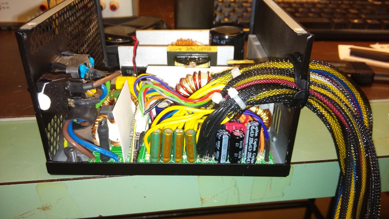

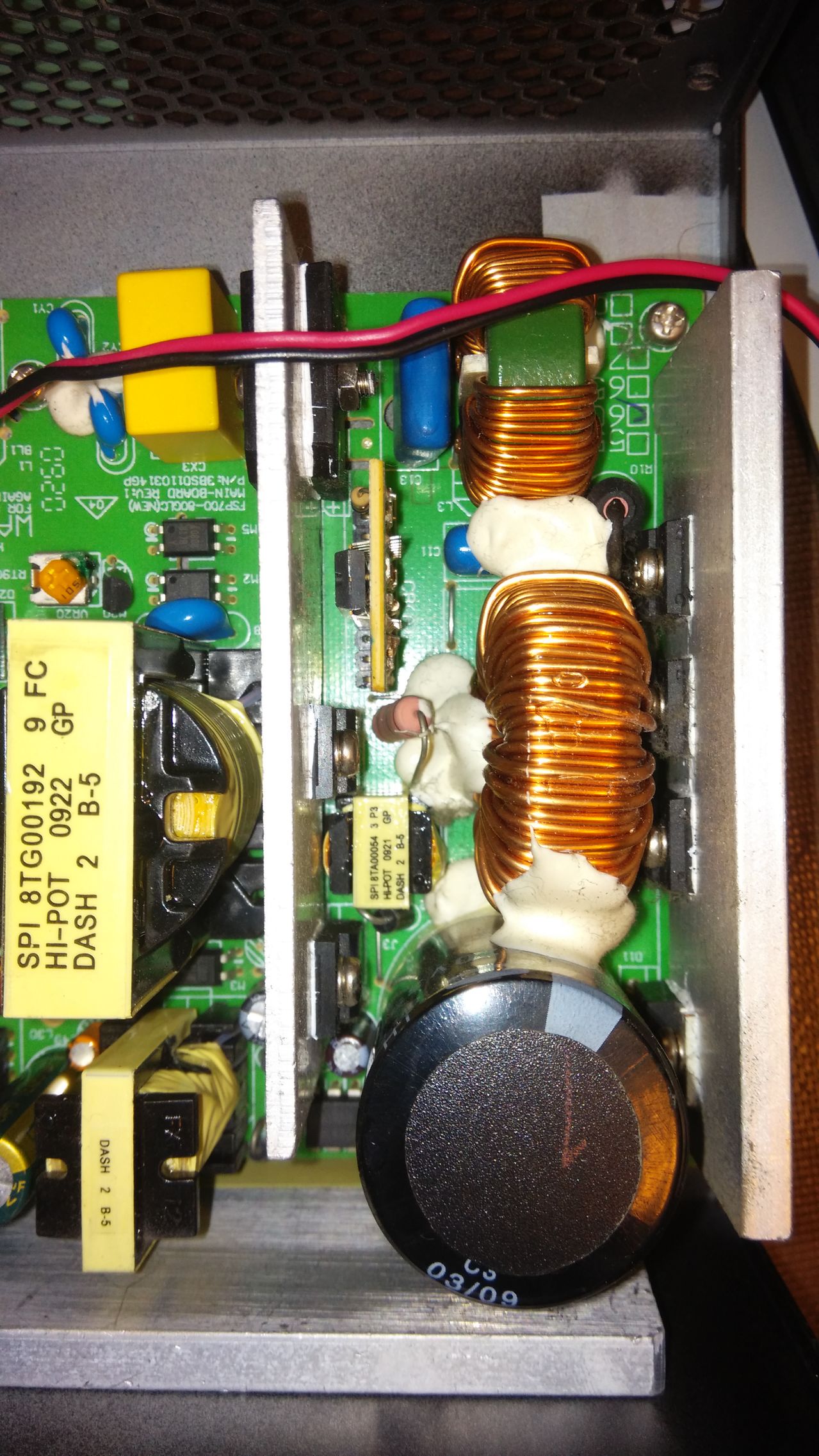

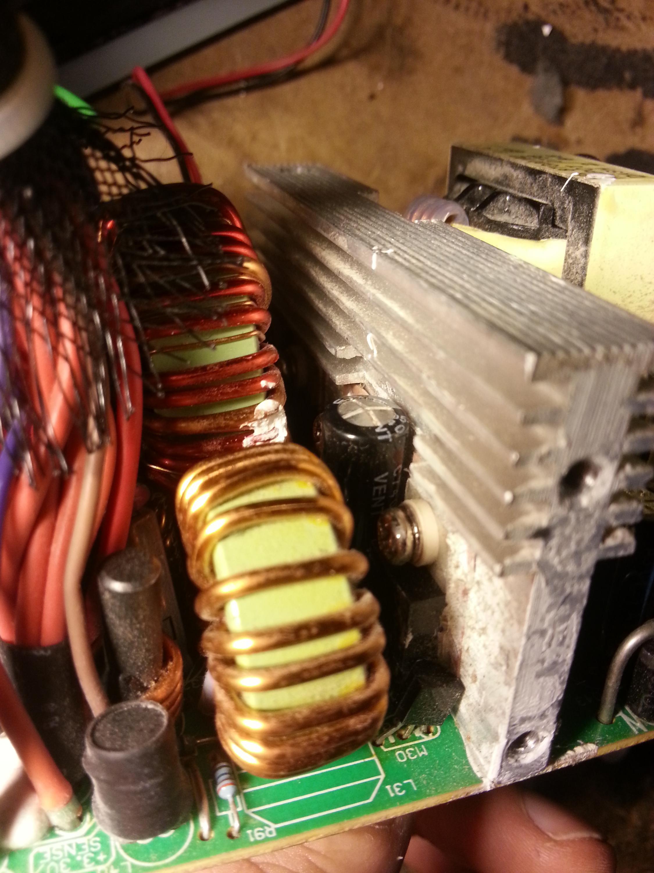

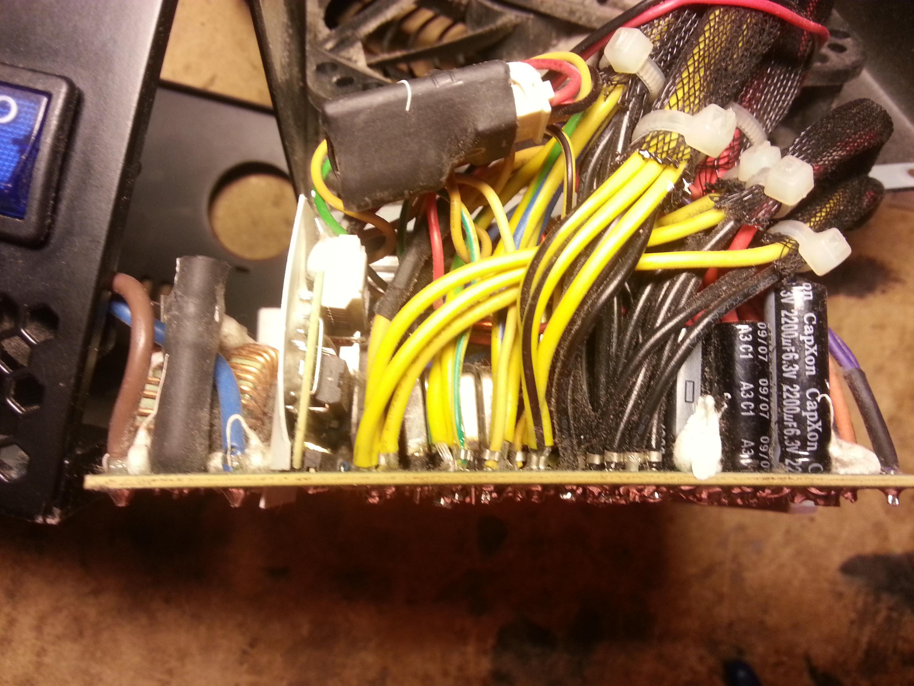

    Hello, I decided i'd have a look at a failed OCZ power supply that has been sitting in my dead pile for a while.
    After freeing up the mass of cables i was able to see the visibly bulging top of a cap. Pressed right up against the heatsink, it even had a piece of heatshrink around it, i'm guessing in an effort to reduce heat transfer.

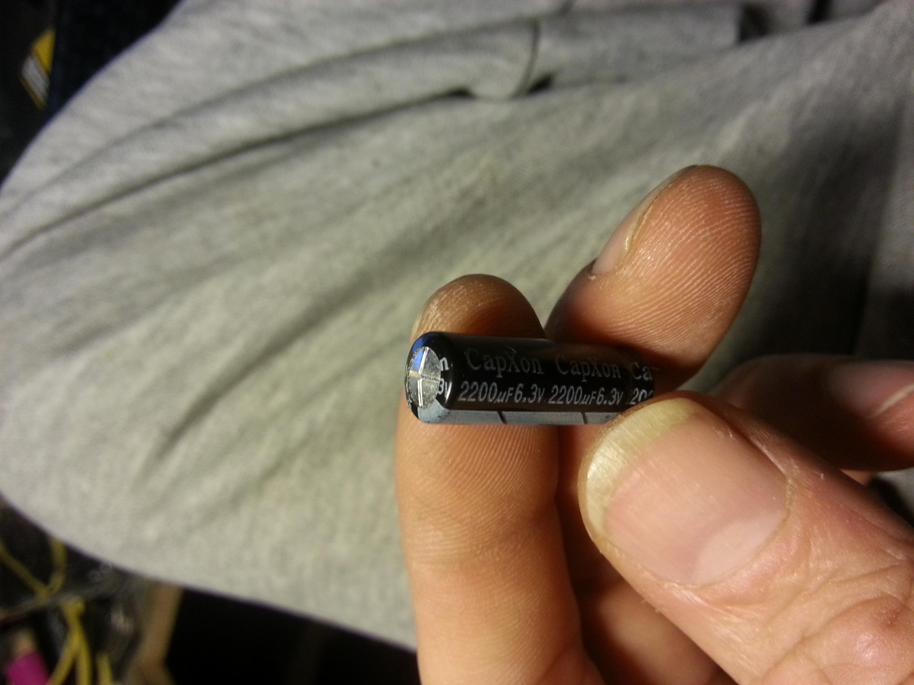

    It's a CapXon 2000uF 6.3v showing 4920uF with an ESR of 0.08 ohms on my meter. It's 8mm x 25mm, now i've tried a 10mm and it's to fat.
    The only 8mm cap i can find is this one.
    http://www.digikey.com/product-searc...=0&pageSize=25
    Is this a suitable replacement and is this power supply worth repairing ?
    I'd replace all of the caps not just the bulging one.

    Hello the replacement capacitor (nichicon hm) is too low esr and is only for mother board use, its a pain when you dont have the correct size cap and you cant fit in replacements, the only real suggestion I have is that you down the capacitance to 1000-1800uf, panasonic do the fr series in 8mm diameter in those values.
    Look up the fr in 1000-1800 uf in 8mm diameter and report back they will be your best choice.

      Thanks, I've located a Panasonic FR with the correct dimensions/voltage but it's only 1500uF.
      I'd have to replace two of these out of out of spec caps, the rest i have found of the same same value/size.

        looks like an old fsp build.
        fm would do fine in that.

              Here's the data sheets for the FR, FR and FC. Unfortunately it seems Panasonic don't make a 2200uF 8mm diameter cap. The highest they do in 8mm is 1500uf.

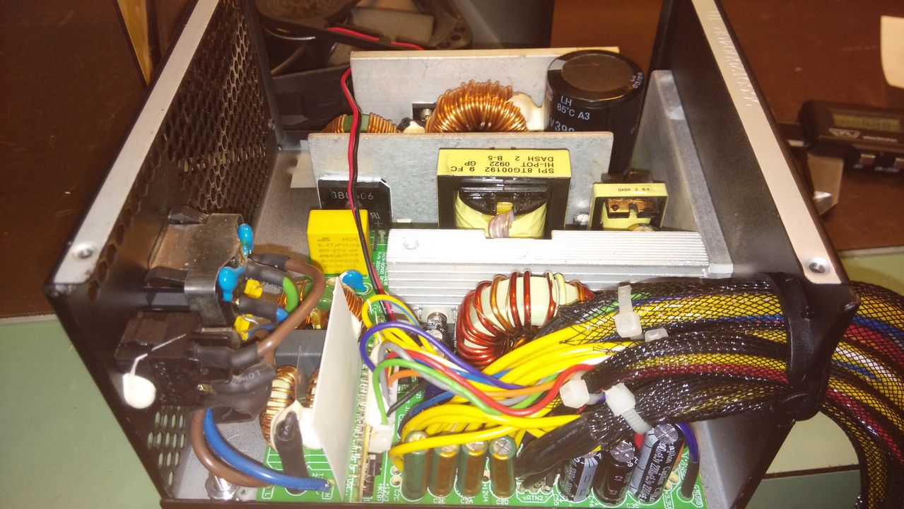

                It is Fortron BlueStorm II internally. You should be able to squeeze D10 capacitor in there without the extra heatshrink, I always have, try again.
                Beware! You need to replace all capacitors in this PSU as all of them will fail, it is only a matter of time. Most Bluestorms II (or OEM designs like GLN based on them) I get have about 80 % caps bad and it is not even able to start anymore. That includes usually totally baked +5 V stand-by rail. You also need to replace two general-purpose high-voltage 1N4007 diodes in the stannd-by circuitry for fast diodes as everell noted.
                I can provide you with the capacitors (and diodes if you need), a combination of NCC KYA 3300/6,3 D10, LXZ 1200/6,3 D8 and KZH 1000/16 D8 (plus some smaller ones), you can do the repair with these for sure (I have been doing them even with Samxons RS 3300/16 D10, now with 1000/16 D8 it is easier).

                  Thanks, after a second look, i can just squeeze a 10mm cap in there but it's touching both the coil and the heatsink. Thanks for the heads up regarding the two diodes, i shall be replacing those along with all the other caps. It's a very kind offer of the components but i think i have the majority of them already as long as Panasonic FR FM FC are ok. It's just the diodes i need to source.

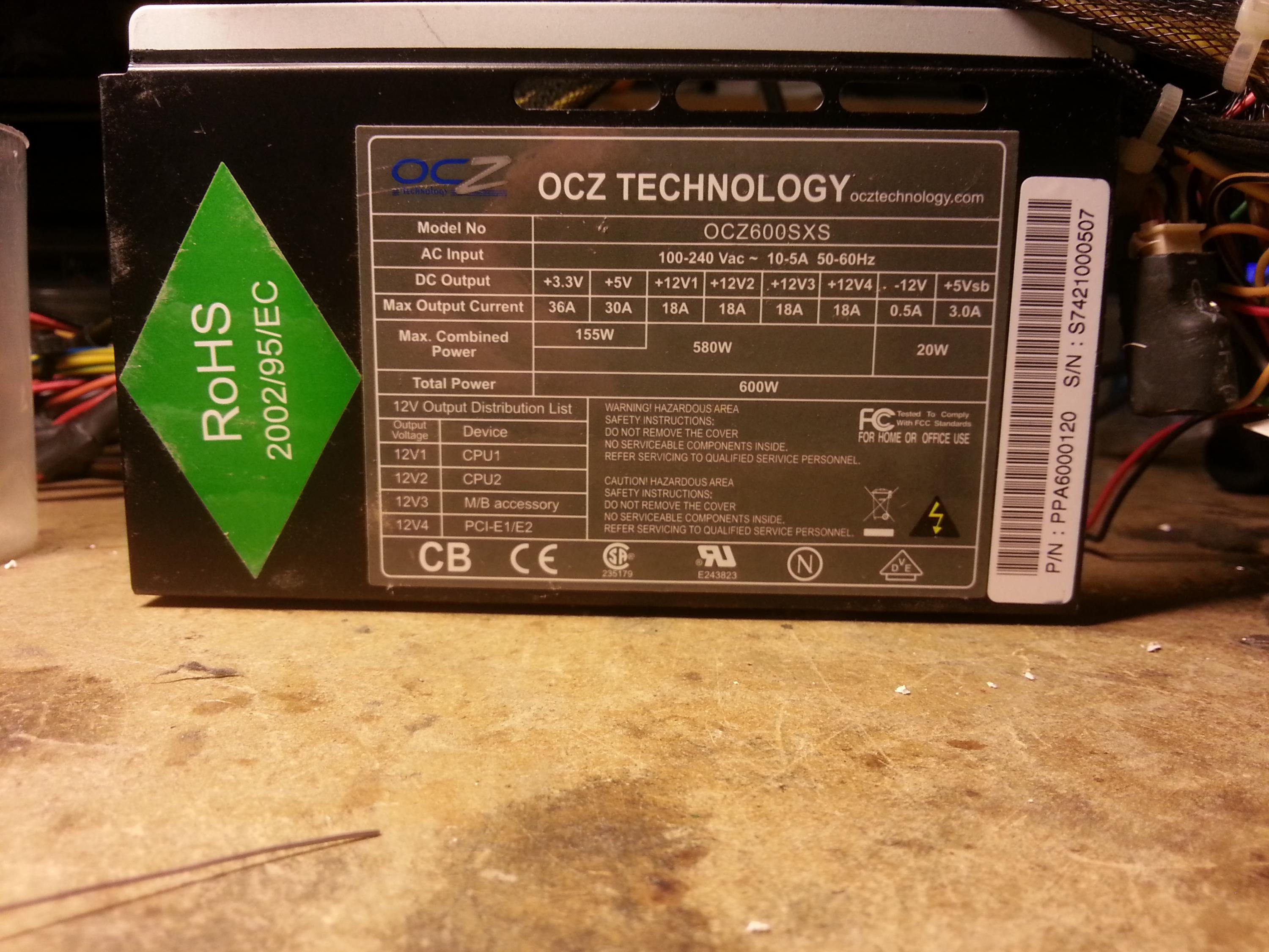

                    I have just bought a PSU of this brand, wattage and model. I haven't turned it on, but the person I have bought said to me that it is working properly, even though he is not using it for 1 year.
                    Before I start working with her, I though in changing all the capacitors and some of the most vital semiconductors.
                    I'd like to hear from you, some advices on what should I do before start working with this PSU.

                            I recon you would get away with the Nich HM just fine. It is lower ESR than the original, but it will also be higher ESR than the standard 10mm 2200uF HM (due to the smaller can size). I've used those 8mm 2200uF 6.3V Nich HM caps in other FSP Power supplies before and it's been fine.

                              It's more on the high side even though it still may be OK. Bigger problem is it is only 2000 hours endurance and I don't trust these caps series, they've been spotted bad years after the problems should have been solved.

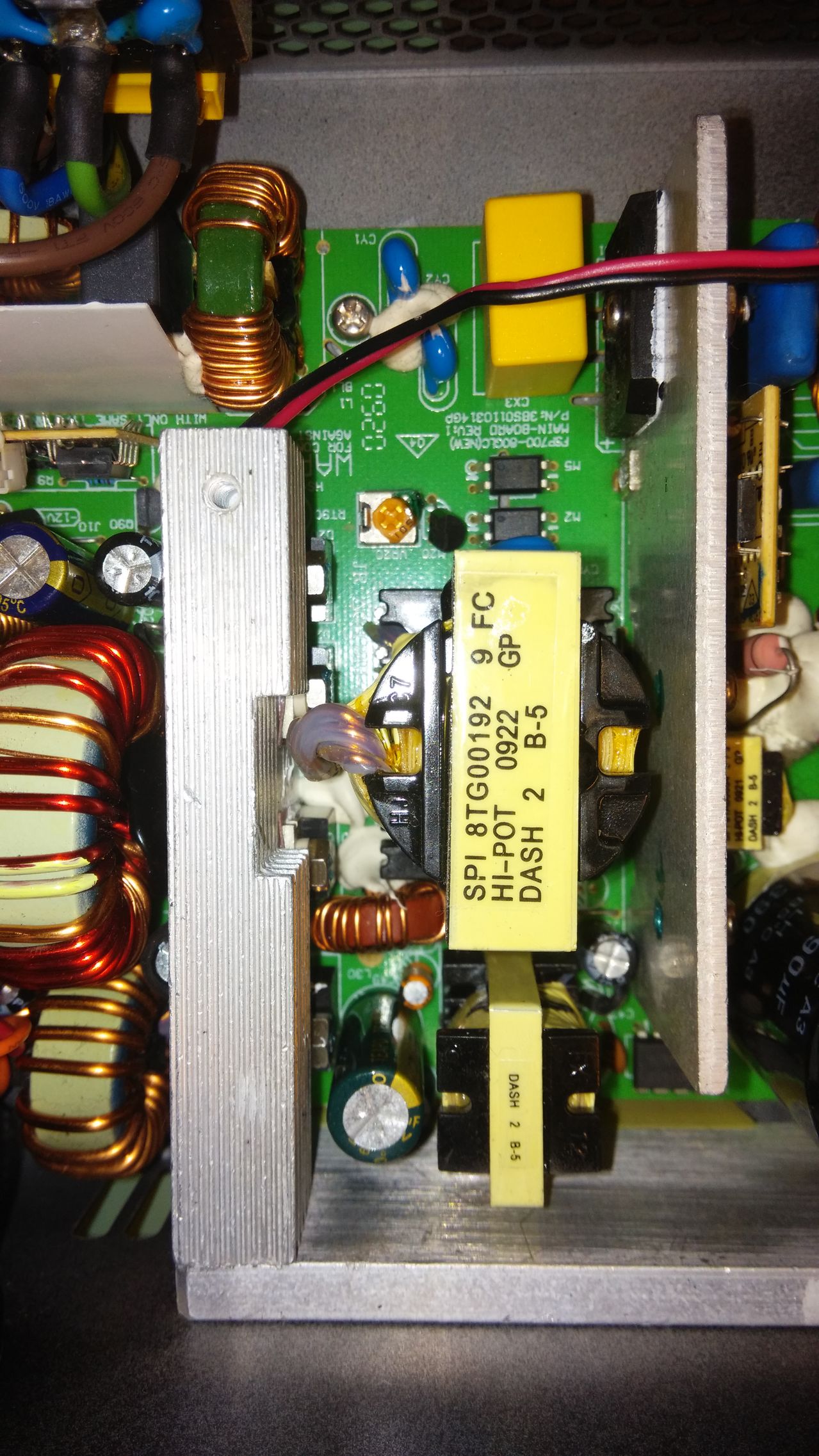

                                Guys, I have a problem here in hands.
                                I have tested this PSU, even without replacing yet the caps (because I don't have them right now), to see if it works.
                                For my surprise the PSU in the 12V line has 9,8V, as you can see in the picture bellow:
                                online photo sharing
                                What might causing this? Could this be caused by bad caps? The HF transformer that it is not working properly? Or it might be the controller (6800)? But to be the controller (the controller is the same for the other lines, of course), the other lines shouldn't work properly too. Right?
                                The HF transformer is the same for all voltage levels, right? So maybe it is not related to the HF transformer at all?
                                I have been told that with that voltage (9,8V) the PSU shouldn't be able to operate at all.
                                Kind regards.

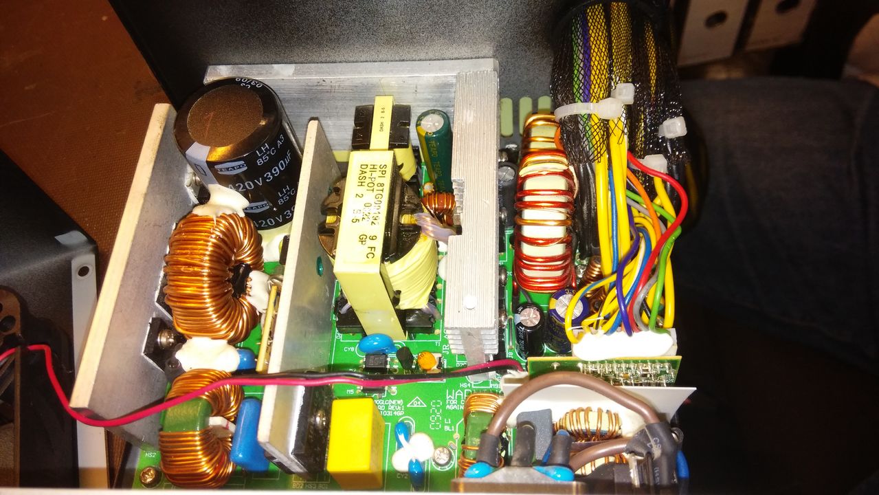

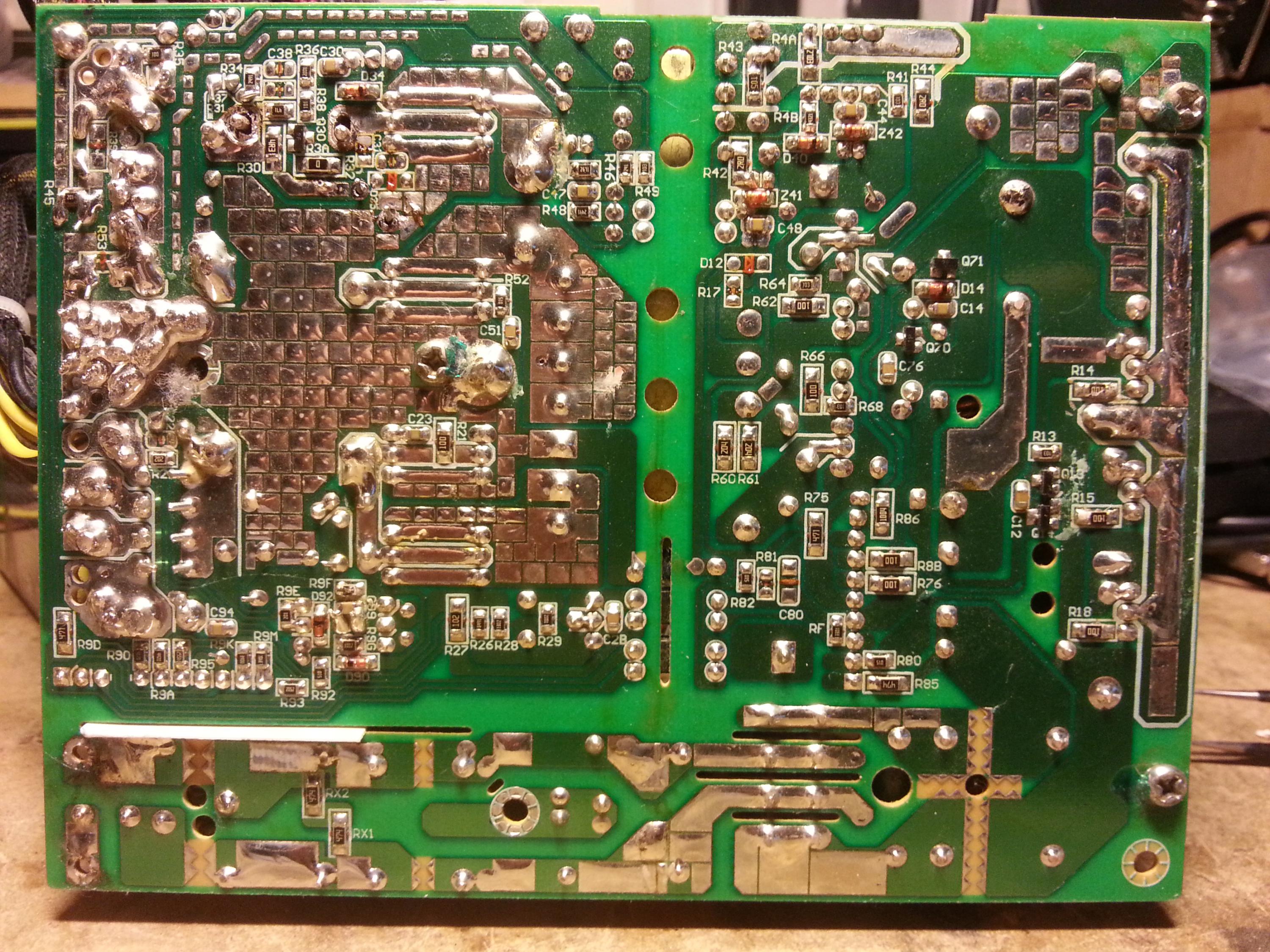

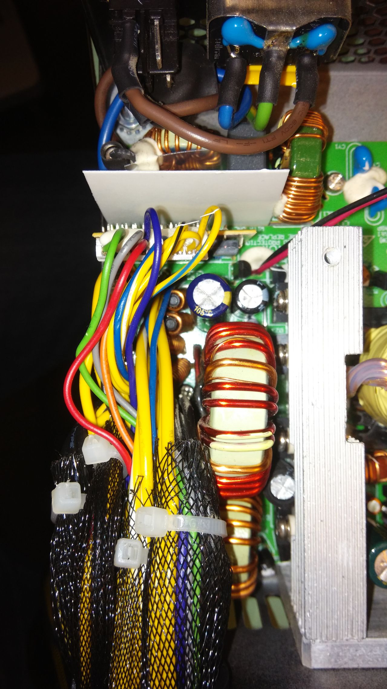

                                  EDIT: I forgot to post some pictures of the PSU:
                                  Any suggestions guys?
