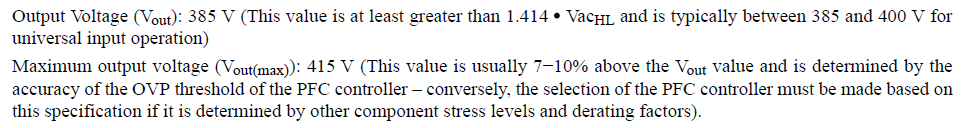

                ... Voltage across the main capacitor: ... 405 volts with the power supply on ...
                Is that voltage typical?
                I'm asking because many APFC PSUs have a bulk cap rated at just 400V (instead of 420 or 450). Calculated risk or dangerous penny-pinching?

                          I don't think that is common, usually it is 380-390 V.
                          Perhaps the voltage on the bulk cap is a bit higher or lower in function of the topology used or whatever?
                          Otherwise I'm puzzled. For instance, when crmaris reviews the relatively simple and unexpensive (~$75) L8 500W, with 400V bulk cap, he criticizes the fact:
                          "... The bulk cap is provided by Teapo (400 V, 270 μF, 85°C, LH series) and is rather small for the needs of this unit. Also, the voltage rating of this cap is low and close to the DC bus of the APFC circuit (~380 VDC). Ideally, a 420 V or even better a 450 V cap should be used but it is significantly more expensive, so most manufacturers prefer 400 V ones. The latter case requires a tight tolerance in the feedback/reference voltage of the PFC controller to ensure that in the cap will not take voltage beyond its rating ..."
                          http://www.techpowerup.com/reviews/b...L8_500W/4.html
                          Then he reviews the much more sophisticated and expensive (~$230) Corsair HXi 1000W, also with 400V rated bulk caps, and says nothing of the kind :
                          http://www.techpowerup.com/reviews/C...HX1000i/4.html
                          Then I lift the skirt of my L8 300W (even cheaper and simpler than the L8 500W) and find a 420V rated bulk cap .

                                  Found this piece of info:
                                  ^ If I get it right sounds like the minimum voltage rating of the bulk cap/s might be related to the accuracy of the APFC PWM controller.
                                  · More accurate APFC PWM controller => 400V might be enough to hold the position.
                                  · Less accurate APFC PWM controller => Better use 420V or higher to prevent .
