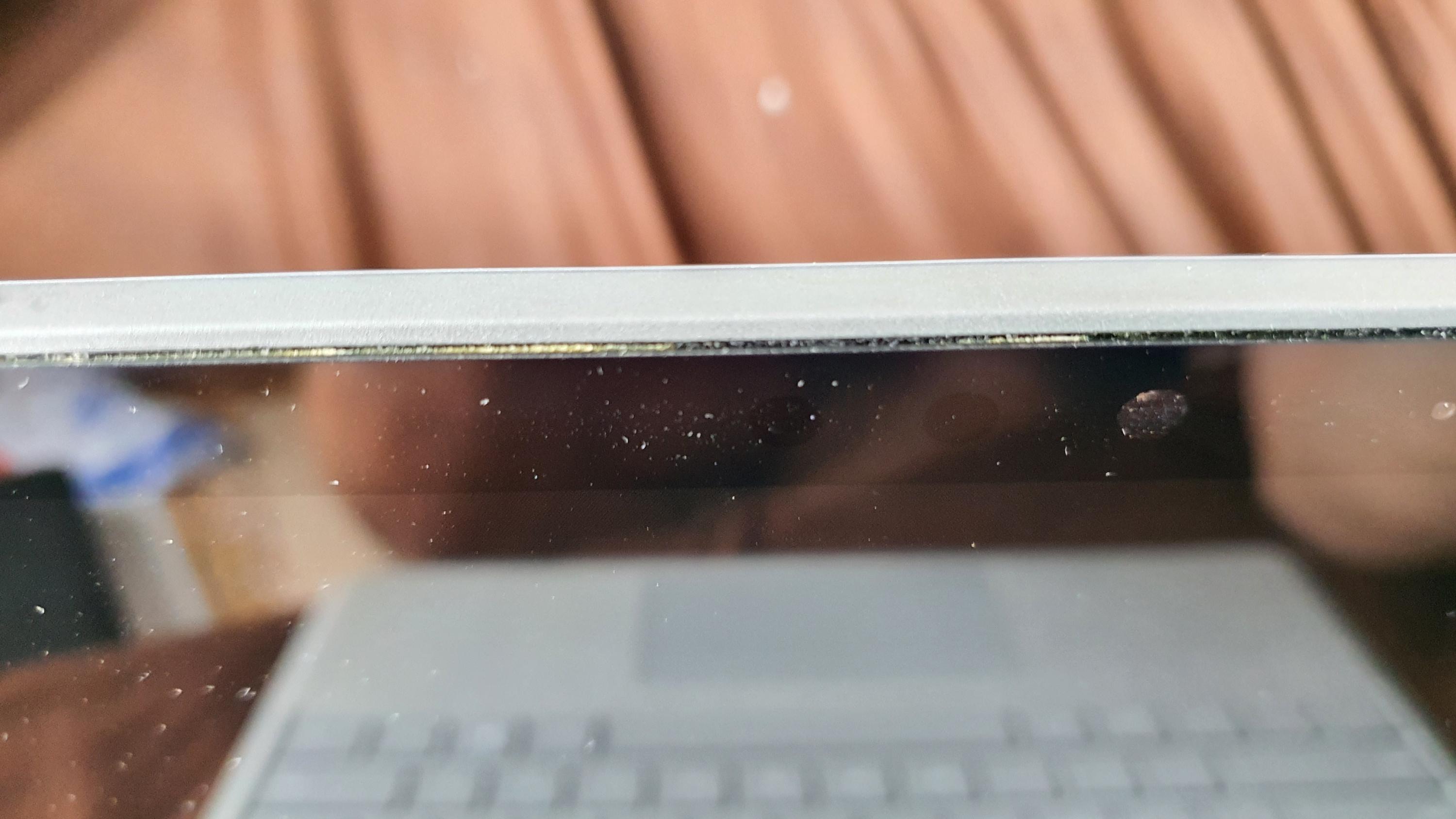

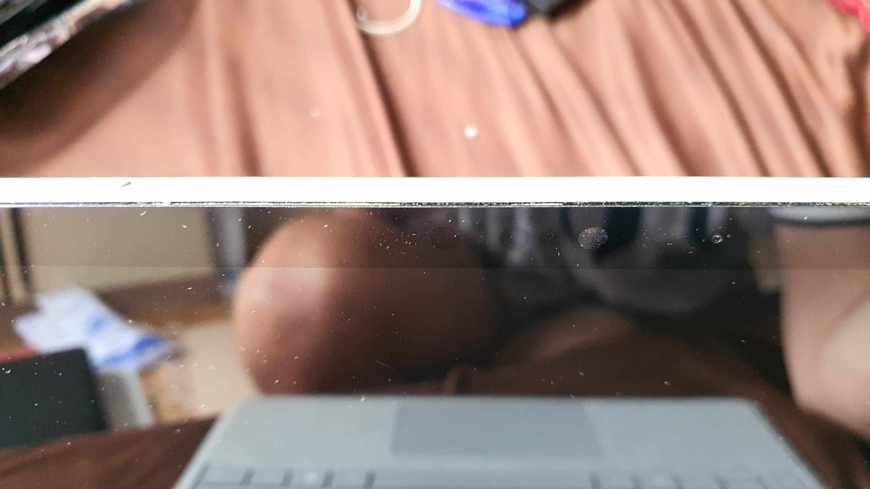

    Hi guys.
    I purchased this tablet in used condition from a guy claiming nothing wrong is with it.
    While I was cleaning the tablet I noticed this (pics) at the top edge of the tablet.It is barely visible,maybe crack is like 1mm wide or so, and I can see probably yellow glue stains.
    Now I read about all nasty stuff about battery bulging and causing screen to separate on Surface Pro 4.
    Is that even in my case?
    Or someone replaced the screen,and didn't use a proper glue.
    Gosh,it just made me depressed and worried even more,cuz I'm perfectionist (OCD).
    Yeah I know this thing is 5 years old,yeah I know it has issues with battery but then again I love the design and wanted to have it.
    Battery wear level is 13 %,I mean that is not that bad.
    I know to keep my things in good shape,my tablets last me even 8 years.
    So I suppose I need to take some precautions about this battery just to try to slow thig "bulging" down.
    Can send battery report file,if someone wants to check up on battery.

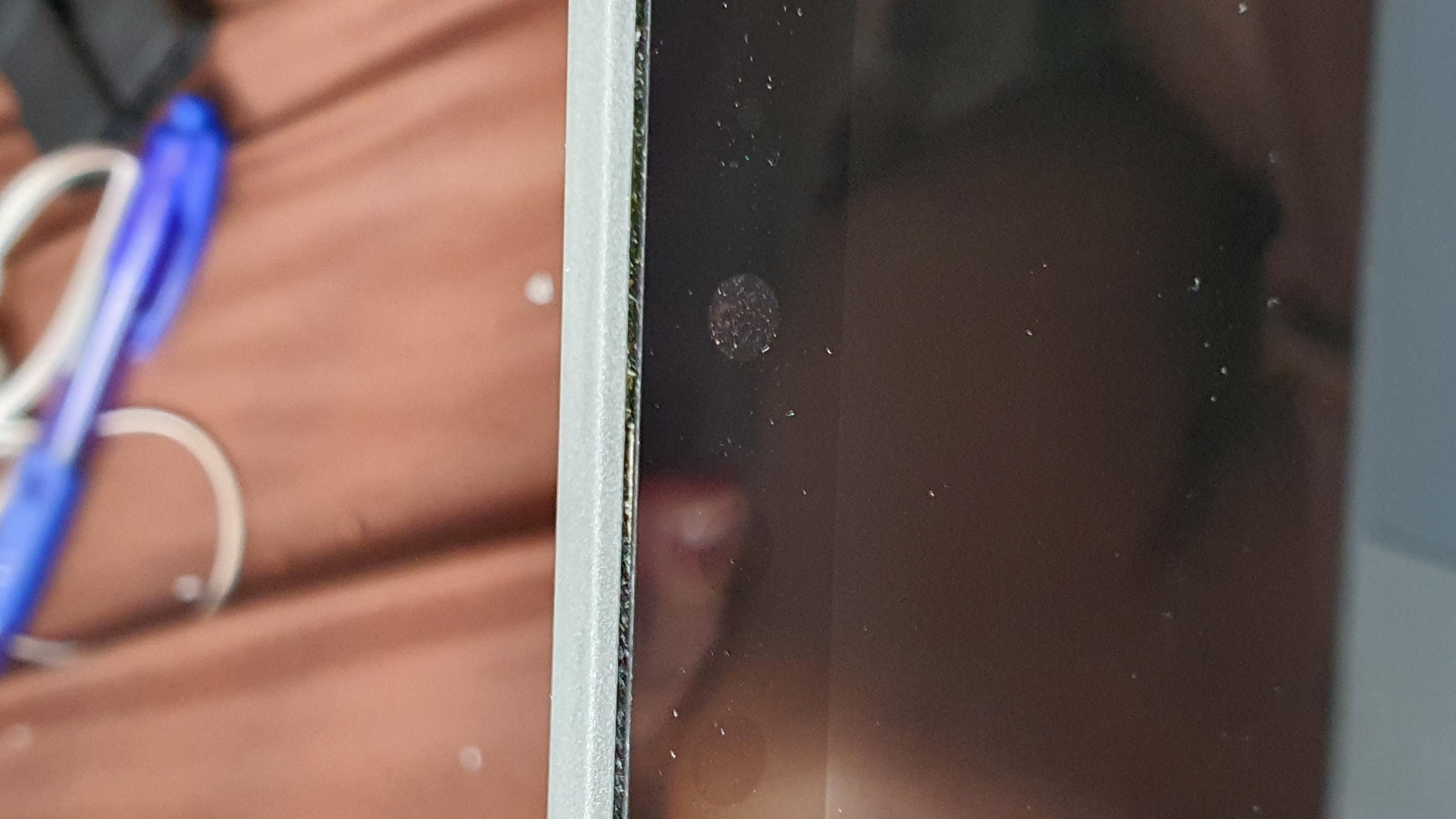

      I have some close up shots of a screen edge.

              Here is a closeup I did.
              So what do you think?
              Someone opened the tablet abd fixed smth, or my battery is swollen?

                      Far more complicated then opening the phone,phone is 6" this thing is 2x bigger with display so higher risk of breaking the screen.
                      Naaah,I'm positive no repair service would accept the responsability to open the device.
                      Have you seen on other devices where screen buldge?
                      It is not on the top edge of the display it's on vertical sides and so far mines are perfectly flat.
                      But yeah there is a possibility that battery is swollen.
                      Havent found over google even yet a device with buldge on top edge of the screen.

                            Re: Screen bulging/separating from frame a bit on Surface Pro 5
                            Laptop stays perfetcly flat on flat surface...
                            I did some battery test,lost 13 % of battery while watchinh 1h 1080p vid on yt.
                            Mostly its bulging around camera, I can push the screen inwards and it stays there for a sec or two and then bulge back.
                            99% of Surface I saw while googling screen bulge at a sides on vertical sides.

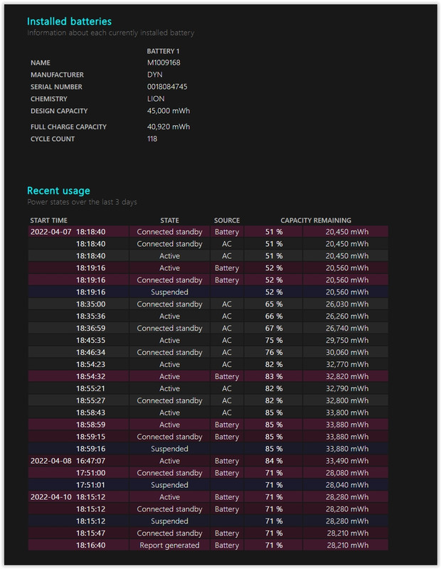

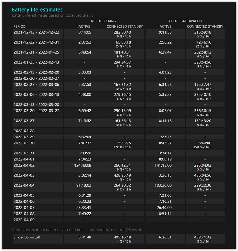

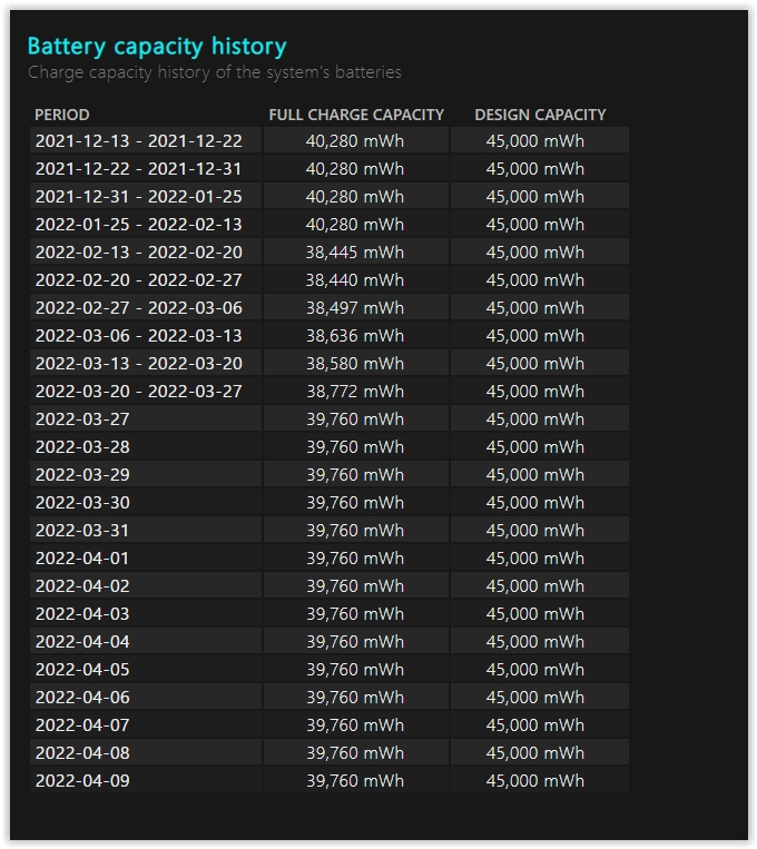

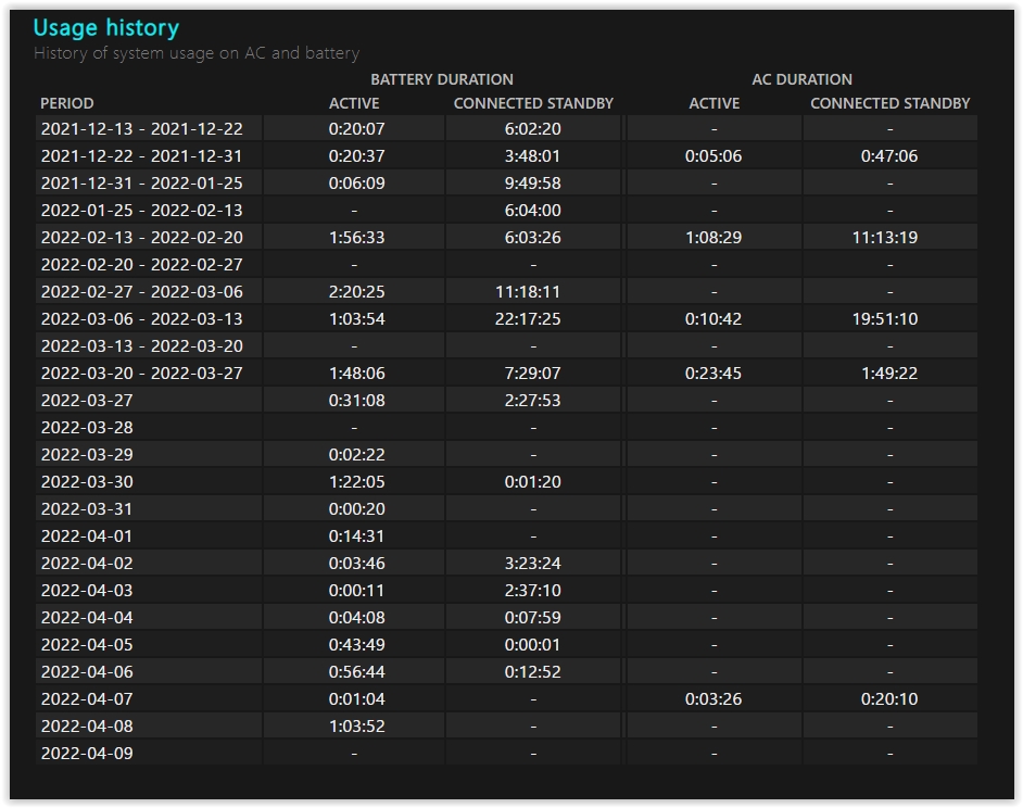

                              Here is the battery report I got.
                              Judging by this battery ain't bad at all.

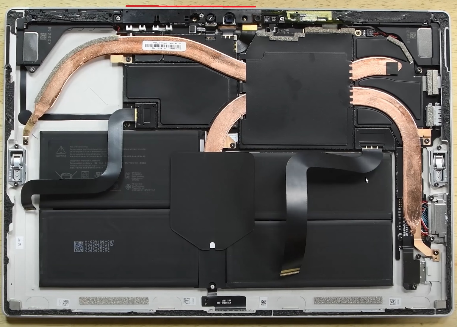

                                Here is a picture I captured of my Surface from the inside.
                                In the part marked in red, there is a "problem" in my case.
                                As far as I can see, there is nothing there except this one heat pipe, which I doubt I raised the screen because it is connected to 4 screws on the cooler via the CPU.
                                The only possibility that comes to my mind is that there was a buldge on the sides or on the vertical edges, but someone skillfully glued it, so now it peeled off on the upper edge, but I don't believe that even though it started to break, it can be glued.
                                As you can see the battery is in the lower half of the Surface.
                                I don't think you need to be a scientist, and I would like someone from these foreigners to explain to me how they think it's a battery after all ...
                                What do you guys think?
