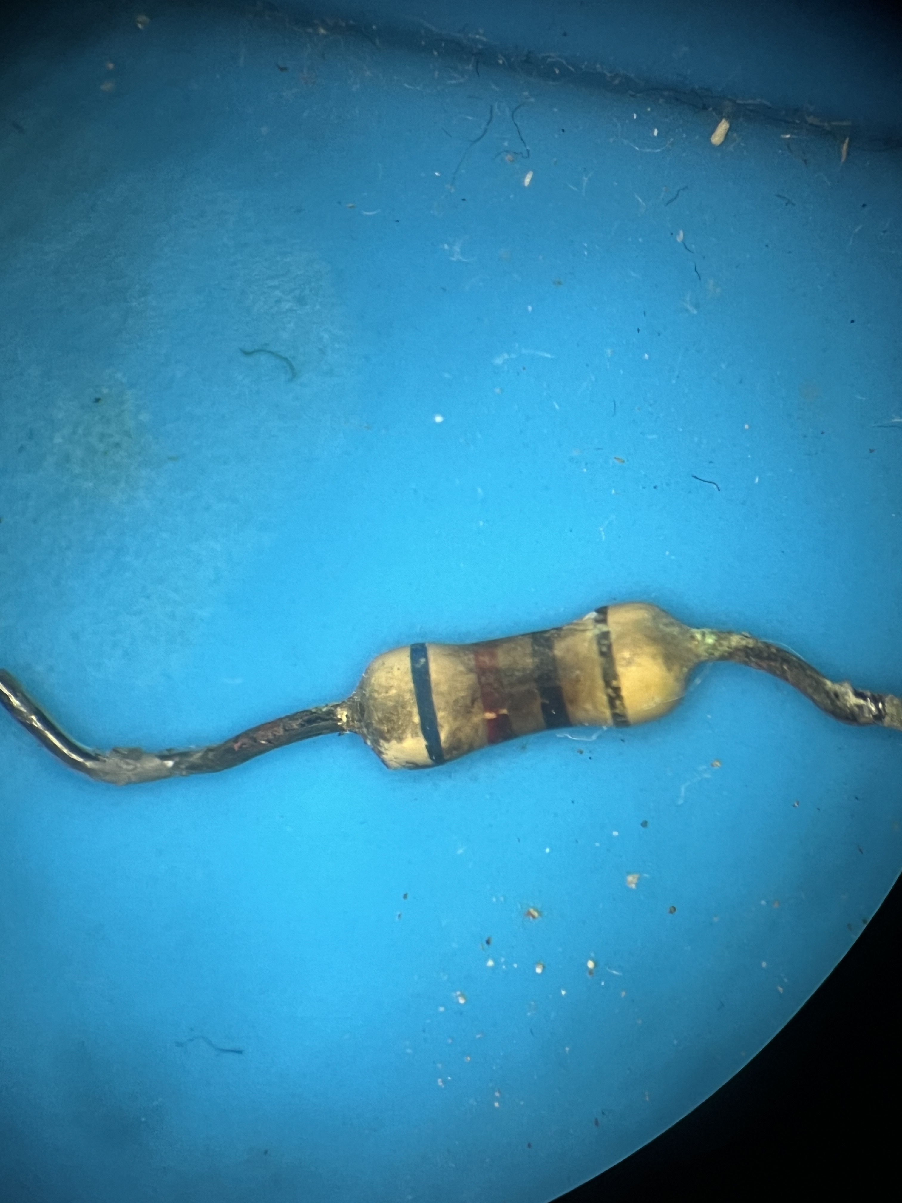

                I also found this resistor to look burned, it reads 0.6kOhm but from the color chart it shoud be like 60ohm not in kOhm, am i correct

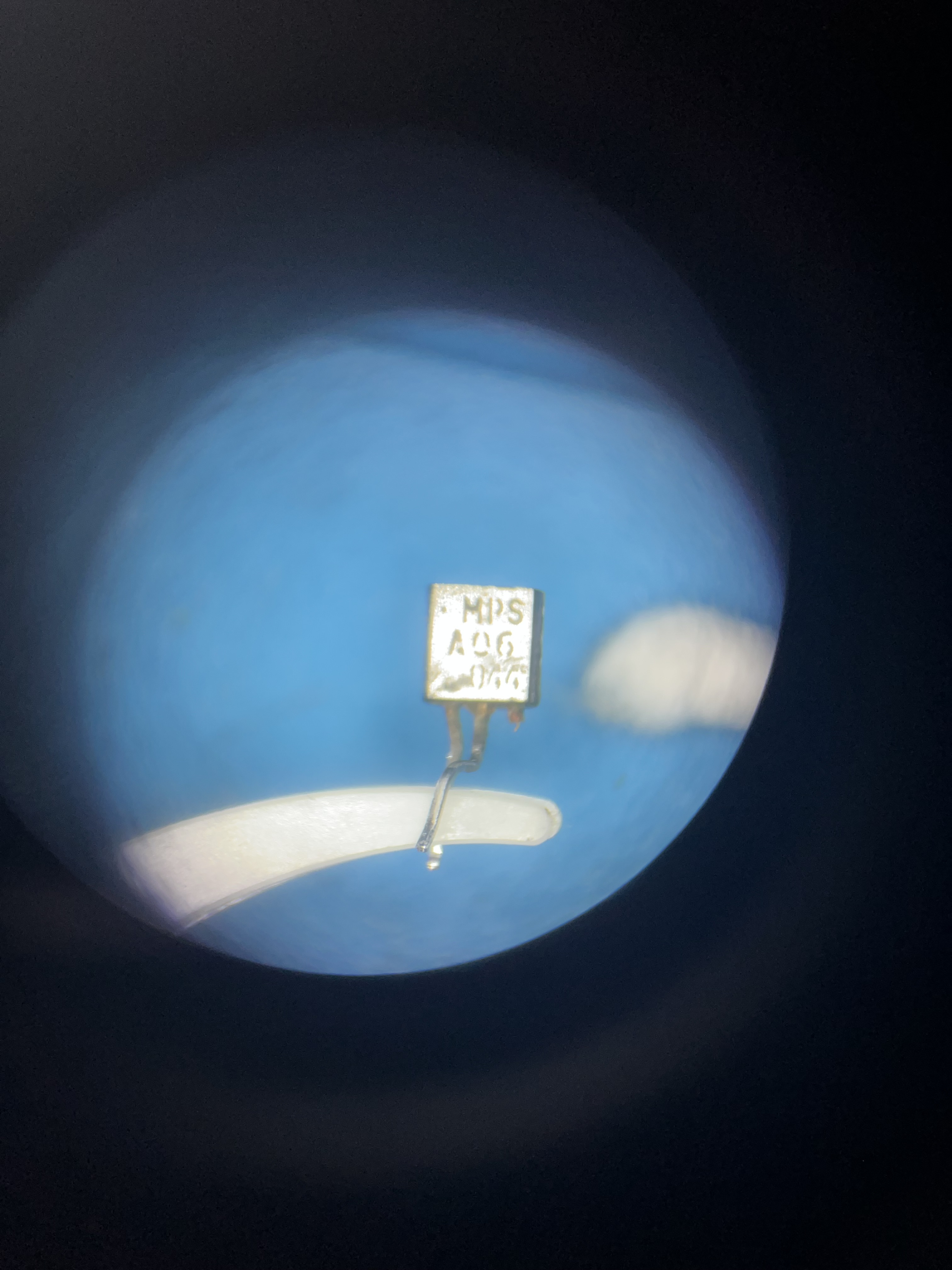

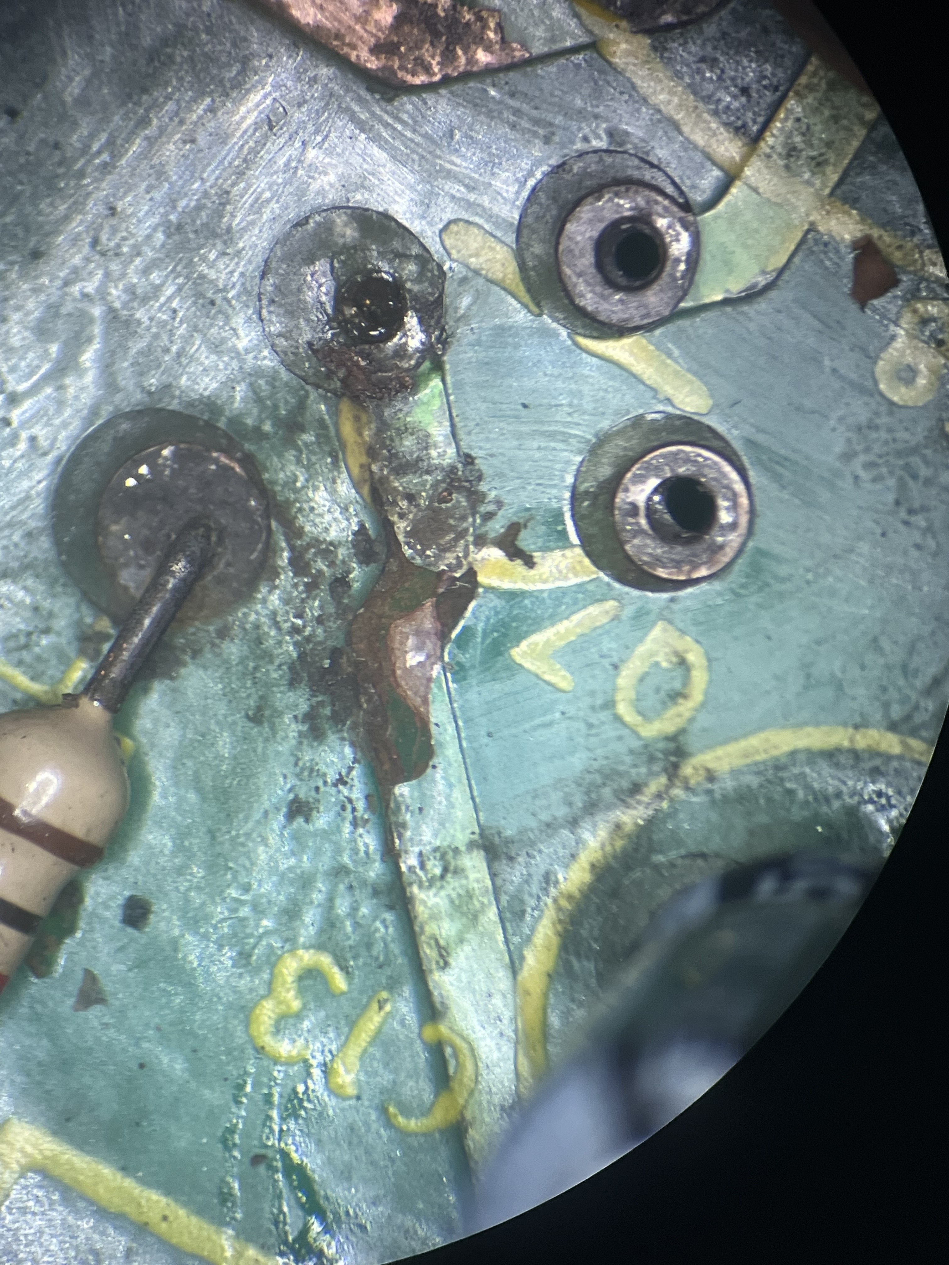

                    Well i am cleaning peace by peace and under one transistor found broken trace. Also colector leg was broken, i will replace it and repair the trace, maybe this will do the trick.
                    2N5038 is fine, not open or shorted

                      Hm… MPSA06… PNP transistor. Should be easy to replace. The 2n5038 is quite a hefty NPN transistor for this remote.
                        Looks like it's available through Mouser and Digi-Key, but in Croatia? It's made by On Semi. IIRC (from ~45 years ago) that part is higher than the common maximum voltage for a PNP BJT.
                          it is available here in EU

                            The 2n5038 is a very common 140v NPN type of transistor it crosses over to a lot of other transistor numbers even “modern” TO3 numbers. No problem.

                                  Well i replace MPSA06 and i repair broken trace but still nothing, i check for other broken trace but all seams fine. I have check the NPN 2N5038 and i only have voltage on case of transistor, the pins are 0V

                                      Did you replace the MPSA06 with the same NPN or did you use a sub?

                                        The same
