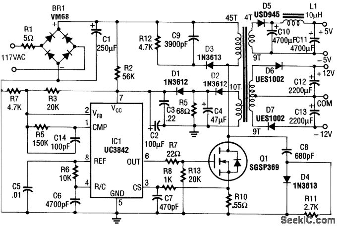

    The "startup capacitors" ("startup and run" is maybe a better term) are just power supply filtering capacitors for the power supply of the PWM controller circuit (usually an IC)
    Before the PSU starts running, these capacitor(s) are (usually) charged though high-value resistors that feed from the primary filter capacitors (the 200v or 400v one(s)) The capacitor has enough energy stored to power the PWM controller as it begins to start oscillating and switching the current through the primary winding of the transformer.
    Once the controller is running, the PWM controller gets most of its power now from a secondary winding on the transformer which is rectified by a diode and filtered with the capacitor(s) in question.
    If the capacitor is failing, it can't hold enough power to keep the PWM controller running and the PSU shuts down or ends up in a power cycling condition.
    See the example in the schematic attached. Pin 7 is the supply pin of the PWM IC and R2 supplies the initial power. Once the supply is running, the power comes through D1 and D2.

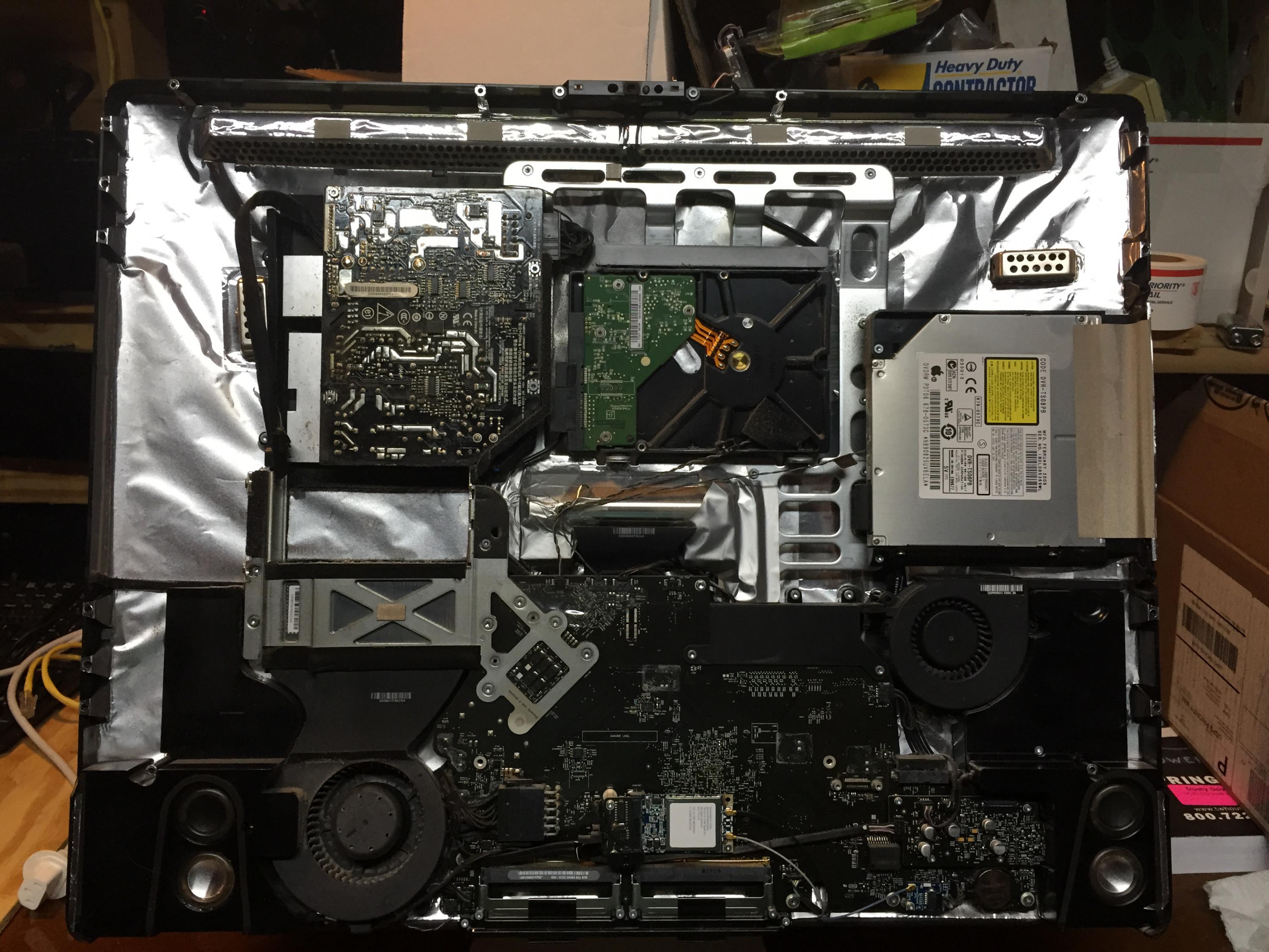

              I've got a similar PSU removed from an early 2009 iMac. Liteon PA-3241-02A2. Blown input fuse. No visible damage to any caps, FETs, or diodes. The diodes and bridge rect. seem to test out OK. None of the FETs (or transistors) appear shorted.
              Since I don't see any obvious "smoking gun" bad components on this PSU I'm considering installing a new fuse and powering up separately on my bench with 120VAC and checking output voltages.
              I'm assuming that if things are working right I should get some 12V standby power initially. But then I'll need to drive/short/pullup/pulldown a control signal on this 12 pin connector to turn the main outputs on...?

                  I soldered in a new 5A slow blow fuse and powered it up on the bench (no load). Fuse held; no magic smoke and the standby 12V pin reads 12.2VDC. OK so far.
                  Reinstalled the PSU in the iMac. It powers up, I get the Mac "chime" sound indicating it has made it past the POST check. There is no HDD installed so I can't yet test the complete boot process.
                  The PSU is making a faint buzzing sound which lasts about 500ms and repeats every 2 seconds or so.
                  The main 12V output reads 12.0V on the DMM, but on my oscilloscope I see transients of about 1Vpp on the 12V rail. Not so good. Not sure if that transient burst is synchronized with the buzzing I'm hearing.
                  I have not tried connecting the LCD panel yet.
                  This iMac has four diagnostic LEDs on the logic board:
                  LED 1 = standby power OK = ON
                  LED 2 = main power OK = ON (after powerup)
                  LED 3 = CPU-video card comm OK = OFF
                  LED 4 = LCD panel comm OK = OFF

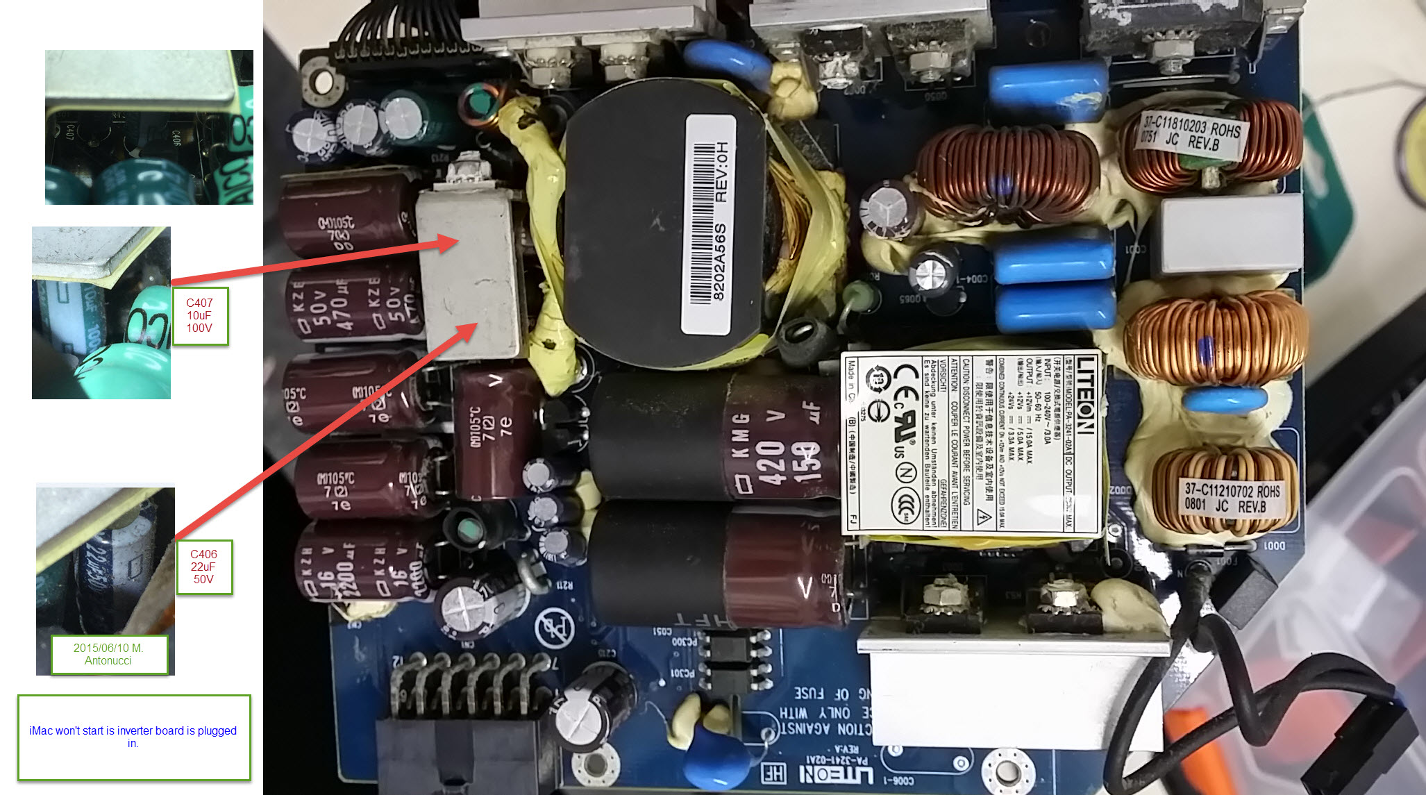

                                      Hello.
                                      This is my first posting!
                                      I was fixing an Apple iMac 24” ~2008, Model A1225 with a Liteon power supply PA-3241-02A1
                                      Symptom:
                                      iMac will shut down when turned on.
                                      When the power button is pressed, the fans begin to spin. When the inverter board attempts to turn on, the entire power supply shuts down. Unplug the inverter board power connector and the iMac will start to boot normally (without a display of course). The 24V power supply is at 24V BUT if loaded with the slightest load (10K Ohms), the power supply shuts down.
                                      I suspected the two caps under the heatsink for the dual diode device probably went bad.
                                      Caps Replaced:
                                      C406 22uF 50V (Blue caps) Digikey P15374CT-ND
                                      C407 10uF 100V (Green Cap) Digikey 1189-1513-1-ND
                                      Removal of the caps was a bit tricky without removing the heat sink but not impossible!
                                      The iMac now powers up properly.
                                      One side effect that I can't solve and it might be a SW problem, the screen comes up washed out! Many people have this issue. Simply put the iMac to sleep for a minute and then wake it up. The colors will return to normal. I even pulled the SATA cable to the HD and it still powered up washed out. I suspect a HW problem but I'm not sure. My friend is still happy with the repair job.

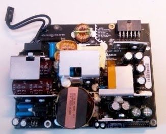

                                          Hello All,
                                          My name is Richard and I am new to this forum, I have been pulling my hair out looking for a Pin out of the 6 pin PSU to Logic board. I have managed to find grounds and that is about it. I truly believe my PSU to be toast but I have no means to prove this per I cannot get the Logic board to display any forms of life. without a means to power the system. I would hate to replace the Logic board since I have 2109480129.2 (Exaggeration) ATX power supply's laying around that function. Before I dive into the schematic and lots of lost hours has any one by chance already completed this Feat.
                                          Fyi the PSU is manufactured by Delta and the PN is 614-0432 and also came out of a iMac 24 it is also a 240w and its identical to the photos provided seen in this threat. Thank you in advance, cool:
