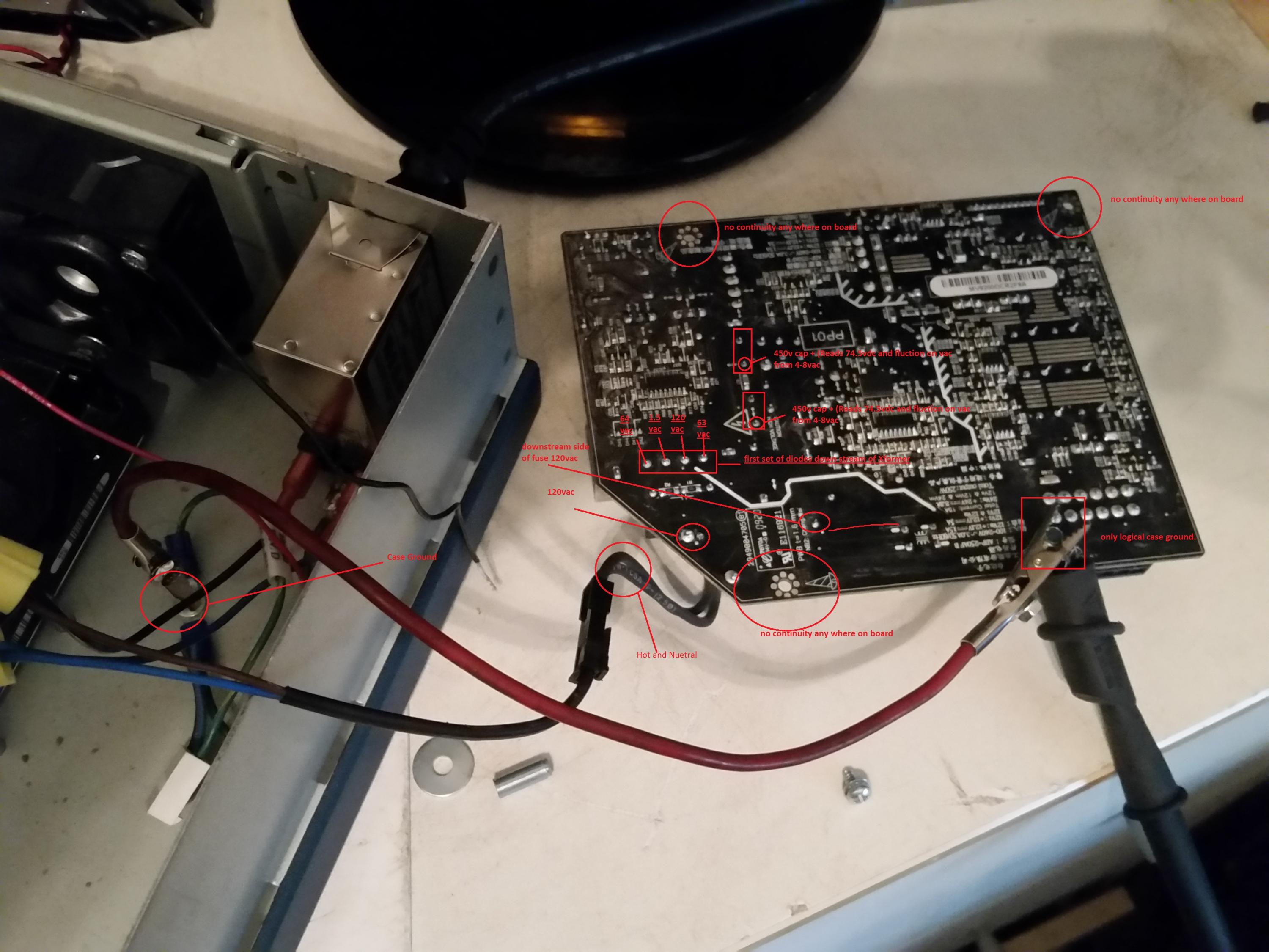

                  #48
                  Re: iMac 24 PSU LITEON PA-3241-02A1 250W
                  The Multi meter is set vdc (Auto ranging), Its a fluke 87 V and its calibrated Yearly. My negative lead is placed on Case ground (See next post for what appears to be issues with grounding on the board). The board is grounded to Case via screw holes. When reading the caps I am reading the (+) on the large brown 450v caps that are laying on their side. Both caps read at +77.2vdc and when I read the neg on the cap they read -75.4vdc. Standby for Bridge diode reads.

                    #49
                    See attached Photo

                      #50
                      Nope. Not the correct reading or method.
                      Your reading at the bridge of 120Vac is good.
                      Your reading of 63Vac is incorrect. You meter must be on the DC scale to read across the 2 outside pins. You should get 170Vdc. If not, the bridge is bad, but that's unlikely as the fuse would have popped. Look at the face of the bridge rectifier. The pin marked with the negative sign is -usually- the HOT side ground/common. Use that as your connection for the negative meter lead when reading the HOT side - the area bounded by the white lines and board perforations.
                      Your statement of "the first set of diodes downstream of the transformer" is incorrect. The is no transformer upstream, only a choke(s).
                      There is no common ground. Those points you marked as "no continuity..." are simply mounting points for the board, nothing more.
                      Can you get a shot topside so we can see the caps? A couple angles would be good. Then some of the foil side that is more straight on and illuminated enough without glare so we can see the traces?
                      I have a feeling the switcher may not be active. That's usually one or two of the small caps nearby.
                      The 12Vdc is from the 12 pin connector. The 24Vdc comes from the long thin connector which is also 12 pins. 6 positive, 6 negative.
                      T
                      veritas odium parit

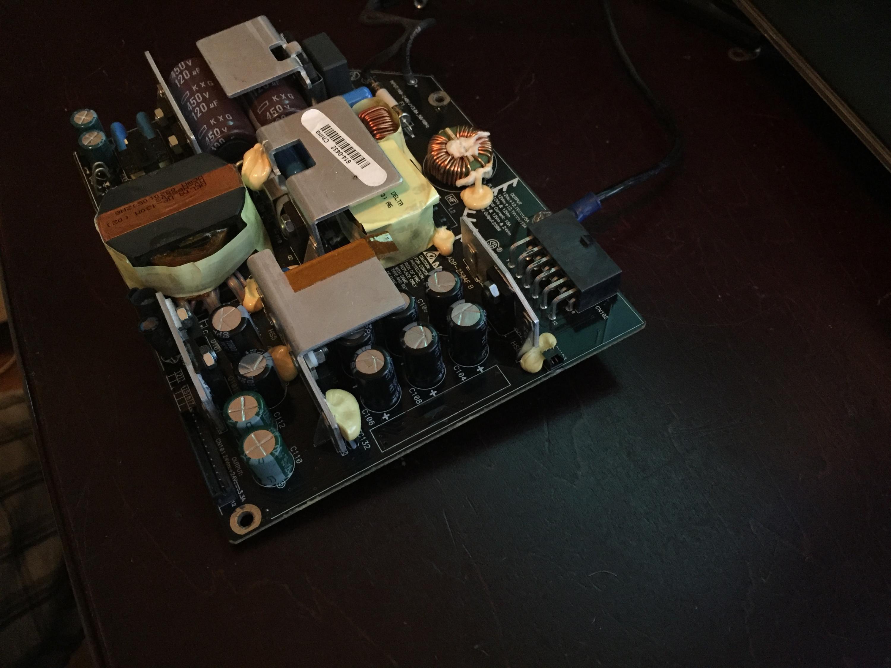

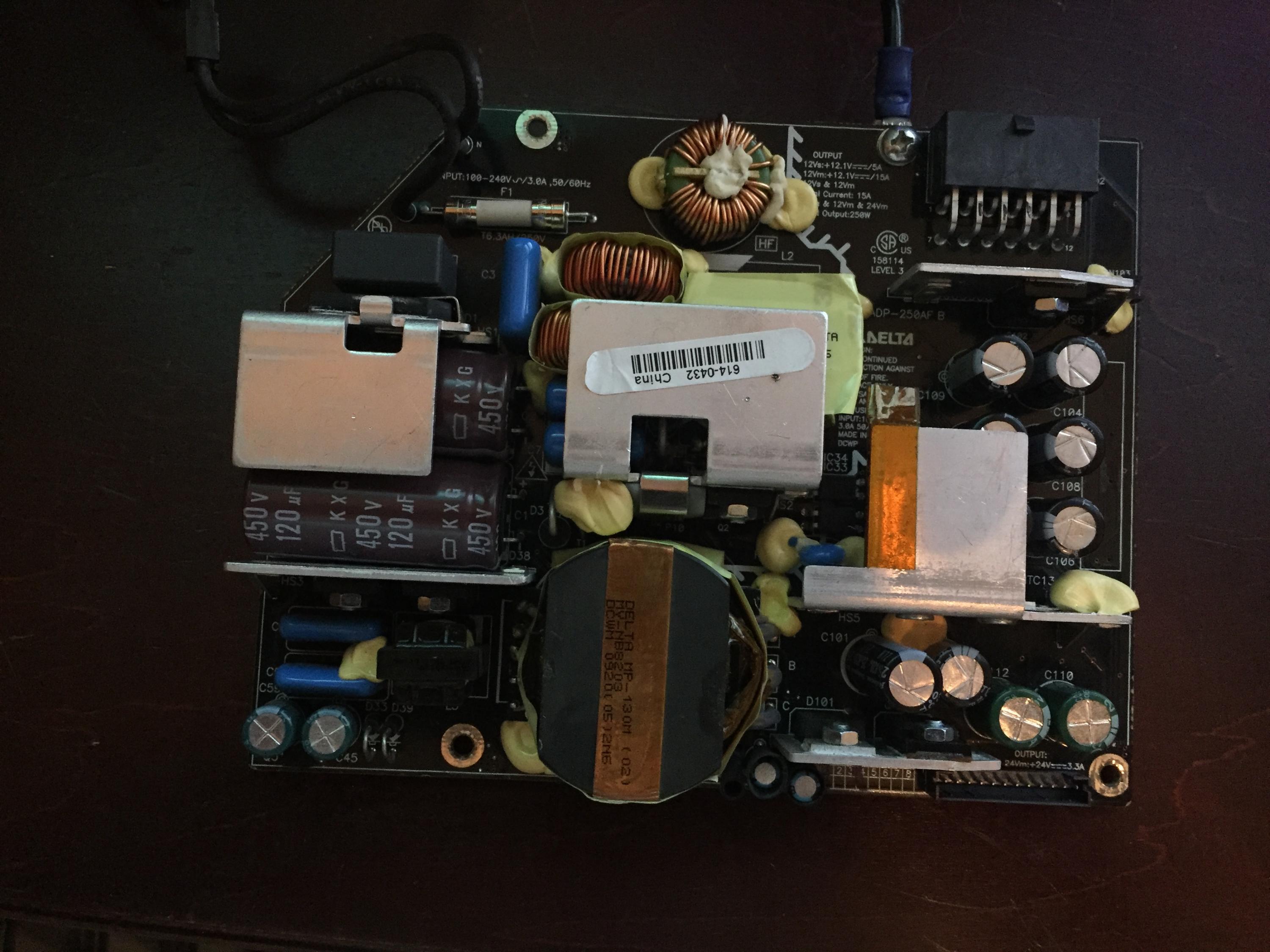

                        #51
                        See attached photos of the top of this PSU

                          #52
                          I get 160vdc across the 2 outside pins on the bridge
                          • Toasty
                            • Jul 2007
                            • 4171
                            #53
                            Excellent!
                            Because your bridge rectifier is under a pressure clip you probably cant read the markings. So, the "cut" corner is the positive end and the opposite end is the negative.
                            Now, set your meter to the 500Vdc or higher range and check the voltage on the main caps. As I said, use the negative pin of the bridge rectifier as your common.

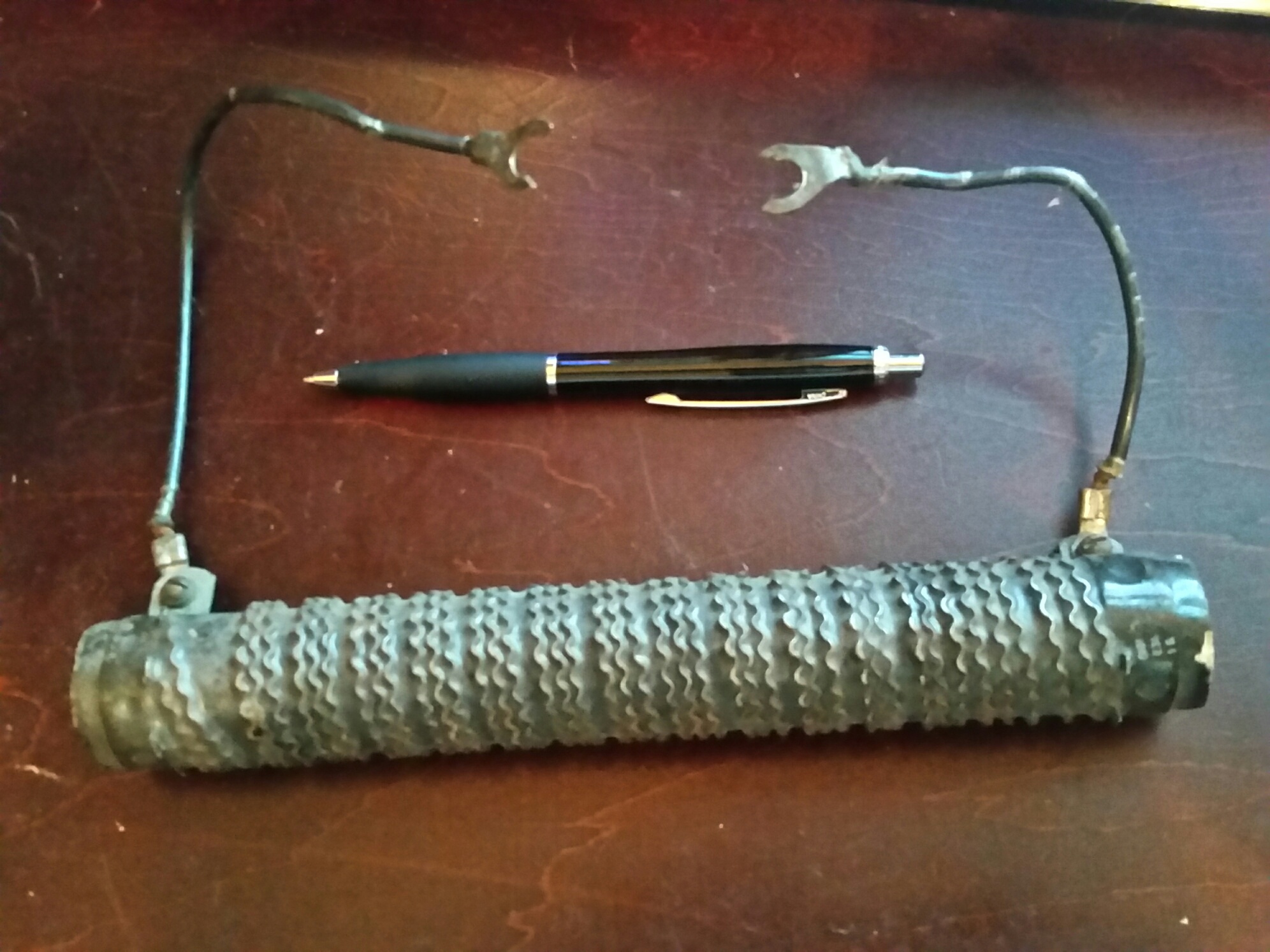

                                      Okay. You need to apply a load across the 12v side. An -incandescent- automobile marker lamp, like a 194 wedge type, is a good choice. The PSU may simply be waiting for a load to be presented before it switches on.
                                      As it stands now, the switcher is not running, and without an actual unit in front of me, it is difficult to go step by step. I have the Liteon unit that this thread is based on, but not the Delta one you have. Nor am I willing to expend the money to buy one off flea-bay, as no "dead" units are up for sale.

                                        #59
                                        Alright well I have had a difficult time finding a 12 car bulb but I have just as equiv for load. I have a 300w 1ohm test resister that should do the trick. no light to turn on but I can tell you if when it gets warm its providing a load. I can surely measure the voltage drop across it if and when this PSU turns on.
                                        see photo.
                                        • Toasty
                                          • Jul 2007
                                          • 4171
                                          #60
                                          No! That will likely present as a short to the PSU and it won't turn on. Or, it will cause it to go into shutdown. I only want you to lightly load it.
                                          If it does come on with that, it will get darn hot very quickly. Around 144W worth. :o
