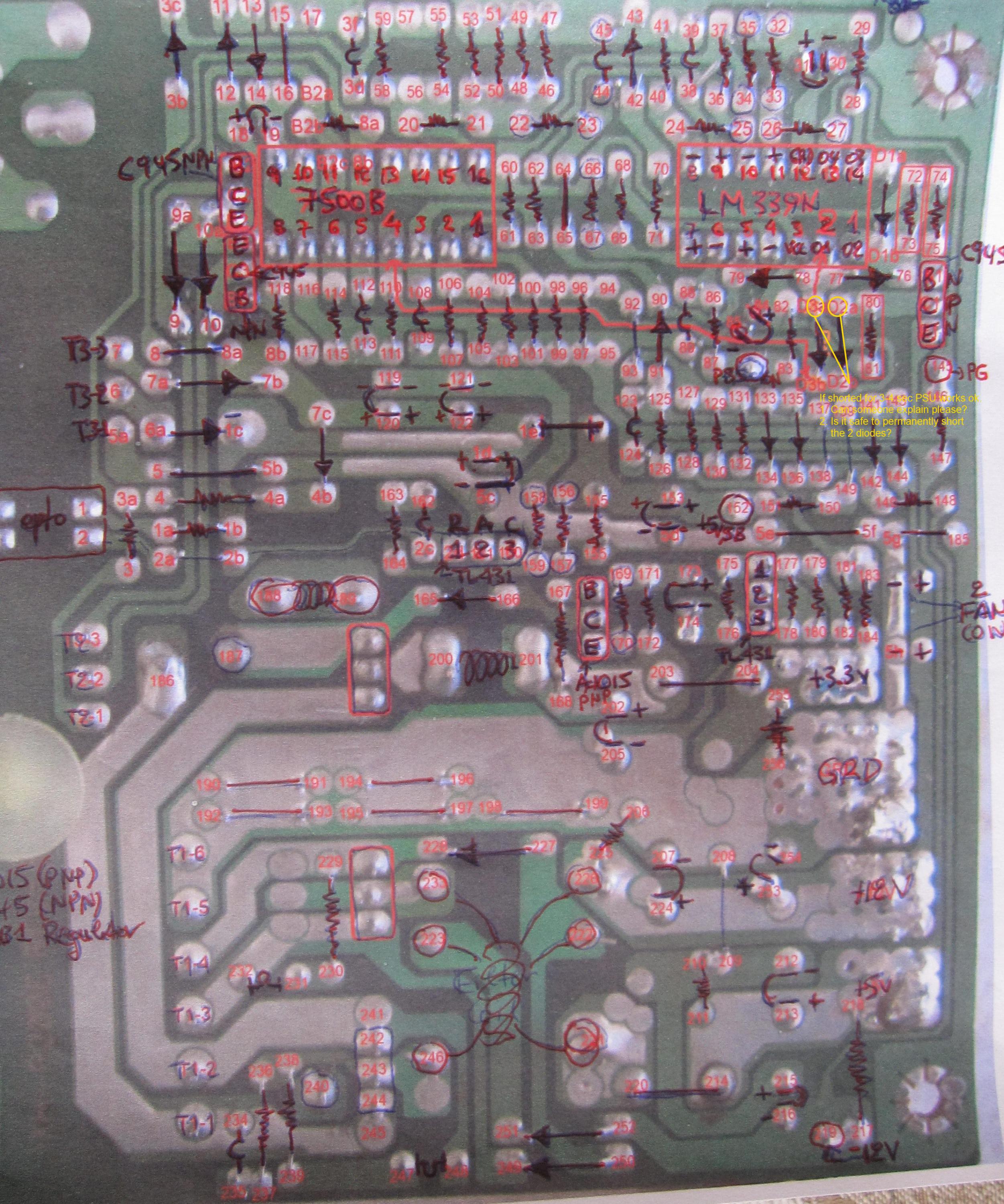

Need help for repairing PSU with only +5vsb output
Re: Need help for repairing PSU with only +5vsb output
4.94 Volt is OK . What about the Transistor C945 and Diodes ? Are they OK ??Comment
Yes all are ok... I wanted to be 100% sure so i used all IC's and almost all diodes from secondary side, LM339N and 7500B from the good one psu and vise versa. The good one psu working ok and the faulty still no go just +5vsb. , Also checked all caps with ESR tester.Last edited by stefos; 03-31-2014, 02:26 PM.Comment

I think the KA7500 is off (7500-pin 4) due to the LM339's shutdown latch (LM339-pin2/4/5) tripping. If you jumper KA7500 pin 4, it will then force the PSU on at full output.
I am looking at what makes the LM339 comparator trip (LM339-pin2/4/5). It's complicated, one comparator is doing a bunch of functions. Taking 339-pin5 high trips the latch. Then you have to remove power to reset it.
That takes me back to KA7500 pin 16. Why is the voltage wrong there?
I would compare readings around D14, C23, D37, R12.Comment

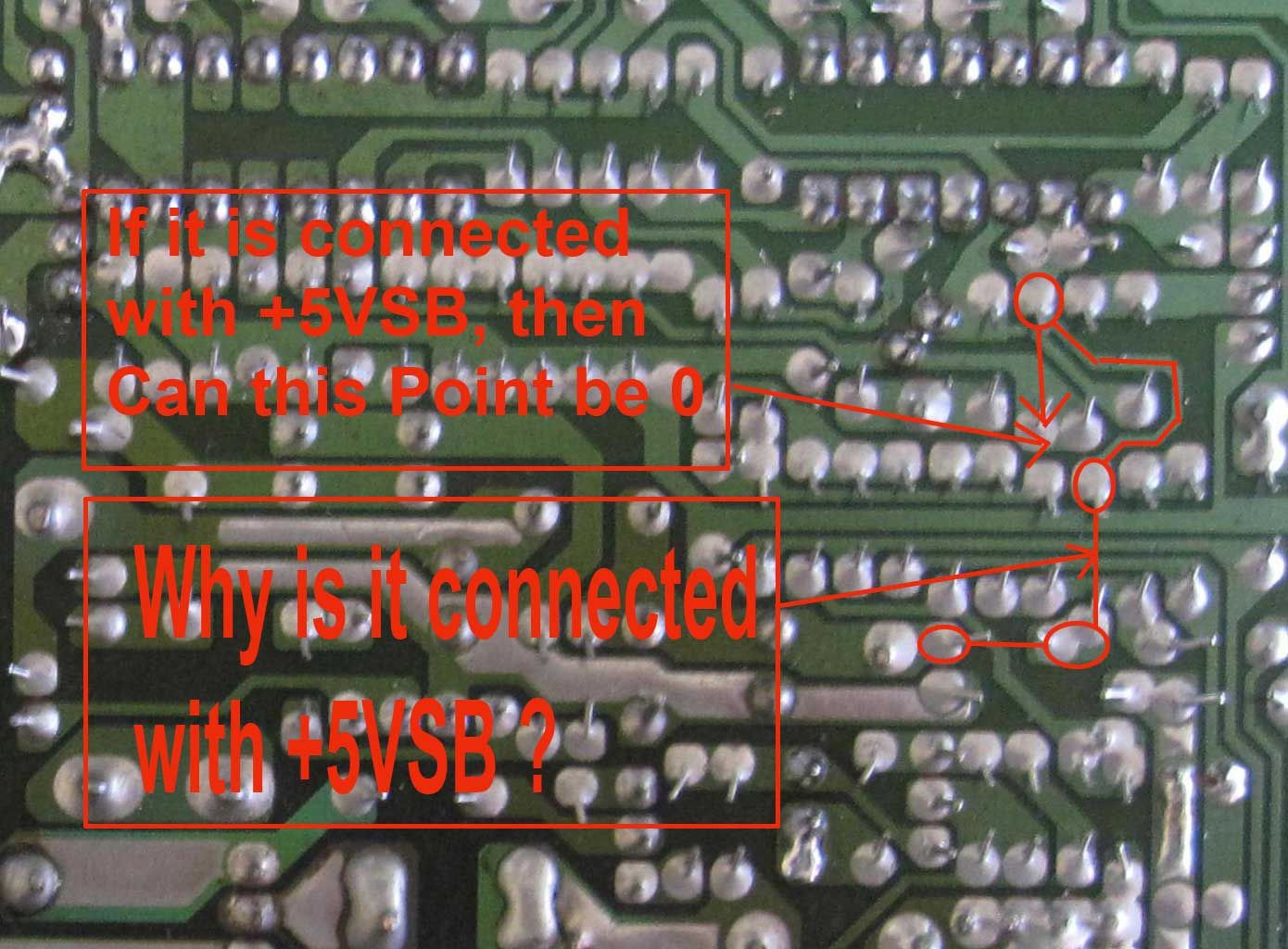

Wow, You have a nice strange problem !!! But One thing is strange to me - LM339 IC's PIN 2 is connected with +5VSB . If it is connected with +5VSB, then Can that marked place be 0 Volt after switching ? [Shown in Image-05] However PSU ran in this design before . Is the other Good PSU same design ??

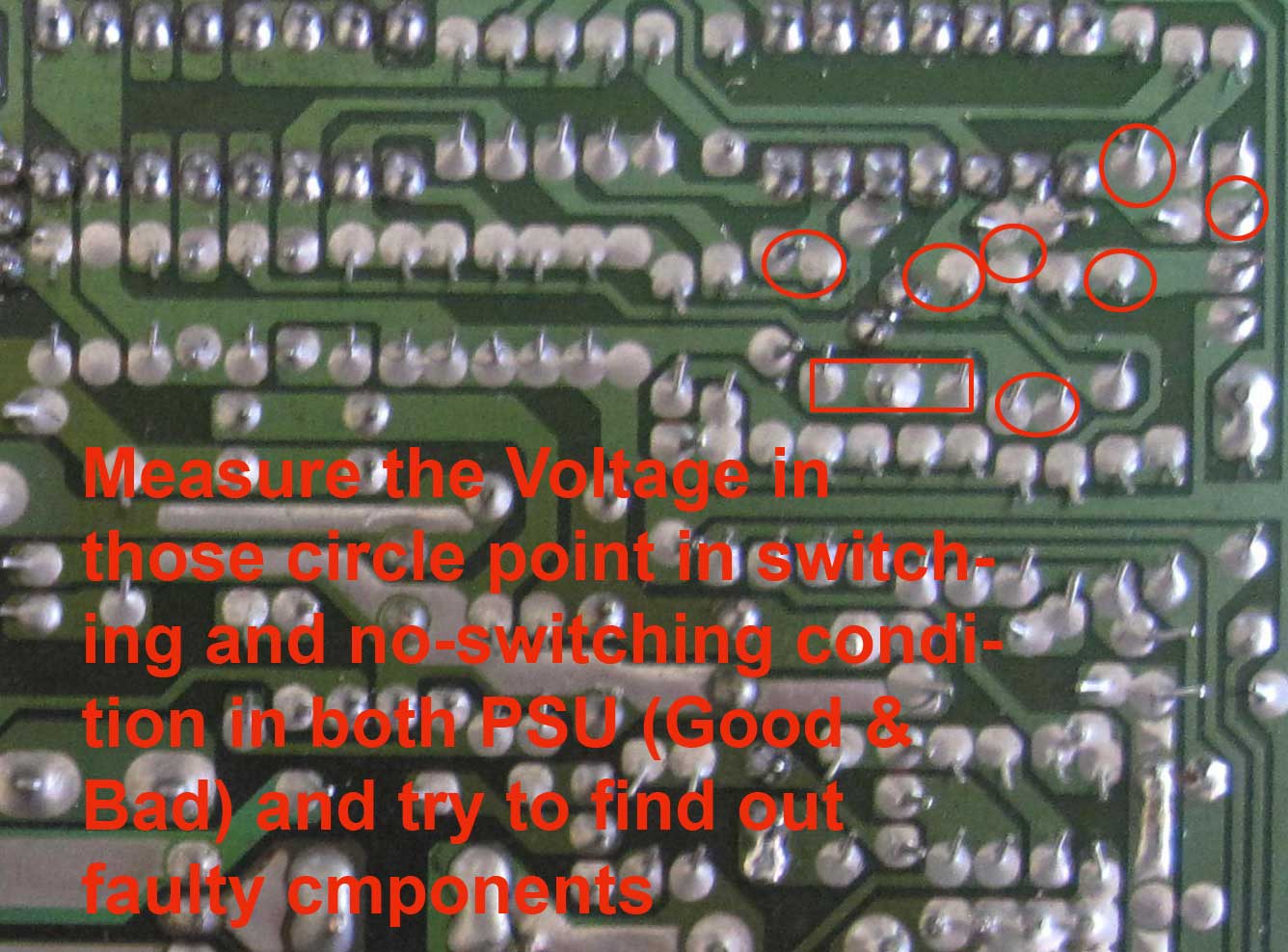

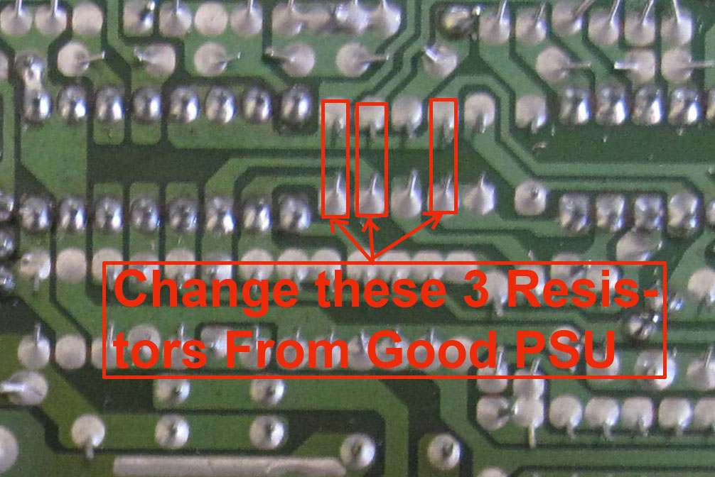

Now it seems to me that One of the component is failing at Load time OR there could be a bad soldering joint . I will suggest you to give a try by replacing those component with New One . [Shown in Image-06]
After changing the components if it does not run, then put the PCB under 100W bulb and keep heating about 30 to 45 minutes . If it favors the luck, then it could be run again !!!!!Comment

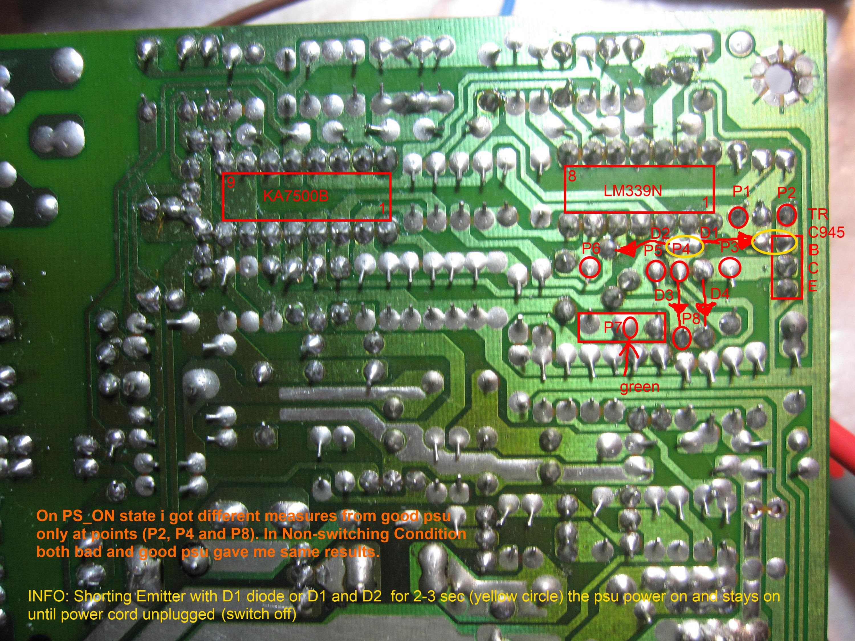

I made proposal checks on both psu (good and bad) and got same results for NON-switching condition. As for PS_ON state the measurements were as the following :
........BAD PSU.......GOOD PSU
P1___3.846 v______3.880 v
P2___0.661 v______520 mv
P3___36,6 mv______34,9 mv
P4___3.910 v______82,5 mv
P5___4.952 v______4.928 v
P6___0 v__________0 v
P7___0 v__________0 v
P8___3.363 v______8.5 mv
Sorting for 2-3 seconds D1 and D2 or C945 Emitter with D1 pins the psu switch on and works until unplug the cord (press switch off-on button).
I have changed the C945 transistor, near registors and diodes D1-D2-D3-D4 from the working psu and vise versa. Still no go

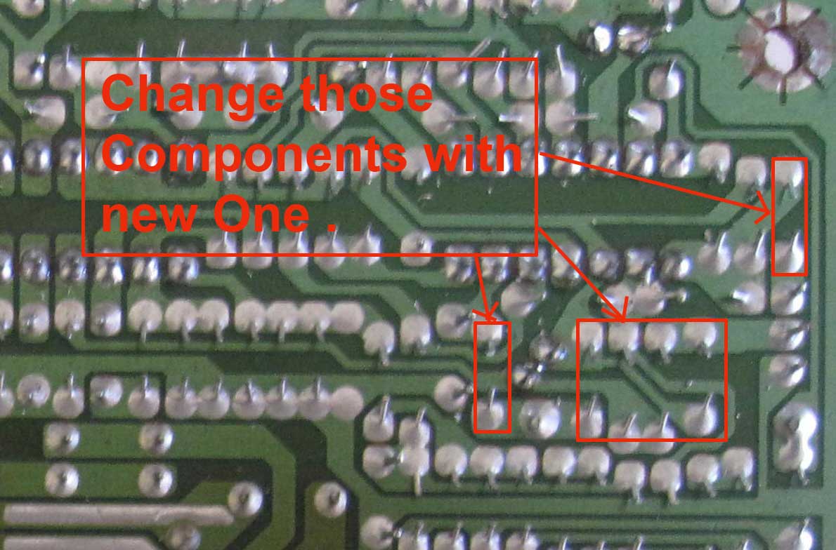

It is very difficult to repair when all the parts are OK and PSU does not run !! Because one parts fails at load time and it is the hardest thing to find that culprit component .

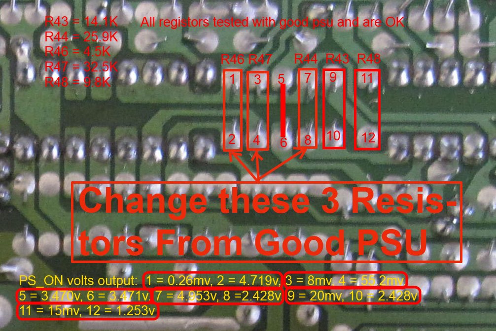

However - C945 Transistor's which you are indicating as Emitter (E), that must be Base (B) . If it is not Base(B), then PSU will not run . Emitter(E) is directly connected with Ground .
Finally - I will tell you to replace 3 Resistors From Good PSU [Shown in Imge-08] . Replace them and see what happens . If it runs then well, otherwise I have no solution left to help you !!
Best of luck Dude .....Comment

I have changed and tested 3+2 near registors.It is very difficult to repair when all the parts are OK and PSU does not run !! Because one parts fails at load time and it is the hardest thing to find that culprit component .
NO LUCK AT ALL

Hello @ll !!!
It's weekend so learning bench time started again. Took me some hours checking every single component on secondary side on bad psu and comparing results with the good psu. Some of them changed from good to bad and vice versa. Still got only +5vsb output to bad one.
As friend Escort Eagle mentioned already it is very difficult to repair when one part fails at load time. All this time I have learned a lot of things about smps.
While testing and comparing voltages between god and bad psu, I figured out that shorting 3-4 seconds (+) side of two signas diodes the psu power on and works fine. Also on both psu if LM339N pin 4 is shorted with ground, both returns to +5vsb only output.
1. Can someone please explain the logic of this status?
2. How safe is it if i solder the two diodes points permanently on bad psu?

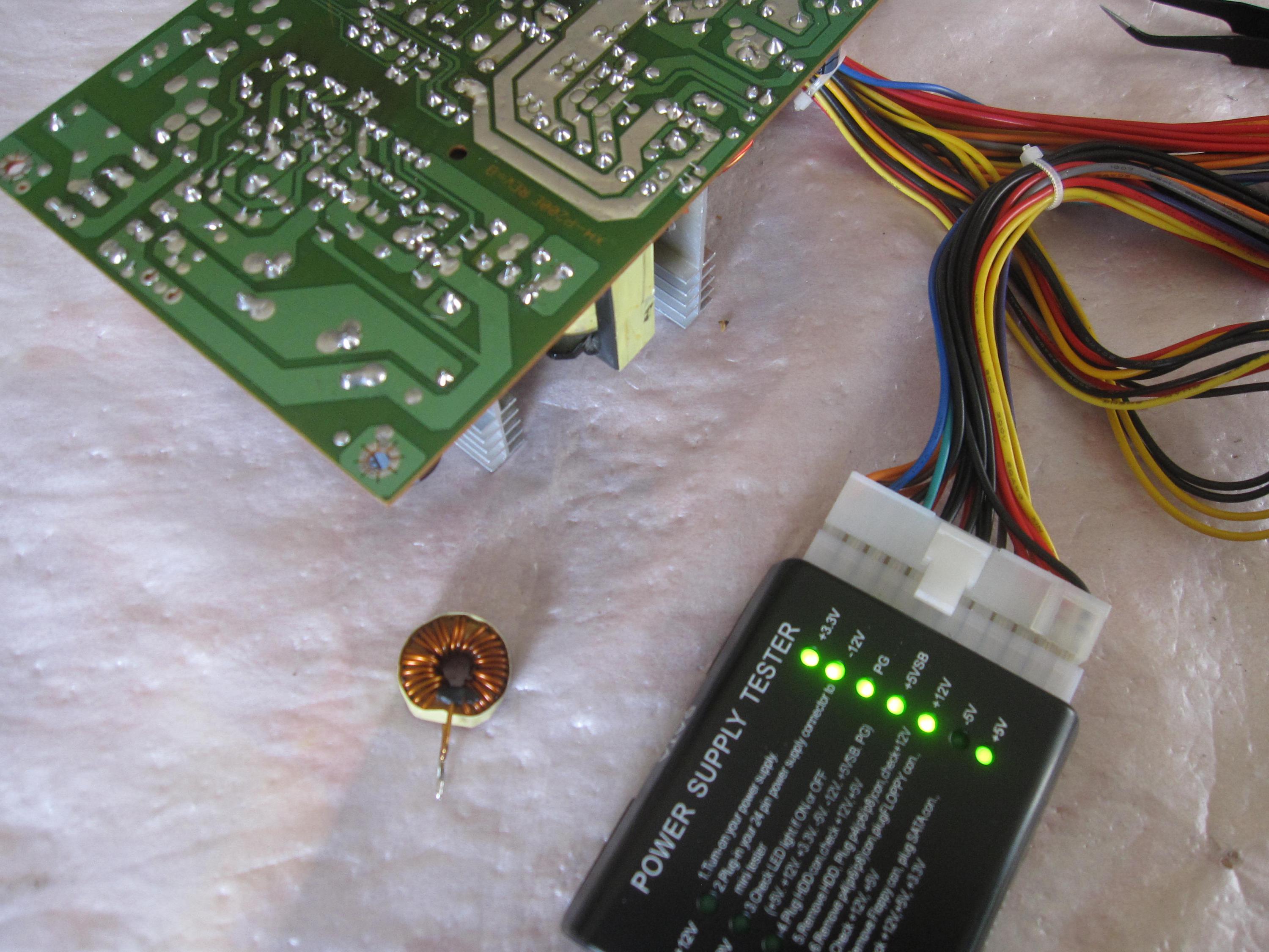

I 've decided to disconnect the +5vsb from LM339 ic PIN 2 and psu was working but the 2pin filter coil in secondary side was smelling like burned.
So I replaced it with another one and tried again. The psu was running ok again but this time nothing started to burn. So I soldered again +5vsb with pin2 of LM339 IC and guess what.
THE PSU FIXED AND RUNNING ALL OUTPUTS CORRECTLY as seen on image.
I would like to thank everyone in this great forum and specially the friends who helped me with thei suggestions.
Congratulations!!
So, the 3.3V torroid coil had shorted turns or its core saturated permanently?Comment
I believe the glue got conductive. Also measured the temperature in this coil and was around 70 C. So thought that the coil conductors were insulated and change it. Temperature dropped down immediately around 35 C and psu worked.Comment
