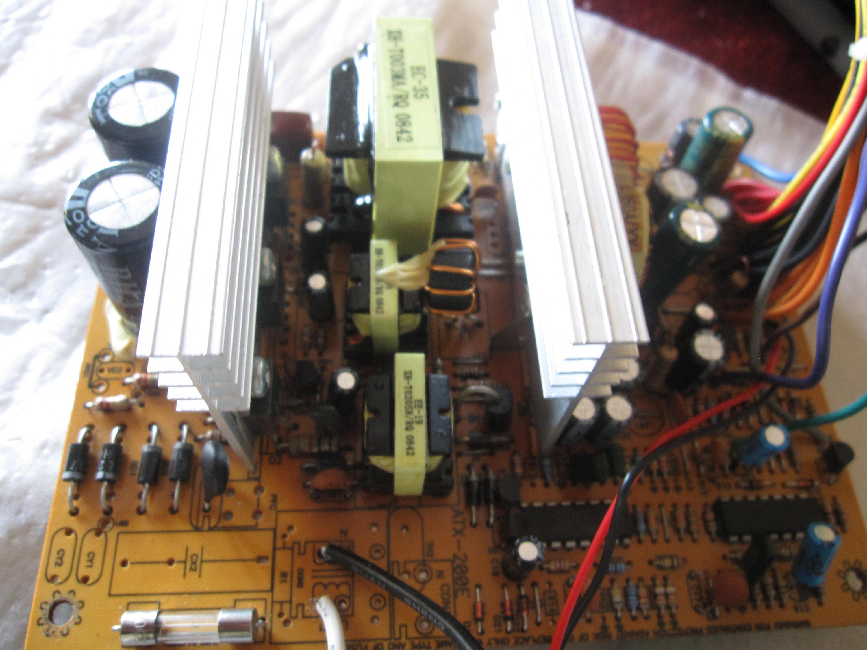

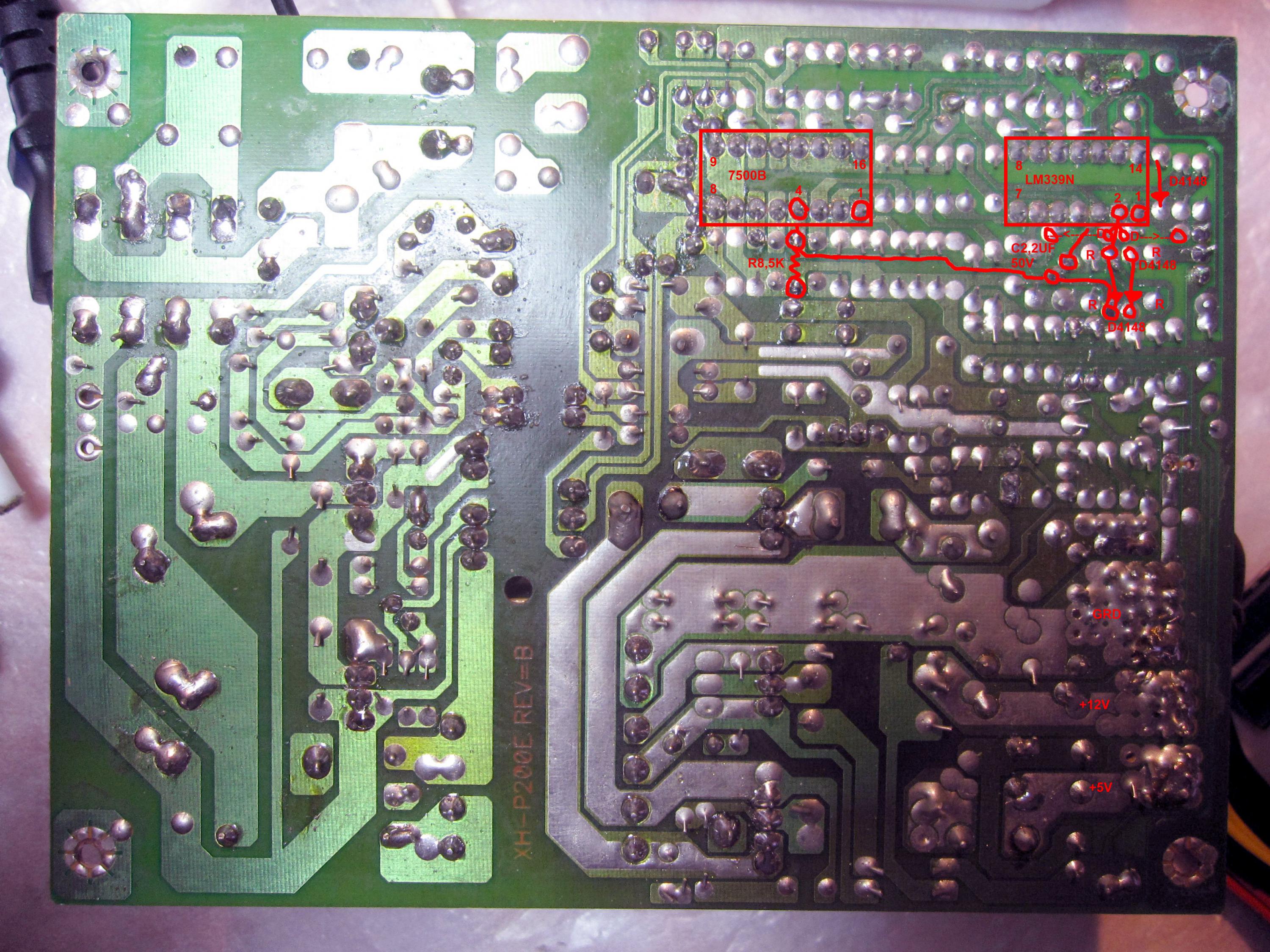

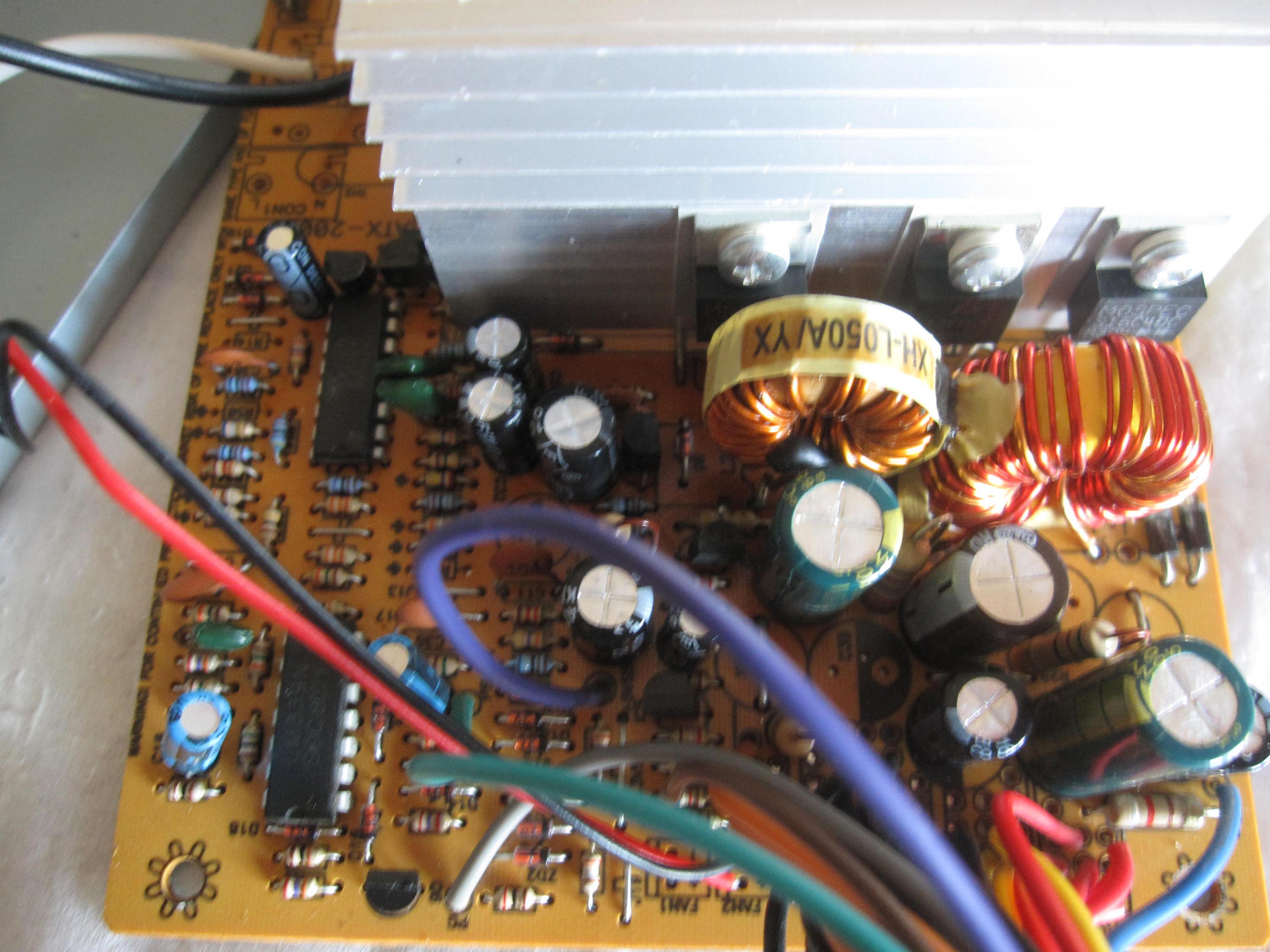

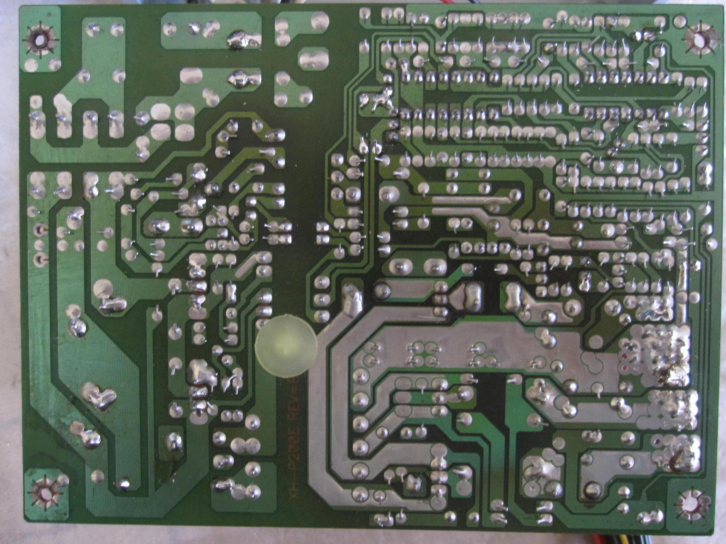

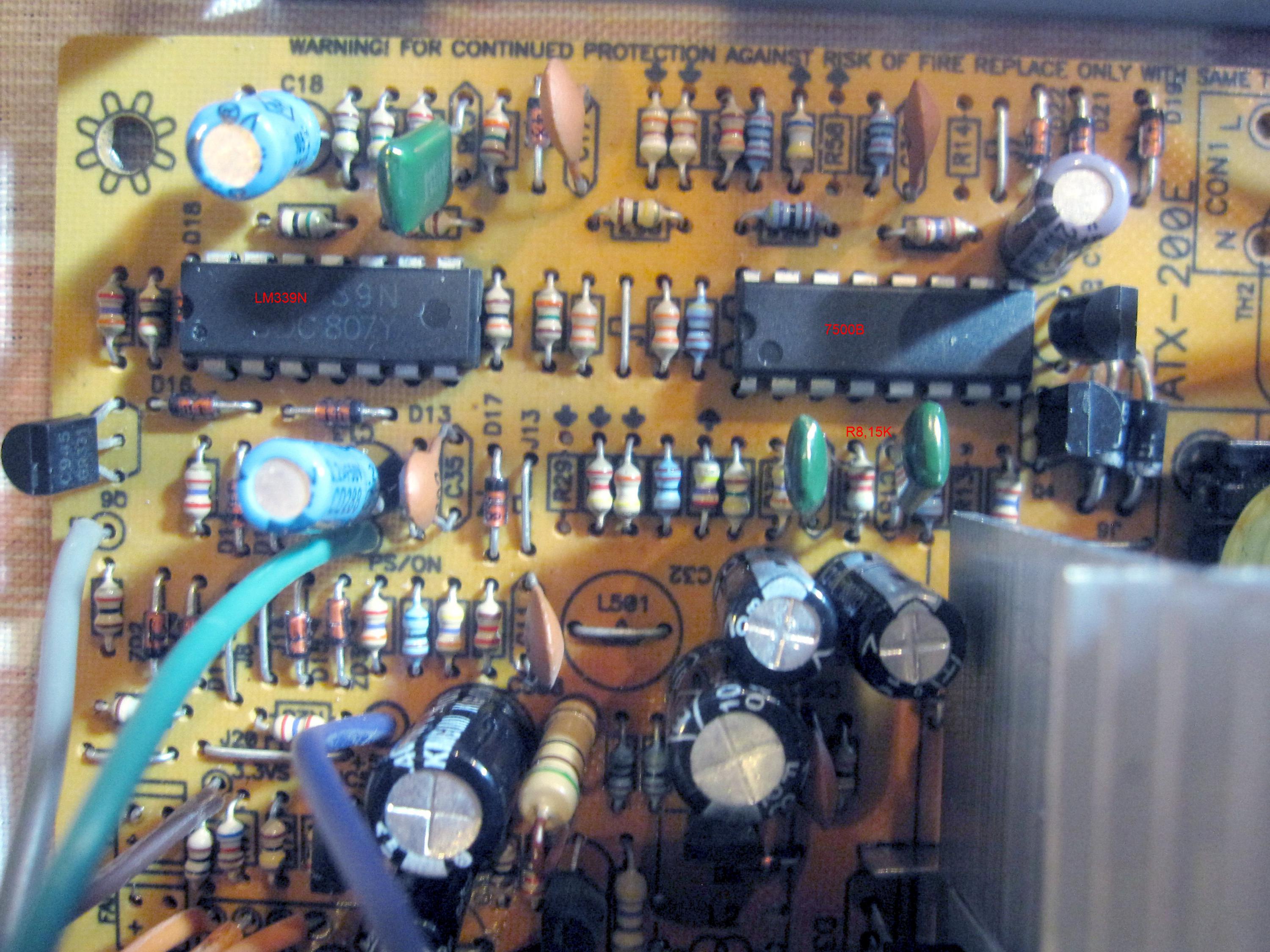

    Hello friends,
    It's been almost two years since I had joined this wonderful forum and until today i have learned alot in electronics. As newbie in repairing atx psu need some help for resolving the problem in T&P-DHK 350W PSU which outputs only +5vsb. No burned components at all just suddenly stopped working. So far I have checked the components in the sections that I have labelled in attached photo.
    I have a working same type and model psu and compared the values with my multimeter. Also exchange and resolder many components from the working one, but the problem remains. The second (working state) psu with the parts from the faulty one still works fine.
    I have attached some photos and hope in your kindness to help me solve the problem. I have tested diodes, power IC's, transistors, capacitors, resolder almost half parts rectifiers, transformers, IC's etc, but still no success. :-(
    For your information: When I soldered reversed the two transistors near the power IC, I got all volts output but the bulp test shows me as expected that short exists, so I put it in right order again and got +5vsb. Unfortunate I don't have an oscilloscope to make further checks, just a multimeter, DIY in circuit transistor tester, PC ATX SATA PSU HDD Power Supply Diagnostic Tool Tester and a bulp tester.

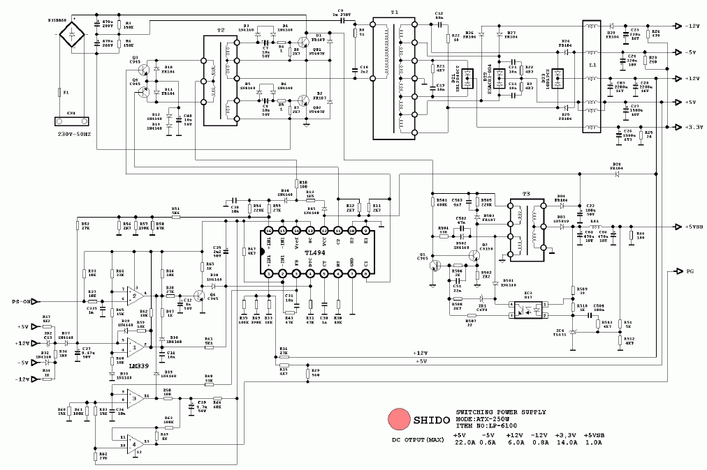

    The attached schematic looks quite same model. I have ordered an esr tester with some other parts needed for another psu (PSU Trust 420W PW-5210) that had some burned items and same problem (only +5vsb) too.
    Will you please help me by marking the necessary steps - checks on the photos?
    Thanks in advance for your help .
    Some photos are:

    I don't know if this helps, but i have take a time to measure all IC pin voltage from 2-3 good PSUs just a guide for me when need to fix this common cheap PSUs.
    The IC number maybe same as you LM339 and 7500B.

      The pictures help a lot. There are schematics here that are closer to yours (see 200W): ATX power supply schematics
      I would check the KA7500 has power on pin 13,14 (5V?) and pin 4 above 3V is usually the PS_ON signal. It's easier to troubleshoot with all IC voltages if you measure them.
      You are jumpering the PSU green wire to COM, to turn on the PSU?

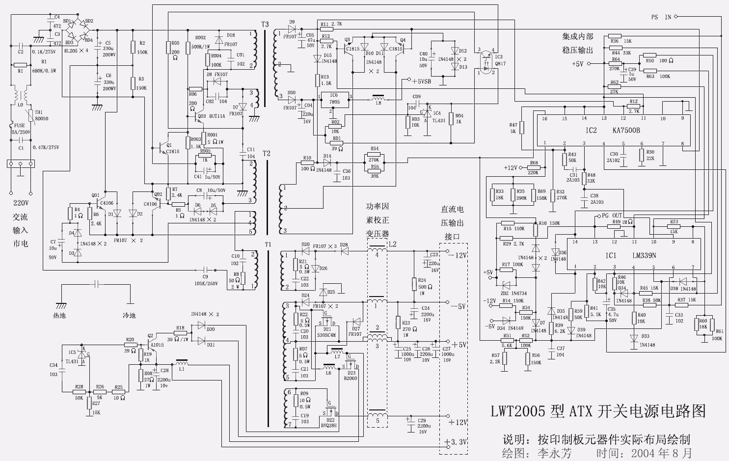

          I don't know your PSU schematic exactly, but going off this one, from: http://danyk.cz/s_atx01b.png (My URL in prev. post #3 is wrong somehow: ATX PSU schematics )
          Looking at those voltages, the 7500B is remaining off due to the logic high (voltage) on its pin 4. That takes us back to the LM339 output pin 2, which then goes back to LM339 pin 5 where the problem is- assuming that matches your PSU... can you verify 7500B pin 4 goes to LM339 pin2 through resistor.
          I think the circuit on LM339 pin 5 looks at all the PSU rails (+5V, +12V, -5V, -12V) - which are obviously zero, and it also monitors power for the 7500B. It might be too high at 22.9V?

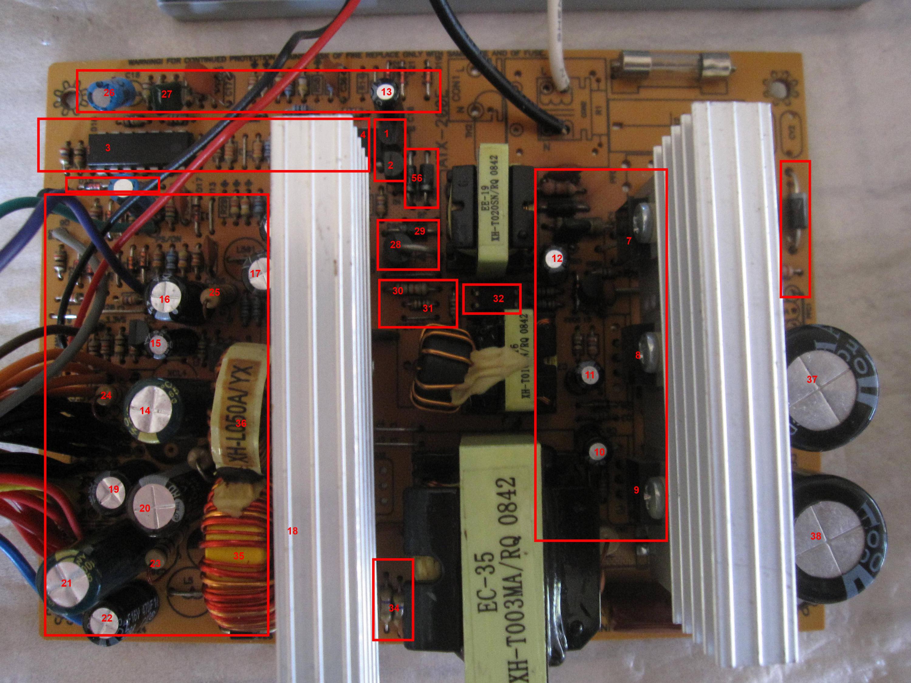

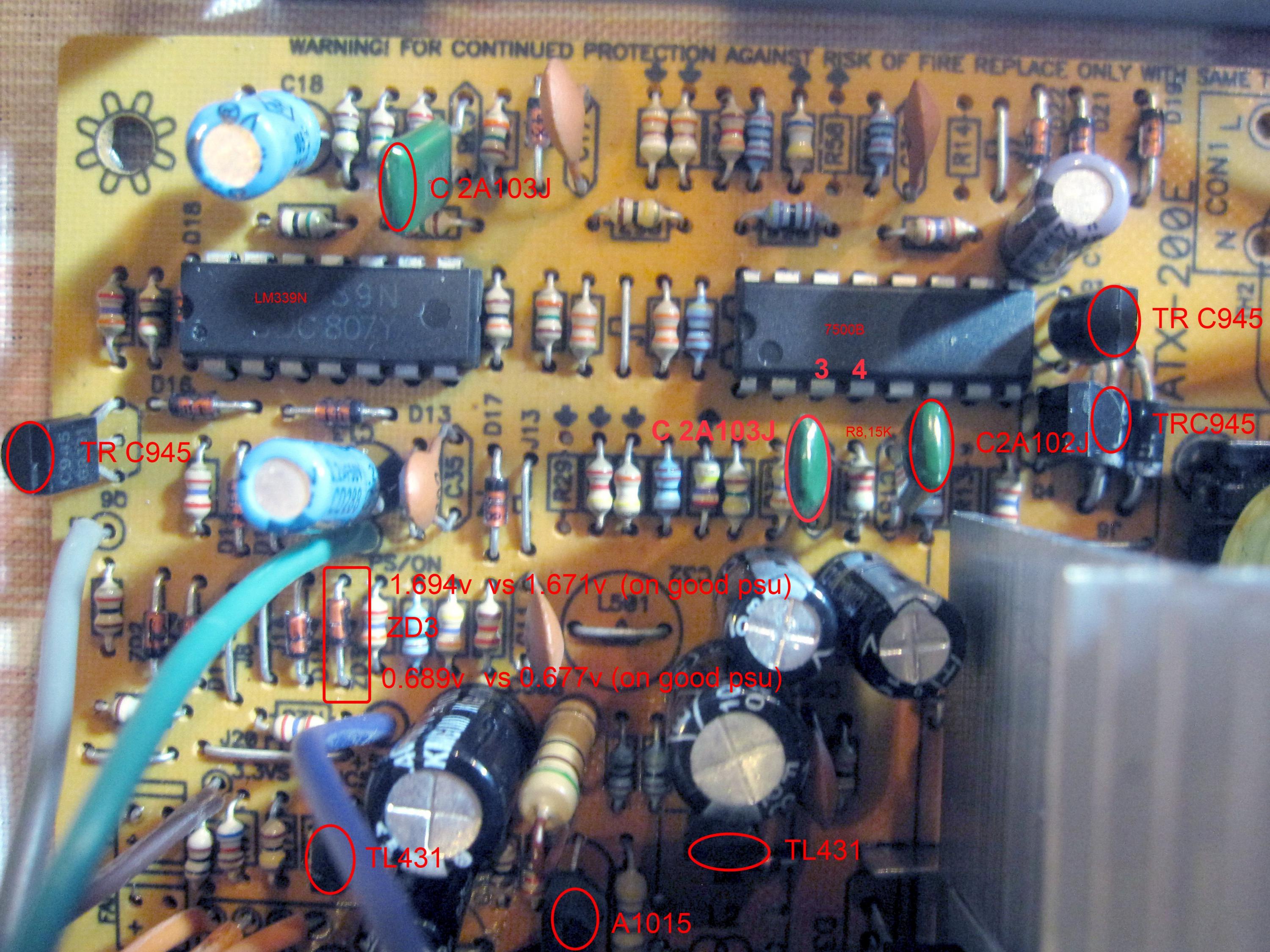

            Re: Need help for repairing PSU with only +5vsb output
            Thank you for your consideration.
            I have marked in new photos the requested info. I hope this closer view images will help found the problem.
            Since I have another working same type model psu, can you please drive me what to check and compare the values?

                    I looked at the schematic again. The LM339 does many functions and it is complicated.
                    LM339 pin 5 looks like a delayed latch for overvoltage and drive transformer overcurrent. Takes us back to Pin 16 on the KA7500, which is not up.
                    I thought it was monitoring the Vcc (22V) but they are watching the xfmer drive current for some reason.
                    Check the parts between pin 16 and pin 12 (Vcc) on the KA7500, then next is to follow KA7500 pin 16 or 12 up to the transformer. Check the diodes, 4 transistors and capacitor from the driver transistors C945's to gnd for being open. Small chance the capacitor from LM339 pin5 to gnd for being open.

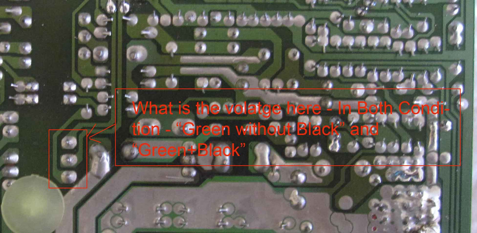

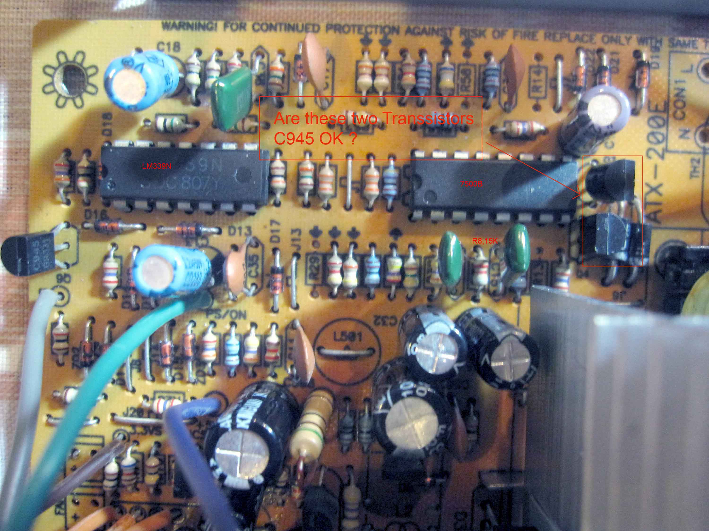

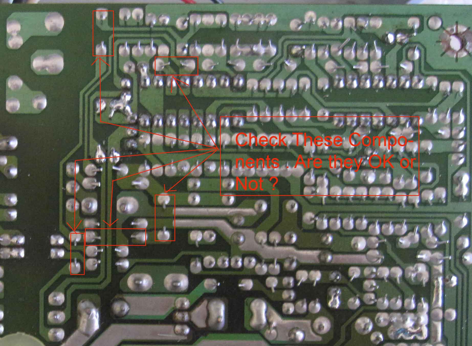

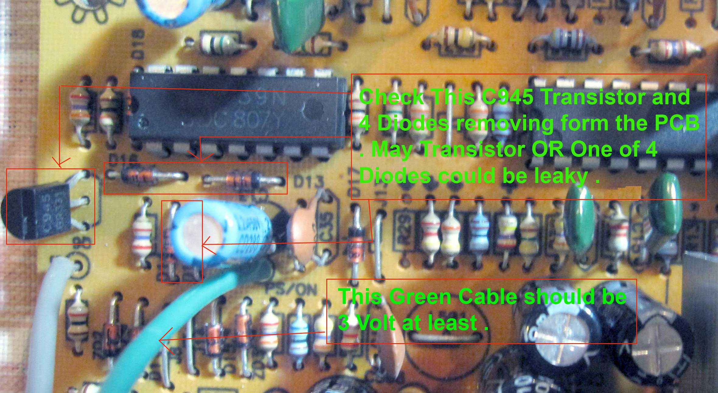

                            1. What is the voltage on the KA7500 IC PIN No. 4, 8 & 11 ?
                            2. Are those switching transistors C945 OK ? [Shown in "Image-01"]
                            3. If the switching Transistors C945 are OK, then Check those components Resistors, Diodes . Are they OK or Not ? [Shown in "Image-02"]
                            4. What is the voltage in T2 Transformer PIN in both condition - PS_Without switching state (Green without Black) and PS_ON state (Green + Black) [Shown in "Image-03"]and KA7500 IC's PIN 8 & 11 voltage also in both condition .
                            • stefos
                              • May 2012
                              • 91
                              • Greece
                              PS_ON state
                              -------------PIN 4 --- PIN 8 --- PIN 11
                              GOOD PSU : 0.85mv --- 2.104v --- 2.113v
                              FAULTY PSU: 3.360v --- 2.290v --- 2.290v
                              GOOD PSU : 3.299v --- 2.270v --- 2.270v
                              FAULTY PSU: 3.307v --- 2.274v --- 2.274v
                              They are OK, because I have tested with my second working same model and type psu as most of the componenets so far, with no luck.

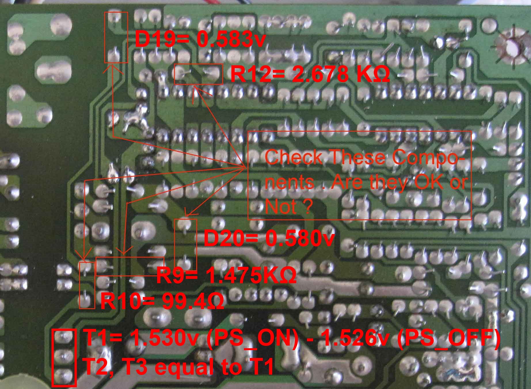

                              See attached image (in comparison with working psu are all OK)
                              For pins 8, 11 mentioned above
                              But for T2 transformer I got differenent volts in comparison with good psu as following:
                              --------------PS_ON state --- PS_Without switching state
                              GOOD PSU on all 3 pins got 2.410v --- all 3 pins got 1.530v
                              FAULTY PSU GOT ONLY 1.530v --- equal to good psu (1.526v)
                              • Escort Eagle
                                • Jul 2012
                                • 110
                                Now Directly Short PIN 4 with Ground(GND) . Is the PSU turning on ??
                                If the PSU is not turning on by shorting with GND, then Change D19, D20, **R9** and R10 with a **new one** . Specially R9(1.475K) . R9 is the vital point for Vdd supply . If you do not find 1.4K, then you can replace it with 1K . Then try again by shorting PIN 4 with GND .
                                And Let us know - what is the result .
                                  YES, the psu is turning on with my psu tester. Is this overriding the LM339 IC or something other component?

                                    1. Now remove PIN 4 From Ground .
                                    2. Now Is it turning on in normal mode Green + Black ??
                                      NO I got only +5vsb output only as expected.
                                        **I hope - You have at least 3 Volt present in Green Cable .**
                                        Now Check that Transistor C945 and 4 Diodes carefully by removing from the PCB . May be The transistor OR One of 4 Diodes could be Faulty . [Shown in "Image-04"] You can also give a quick check to other Crystal Diodes surrounding of LM339 IC .
                                        If you find that Transistor and Diodes are OK, then Change the LM339 IC with a new one .
