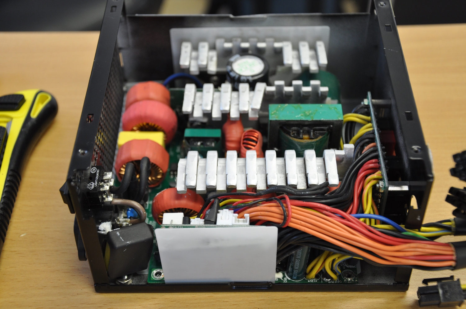

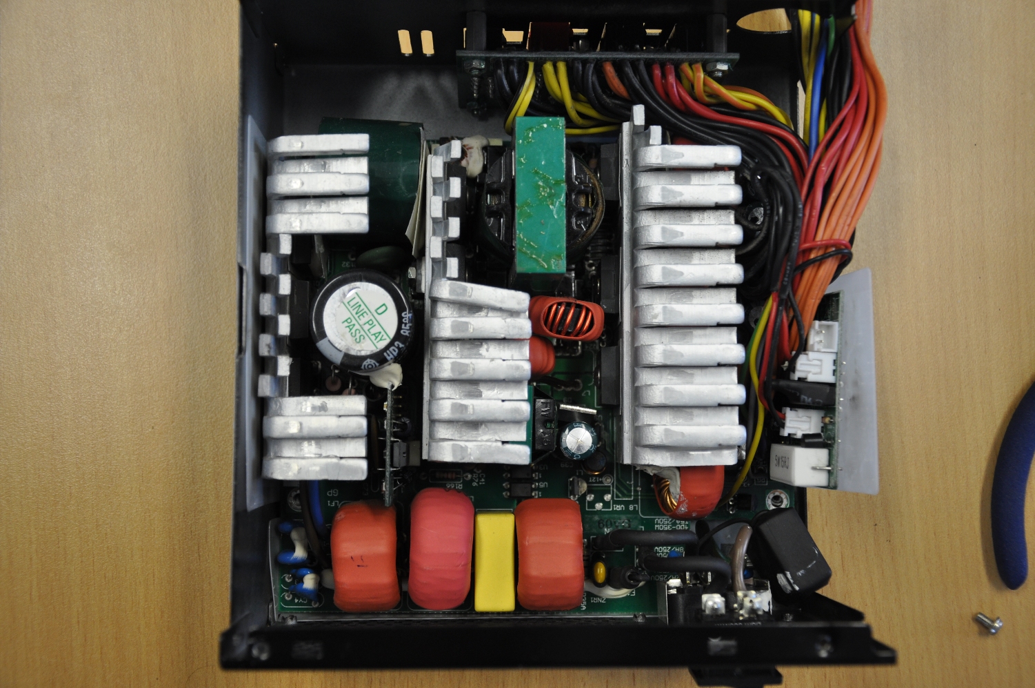

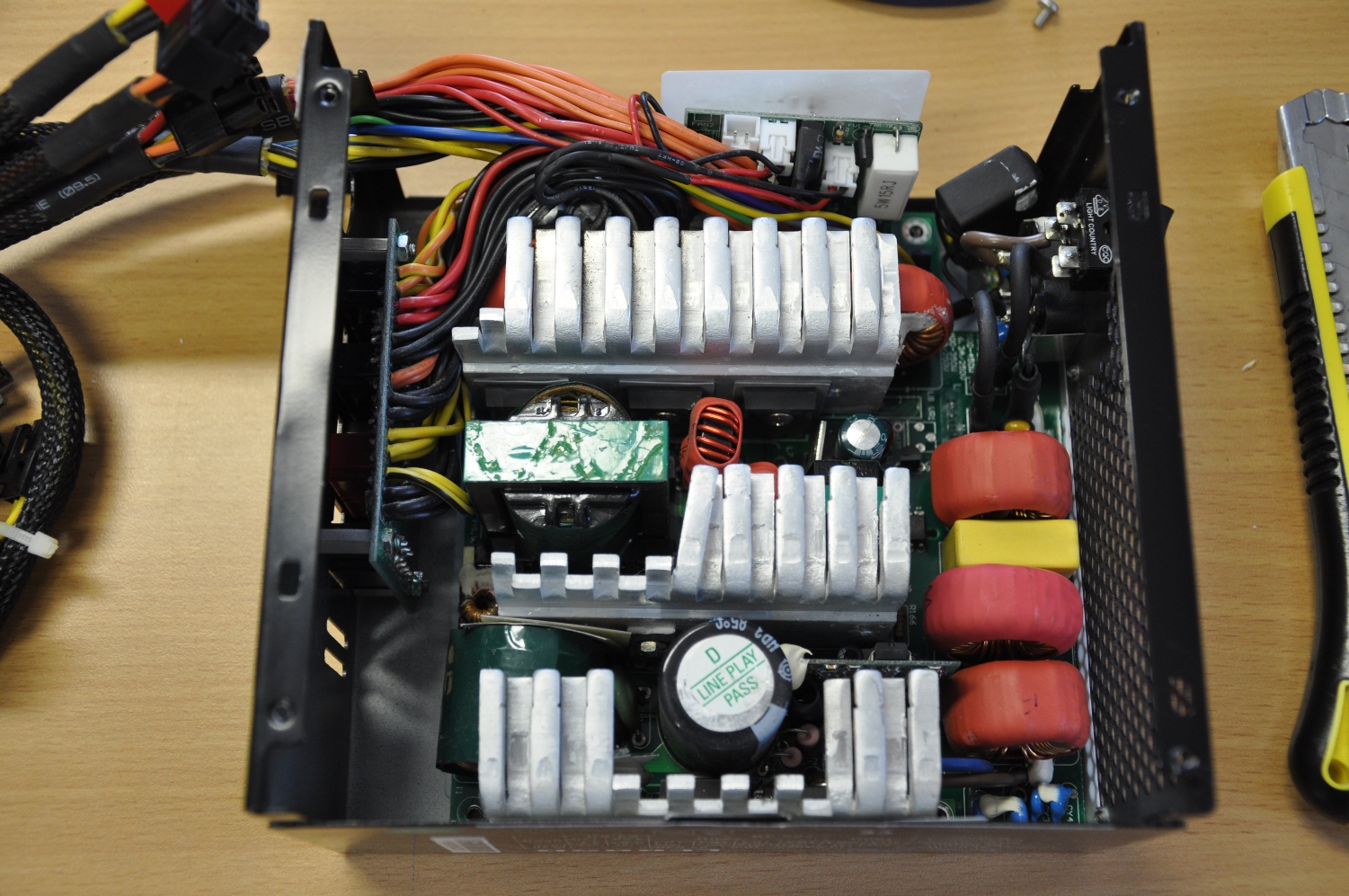

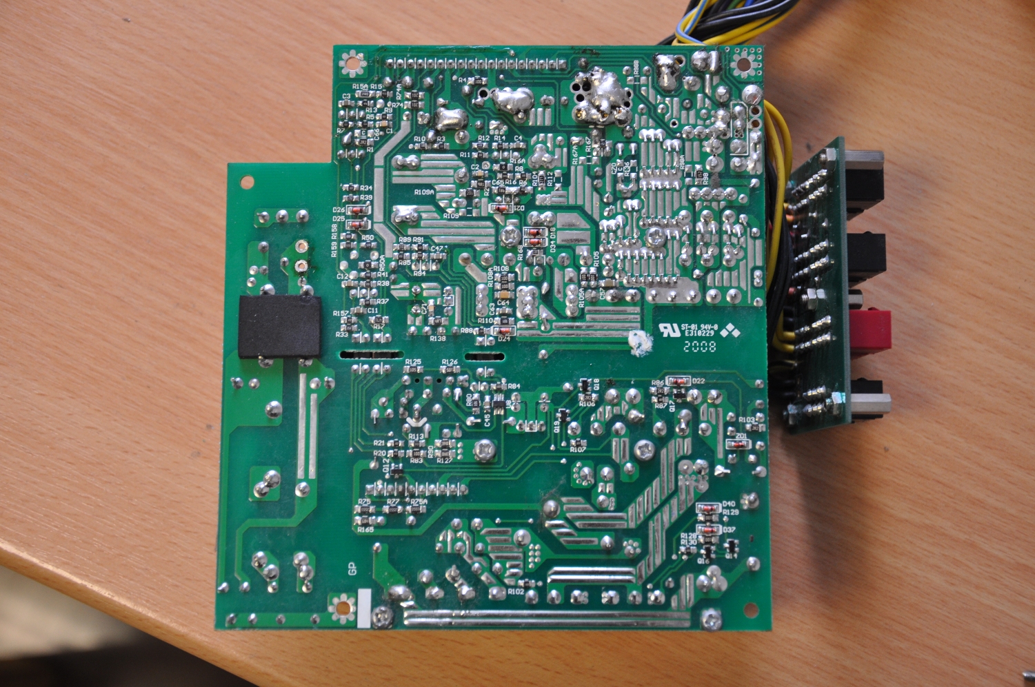

            Added some pics. The bad cap is indeed Samxon GF.
            do post pictures before you buy parts.lc stuff is notoriously junky.it would suck to buy good parts for a unit that belongs in the trash.
            Trash or not?
            EDIT: Never in my entire life have I seen such shitty soldering...
            EDIT #2: The cap in question is a GF(M) X5A
              There are some with much, much worse soldering than that. Mainly it looks like you need a high wattage iron to reflow the solder on the wiring harness locations.
              It looks worth a recap to me but it all depends on the value of a spare PSU vs time and parts cost. It's a fairly inefficient design that I wouldn't trust past 500W load if that.

                  That's actually a decent power supply. I had the same thing happen to an almost identical PSU (A Thermaltake ToughPower 750W). In my case, it took the board out, but if you care to recap it, it would be a decent power supply.
                  EDIT: As stated by Half-Saint, I agree that's actually quite good soldering for a CWT-built unit. I've seen much worse from them.

                    I don't like seeing huge blobs of solder. I already reworked one of the smaller blobs so that they're not connecting anymore. Having a max. of 450C solder probably isn't helping but the rest are going to be quite difficult to do.
