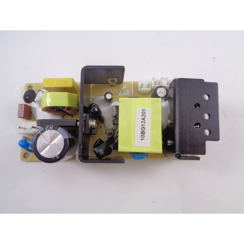

I have a 12v psu from a DJ lighting system and I can not seem to figure this one out. The board so far had a blown fuse and a shorted voltage regulator. After replacing those I get 12v out but hooking a load to it the voltage seems to bounce between 5v and 0v. I remove all the caps and checked those and replaced 2 that were only questionable. I know it's not the device I connect it to as I put 12v to it with my bench power source and it works fine.
12v PSU help please.
Was the mosfet shorted Drain to Gate? if it was then it is possible the ic was damaged, also check the source resistor (if there is one) and there may also be a resistor between the mosfet source and the CS pin of the ic. You should also replace the small electrolytic in the primary circuit.Last edited by R_J; 05-07-2024, 07:34 PM.Comment
