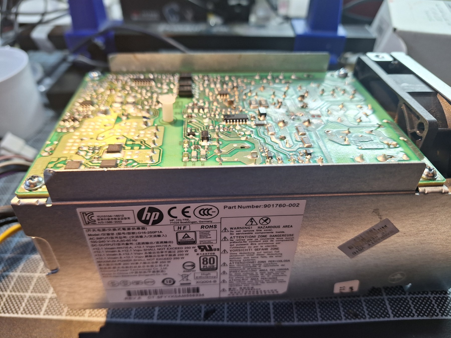

    Hi to all of yoy!

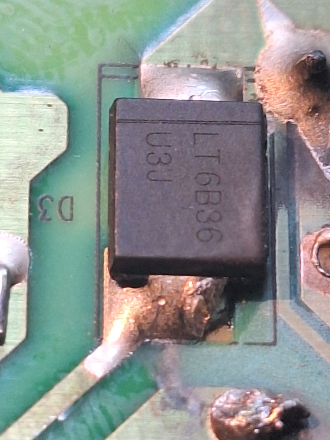

    I have a damaged HP PSU p/n: 901760-002 with blow up 6.3 Slow blow Fuse & an smd shorted diode with LT6B36 printed on it!
    I cannot find any info on this part.
    Any suggestions?
    May I substitude with any similar one?

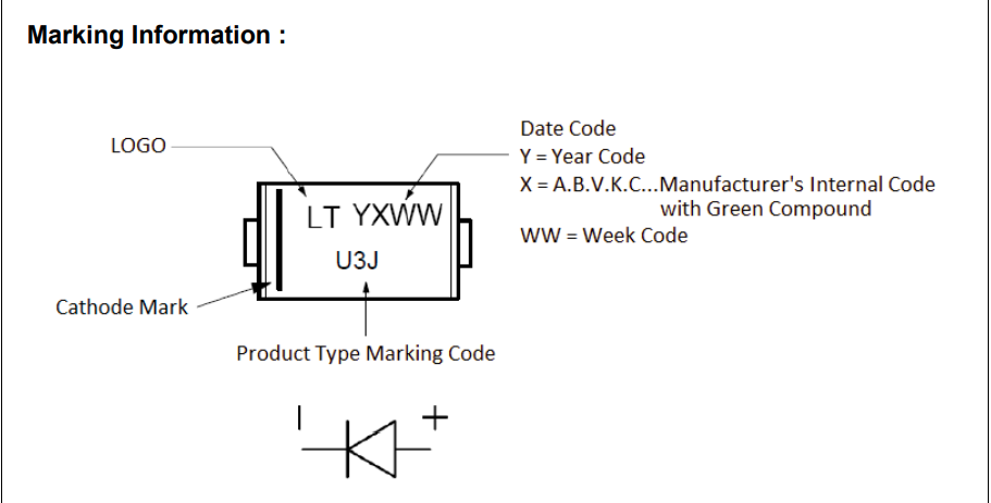

    This is what it is, produced by different manufacturing companies, with different logos.
    In the second datasheet it is your diode.

      U3J - MURS360T3G (600v, 3A)

        Really thank you my friend lotas.
        I was thinking that U3J is not part of identity...
        LT6B36U3J is similar to U3J - MURS360T3G ?
