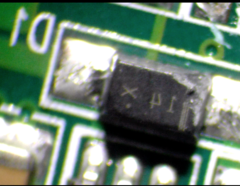

    I need to identify the diode on attached image. is an SMD diode on damaged board.
    As more wide question... there is a way to identify any smd component in a more or less simple way?
    Every time that i need to identify some components with no schematics is a nightmare for me!
    Thank you for any kind of support!

    Maybe this will help smd-codes.pdf

      It might be a FM140-M ; or MSS1P4 (40v/1a) schottky diode
