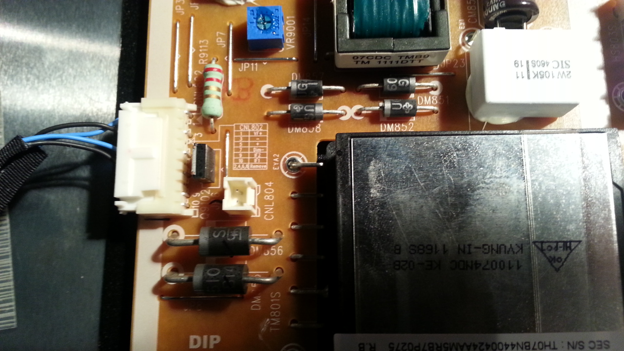

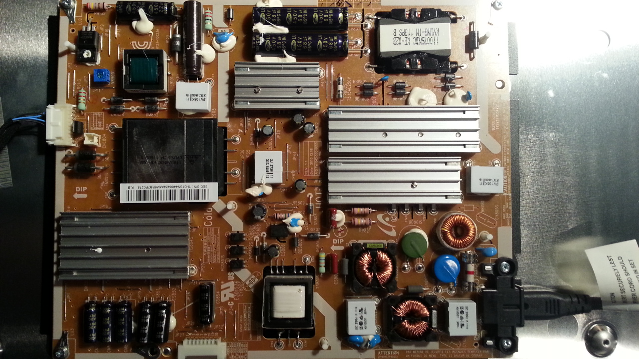

    This is from a 55" Samsung LED tv. I have no idea of the expected behaviour but seems faulty to me. The set doesn't work with the mainboard plugged in so I unplugged it to try and isolate fault.
    When plugged in by itself (or with led) there is a faint tick that sends all voltages rising momentarily, then back to zero and over again. Cycle takes 4-5 seconds. The 5VSB line is the only line rock steady.
    What confuses me is the three pins generated by the mainboard (PSON, BLON and DIM) rise and fall in voltage as well (without mainboard attached!). So it seems like a short is causing stray voltage and tripping whatever protection the board has.
    How can I determine if the PS is faulty and which component is causing the problem ?

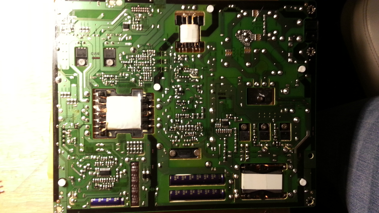

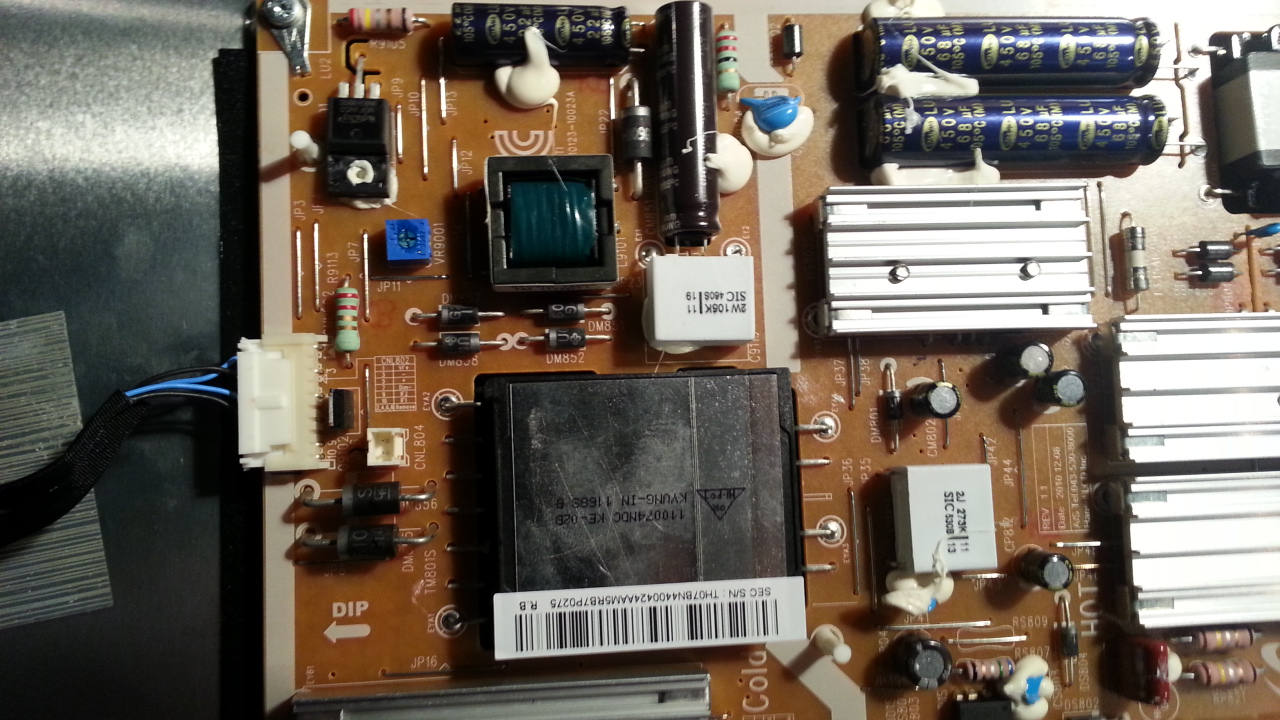

    Some pics...

      Ok then... let me ask this.
      Is there a way to separate the Primary from the Secondary to see if it keeps rebooting so I know which half the problem lies in ? And is it possible to keep the Standby voltage active when disconnecting the Secondary ?

        Sounds like it's going into protection. See if any of the outputs are shorted.

                      See if the PSU still ticks and if the voltage still go up and down when the PSU is connected to the TV when you try to turn it on. Some PSUs do not like to run without a load and will shut down like that. If there a label somewhere on the board that says how much current each output is rated for, you can try to add some resistors and 12V car bulbs to the outputs rather than have the PSU connected to the TV to see if it still does the same thing.
                      I also see that there are lots of SamWha or SamYoung capacitors on the board. Definitely change the very small ones on the primary side first (i.e. any "startup" caps). So CM802, CP812, CM812... etc. - those tiny ones.
                      Also, check all large "power" diodes and rectifiers on the secondary side.

                                      Re: BN44-00424A Continuous Restart
                                      i dont know if this help. but try to remove the transformer of smps and see that is still restarting or remove secondary diode one by one except the feedback ones after attach again this transformer to circuit to determine where section is failed. but try to hear others advice because i just know how to troubleshoot a smps at beginner level.
                                      "There is no shortcut to be successful. No pain, no gain."
                                      Best Regards
                                      Rudi
                                      Thank You
                                        Problem is I can't tell a secondary output diode from a feedback diode so if somebody wants to point them out I will gladly try that.
