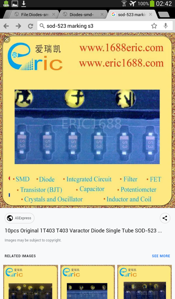

    SMD Diode S3 marked on package
    I need to find a replacement for this diode on one of the six gate drivers of a full-bridge IGBT inverter for a servo motor. It has S3 on the package. How can I find out for sure the right diode that I need. I believe it is schottky because it has 0.2V drop across.
    The anode is on pin Ve and cathode on pin DESAT on 316J gate driver IC. Also would be nice if anyone had an idea of the purpose it is serving as it is not included in the suggested schematic of the 316J datasheet.

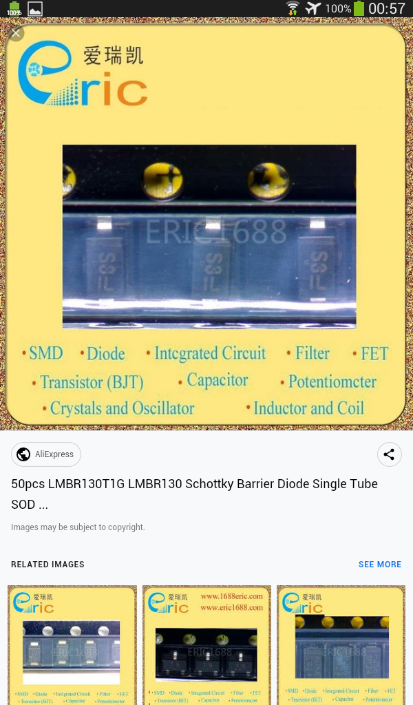

    MBR130
    • Dan the Dog
      • May 2024
      • 6
      Thanks! So you new the package name and searched S3 with it?
      Here is a datasheet for MBR130. It says min Vf of 0.47. I am measuring 0.2V. Could it be a different diode in my circuit?
      https://www.onsemi.com/download/data...mbr130t1-d.pdf

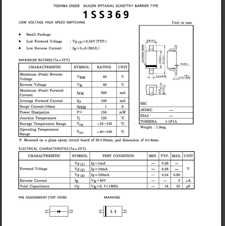

            ​1SS369 marking S3
            • lotas
              • Jan 2016
              • 4803
              • Russia
              schottky SD101CWS marking S3

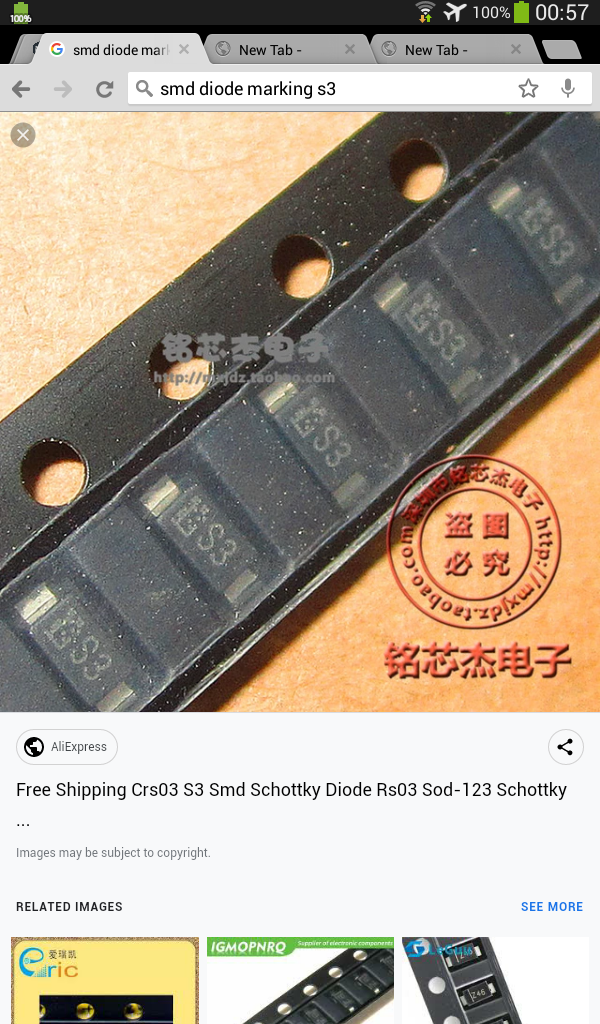

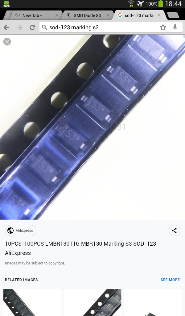

                I first search for package name and add first two character.
                This is fast searching, because you actualy search for picture on who is corectly labeled. Many seller noted in title name of component (which we dont know) folowed with world markings on it and package name.
                Usualy first two character are model name, and rest one or two is date production code. Not the absolute rule, but for general fast search it is.
                Neverless, marking codes are a one big mess, you never realy know what it represent for any production... it many of ic have much same code, maybe slightly different font, positioned or printed, with some undefined simbols or not... so...
                Notice that your S3 have different type of font, bold, especialy number 3...

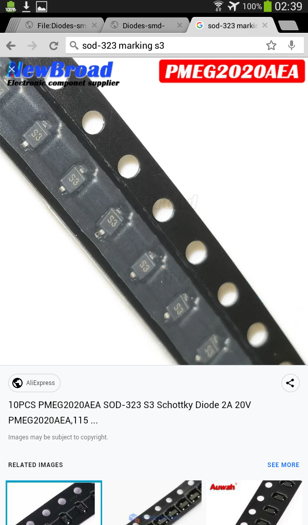

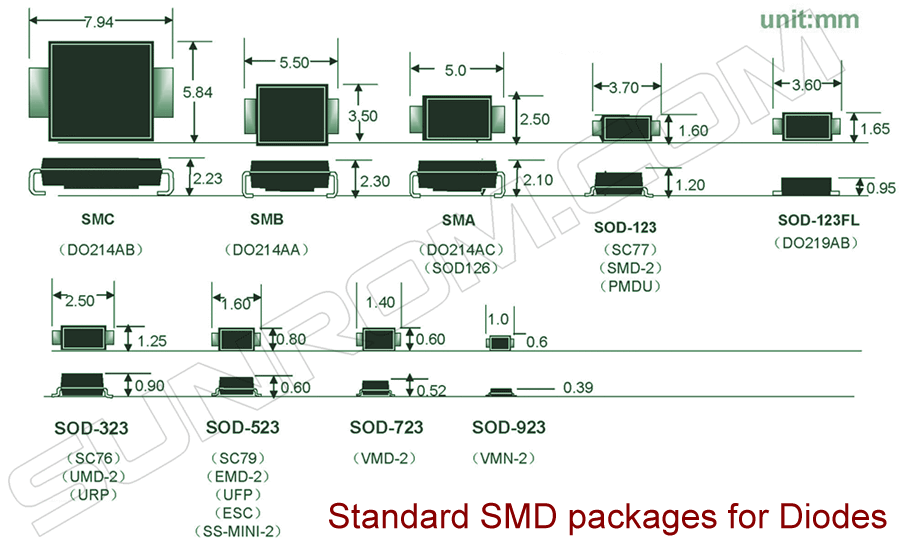

                • harp
                  • Jun 2022
                  • 643
                  • Planet Earth
                  to make it even more complicated, pay special attention to the package... seems that different package have different "category". What is your correct package?
