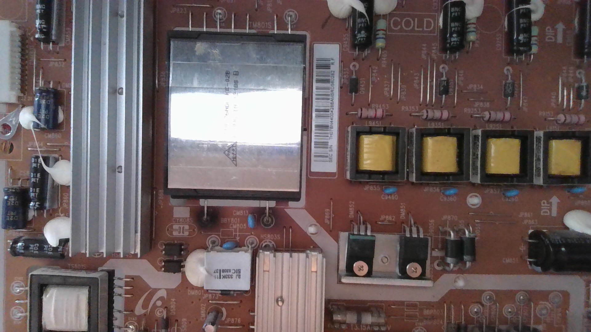

    I did not fire up my unit yet since i noticed some nearly burnt pcb trace. Thanks Budm for the info..i ordered the IC and will be posting some updates later.

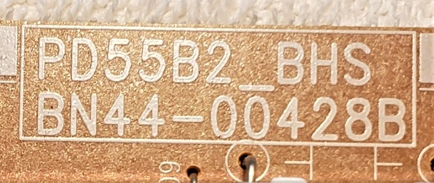

        I also have a Samsung UN55D6400UFXZA. I have the blink problem. My power supply is PD55B2_BHS, BN44-00428B. I found this repair kit on ebay for $12.95 and free shipping:
        https://www.ebay.com/itm/Samsung-BN4...72.m2749.l2649
        The kit arrived but no directions. The seller said the part number on each item was the location on the power supply board. Looking at the power supply board I can see that. I have found most of the locations but for one. I have a cap called CM811. I have spent an hour going over the board (front and back) and can not find the location of a cap called CM811. I wonder if I have a newer or older version of this power supply board that is different than the kit I bought?
        I can go ahead and install the rest of the parts. And, thanks to this forum, I will check for that cold solder joint. Any thoughts on if I need to install this cap and where?

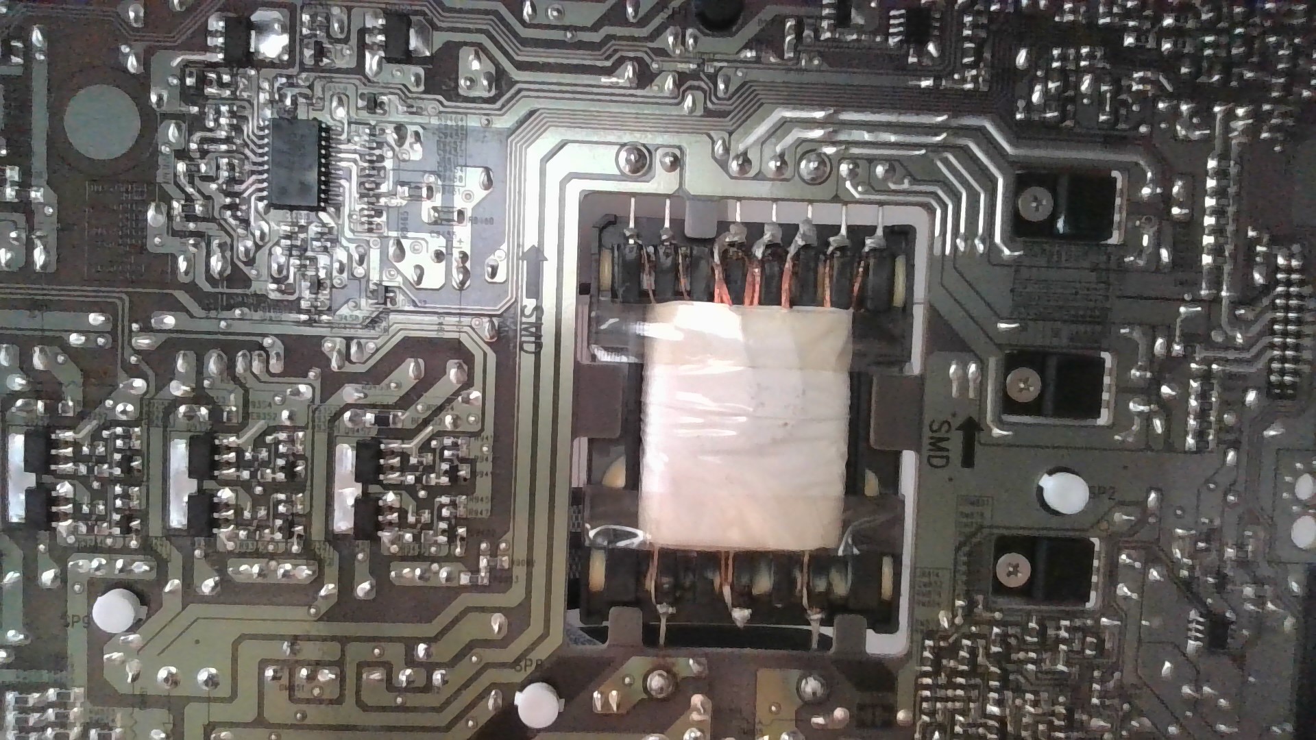

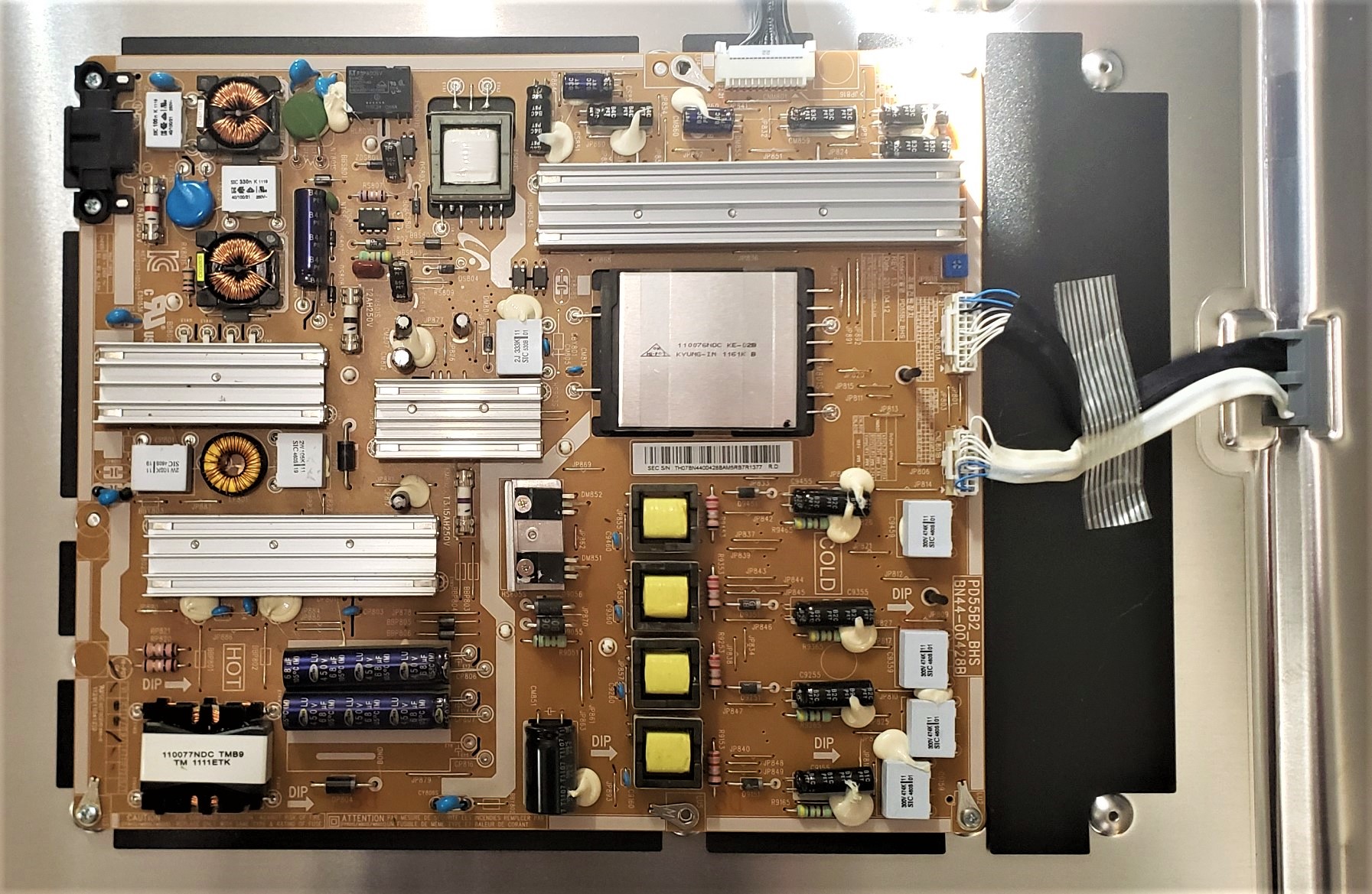

          Samsung BN44-00428b -revision 3 power supply?
          Folks...
          Update on my kit and power supply. See my post above this one.
          Most of the stuff in the kit do not have a place on my power supply. Could it be that the revision number of my power supply is not matching up with the kit I bought?
          I have no capacitor called CM811. I have no ICM801S. Nothing even close. The kit had two ICs called QP801,802. I have nothing like that. However I have two ICs at location JP862 called DM851 and DM852.
          The only correct things in the kit are two ICs (ICS801S and ICP801S) and the three fuses.
          I have enclosed three photos of my board. I bought the correct kit for the Samsung TV part number and the correct power supply part number. But maybe the kit is old. I have revision 3 of the power supply. Maybe that is the issue?
          Could that be it? Should I check for cold solder joints, install the two ICs and 3 fuses and see what happens?

            Re: Samsung / Hansol BN44-00428b
            CM811 is next to the diode DM801, designator of CM811 is covered by the white glue.
            ICM801S designator is also covered up by the white glue.
            QPxx are also covered up by the white glue.
            The question is what is the problem with the power supply board? What Voltages do you have and not have on the power supply connector that goes to the main board? I would not install the kit until you find what section of the power not working otherwise you can create new problem due to improper repair works..

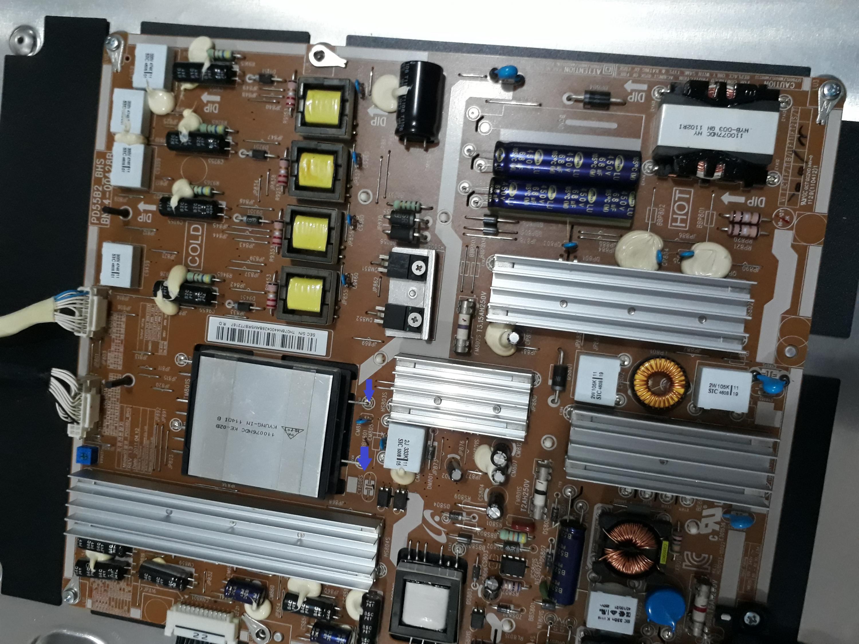

              Tv model:ue55d7000. Has power supply BN44-00428b. Intially problem started with restarts in between. But later got worse with automatically switching on/off before staying on for more than a hour. Last week it indefinitely went in boot loop.
              Took the back cover off. Smart logo keeps appearing on on/off. Backlight flashes 95% of the times.
              Weird thing is when I hold TV at an angle to the floor, it starts normally but goes in boot loop if i change the angle. So thinking some connection issue rather than a problem with power supply or main board.
              I can see a cracked solder near the transformer TM801s. Is there any way i can confirm this solder is the not making proper contact or cracked solder is the problem?
              Appreciate your help. Very useful thread.
              Thanks.
                #87
                Lets see the pictures your cracked solder and the straight shots pictures of the whole top and bottom side of YOUR board.

                  #88
                  Thanks for the reply. Unfortunately i didn't take a picture and already resoldered it. But still no luck..

                    #89
                    Whwn i measured voltage for TM801s as shown in picture(with blue arrows) it is reaching 1700 to 1800v(flutuates lot as it is clicking) and going back to 0 as it clicks. Not sure if it is the desired voltage. Pls let me know if it is desired.
                    Power supply clicks only when main board(cnm801) is connected (even without led pins(cnl801a and cnl801b) connected).

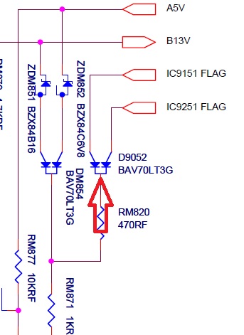

                            After removing the main board connection to power supply and tried connecting A5v to PWM_dim1, PWM_dim2, PWM_dim3 and PWM_dim4 in cnm801 one by one. Except PWM_DIM1(top most back light LED strip) all other back light strips worked.
                            Then checked voltage on all pins(R1+/-, R2+/-, L2+/- and L1+/-) for PWM_DIM1. Only L1- (pin7 in CNL801A) read 0V. So it looks like problem could be open/short circuit in top most back light LED strip.
                            As tv works fine when tv is hold at an angle i assume that LED is fine, just there could be short circuit because of dust. But looks like anyway i have to open the panel before that will give a try with a vaccum
                              #94
                              Yes, you do have open circuit in one of the LED string, it can be as simple as bad connection on the the connector that links the LED strips together.
