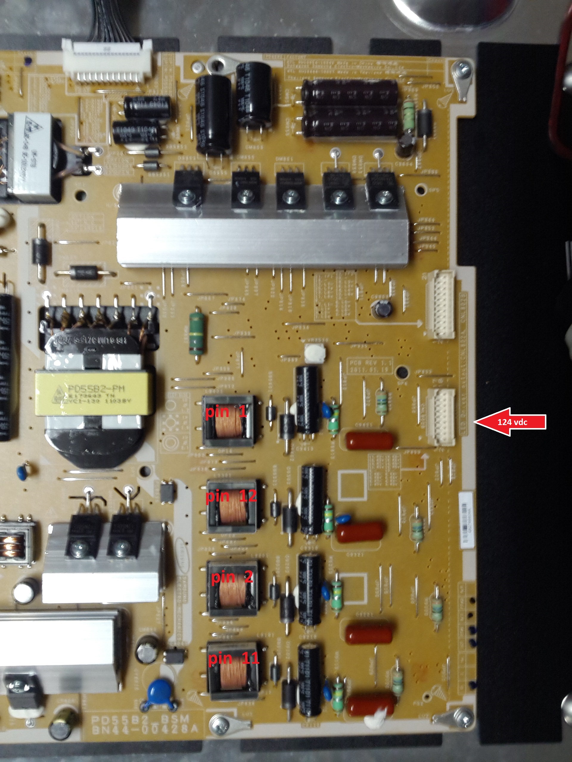

    Having a power supply problem on a Samsung UN55D6400UF.
    This is one of those LED smart TV's (2011), with the led driver is built into the PSU.
    Here's the problem:
    - locked in Stand-by mode (blinking 2 red)
    - Relay cycles on/off (about 5 secs.)
    - No Backlight
    (with CNM803 disconnected from the Main board - Forced Backlight does not turn on any of the Leds.)
    I'm assuming that the Led driver (circuit) is what's causing the protection mode, and shutting down the power supply ?
    All readings are at the PSU with CNM803 disconnected from Main board (forced backlight mode)

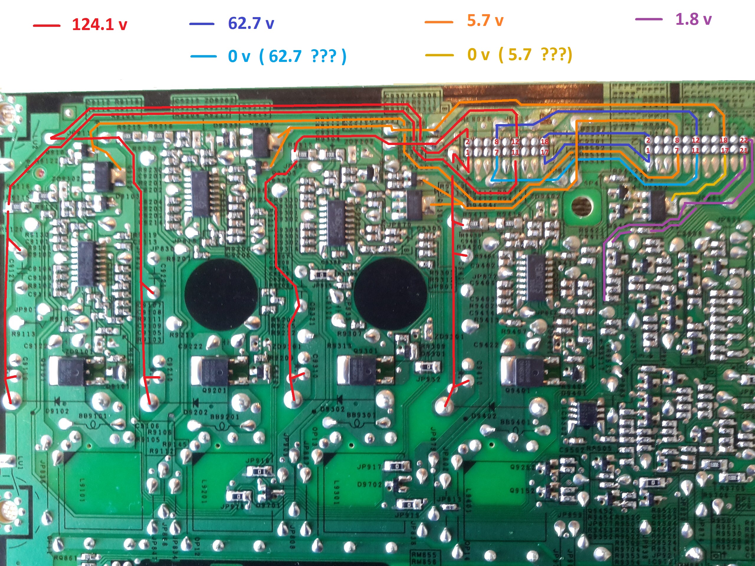

                        Had a hard time trying to cyfer the Led driver output cicuit, so I decided to make my own diagram. I only went back as far as the inductors - but this is what I have, so far.
                        This is an overall track line / wiring diagram - traced directly on to the board itself.
                        Certainly provided a lot more clarity on the overall system - but also questions:
                        Are the Led lights (backlight strings) run in series as opposed to parallel ?
                        - note the correlation on the 62.7 (pin 8/12 , 18/2 , 7/11 , 17/1) - no input or output
                        -Or-
                        Are the connectors (pinouts) split top / bottom :
                        124.1v (2) feeds 62.7v (8) jumper to 62.7v (12) feeds 5.7v (18) etc...
                        Not sure - still somewhat confused.

                                  OK, so I went back and voltage tested each of the components ( 7 per) on each of the 4 strings - All Good.
                                  Each of these appear to be the Primary voltage supply for their led outputs.
                                  I was also able to confirmed and verified them at their respective destination points by their 124v power source on pins 1, 2, 11, 12 of the 18 pin connector ( as seen in my attached wiring diagram ).
                                  Just out of interest I decided to re-test each of the voltages at the led connectors - This time with the connectors unplugged:
                                  With your concerns in mind, I used an old Analog meter (needle). Since the needle will respond a lot faster to any millisecond fluctuations than any DMM, and a better chance of spotting any voltage/spike before shut down - I thought it was a good choice .
                                  Readings =
                                  124v constant on all primaries (1,2,11,12 - 18 pin conn.)
                                  1.8v on IFC 1 & 2 (pin 21,22 - 22 pin conn.)
                                  No other voltages present - either on initial plug-in or running ???

                                    Based on the information provided by the board, I was able to draft a basic composite of the backlight sheme (very basic).
                                    Based on that , I can extrapolate that there is a failure in strings 7 & 8.
                                    With the 124v power source being provided at R7+ and the lack of the 5.7volts at L7- , I guess the question would be :
                                    " Is the 5.7v signal on pin 17 (of the 22 pin conn.) a forward ? -or- return voltage ? "
                                    I'm guessing that the answer to that will probably determine whether this is actually a power supply problem - or- an Led issue.

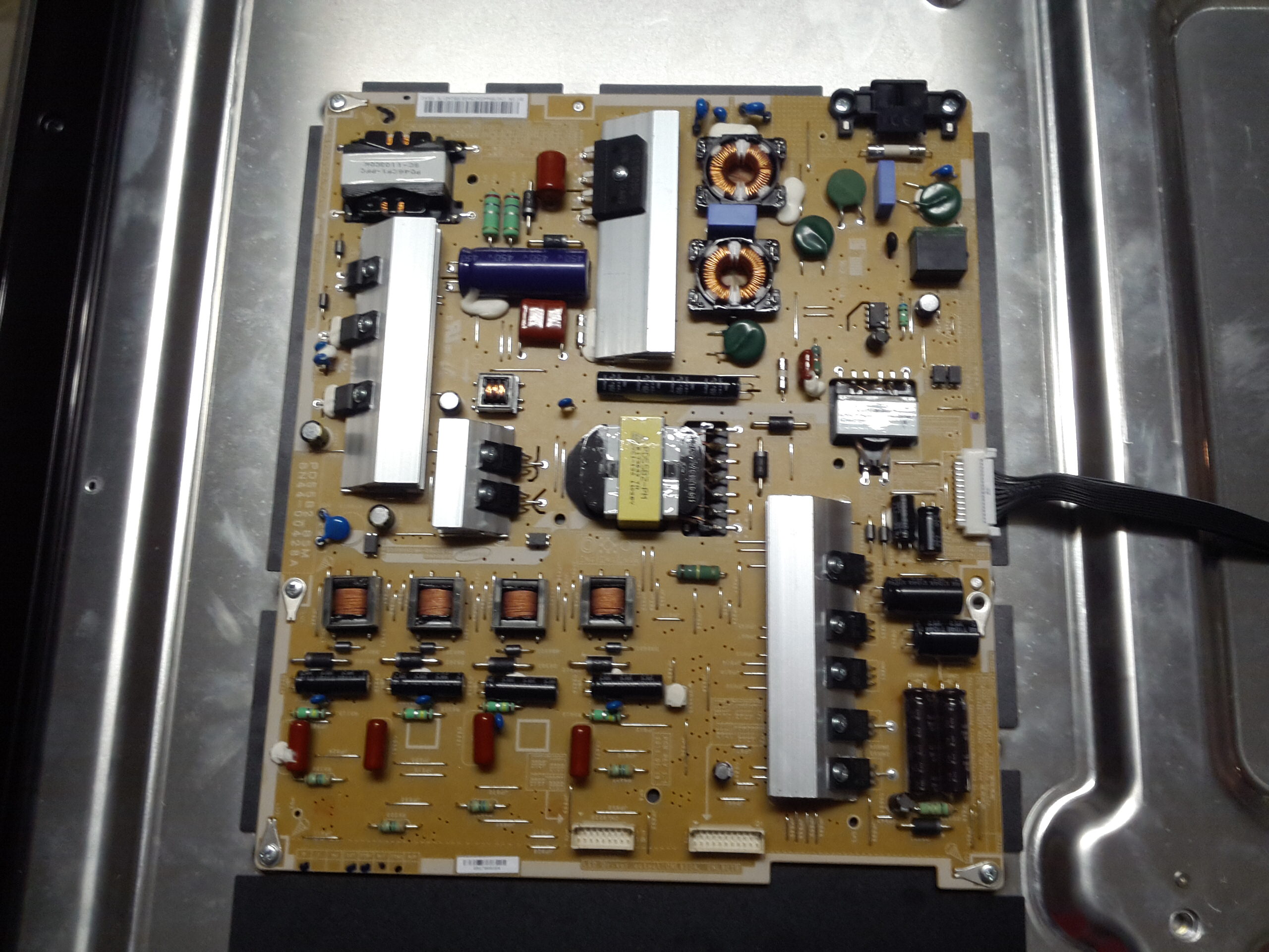

                                        I took it apart (panel) - and what I found was:
                                        This system uses 2 side panel led light bars - Left/Right
                                        CN801a (18 pin) operates the right side and CN801b (22 pin) the left.
                                        Each connector is then split again - top/bottom (odd/even), each responsible for their own respective halves of the light bar.
                                        The two bars are then connected by looping the right side (primary) back through the PSU to power up the left side - cn801b 1,2 to cn801a 17,18
                                        The 5.7v is a return signal - (after voltage drop from the 124v across the Leds)
                                        Because of this, I am fairly convinced that this is not a power supply problem - but rather a bad Led (light bar) issue.
                                        Sorry I posted this the wrong location -
                                        thought for sure that this was definitely going to be a Power Supply problem
                                        I know it was a long work through - and I appreciate all your help
